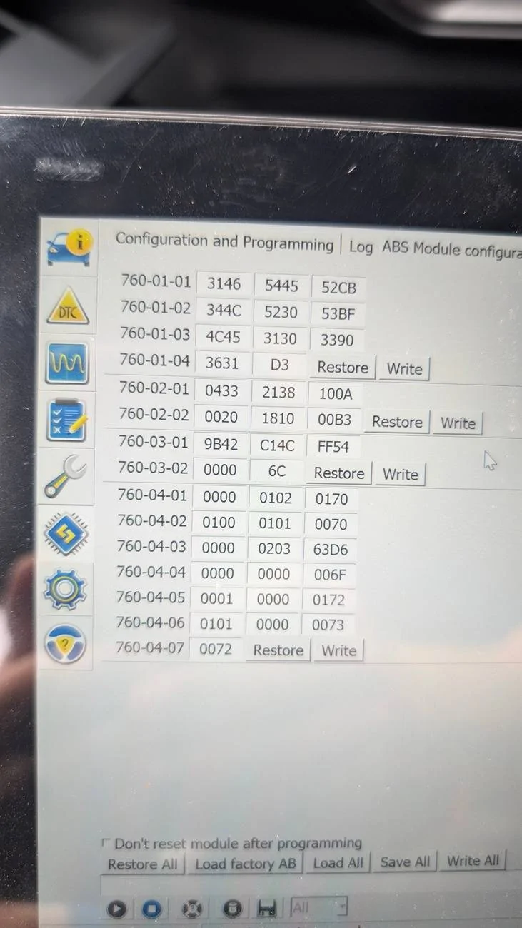

I went to enable Trail turn assist and my abs section doesn't match what the spreadsheet has.... The 760-03-1 part... I have a 2025 US spec
I have a 2026 Argentina ranger and I'm experiencing the same problem, we have 3 ABS blocks with completely different coding than any spreadsheet. I tried adding 8 to Hex, but Forscan doesn't record and displays the message "Service procedure has been interrupted". Does anyone have a solution?

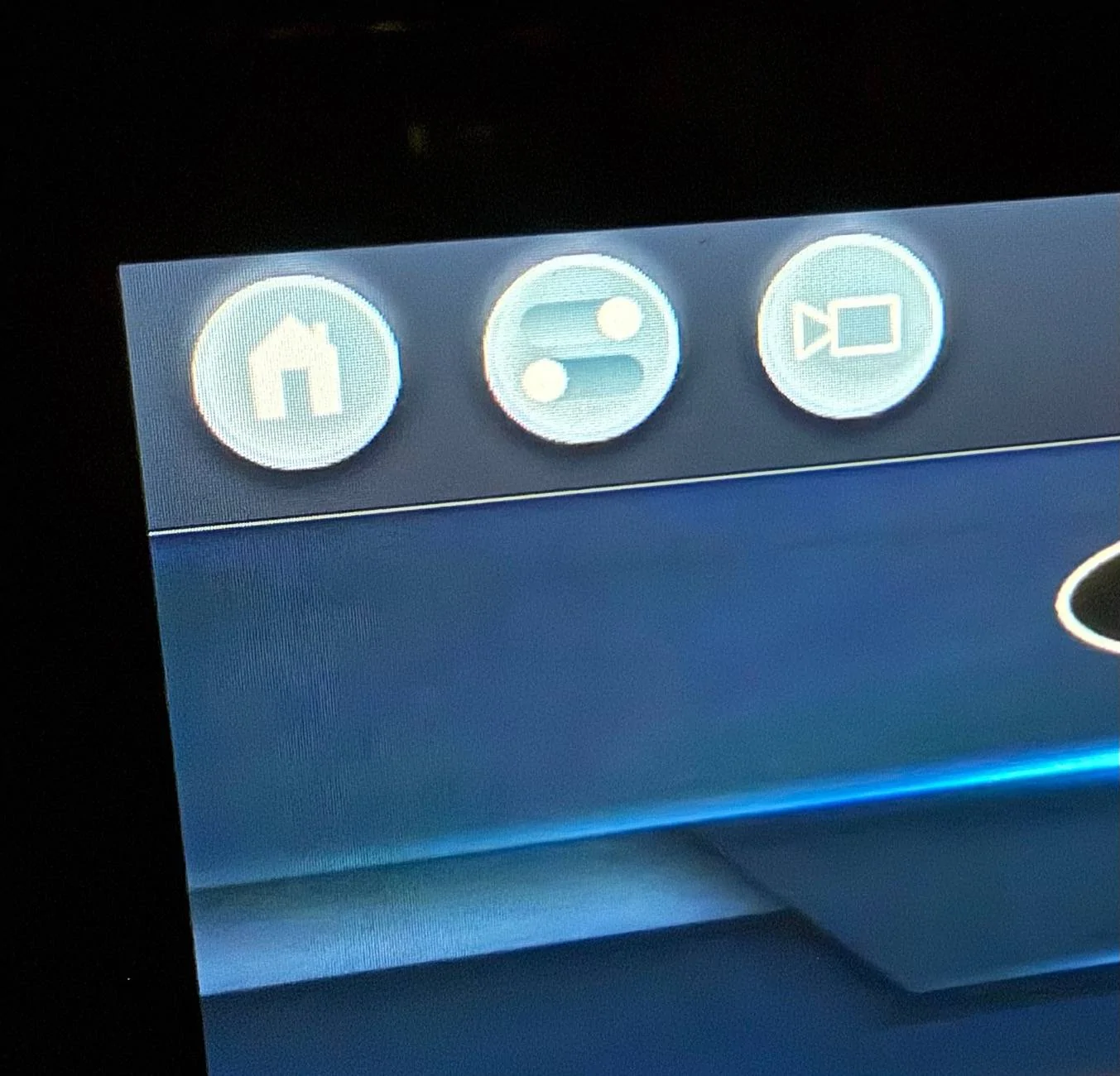

Now i'm trying to activate the rear camera at speed. Does anyone with just the rear camera was able to do it? I have a feeling it only works with the 360 camera system.
I was able to enable this icon at APIM module, but when I click it nothing happens.

I was able to turn rear camera on at speed. That is the only camera i have. Also made the "full view not available go away. Its in the spread sheet here on the asbuilt sheet. Works like a charm.

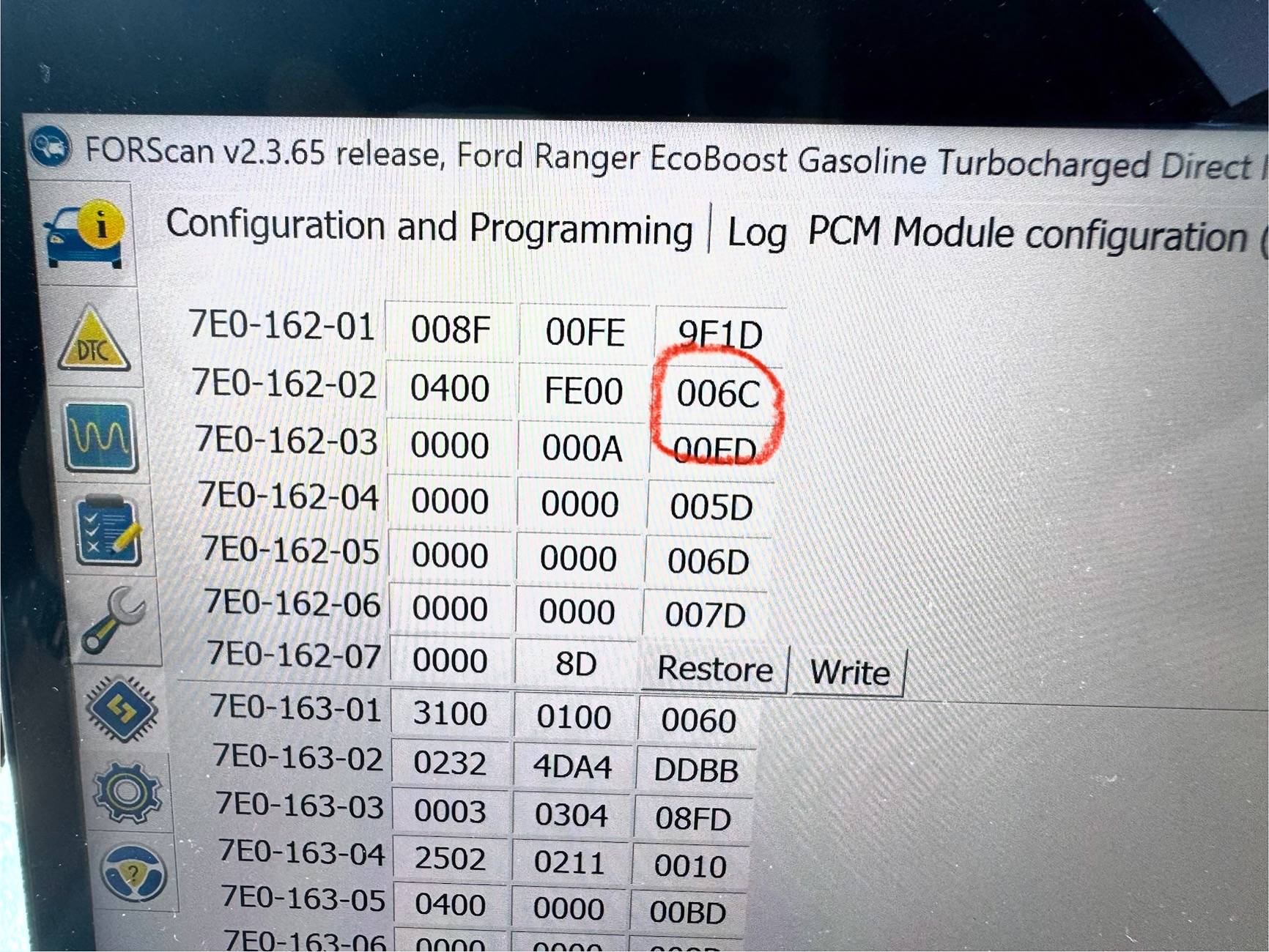

Has anyone had any luck making changes on the PCM module?
I’m pretty sure the second digit in the field circled should be 4 and when I put that in it gets to about 80% then fails. Not sure what the 6C means either. Anyone else here with a ranger raptor that can post a screen shot of what theirs shows. This is to try and get the active shutters on the intercooler to open. Thanks
