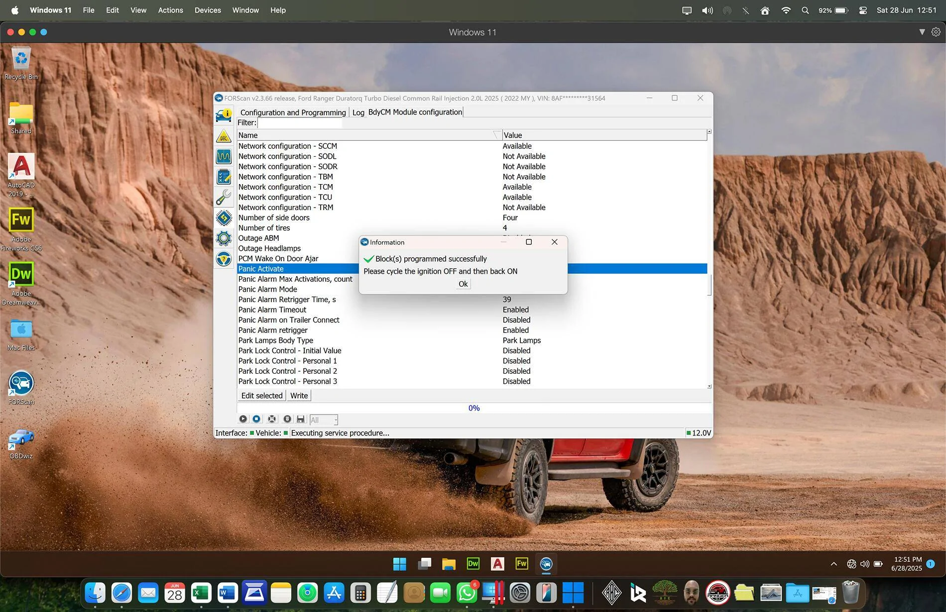

Guys, after a long time trying I was finally able to make the OBDLink MX+ work on my MacBook M2 running Windows 10 via Parallels.
The trick is simple: you can’t use Mac’s bluetooth. I bought a cheap plug&play usb bluetooth adapter, connected it to my Parallels Windows machine and it worked like a charm!
Hmmmm, interesting...???
Zero issues with MacBook Pro, W10, Parallels with OBDLink CX for connection and coding w/Forescan.
Been using said set-up for years coding my Bimmers as well.
FP tune, different story, must use a Windows PC laptop as no Mac/software combo will work full stop.
