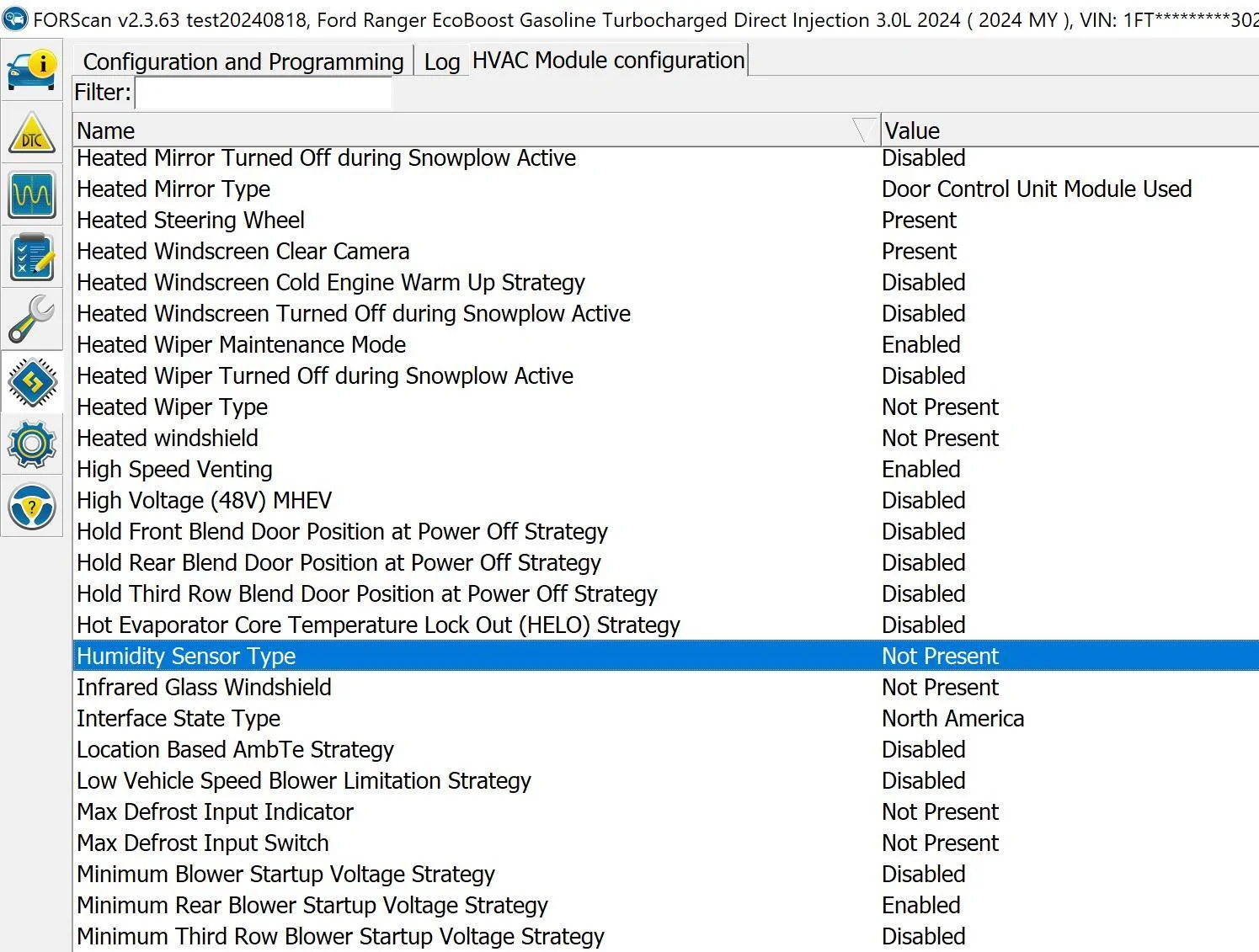

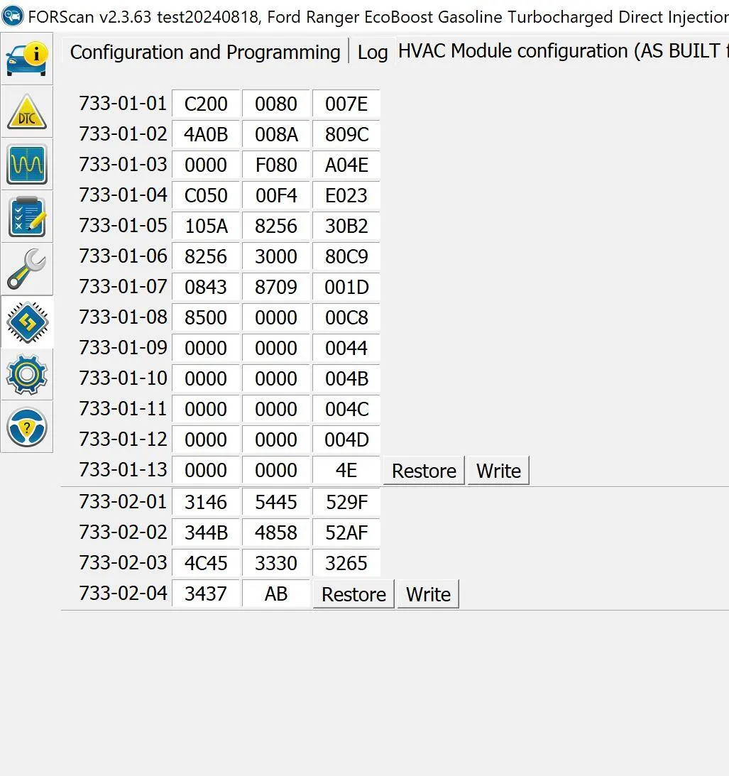

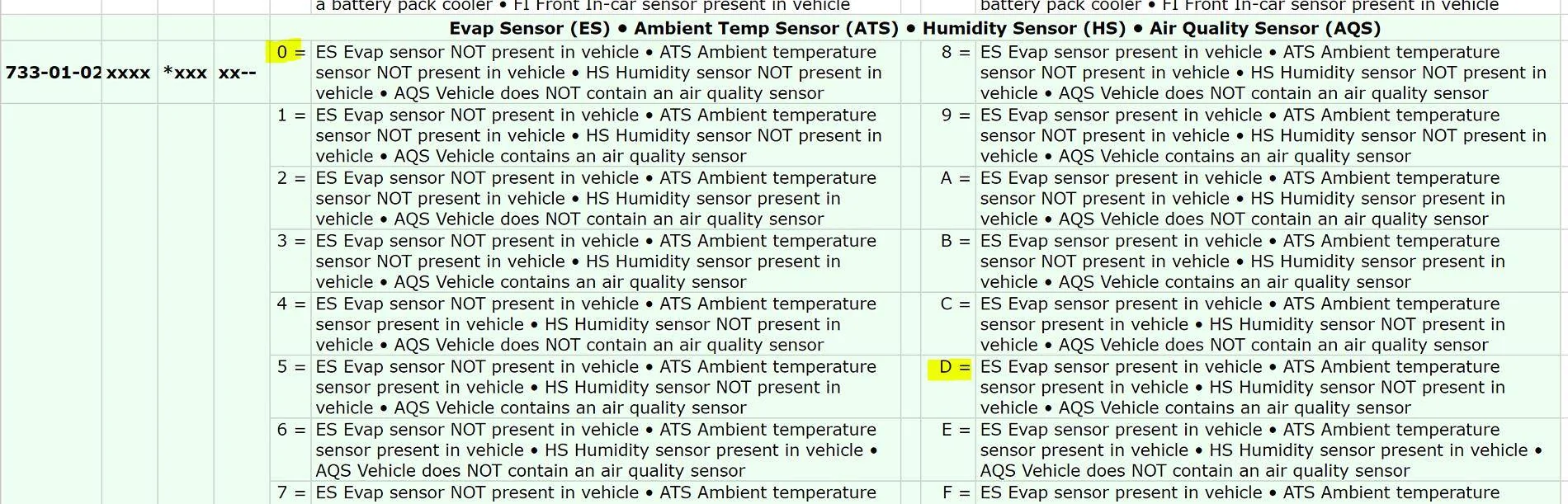

I think I got this figured out and wanted to share my process for others looking to do the same.
I looked in the 733-01-02 and as you can see below, the digit I need change is a 0. A zero in the FORscan sheet means that none of the listed sensors are present.
Ford Ranger FORScan NA Ranger 6th Gen (2024+) Crowdsourced Spreadsheet Capture1
Ford Ranger FORScan NA Ranger 6th Gen (2024+) Crowdsourced Spreadsheet Capture3
Changing the listed value to 'D' would enable all the sensors except the humidity sensor. However, if none of the sensors are present, I shouldn't have the A/C come on by itself. Hmmm...
So poked around on the non-ASBUILT and looked for the humidity sensor there. It showed that the 'Humidity sensor type' was 'Windshield mounted'. I changed that to 'Not Present' and wrote the changes.
Ford Ranger FORScan NA Ranger 6th Gen (2024+) Crowdsourced Spreadsheet Capture2
Happy to report that I took it for a little spin and got nothing by sweet, sweet ambient outside air coming out of the vents. Okay, it wasn't that sweet. It's like 92 degrees today, but the A/C did not kick on until I turned it on. The biggest test will be in the mornings when it's a little cooler and more humid. I'll update later.

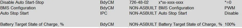

so I turned off Start Stop on my Raptor, it doesn't report any errors
completely disabled, or just default to off?
I am not interested in completely disabling it, but I do like the idea of it defaulting to off, rather than on.
craigc
craigc
Craig
Aug 28, 2023
311
253
Allen, TX
completely deactivated
Thanks for confirming this. I thought for sure I had tried it and it didn't work, but went ahead and tried again, and can say that this completely deactivates the feature. Spreadsheet has been updated on the Confirmed tab.
There is an APIM setting for Auto Start Stop. I have not tried it, but -maybe- that enables an option in the center screen to allow for turning on and off. Would be nice if it could just be defaulted off rather than on, but I see no such setting for that.
