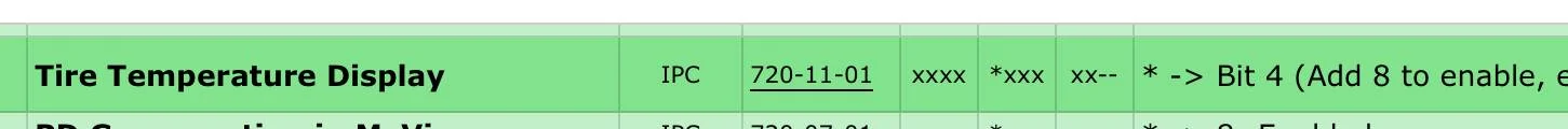

I followed the instructions in the linked sheet in first post.
The value changed from 0 to 8 on my raptor. Temps work, no issue with gear display.
That fixed it for me. Thank you!
