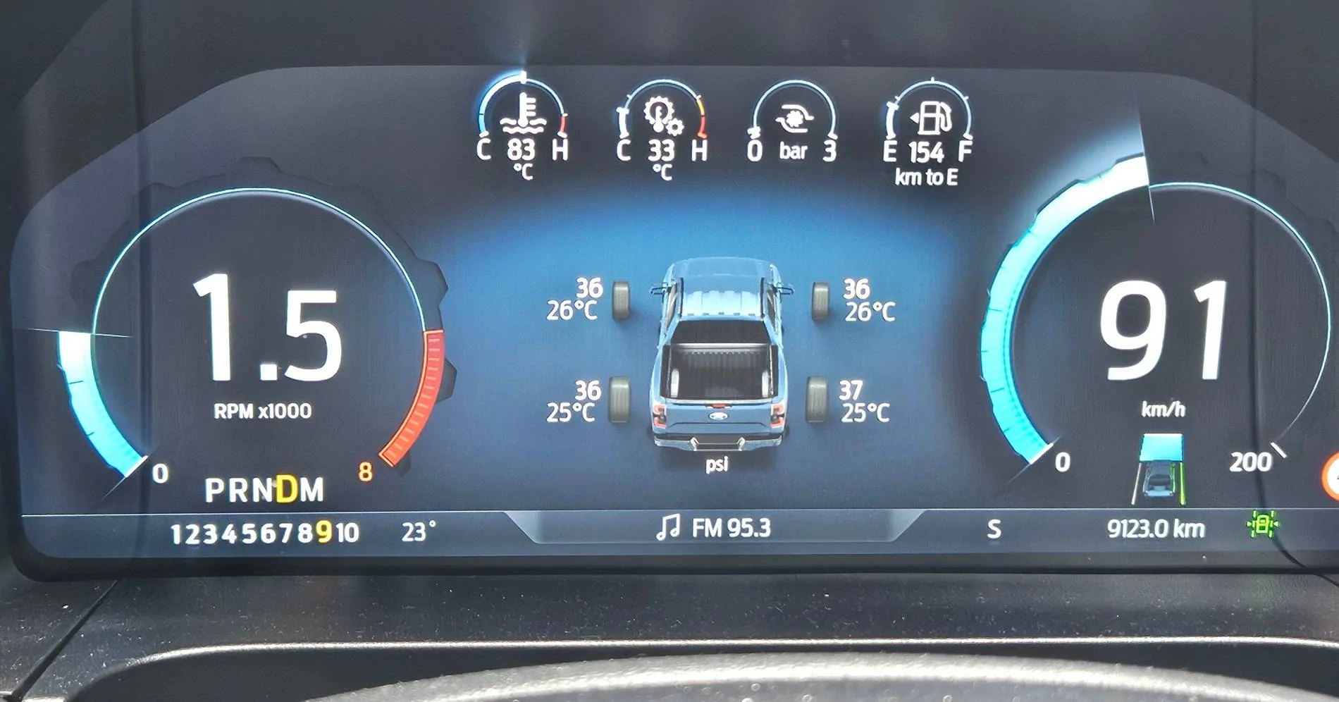

Has anyone tried to turn the little number values for the displayed small gauges. Underneath the fuel gauge it shows DTE. I’d like to also see oil pressure, coolant temperature etc.?
i have seen it turned on but I don’t know what forscan function it is.
I'll look at my setting tonight.
I'll go over my settings tonight. Tyre psi and temperature are pretty cool too.
I’m interested to know if you have got oil pressure to work. That’s the one I haven’t got going.
what vehicle do you have?
I don’t have the selected gear showing either on the bottom left side

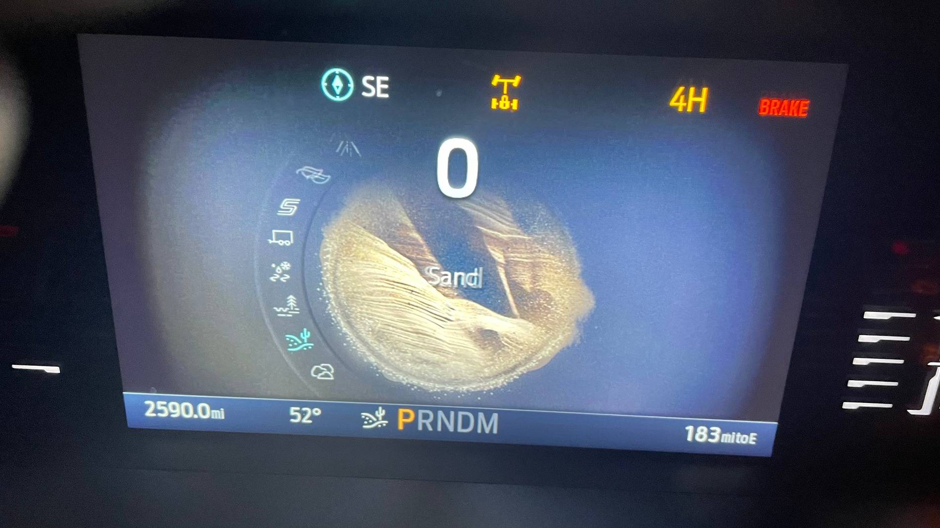

For 8" screen on XLT, has anyone found if there's a mode to always show the gauges, like transmission & boost?
RangerDangerStranger
Chris
Mar 14, 2020
469
464
SF Bay Area
2024 XLT 4x4 in GreyBlue.
Cool Dude
3 line menu key on steering wheel > Offroad> Vehicle gauges. Toggle on off once selected by reverse pointer st wheel key.
