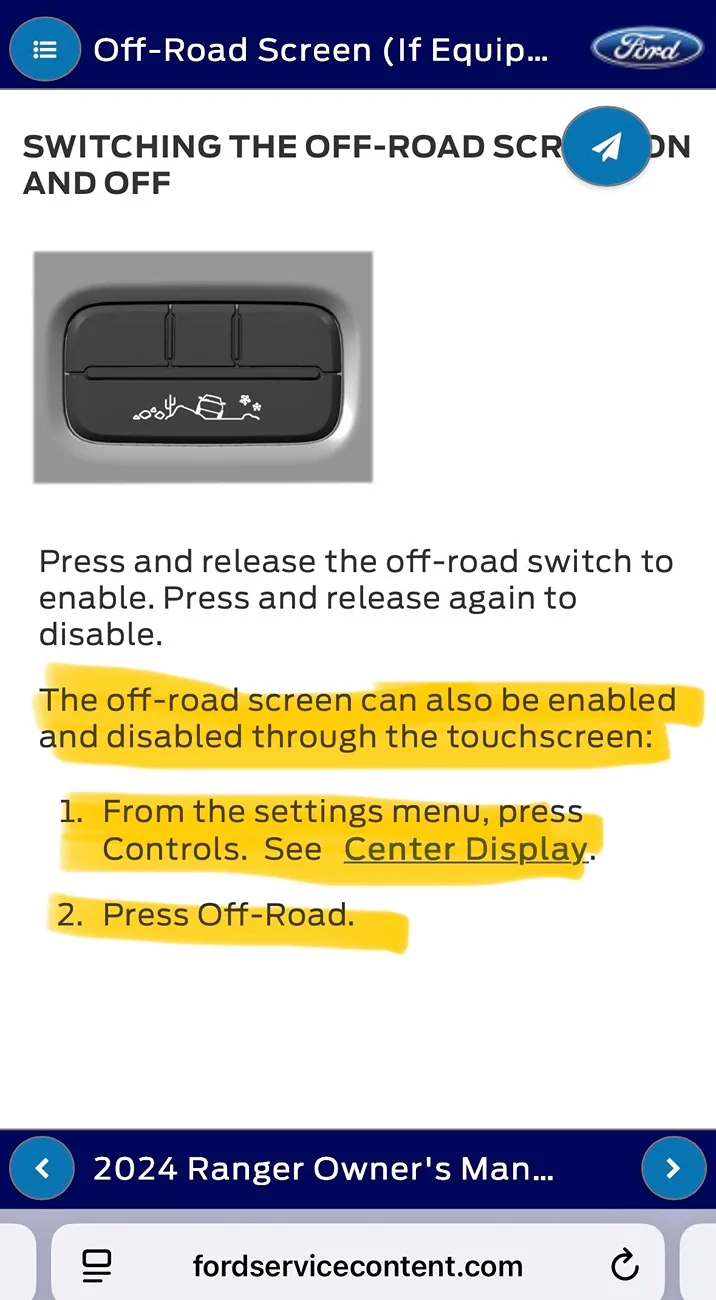

Did someone with a non-FX4 ranger 2024/2025 did (or could) try to ENABLE the APIM : Off-road Menu
And try to access to the offroad menu with this option (in yellow) :
Ford Ranger FORScan NA Ranger 6th Gen (2024+) Crowdsourced Spreadsheet 1765144466591-h1
It would give access to the Offroad menu without the physical button & the option to unluck Trail Control (with unlocking another option in Forscan)
I want to buy a used 2025 Ranger Lariat but it doesnt have the FX4 package, so i would be grateful if someone can try.
Thanks
Waiting for an answer

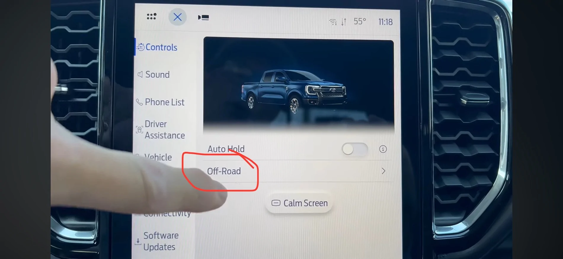

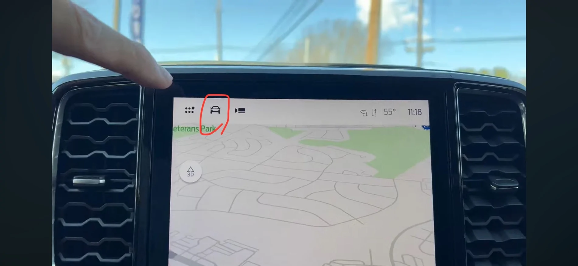

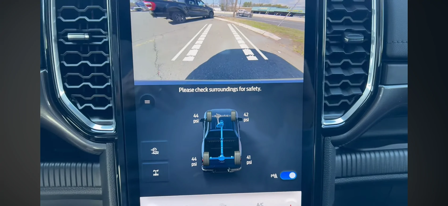

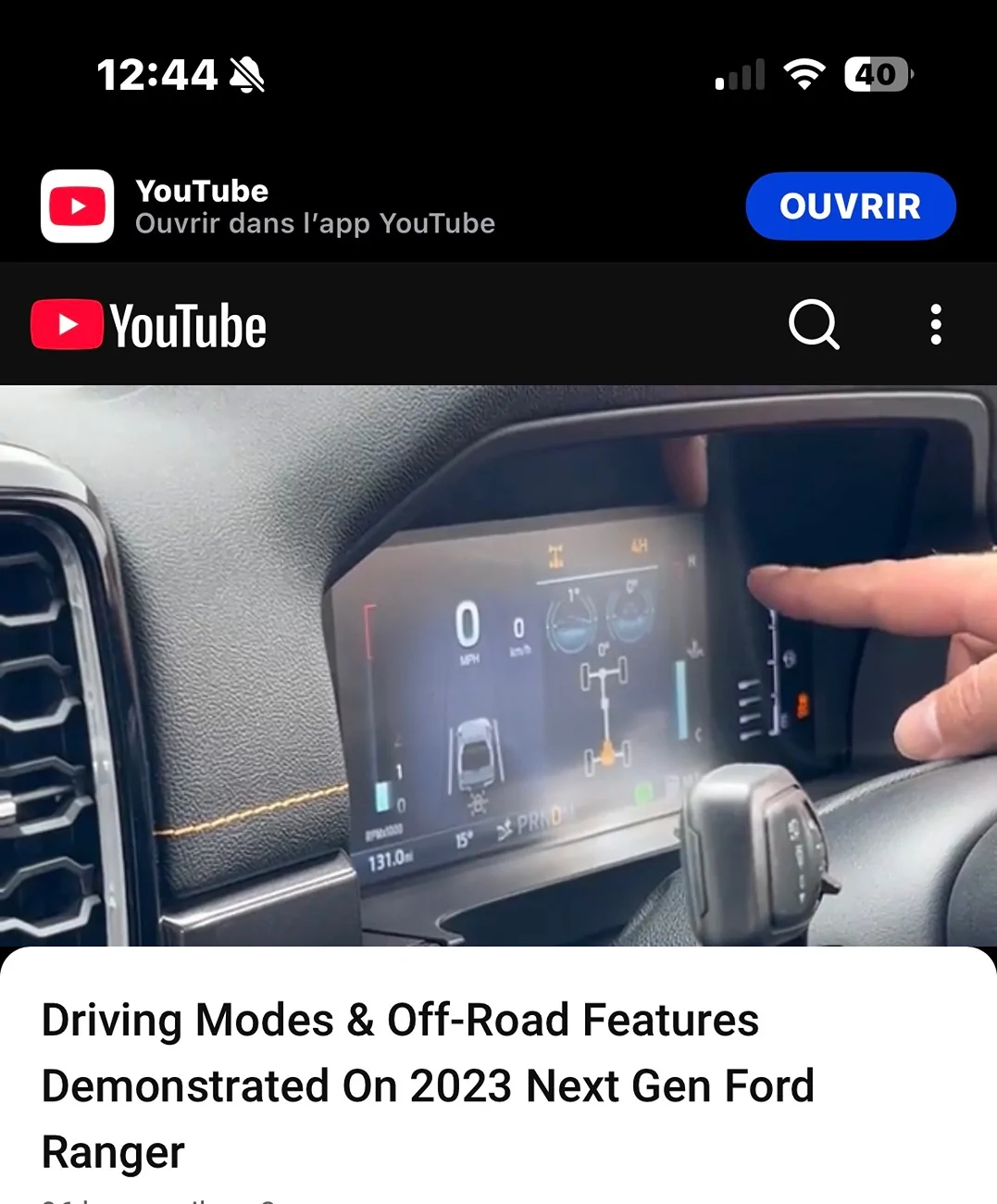

Took those screenshots from a video of a guy that has a FX4 ranger :
1-
Ford Ranger FORScan NA Ranger 6th Gen (2024+) Crowdsourced Spreadsheet 1765242339657-vd
2-
Ford Ranger FORScan NA Ranger 6th Gen (2024+) Crowdsourced Spreadsheet 1765242381183-74
3-
Ford Ranger FORScan NA Ranger 6th Gen (2024+) Crowdsourced Spreadsheet 1765242413573-tf
so does enabling the APIM « Offroad menu » on a non-FX4 truck allows this?
1-
2-
3-
Ooh ! I thought you were asking about the offroad driving modes selection without a physical button! I already have this menu !
But with no driving modes selector button I can’t activate sport or crawling mode
