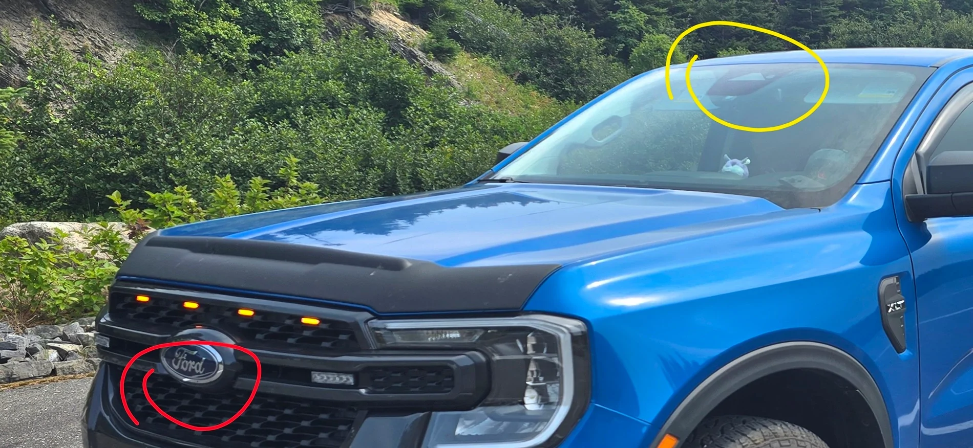

Do you actually have a front cam but it doesn’t show up in the menu or you simply don’t have a front cam?
the front cam they are refering to is the 360° camera in the grill. the windshield is the lane keep assist/forward emergency braking assist/automatic highbeam camera.
the front camera is a standalone camera
The 360 degree camera is the back, two side mirror cameras and front camera fused together into a single image
if you have the tailgate open and or door open you get a really funky 360 image.
in order to get the front camera in the grill you need the 360° camera in the technology package. my xlt does not have the grill camera(red), but does have the forward collision avoidance/lane keep assist/automatic high beam camera at the top of the windshield(yellow). tailgate camera is standard on all rangers(in canada anyways as its mandatory)

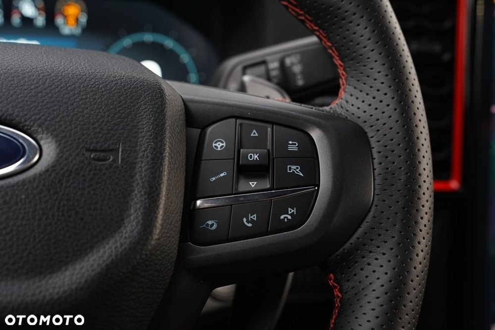

Hi All.
My car is EU RR 2024.5
I have a big issue (most annoying just after miss of memory seats...) with mobile phone operation. I believe every owner of RR knows that receiving is no problem via [OK] but to drop it after call finish is pain in the ash...
Then suddenly i saw this:
Ford Ranger FORScan NA Ranger 6th Gen (2024+) Crowdsourced Spreadsheet image;s=5120x0;q=100
It is 2025.25 EU model (not fake since i saw it on some other pictures as well).
I believe it is just a matter of codding and/or SCCM software.
I do not believe those switches need to be changed to get functionality.
So if anyone get on it with Forscan in hands, please check codding for
SCCM SW/FW ver
724-03-01 xxx* xxxx
