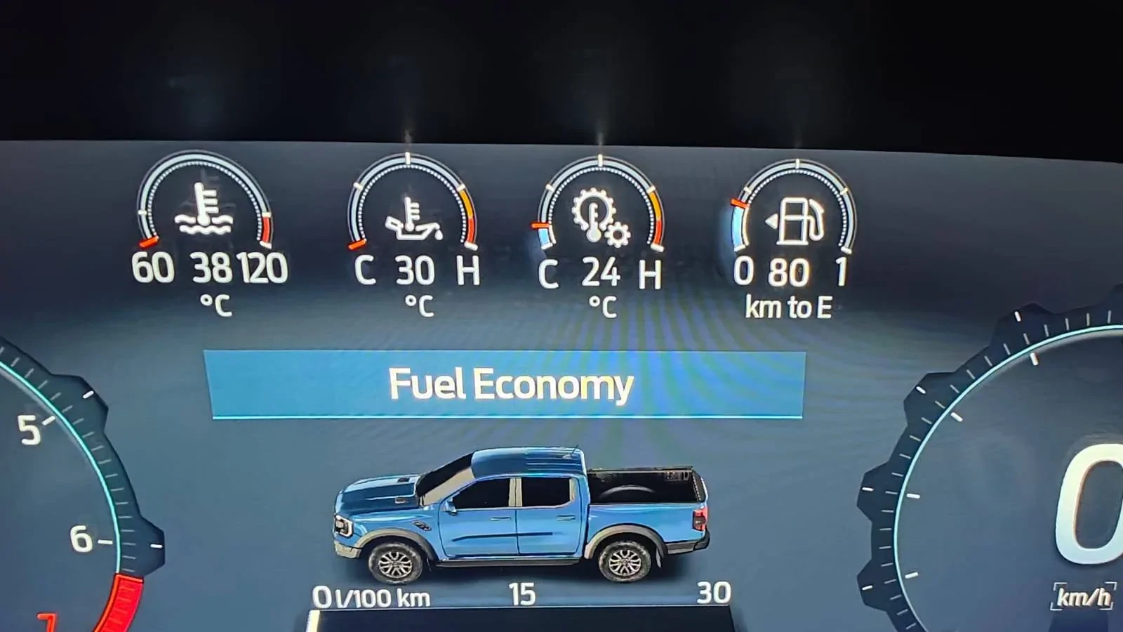

.....I added the temperature reading for oil, coolant and transmission. ....
so, do you mean the 4 gauges at the top?
I have coolant temp, oil, temp, trans temp, and fuel, and I want to add the actual temps below, so they match, like this, but in °F for me here in the states
Ford Ranger FORScan NA Ranger 6th Gen (2024+) Crowdsourced Spreadsheet 1769282937000-0u
is this what you did, if so, how did you do it?
I thought it was this:
ClusterDigital Engine and Transmission Temperature Gauges in 12" clusterDigital Engine Temperature GaugeConfig 2 (Default), Enabled
Digital Transmission Temperature GaugeConfig 2 (Default), Enabled
but mine are already the 'config2(default)'

Yep those are the ones, but config 2 is default, you want to change them to enable.
Anybody else have done these and see a big delta gap for coolant and the other two while the weather is cold? I'm wondering if that's as low as the coolant temp goes? If so that seems odd

ok, thank you, I misunderstood the sheet. Now that I've got it right I can also confirm that it looks like 100°F seems to be the bottom limit of coolant temp. I have 53°F on oil temp and 55°F on trans temp, after sitting in a 30°F garage for about 7 hrs so those may be the bottom limits of those two.
