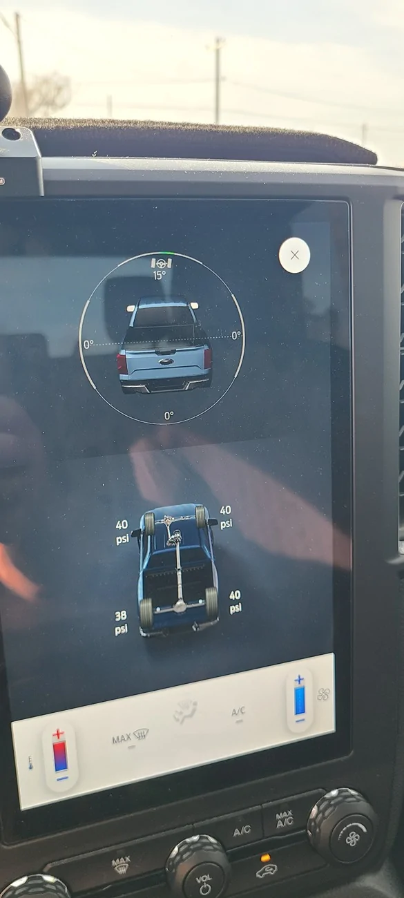

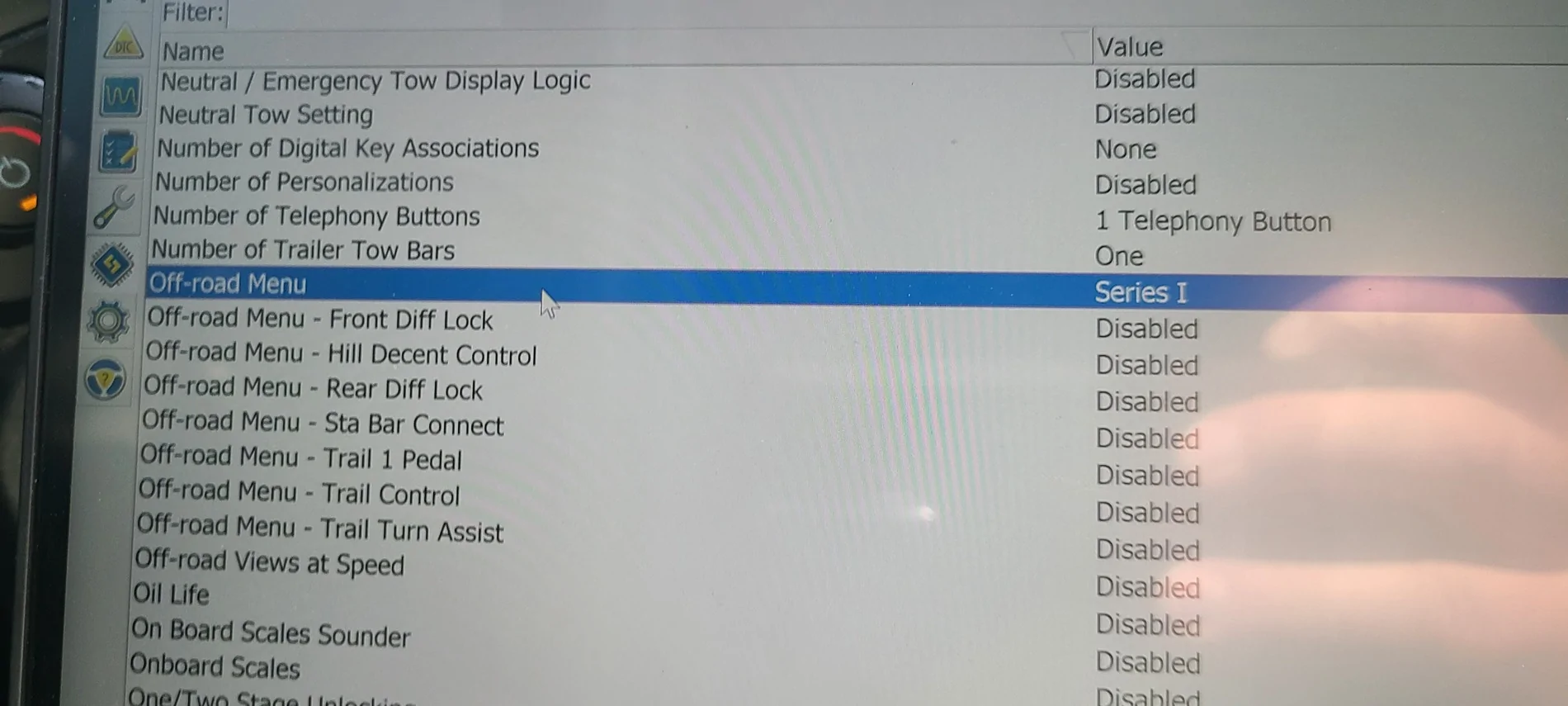

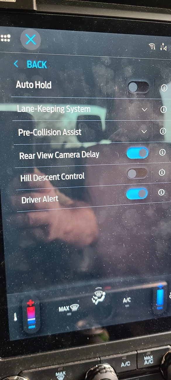

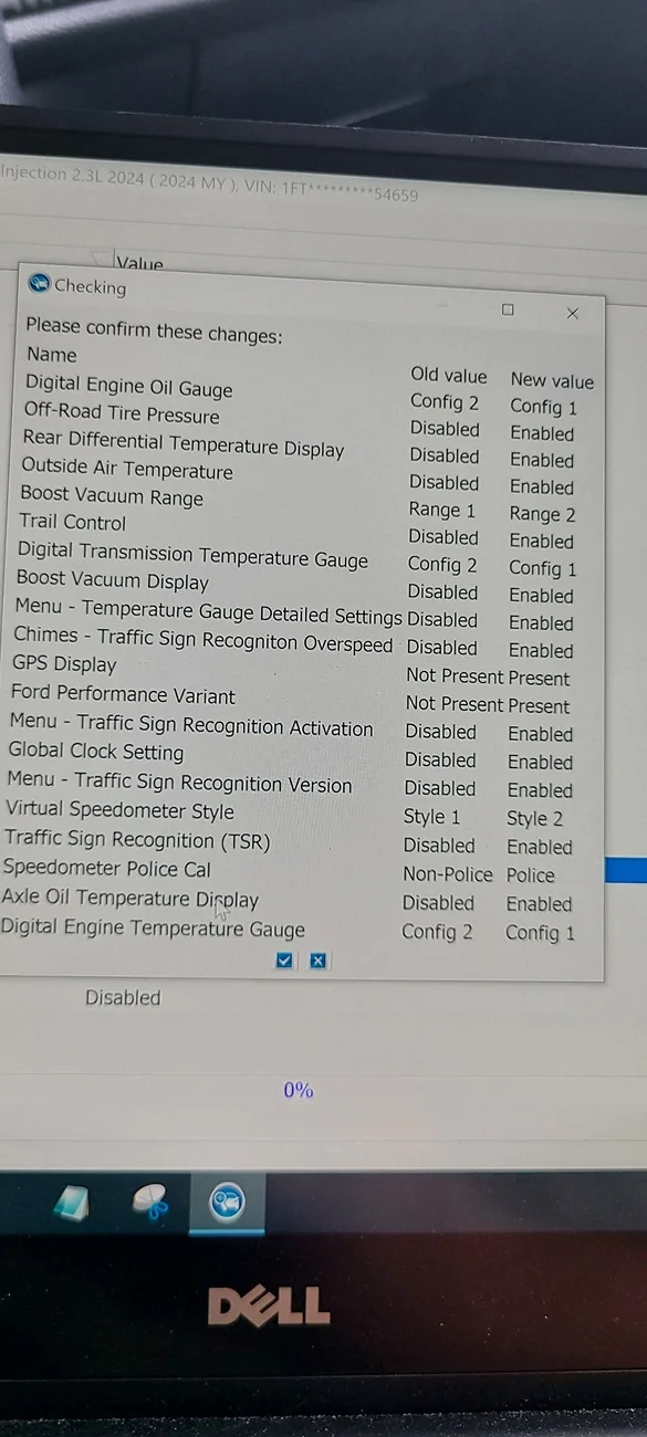

Offroad view works on the 2wd stx/xl. I never tried it efore so today i activated it.
Ford Ranger FORScan NA Ranger 6th Gen (2024+) Crowdsourced Spreadsheet 20260225_162640
Ford Ranger FORScan NA Ranger 6th Gen (2024+) Crowdsourced Spreadsheet 20260225_164821
I actually tried all 3 settings and they look the same so i just picked series 1
Ford Ranger FORScan NA Ranger 6th Gen (2024+) Crowdsourced Spreadsheet 20260225_162921

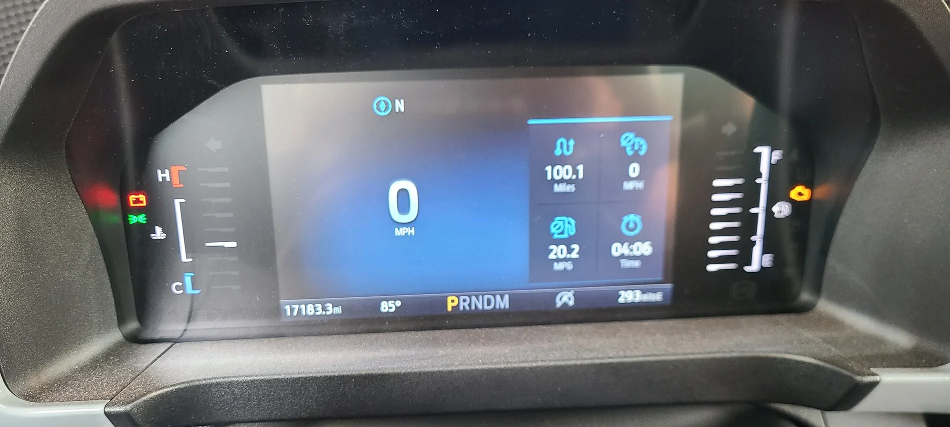

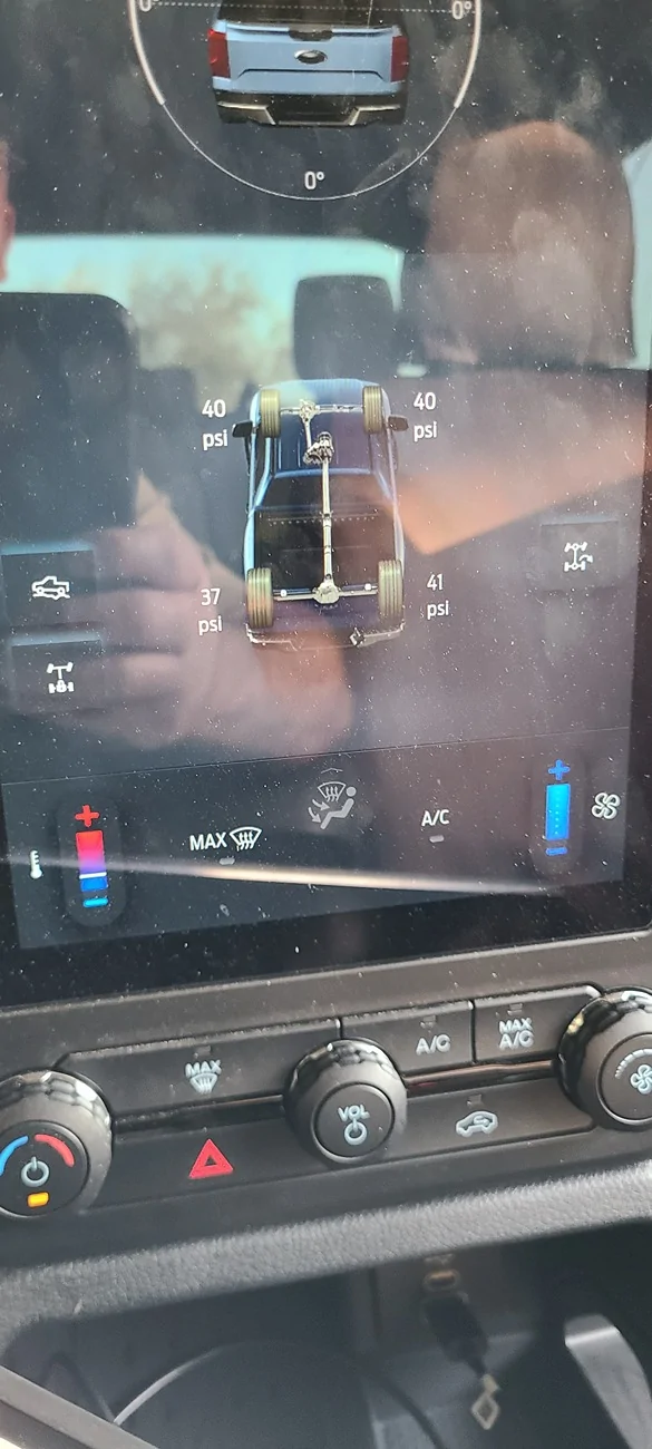

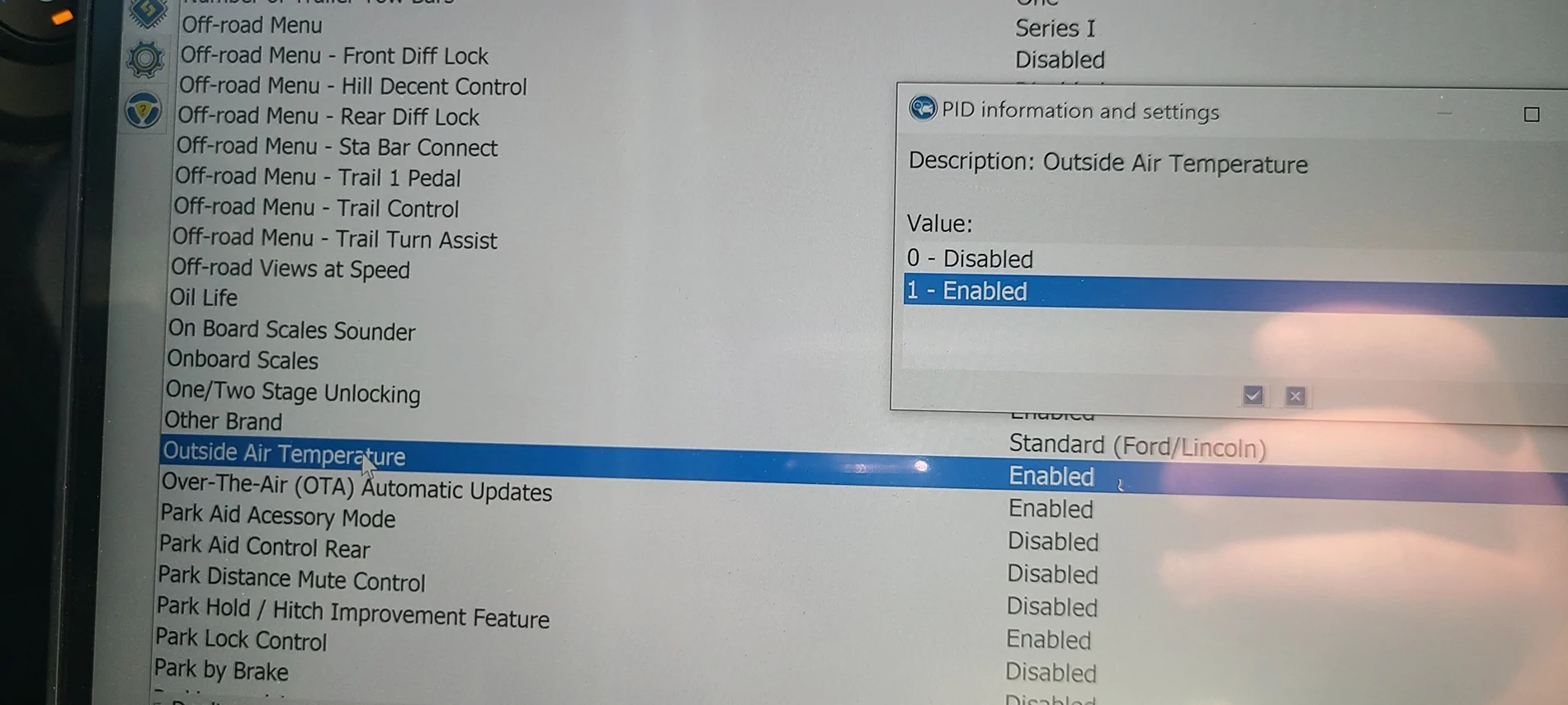

Also, redid the outside air temp choice but nothing on thr gage cluster, still. Just the center screen
Ford Ranger FORScan NA Ranger 6th Gen (2024+) Crowdsourced Spreadsheet 20260225_162945
I looked through every module for anything else related to the air temp, but nothing seemed related.

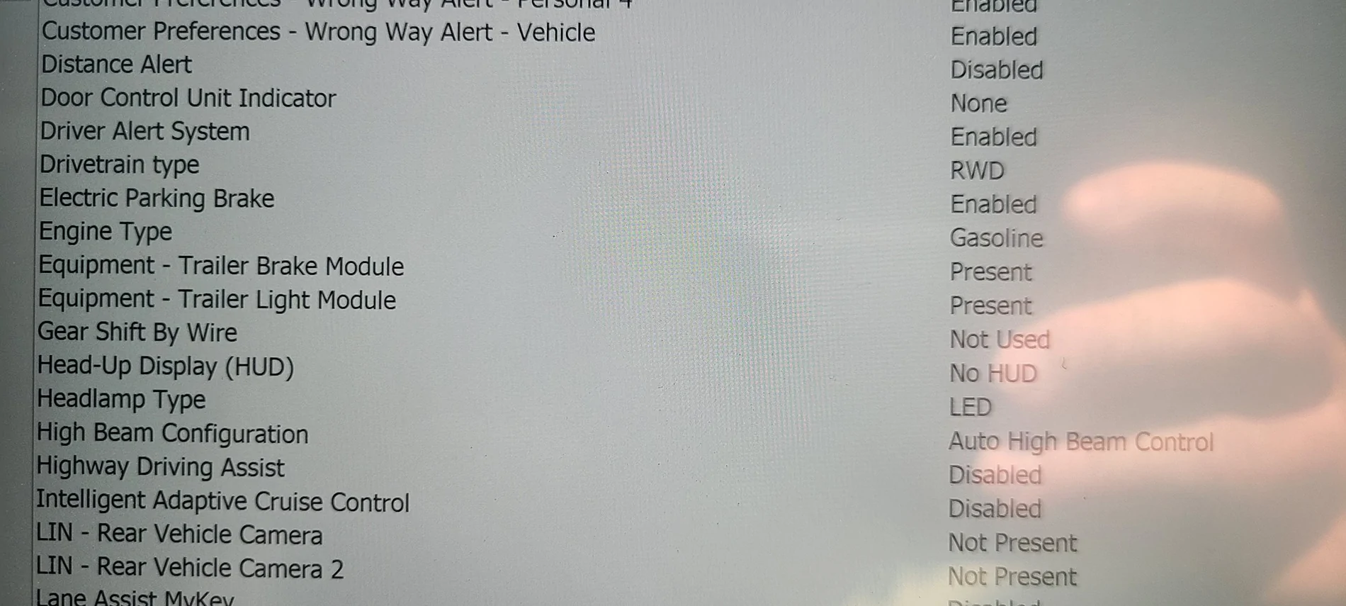

And look at this. It says trailer brake module present. So i must have the stuff, wiring etc, just not the controller.
Ford Ranger FORScan NA Ranger 6th Gen (2024+) Crowdsourced Spreadsheet 20260225_161738

I still have problems with tpms activation! Tried every TPMS option with FORSCAN!!

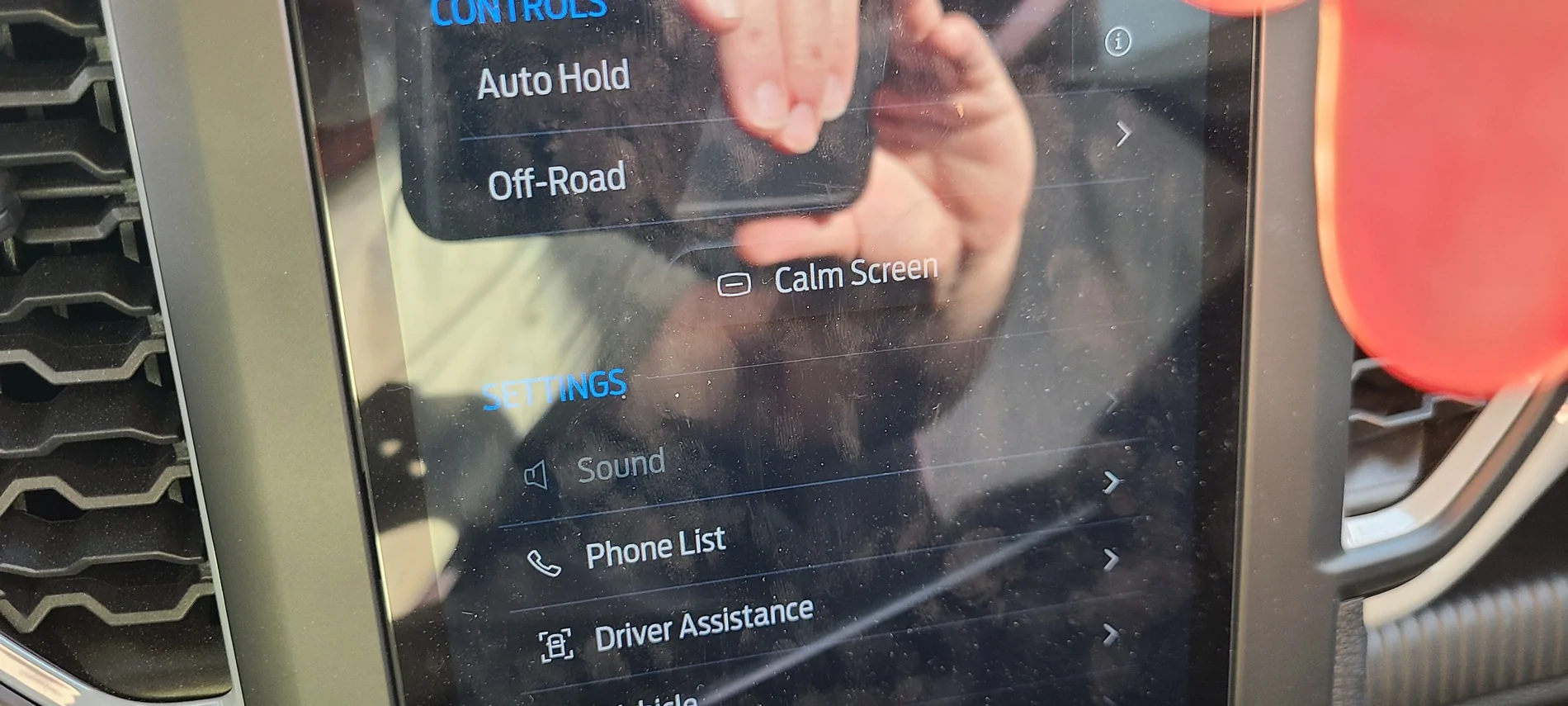

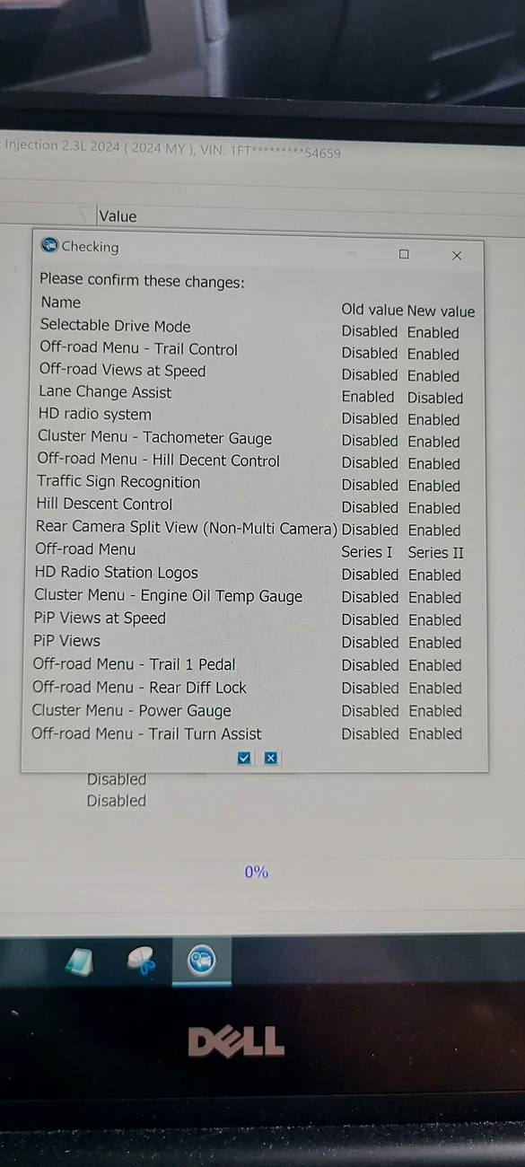

All of this is in a 2024 2.3 2wd stx, which is an xl with carpet and rims for people who dont know.
Ford Ranger FORScan NA Ranger 6th Gen (2024+) Crowdsourced Spreadsheet 20260305_171537
Ford Ranger FORScan NA Ranger 6th Gen (2024+) Crowdsourced Spreadsheet 20260305_165839

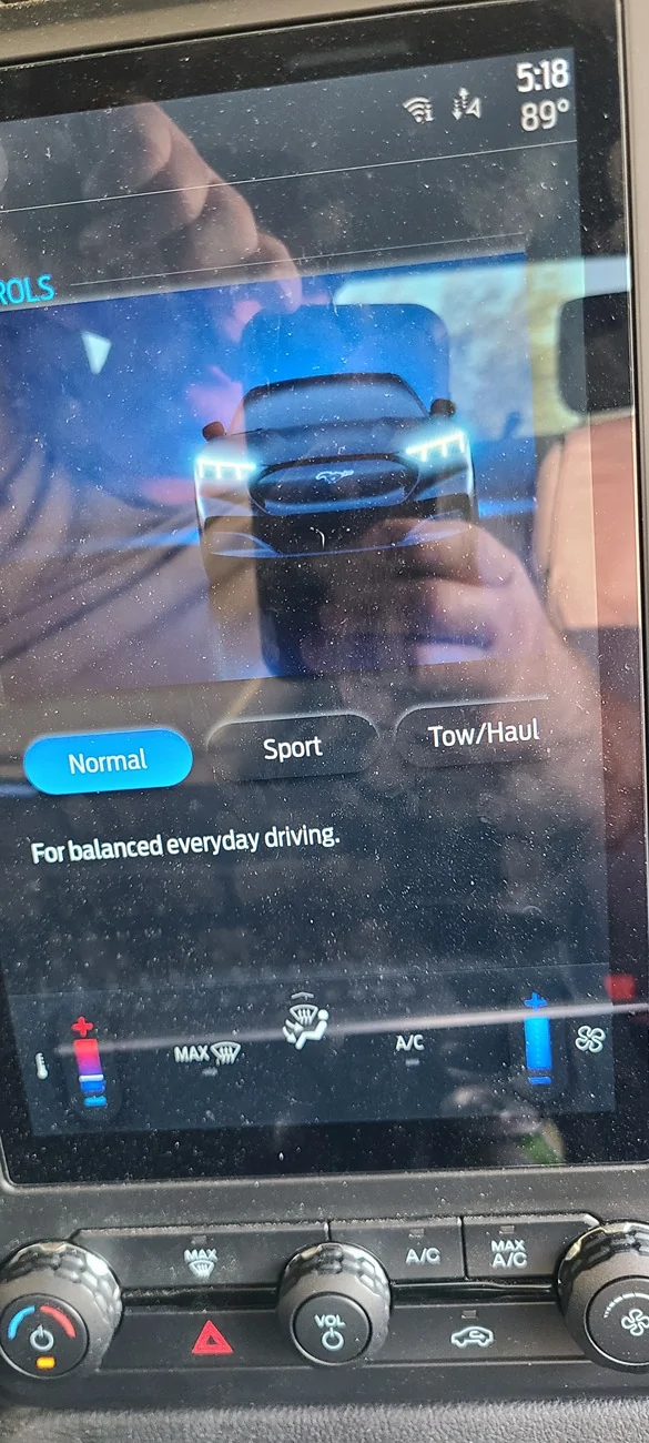

Ok, on those options, don't turn on selectable drive modes. It changes the center screen to a mustang screen and nothing on
that screen works.

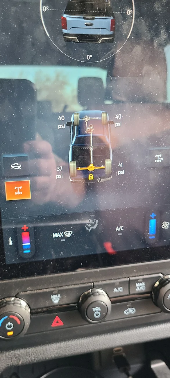

Off road menu turns on the buttons on the off road screen but only one button works on the screen. Hill descent turns on the hill descent slider in the center screen under the vehicle options.
Ford Ranger FORScan NA Ranger 6th Gen (2024+) Crowdsourced Spreadsheet 20260305_173902
Ford Ranger FORScan NA Ranger 6th Gen (2024+) Crowdsourced Spreadsheet 20260305_174034
Ford Ranger FORScan NA Ranger 6th Gen (2024+) Crowdsourced Spreadsheet 20260305_180514
