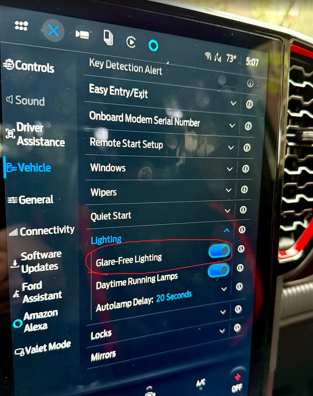

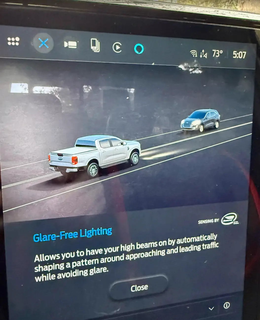

So now that I have FORScan up and running, I've been going through the spreadsheet and enabling/disabling items I wanted. I'll make a list here shortly. I do have a question about the glare-free/matrix headlights. I changed all of the modules per the spreadsheet but I don't see the option (shown by previous posts) in the center screen settings menu.
[edit] So after waiting a bit and restarting the truck, I noticed that I do indeed have an option w/ an info screen. It just doesn't look like what I'd seen before, with the option for LH or RH drive
Ford Ranger FORScan NA Ranger 6th Gen (2024+) Crowdsourced Spreadsheet rraptor_glare_free_lighting_1
Ford Ranger FORScan NA Ranger 6th Gen (2024+) Crowdsourced Spreadsheet rraptor_glare_free_lighting_2
