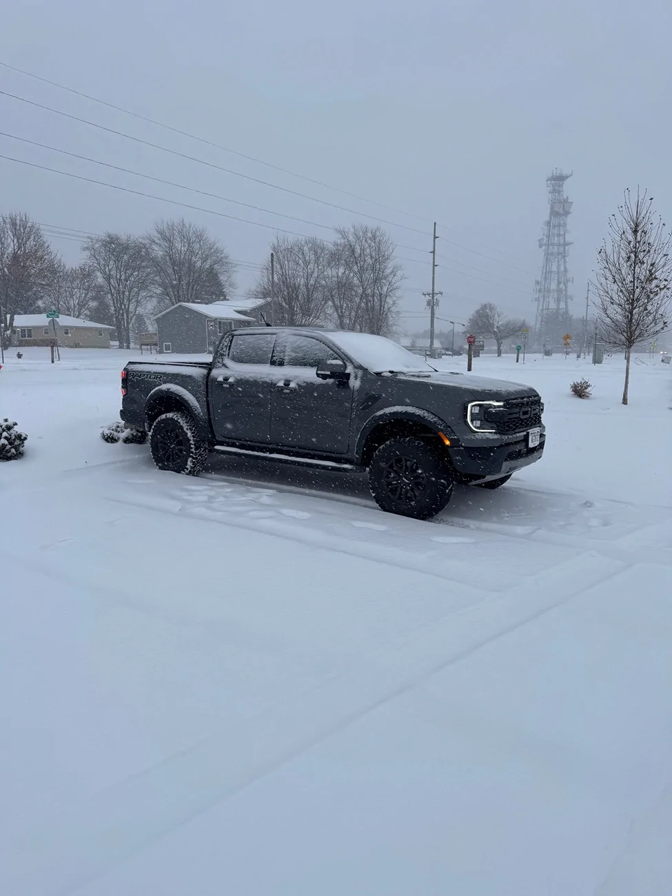

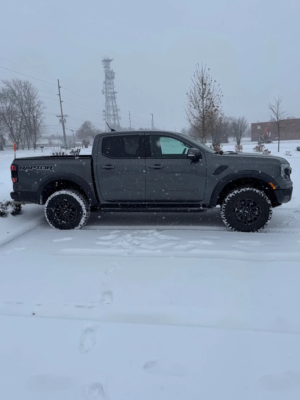

I did a 1.5" strut spacer up front. After everything was settled. I am at about 1.25-inch rack in the front. Measuring from my flat garage floor to the fender. Front 39.0" Rear 40.25"

Stock wheel set up? Any chance you could share some pictures of how it looks from the side?
