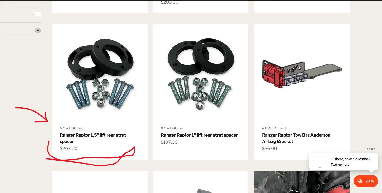

I'm not seeing an option to order 1.5" rear pucks on your site, just the 1" rears. How does someone order the 2/1.5 combo? Any gotchas with this, like how a 2.5" up front guarantees you'll need UCAs?
Thanks.
you clicked "shop all" at the bottom of the drop down?
