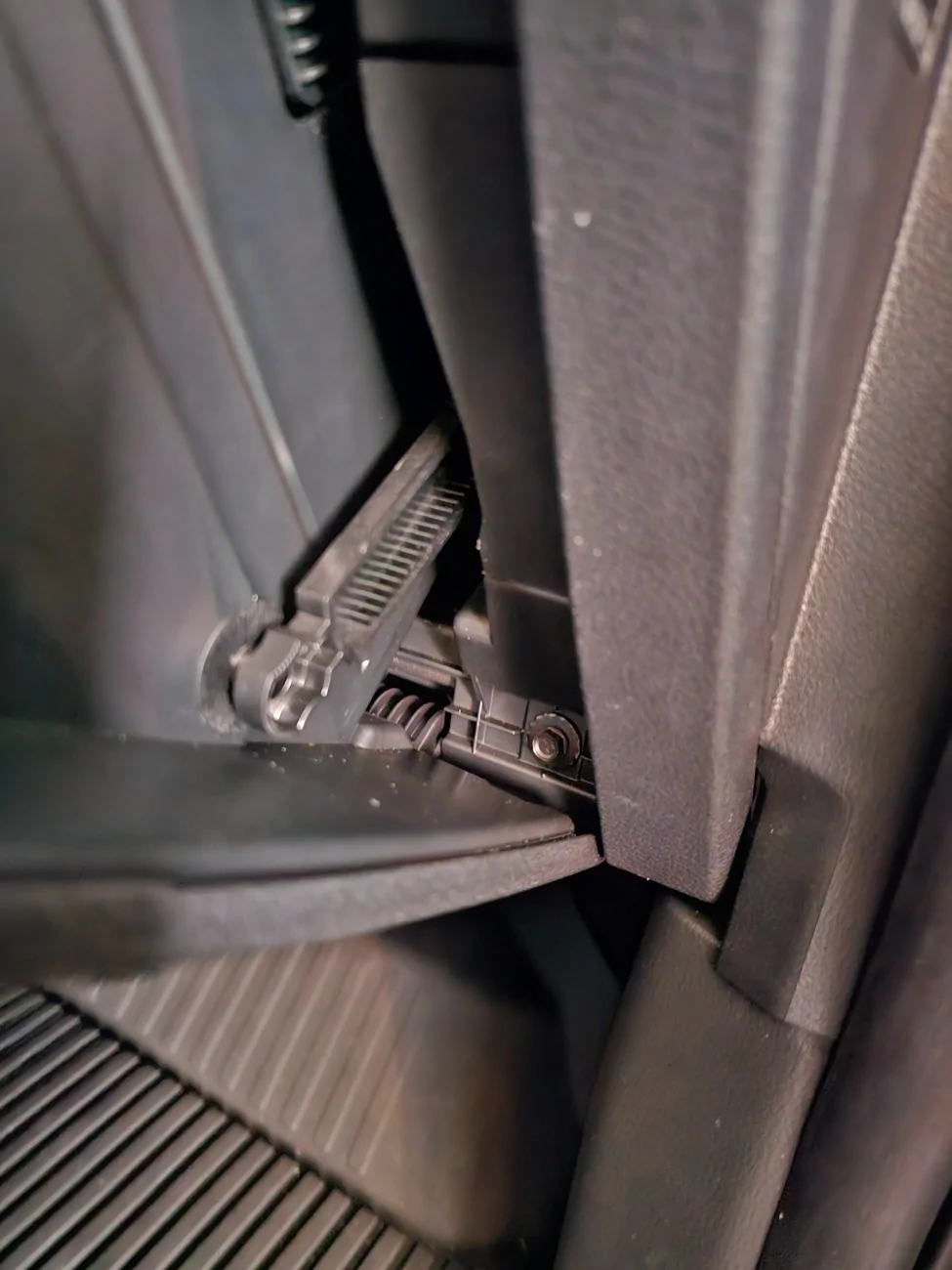

Fancied up my interior just a bit. Installed the soft open bracket from the Volkswagen Amarok in the glove box, took two minutes to install and prevents the box from just dropping open.
Volkswagen P/N: 5G1-858-309

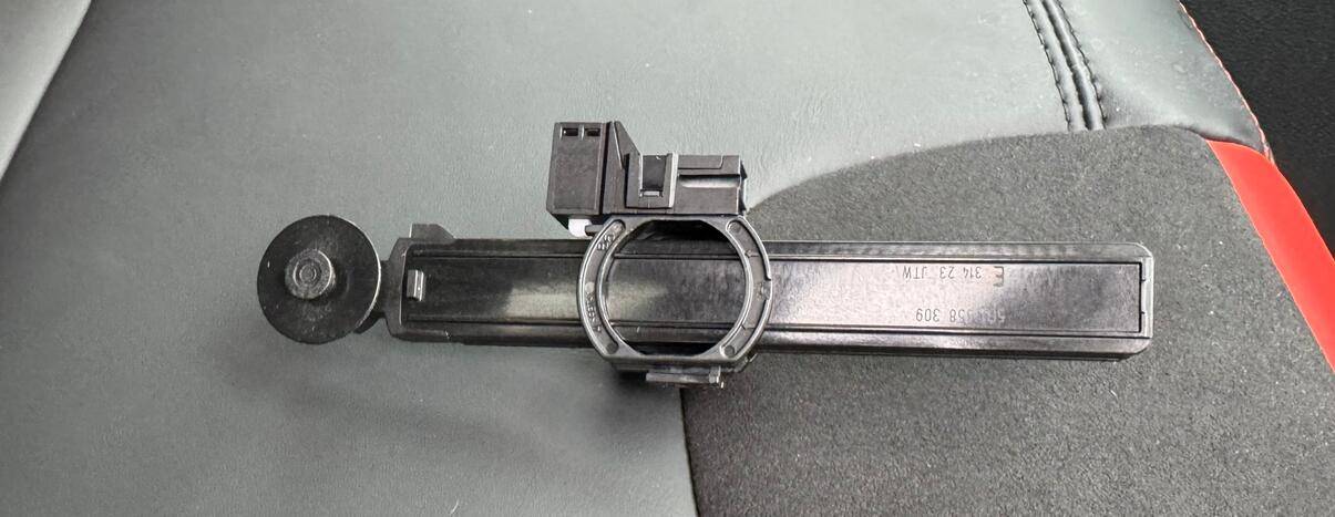

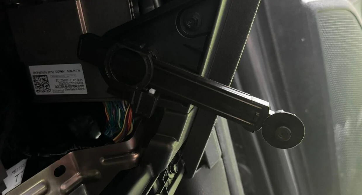

Hello everyone, I only understood half of this video I found on YouTube, but if you’re interested, my local dealer told me this is a VW sourced part. P/N F5G1858309 for all next-gen global Rangers. AliExpress sells these for cheap, so I decided to give it a try and I'm quite happy with it. It might be a minor change, but it adds a "luxurious feel" that my F150 had when I opened the glovebox ?
This is great! Also ordered one from ebay, $12. Appreciate this, it's the little things. :)
