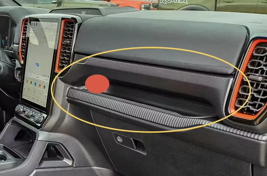

Hi, sorry if this a duplicate, how is this 2024 RR panel held in place? Does it use snap pins? Are their other hidden screws?
I want to make a 3D printed USB power supply bracket to go where the red circle is shown, it would be way easier if I could simply pop the entire shelf out. Plus I could more easily route a power cable with it removed.
Please advise, pictures would be much appreciated! If anyone can provide the part number, I could look up an exploded Ford parts diagram.

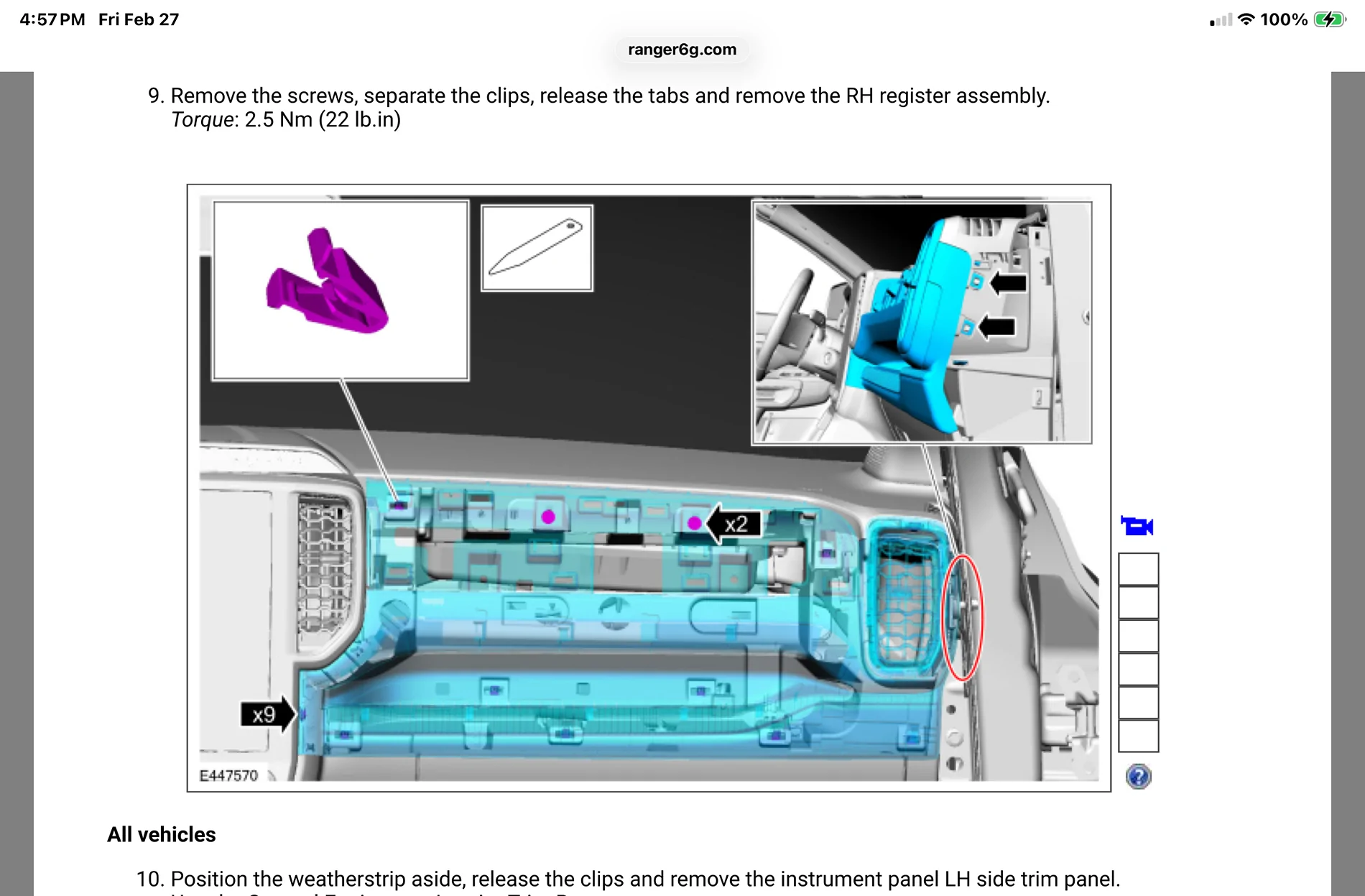

this is for removing the radio. but you dont need to go that far. bought the 72hr access ro the ford stuff over at www.motorcraftservice.com the factory service manual. wiring diagrams, etc, and tsb's etc

Zowee, that looks fairly quick and easy, thank you so much! I will post some pics in this thread or a new one later.

For what it's worth I took a look at mine.
With an inspection mirror looking up from below there are clip tabs visible.
Gently prying up on the "rubber" liner, I can see the tabs going thru holes in the plastic beneath. It appears to simply snap in place/ pry off. I would use a plastic stick or a small flat screwdriver and gently go for it. It is soft so it seems unlikely you would break it.
Edit: I didn't realize you wanted to remove the whole thing! I was thinking just the liner....
