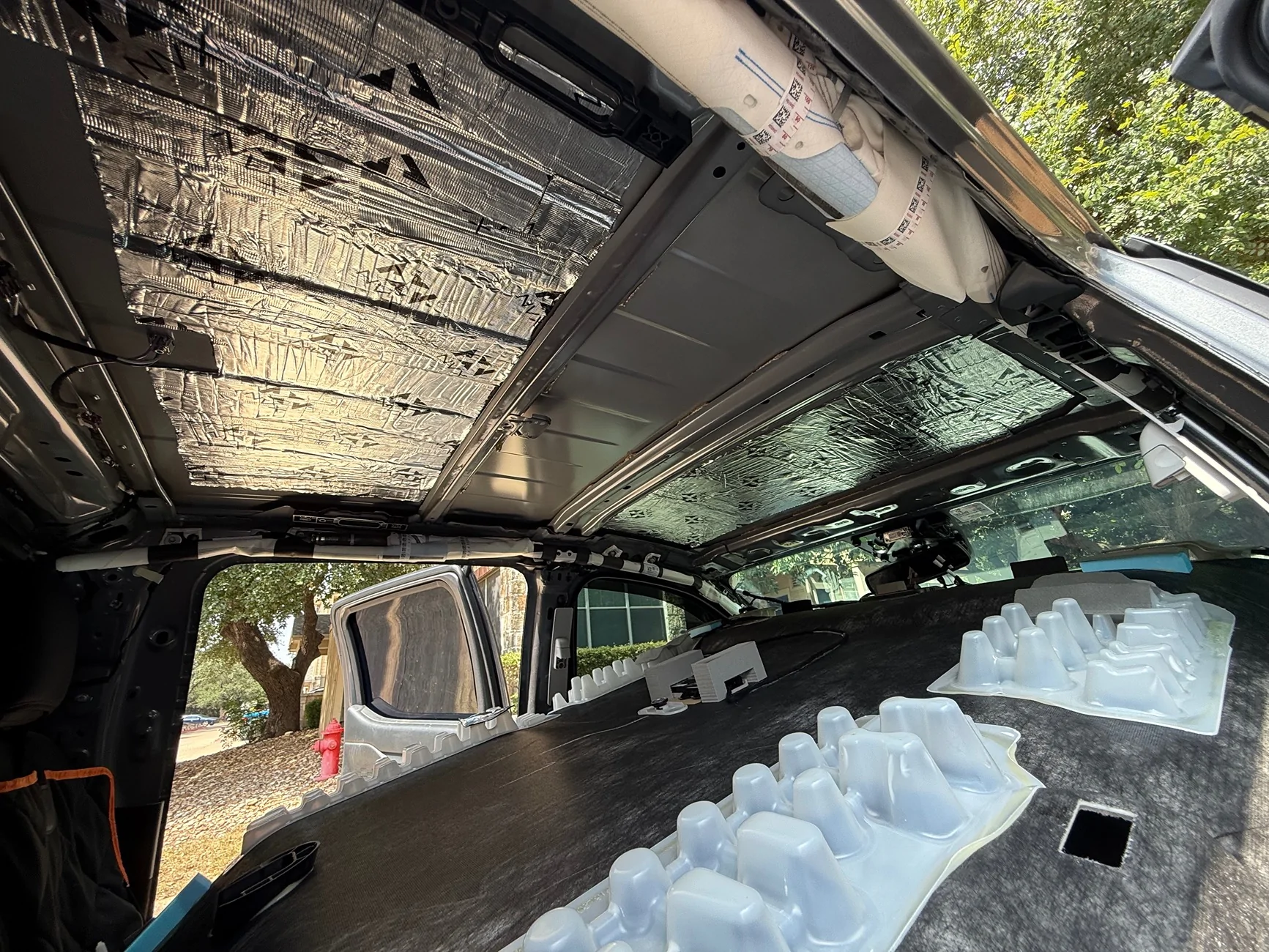

sound deadening the roof of my non raptor did wonders (my doors are fully deadened and resonix black mat on the panels)
12sqft on the roof with 1" Resonix Black Mat acoustic fiber to fill the voids of the open area.

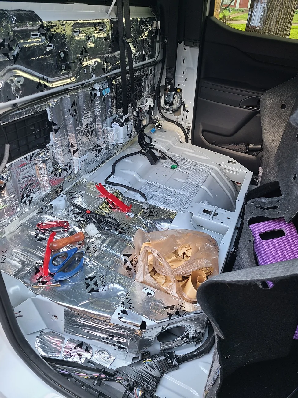

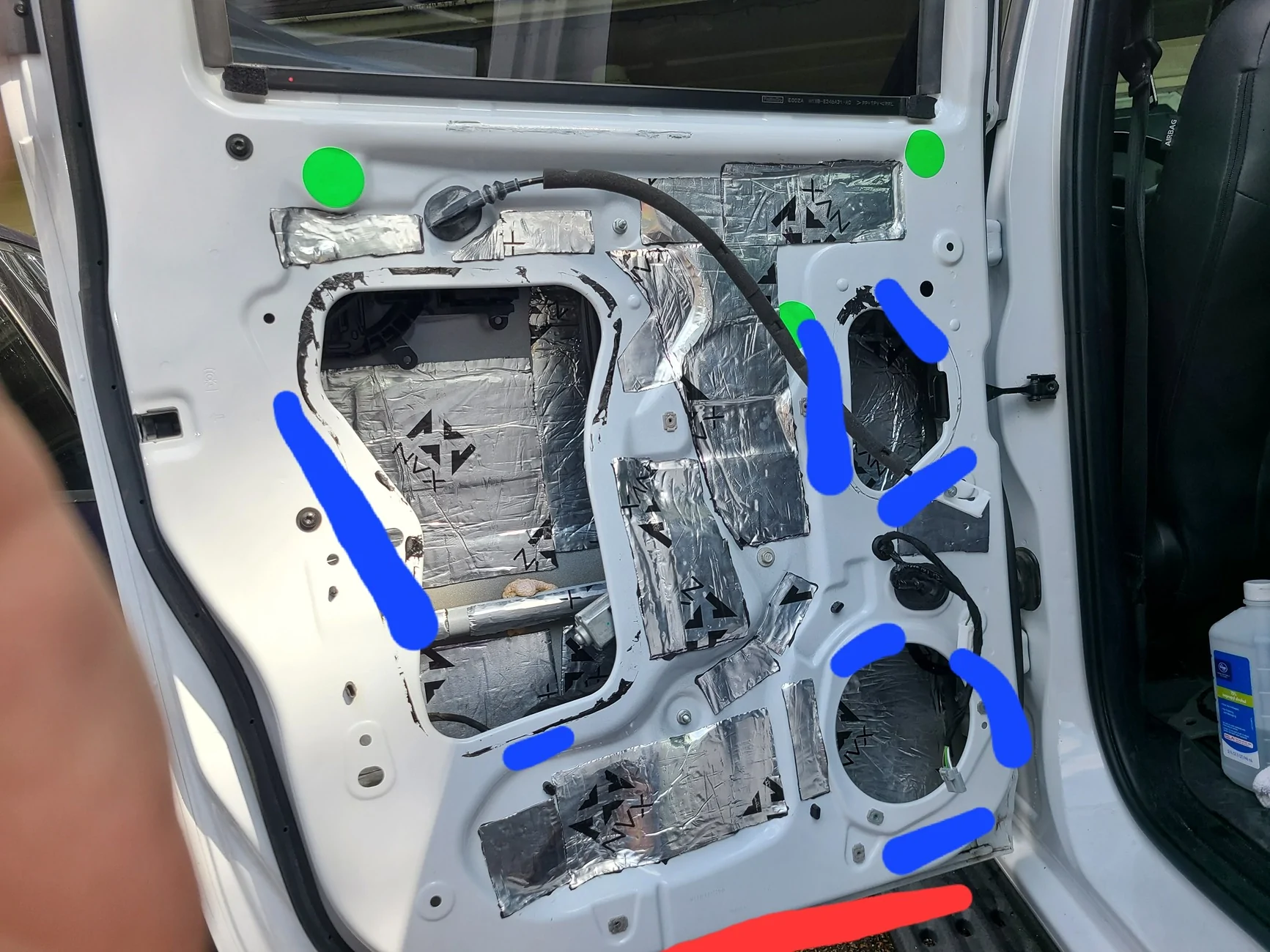

I installed CLD (NVX) and absorber (Thinsulate batts and Resonix) this past spring. Even posted these pictures on here too help others with their installs. Only thing not done is the floor, firewall, and wheel wells.
