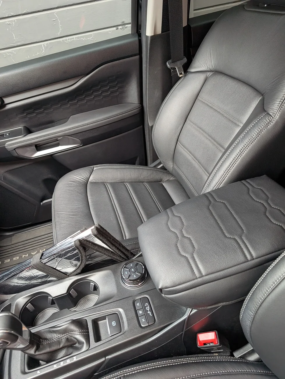

Find a local upholstery company that uses Katzkin leather seats. I have the same truck and the dealer had mine sent out. I paid 2k for the seats and install. I have driven to Washington and back to cali without any backpain, sit bone pain.
I know you said no leather but I am telling you i had no pain!! Could you find some seat covers that go over your cloth seats that add extra padding? Sure..but I have not tested those out..
Katzkins are Def worth it!
To add to this. They tear your cloth out and install leather. Heated seats still work as normal with leather.

katskinz will not improve the seat if its bothering you. They only change the fabric has nothing to do with the shape of the seat which is the actual problem. The problem for me is the seat tapers back to much and the side bolstering creates way to much pressure on the back of my Hamstrings. I’m hoping to eventually try and swap in an F150 seat, Mustang seat or see if an upholstery place can create a new bottom cushion and match the fabric to look similar to stock
