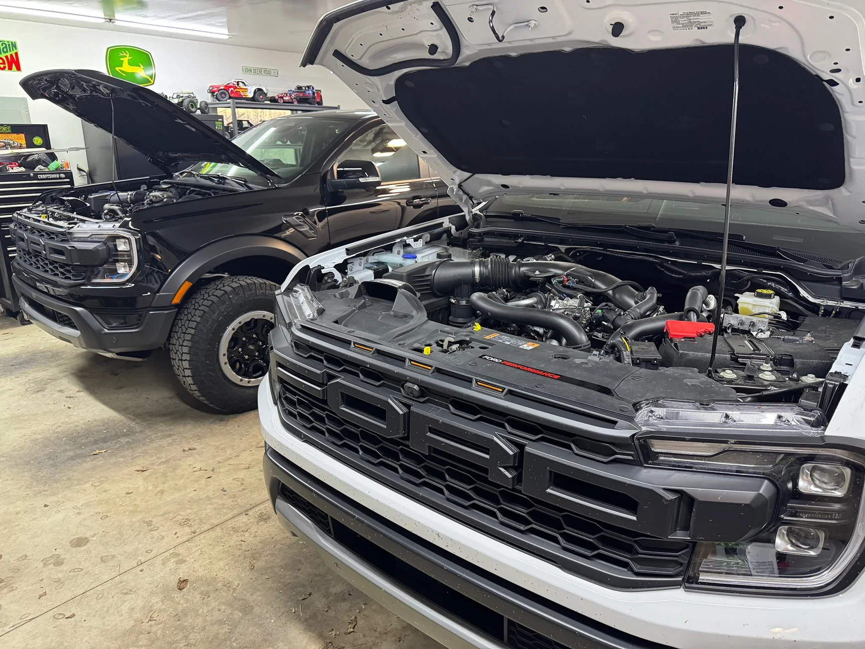

I had hoods up on two of mine tonight.
Yea, have to drop them from from 12-18“s typically gets it latched 1st time.
True, Closing it lightly doesn’t seem to work.
