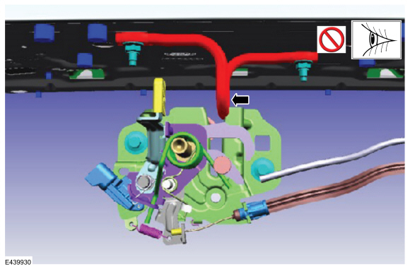

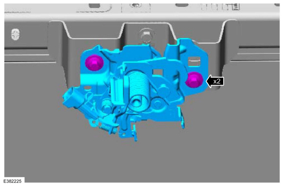

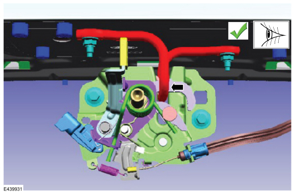

Service Procedure
1. Open the hood.
2. Adjust the bump stop rubbers located on the hood assembly by turning the bump stop rubbers clockwise until the bump stop rubber is fully wound in to the hood inner panel.
3. Once the bump stop rubbers are wound in all the way, turn the bump stop rubbers counter clockwise 3.25 turns.
4. Open the hood and hold it 12-13 inches (304-330 mm) above the latch and drop the hood. Did the hood latch easily?
(1). Yes - repair is complete.
(2). No - proceed to Step 5.
5. Remove the radiator sight shield. Refer to WSM, Section 501-14.
6. Loosen the latch attachment bolts (Figure 3) and align the latch so it is centered to the hood striker. (Figures 1-2)
Figure 1
Ford Ranger Hood Latch Fix! [Official TSB Fix Added] {filename}
Figure 2
Figure 3
