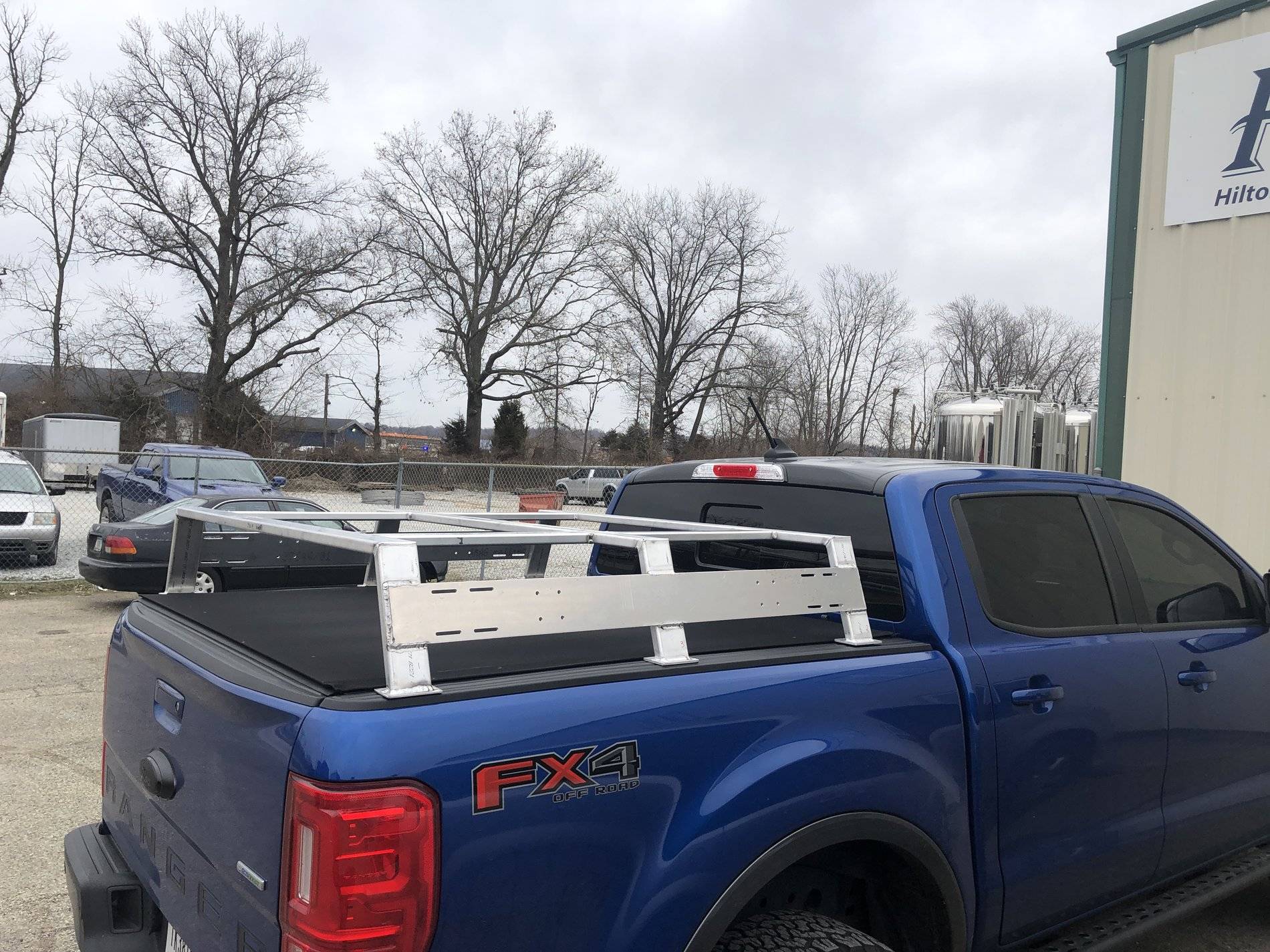

FINALLY got my rack. Now to paint it black this weekend. I’ll post up more pics once it’s done and I get my RTT mounted on it. Here she is all naked.

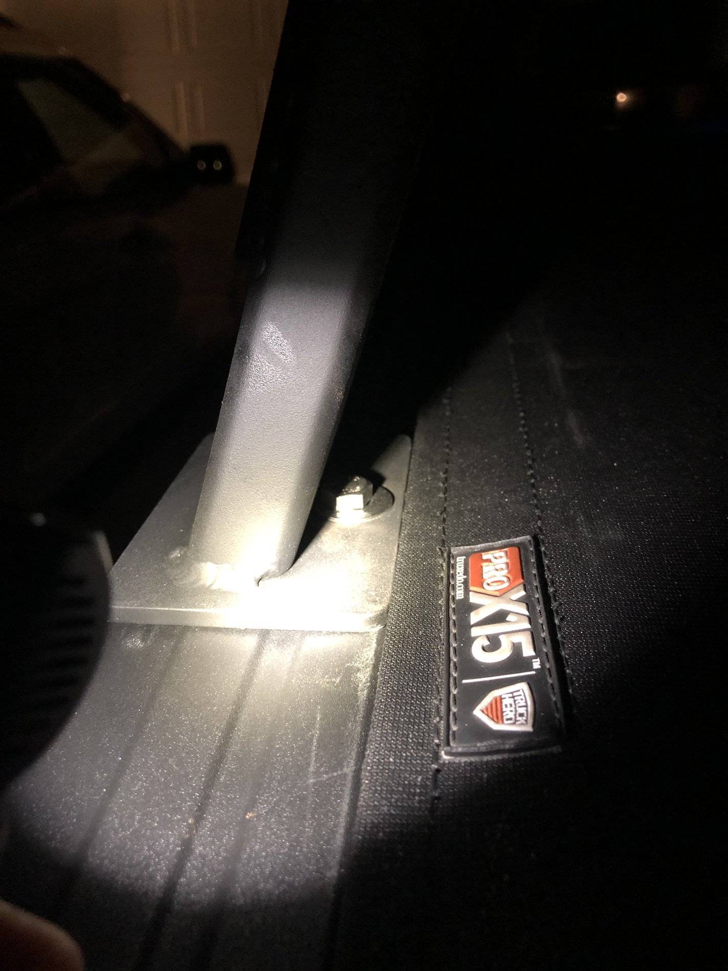

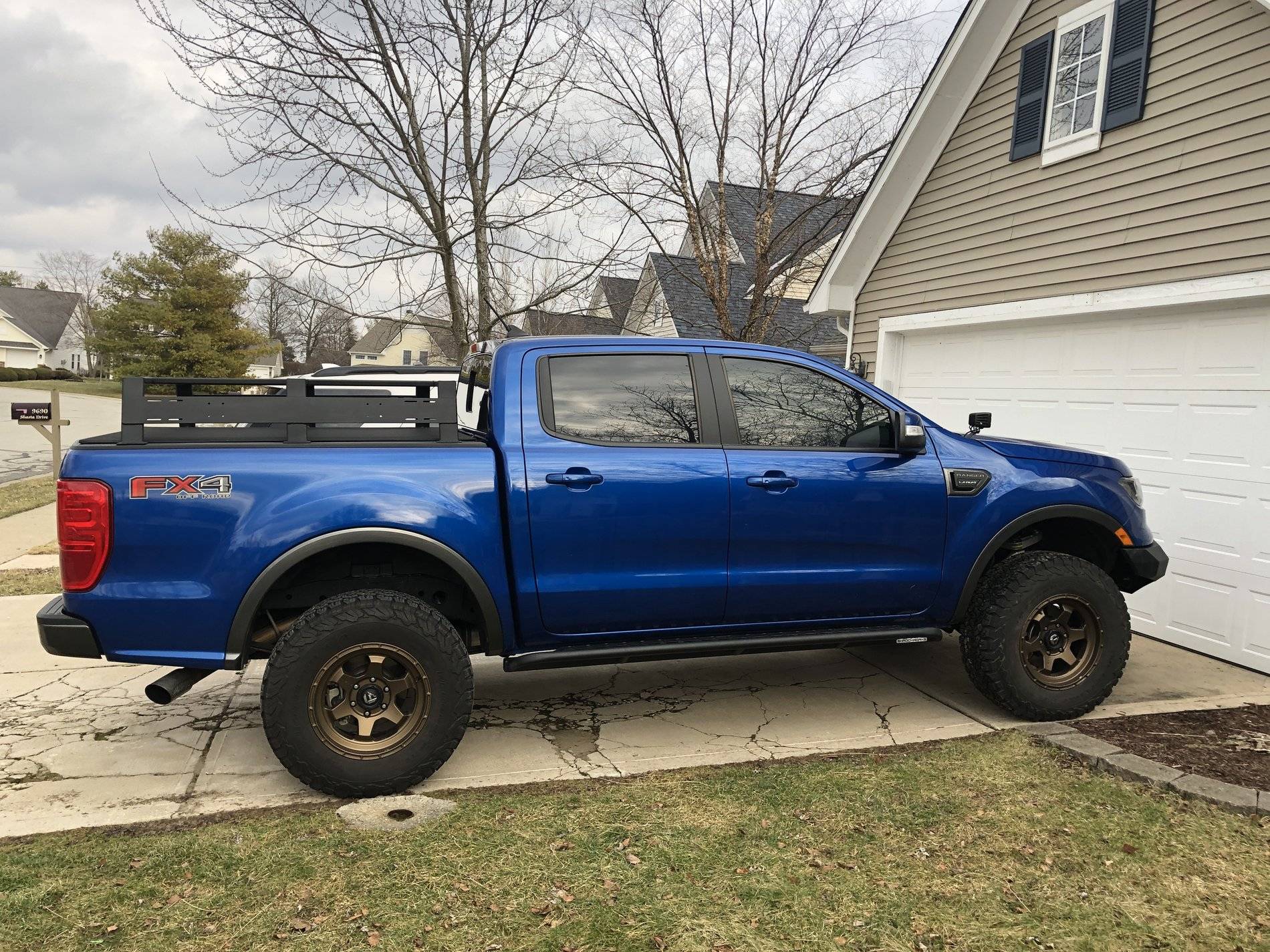

Finally got the rack painted and put on. Only slightly intimidating drilling six holes through my bed rails but it’s done.

Hi Tyler,
Did you back up the bolts on the underside with anything larger than a lock washer? If so, please consider using a fender washer of good thickness.. This backs up the attachment and spreads the load on the box rail over a larger area of the sheetmetal.

Hi Phil,
Yes I did use a fender washer underneath. I used the largest diameter that would fit in the ~1” space. That is only temporary as I actually plan to use some aluminum bar in its place in the near future. I’ll likely use a 3” long section for each bolt so that I have a full 3 sq in of load distribution for each bolt which matches the 3” width on the aluminum tubing that makes up the rack itself.

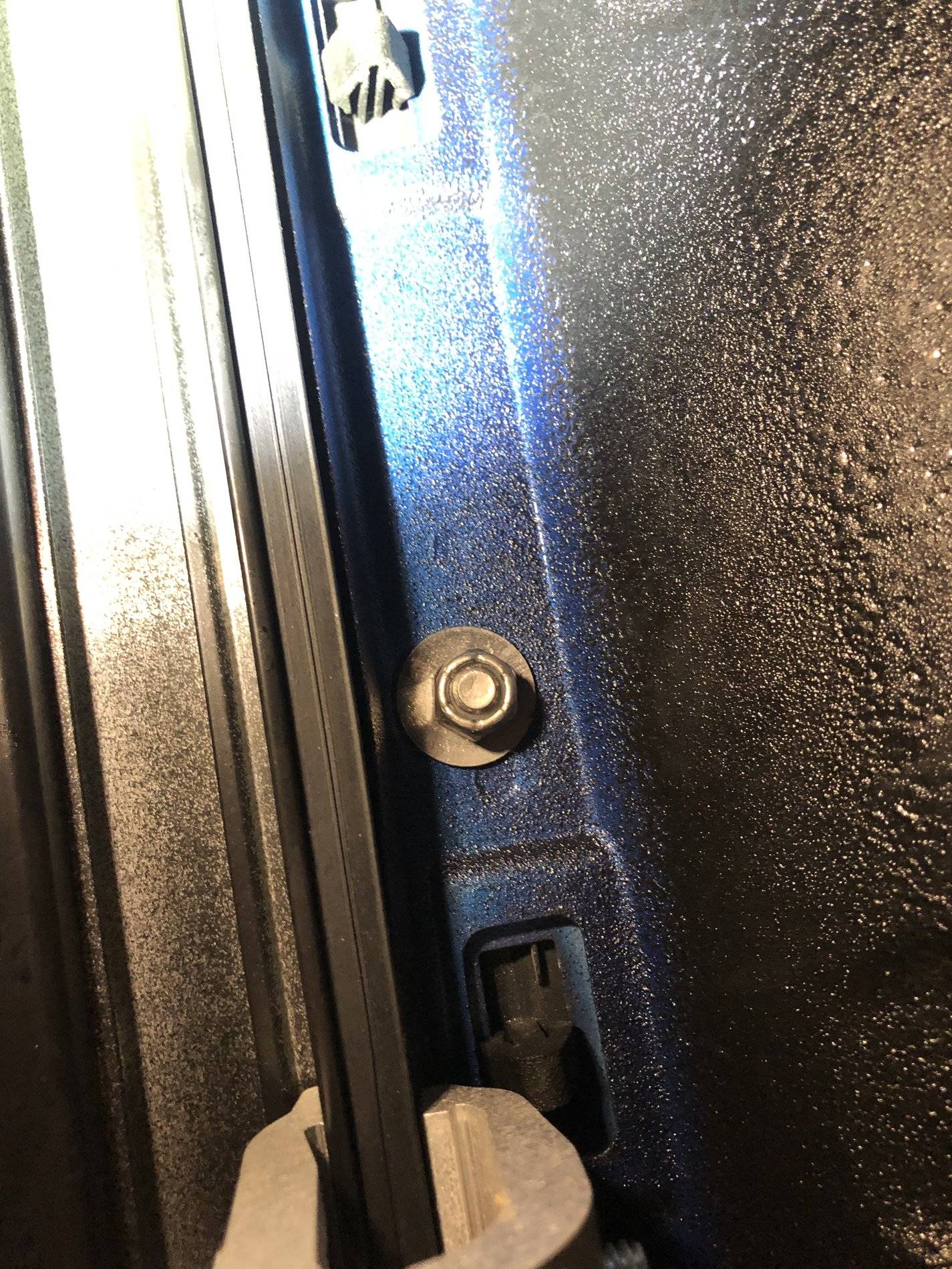

It’s dark but I grabbed a pic of both the top and bottom. You’ll see that if I use a bar and drill my own holes off center, I can actually go a tad wider than what the washers allowed.

Hi Tyler,
Great! Looks good...the aluminum plate will be better but you have done a great job in thinking ahead!:thumbsup:
