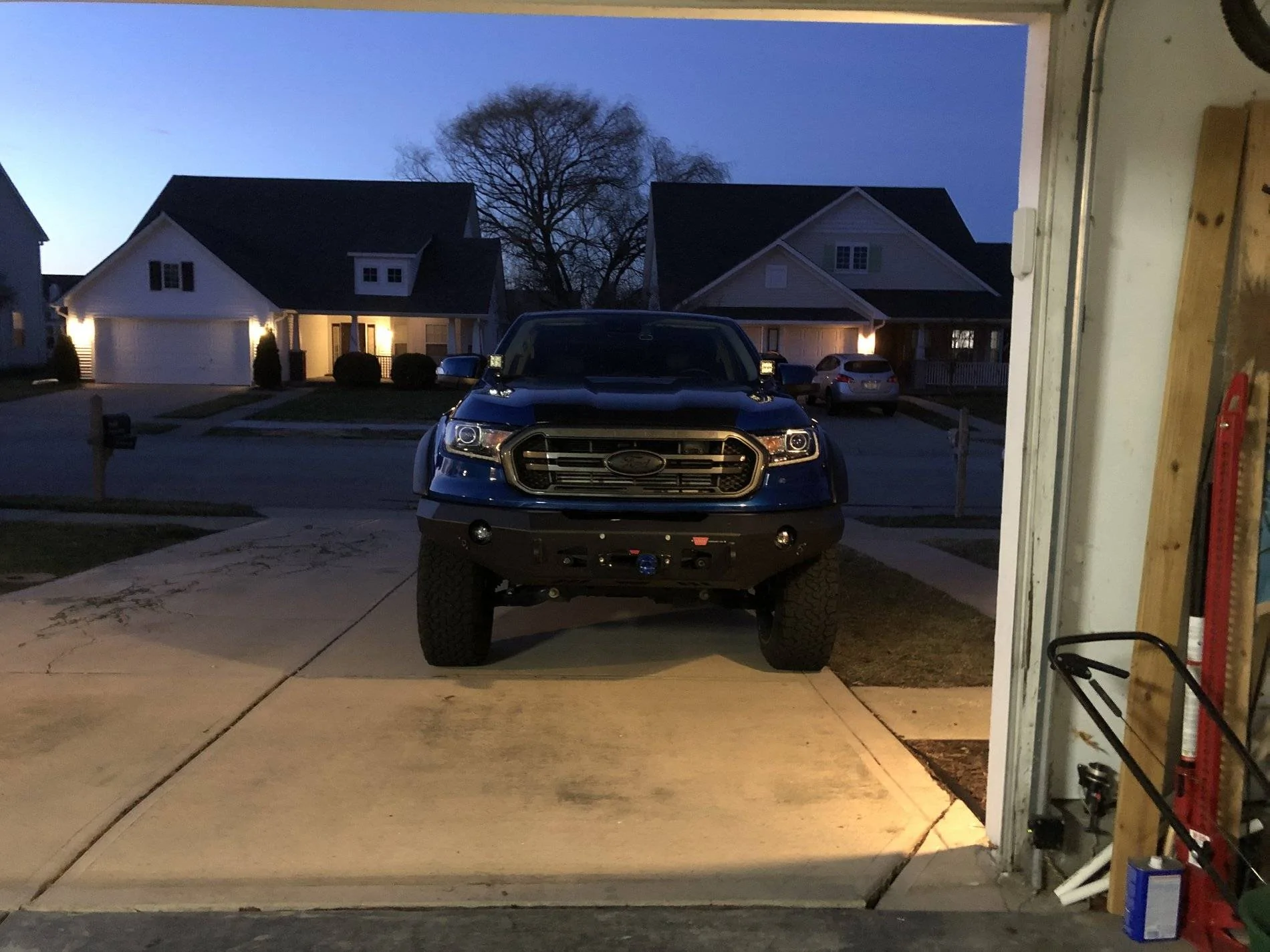

Also, yes it clears my garage door by about an inch...:whew:

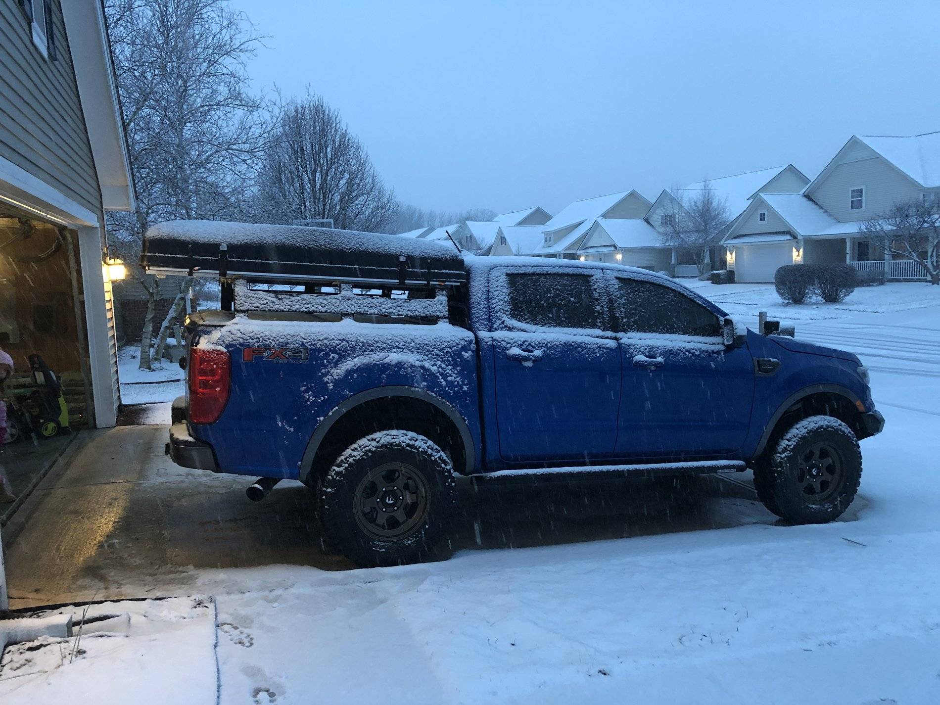

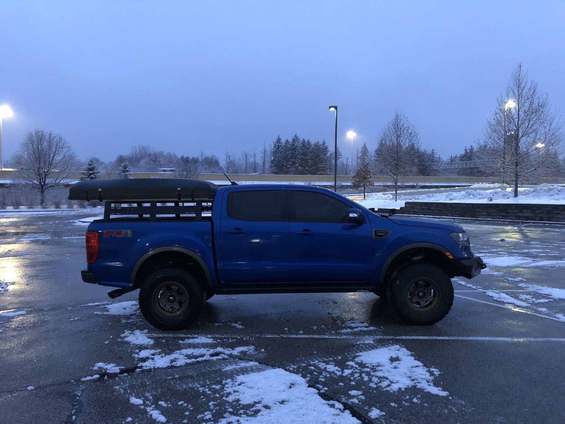

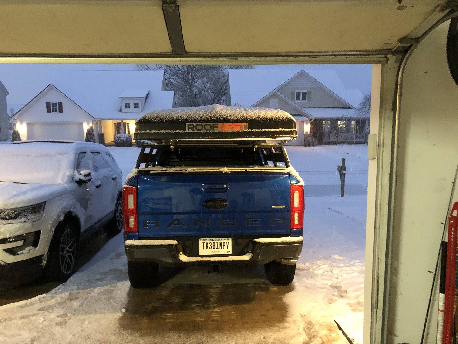

My truck sits about the same height as yours, as I am running the same ICON Stage 2 suspension dialed in at about 2.5” lift, 1” rear blocks, and slightly shorter tires (255/75/17 BFGs). I am interested in whether a RTT setup will clear my garage door (height) once I install a Diamondback HD cover (about 3” higher than bed rails), front runner bed rack posts and load bars (adds about 10” height), and IKamper Mini RTT (adds 13” height).
How tall is your RTT ?
How tall is your Bed Rack (from top of bed rail)?
What height/opening is your garage door?
Thanks in advance for feedback!

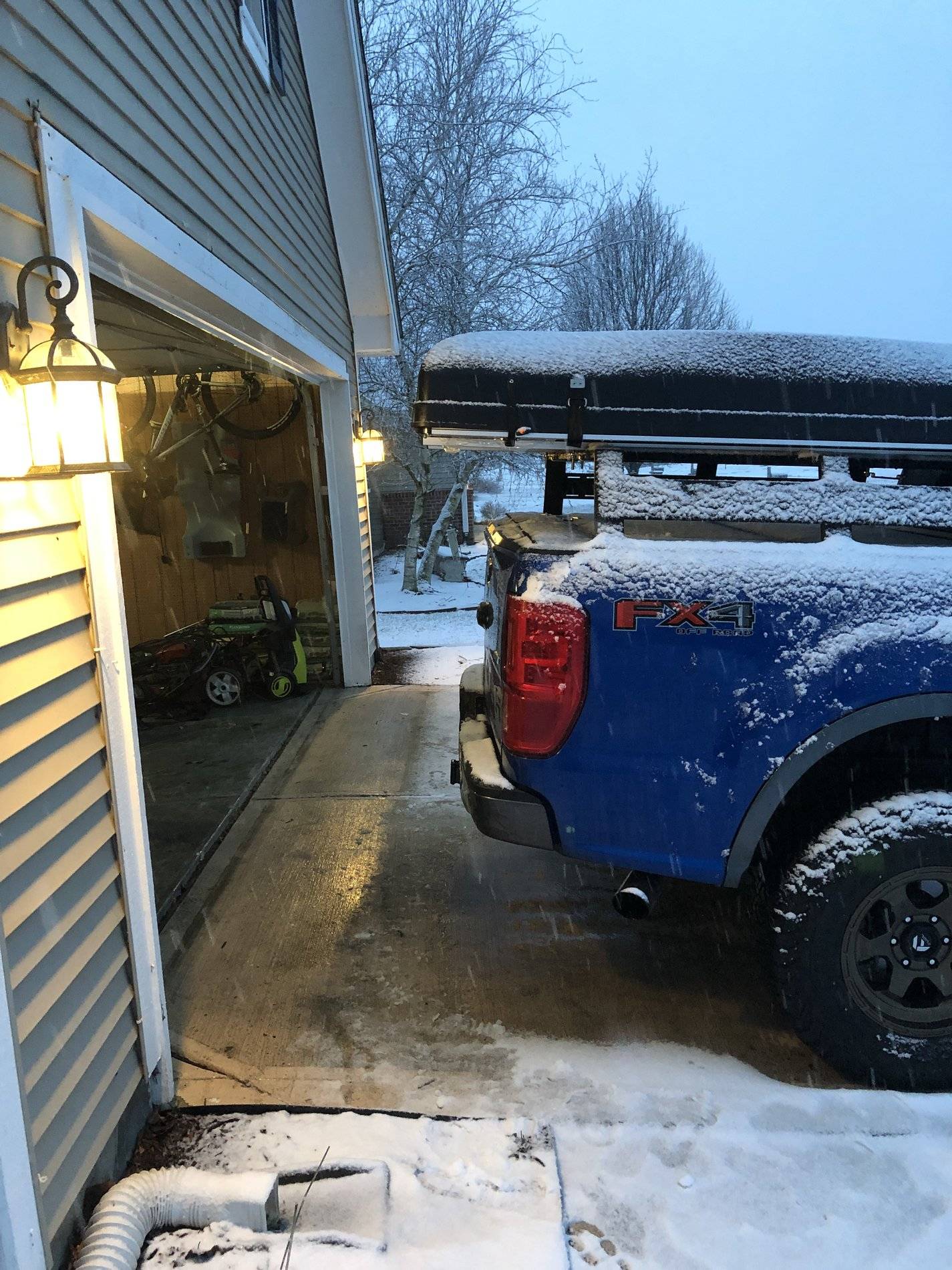

Np at all.
7’ garage door
Bed rack is 10” tall off the bed rails
Tent is 14” tall.
You should be fine I think.

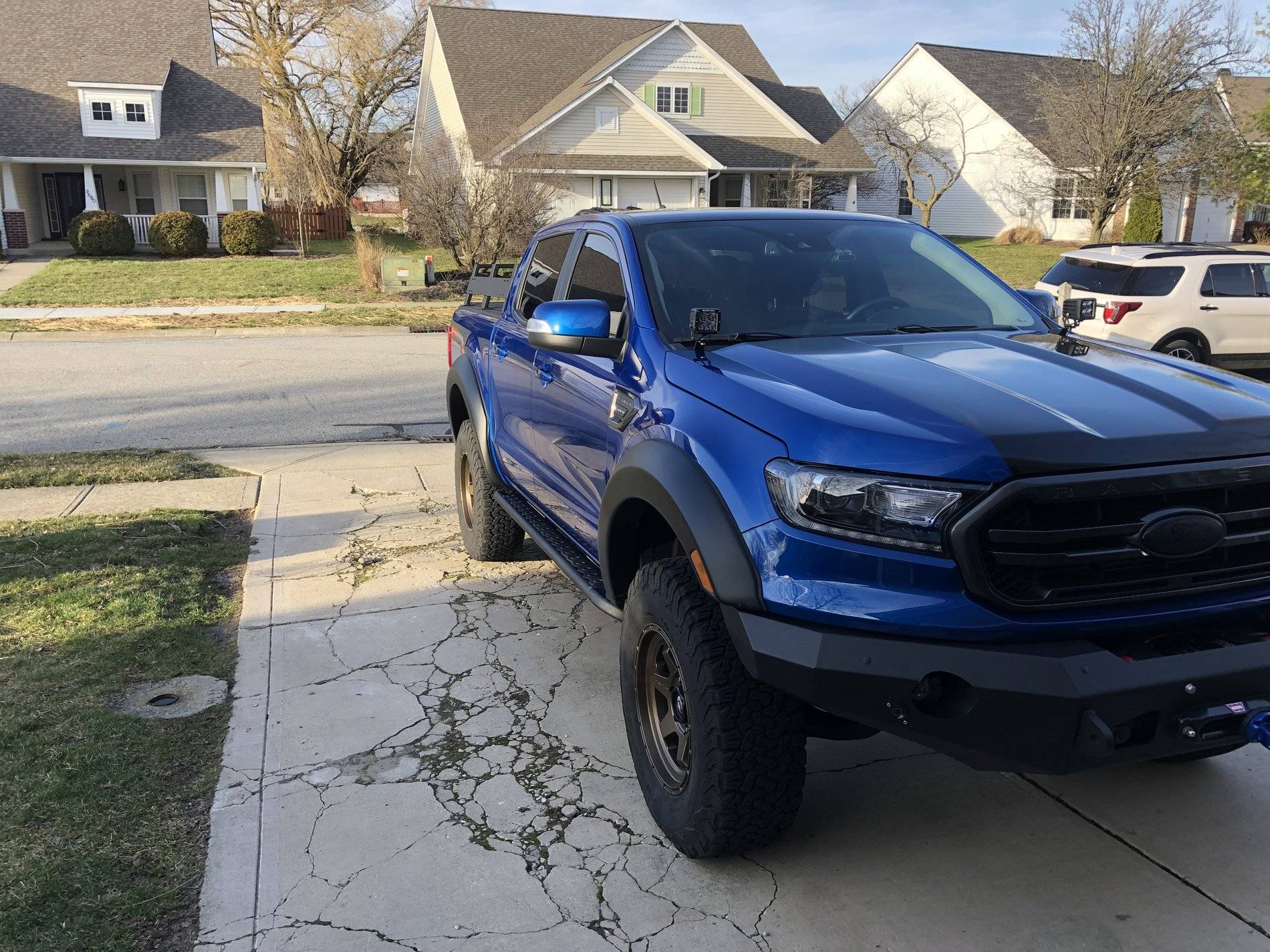

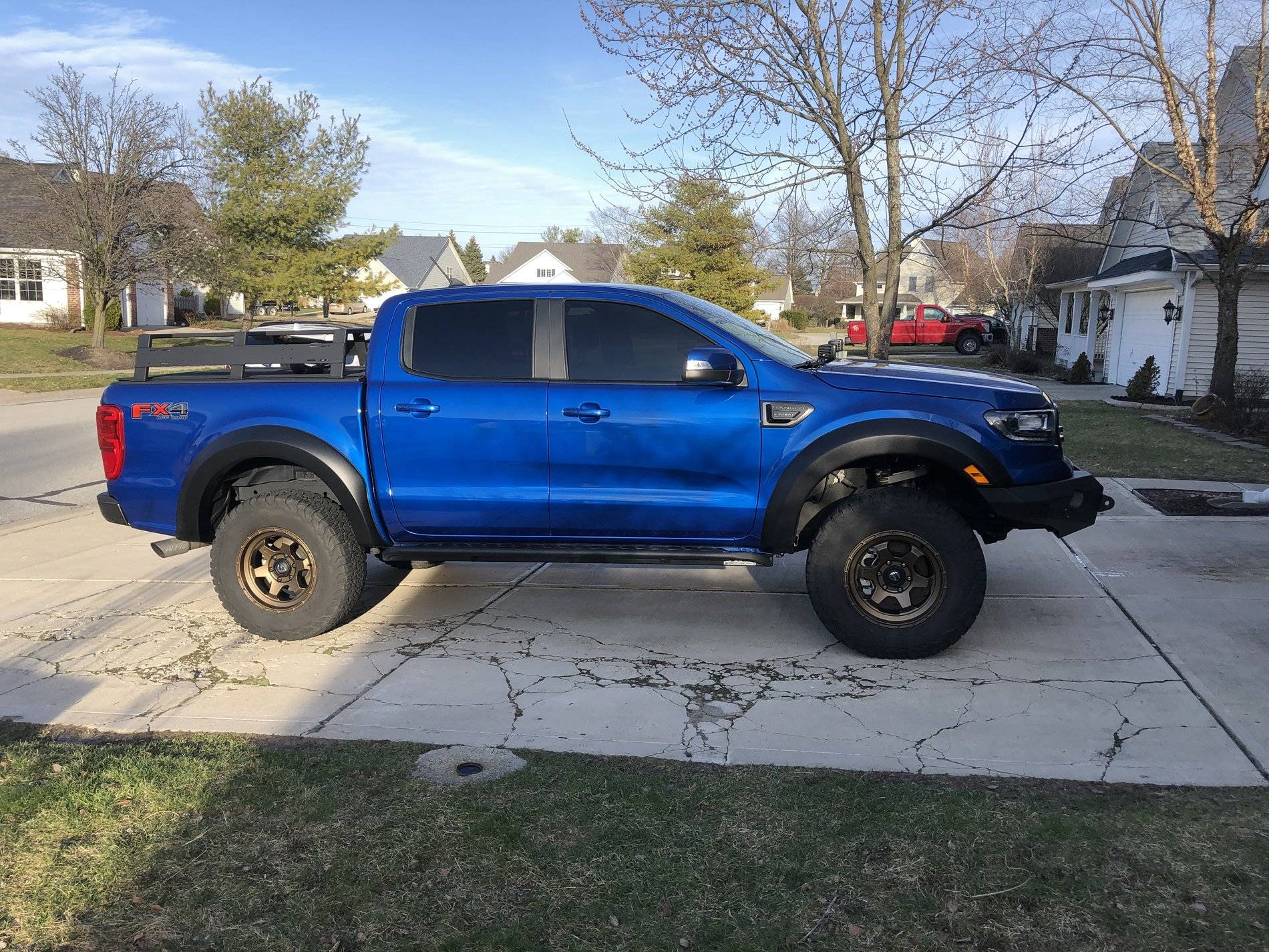

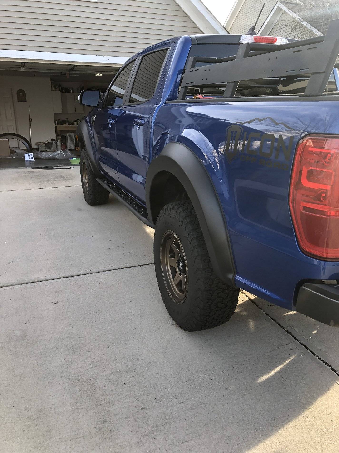

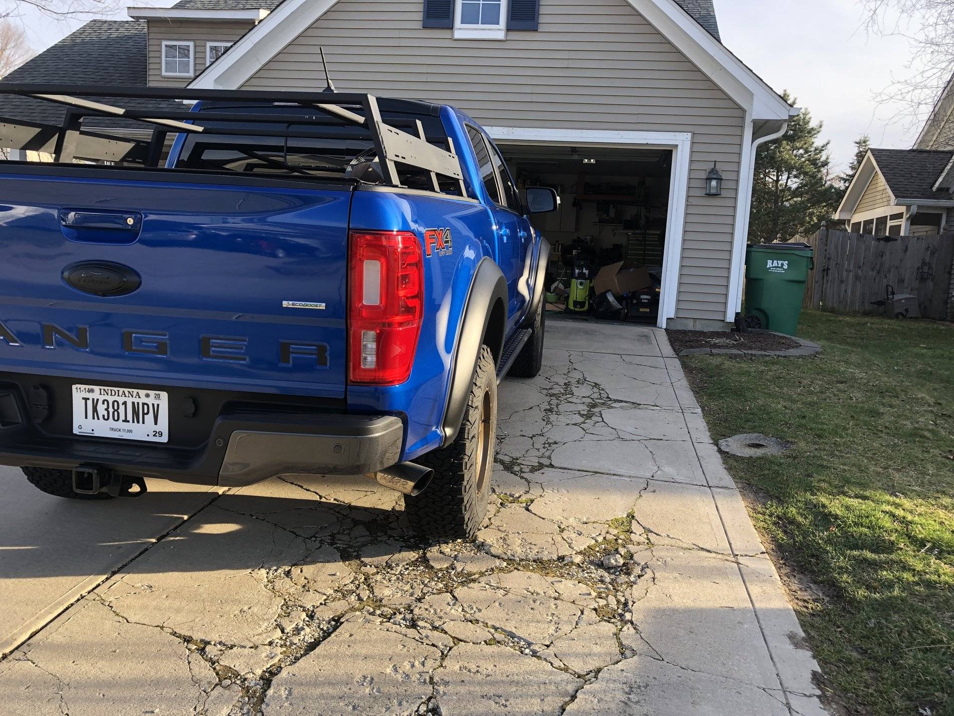

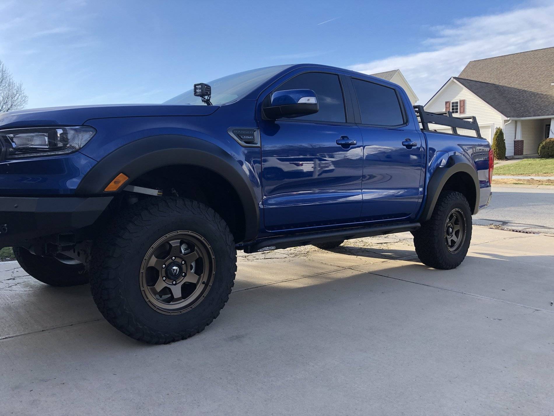

So I used my points and ordered Lund Sport flares through the dealership. However, I ended up receiving bushwhacker extended flares. But what I got was the ones withOUT the fake bolt on which is good because it not a fan of those. So...I stared at them for a bit and decided I might actually like them. What do you think?

Dr. Zaius
Dec 20, 2019
154
GA
2019 Ranger
Now your wheels need to stick out farther :D
Aren't you running 285's?
Those flares almost make them look small.
Lol yea 285’s. I don’t want them to stick further, I had to get these because I was getting rock chips without them and I don’t like mud flaps.
