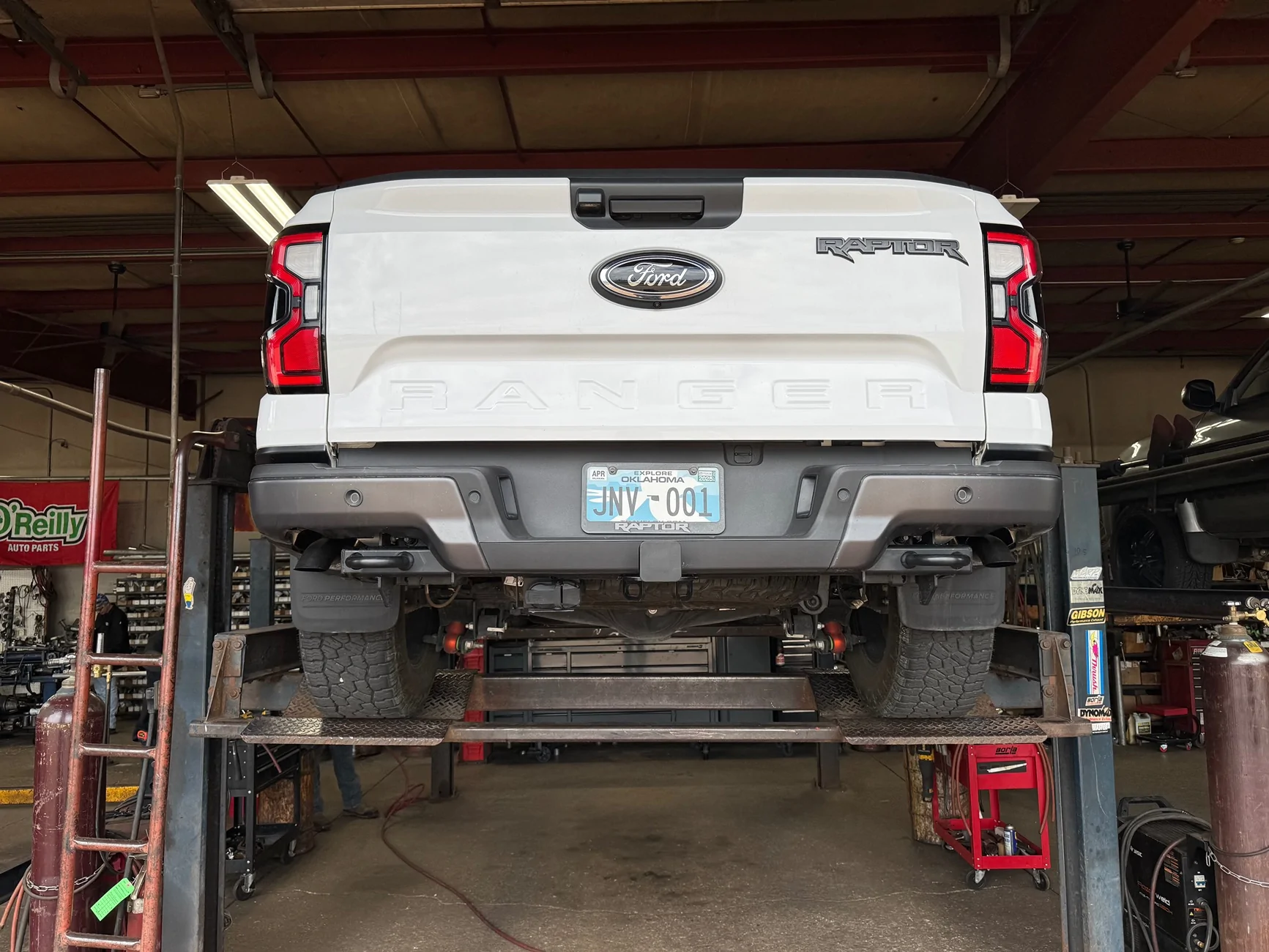

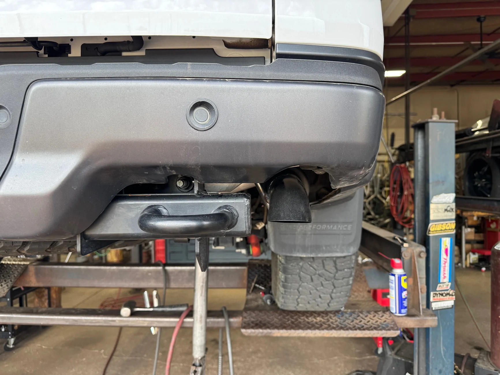

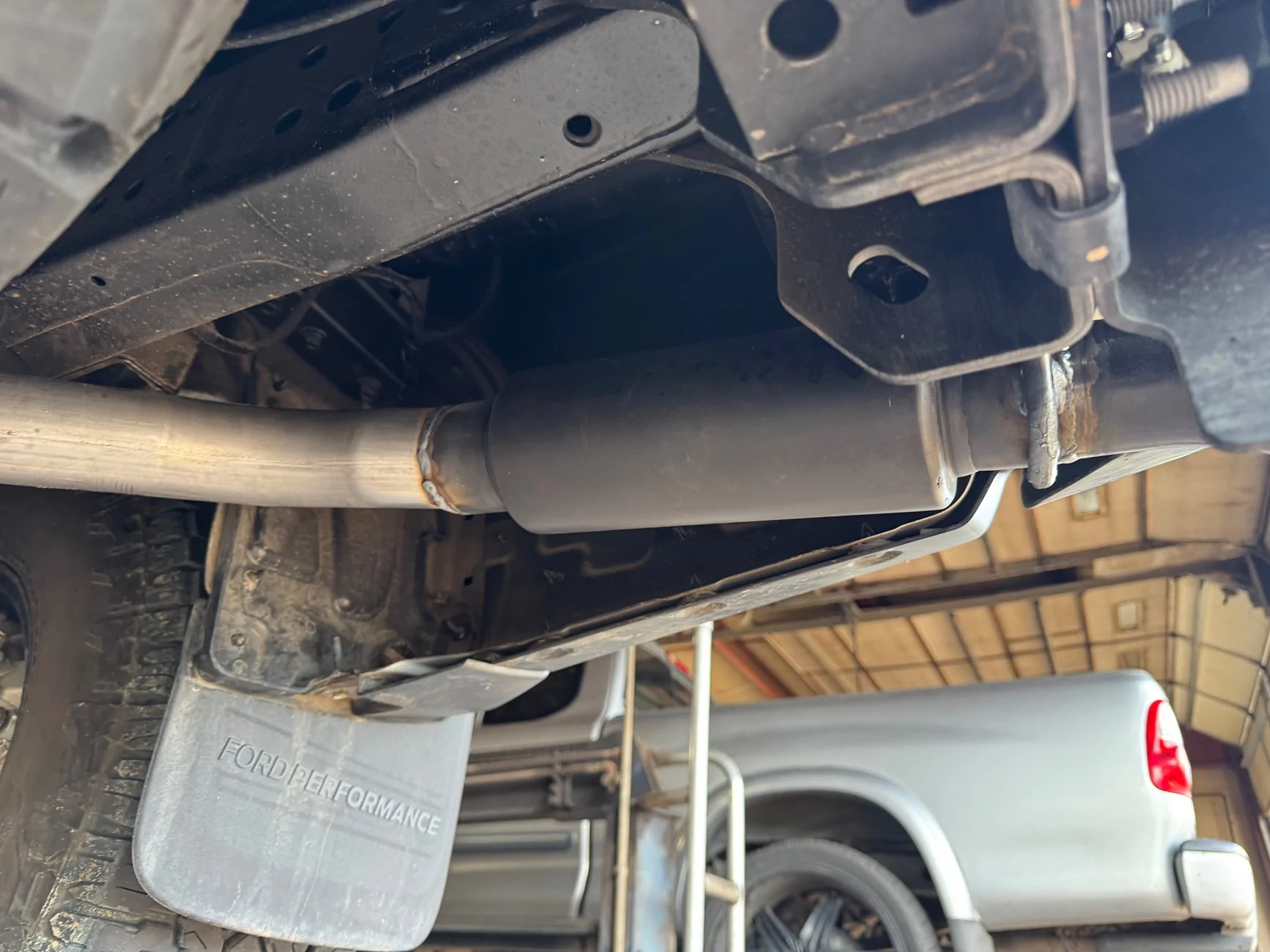

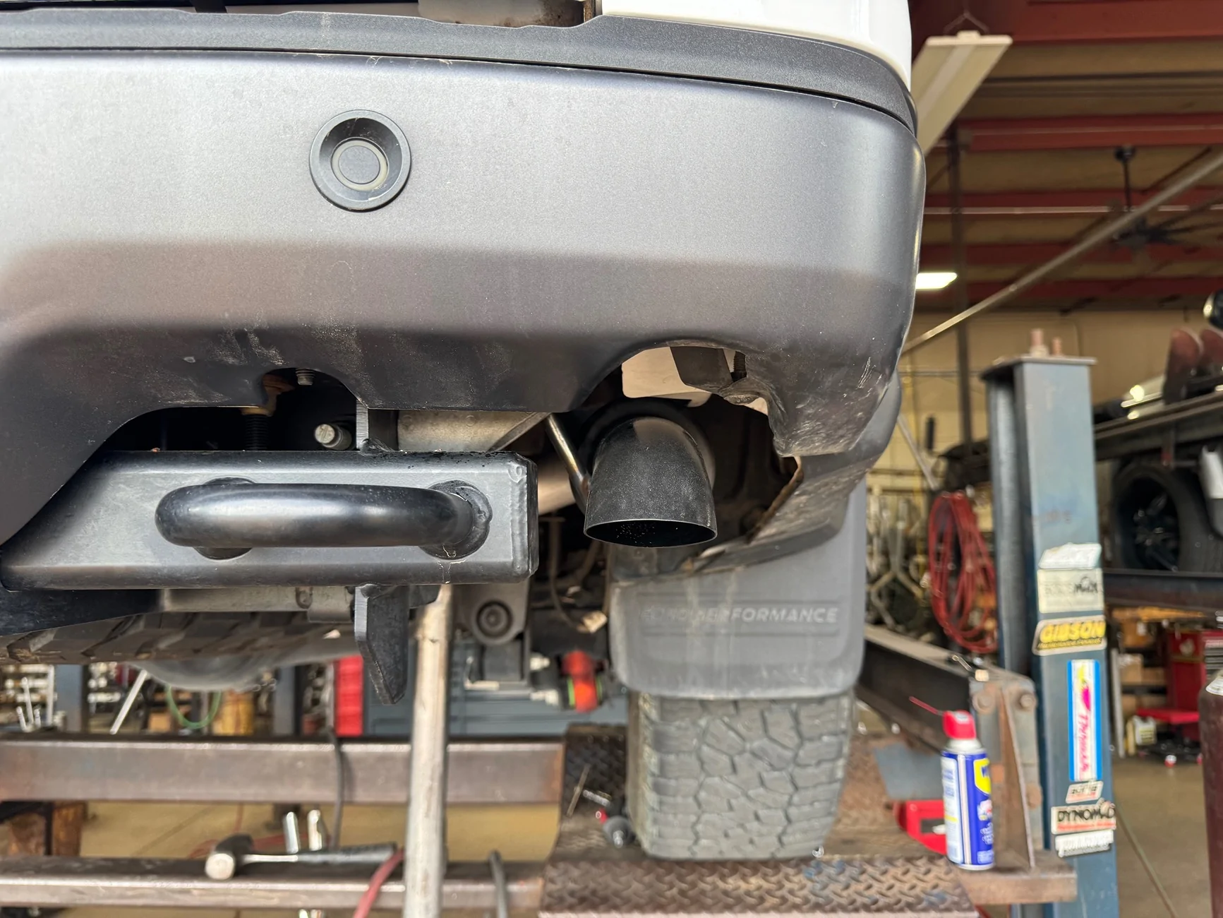

Right side done !
Ford Ranger I want a QUIET exhaust IMG_5658
Ford Ranger I want a QUIET exhaust IMG_5659
Ford Ranger I want a QUIET exhaust IMG_5660
Ford Ranger I want a QUIET exhaust IMG_5661

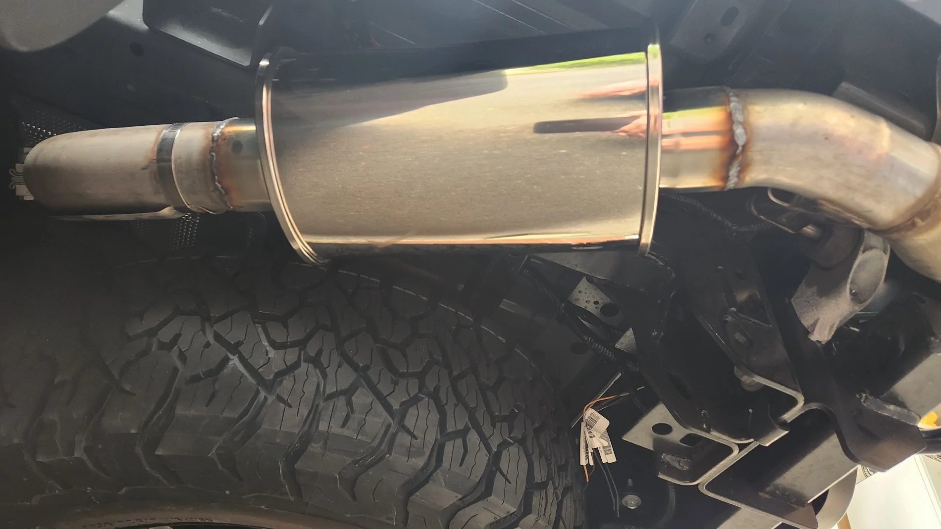

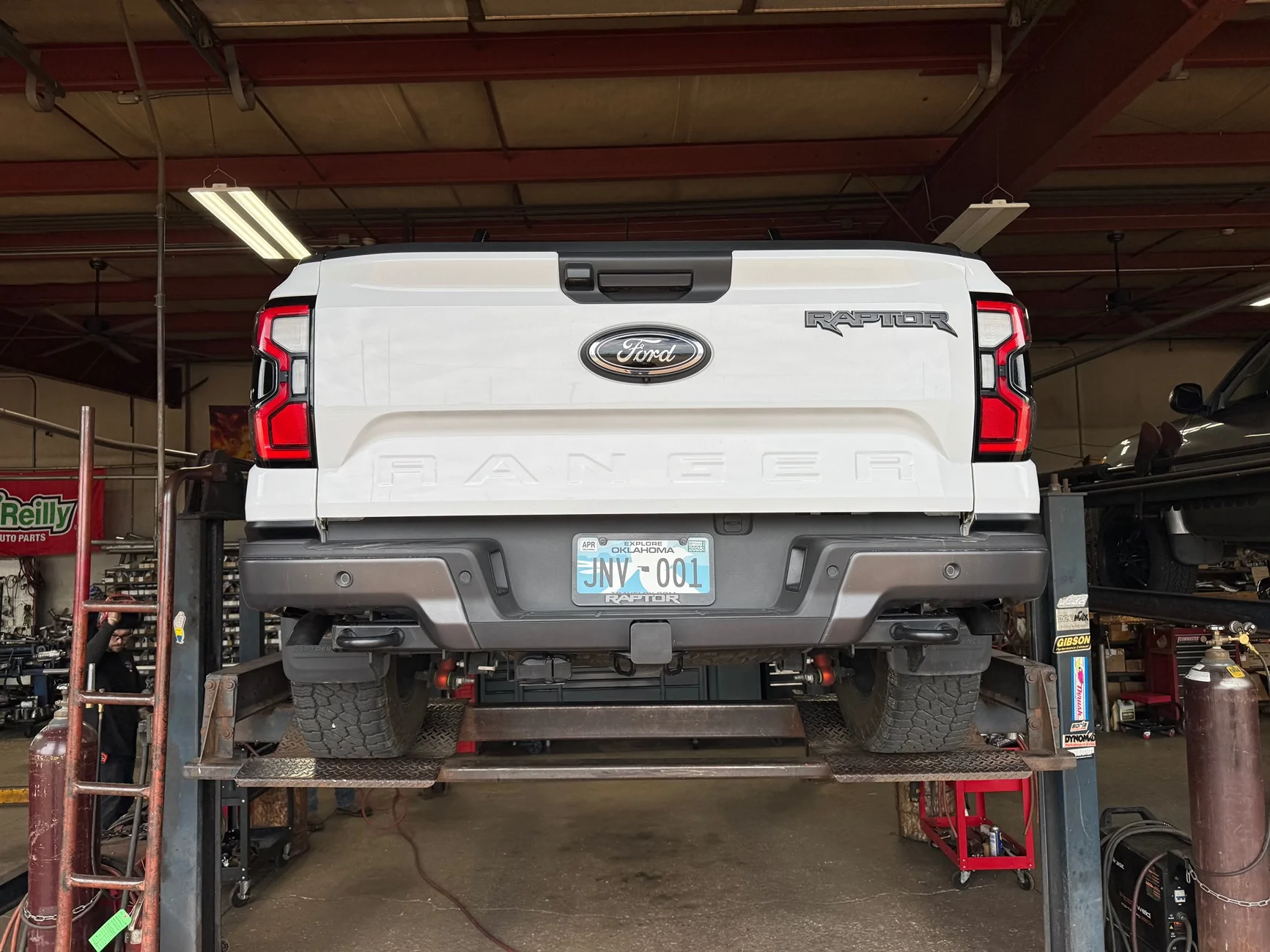

All done !
It’s much quieter !
I will try and post some sound clips later.
Ford Ranger I want a QUIET exhaust IMG_5669
Ford Ranger I want a QUIET exhaust IMG_5665
Ford Ranger I want a QUIET exhaust IMG_5668

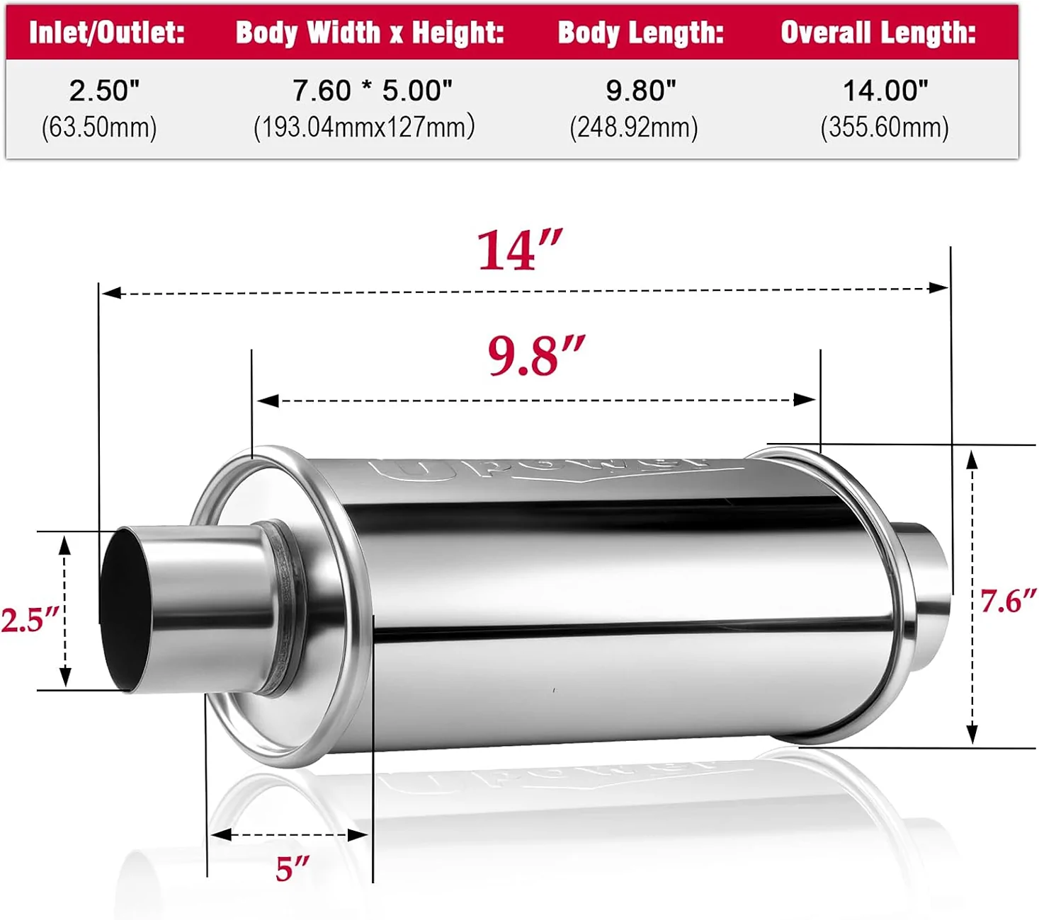

I was considering these, as they are slightly larger than the Vibrant 1141 Ultra Quiets, so I assume they would be a hair quieter/deeper tone.
Amazon.com: Upower 2.5 inch Ultra Quiet Resonator, 304 Stainless Steel Exhaust Muffler 2.5", 2.5'' Inlet & Outlet 14" Overall Length Universal Oval Performance Muffler Resonator : Automotive

Nice!!! Been watching for your updates. Sounds like it has a deeper tone. Is that your impression in person?

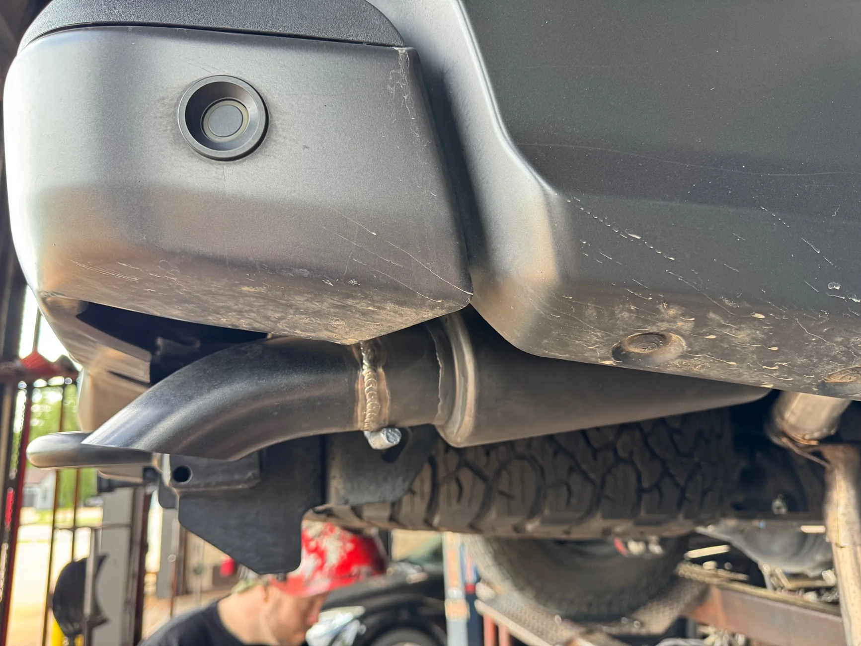

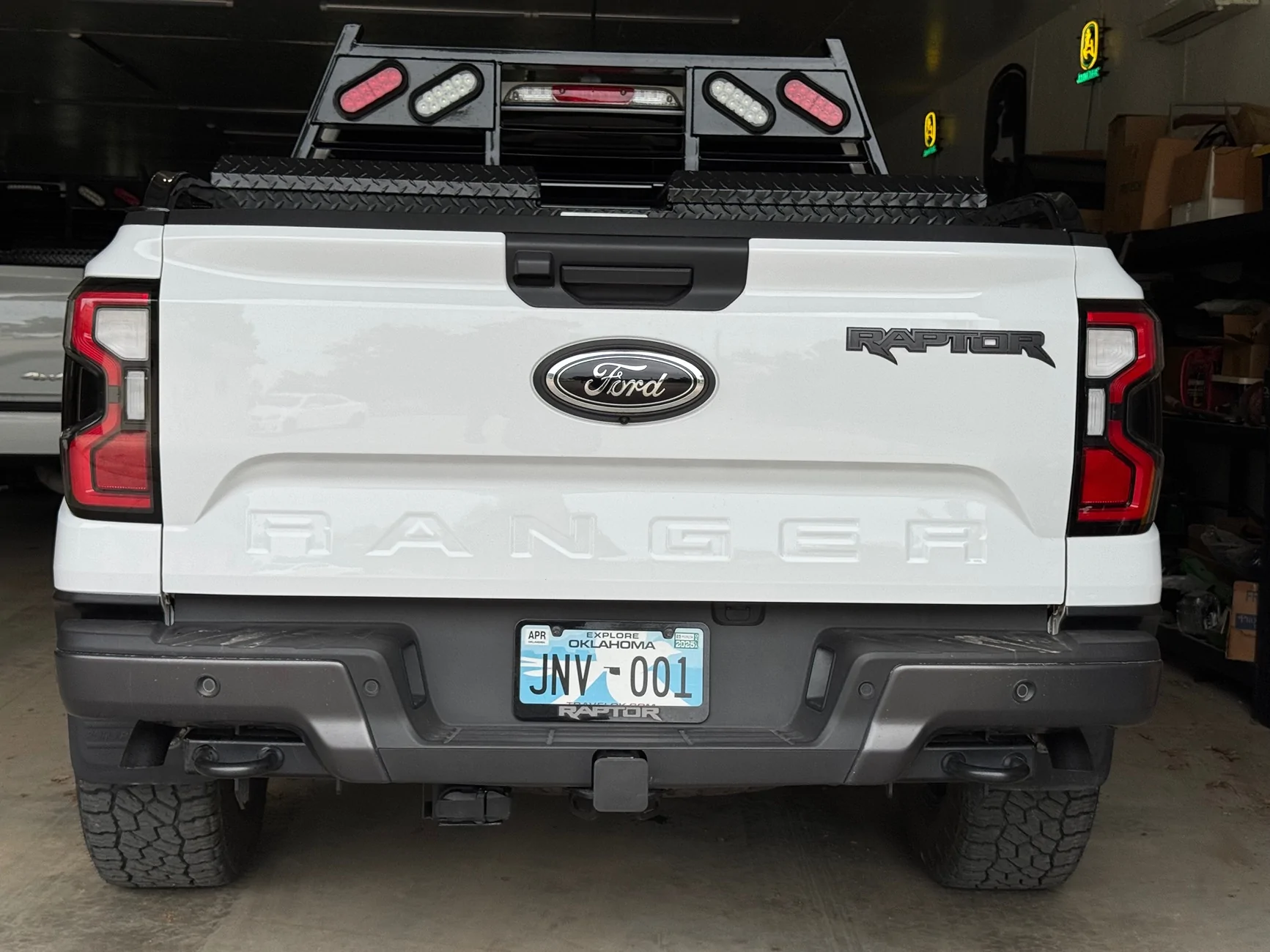

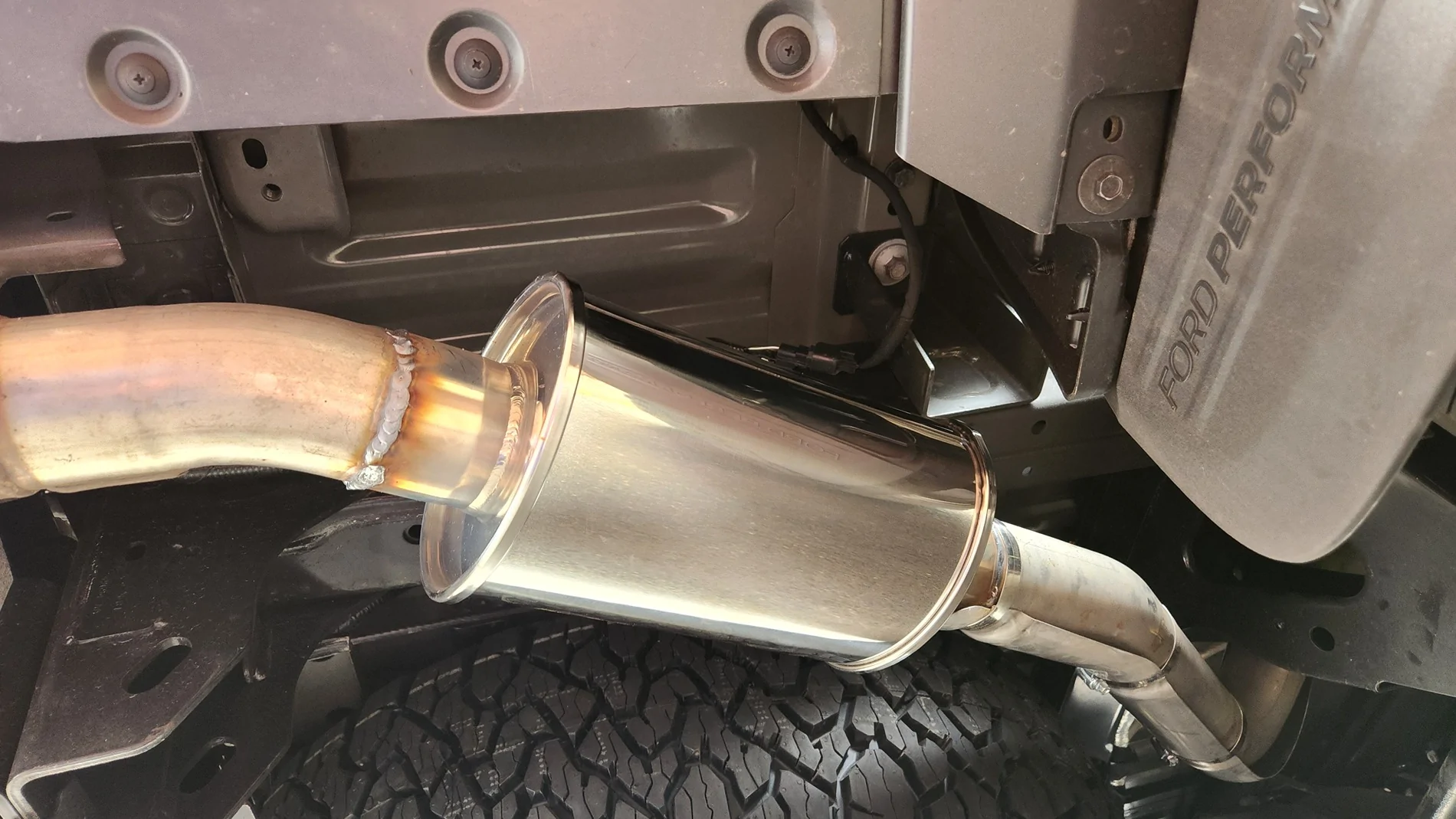

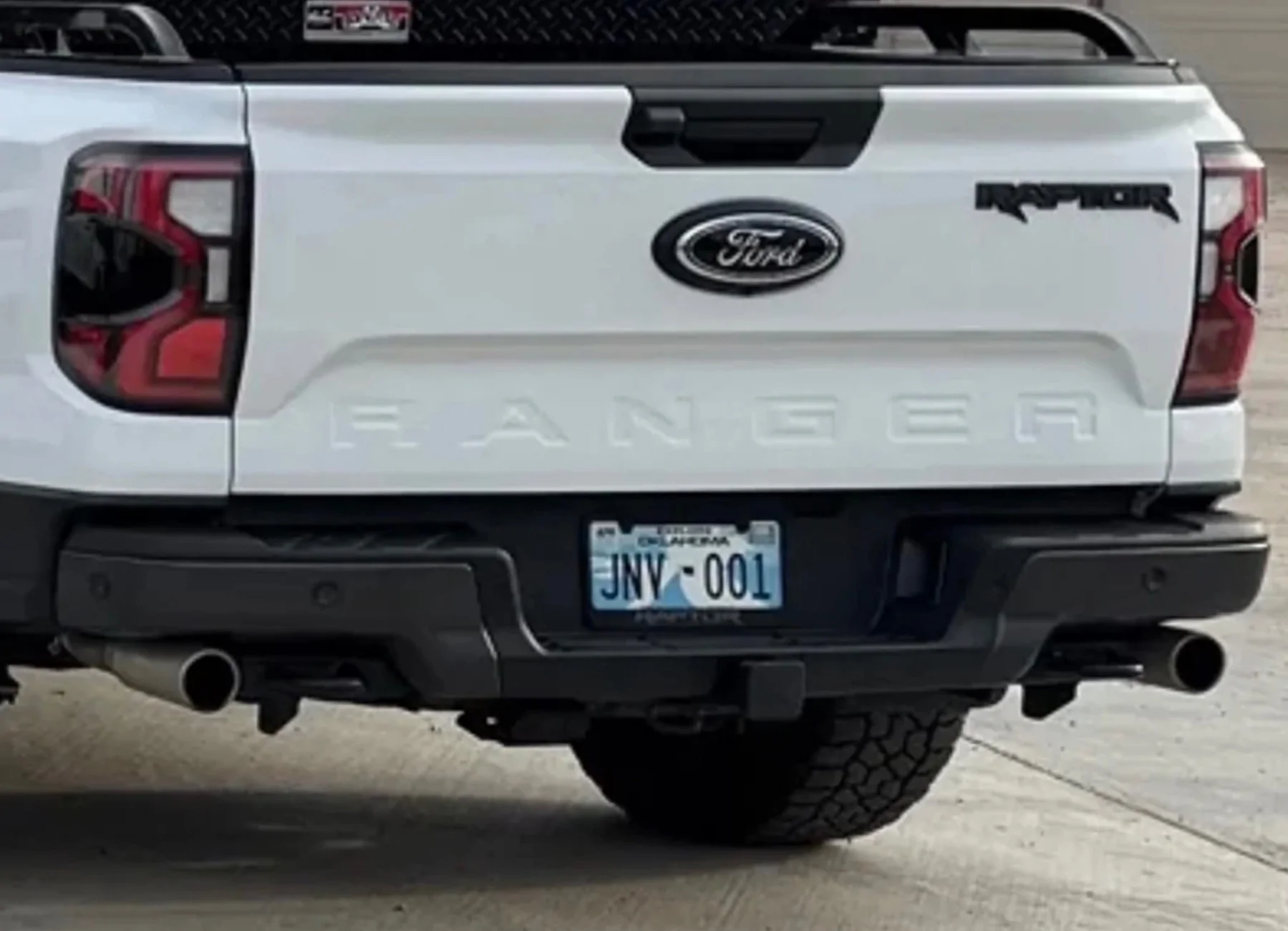

Here is a few pics of the new exhaust with truck down off the lift.
I am really liking the new clean look .
I still need to hit the welds with some high temp black paint to finish it off.
Before.
Ford Ranger I want a QUIET exhaust IMG_6789
After
Ford Ranger I want a QUIET exhaust IMG_5680
Ford Ranger I want a QUIET exhaust IMG_5679
Ford Ranger I want a QUIET exhaust IMG_5681
Ford Ranger I want a QUIET exhaust IMG_5682

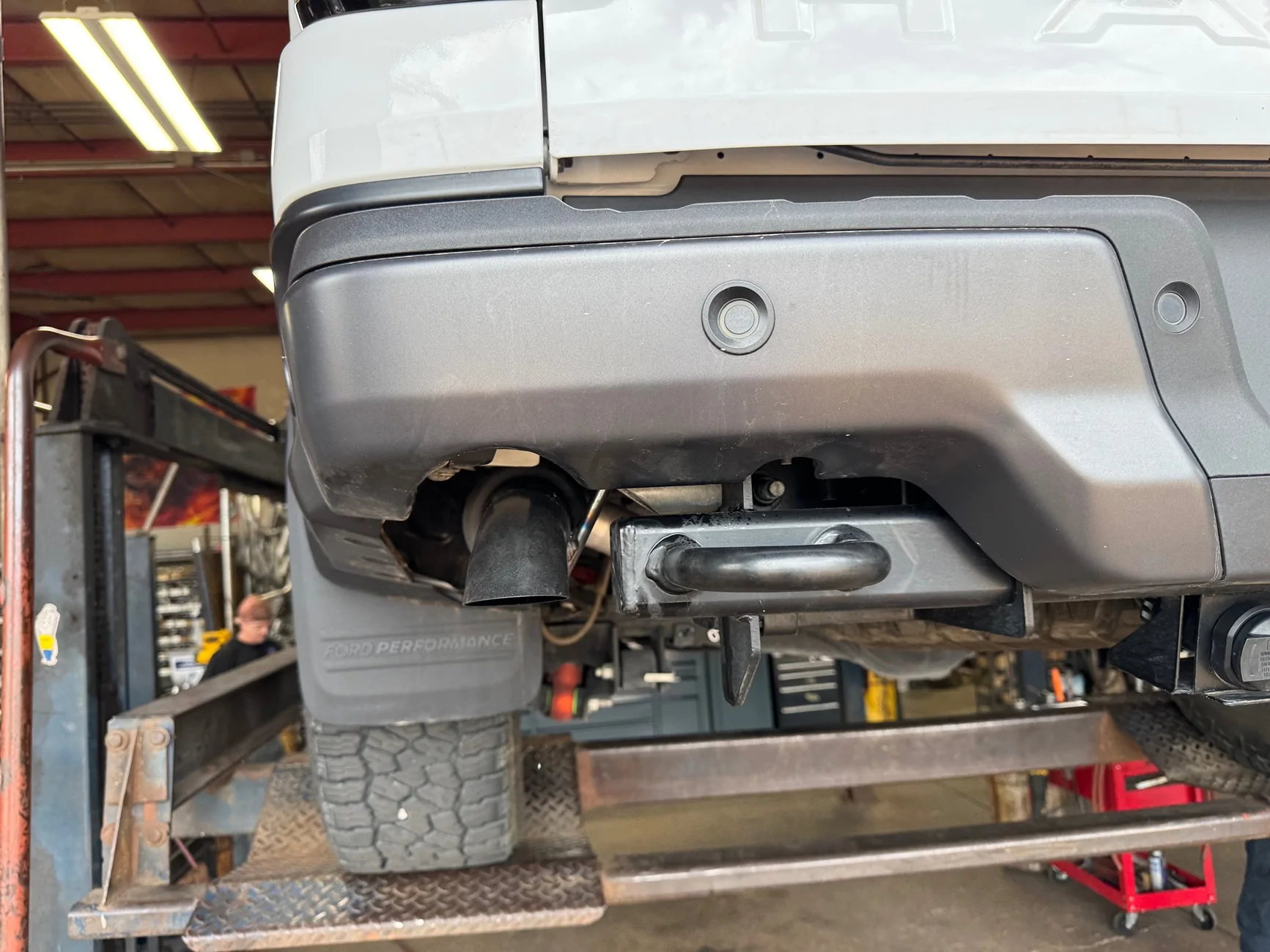

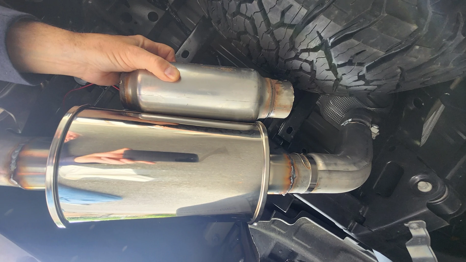

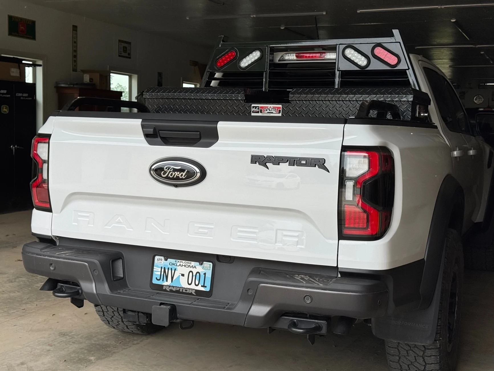

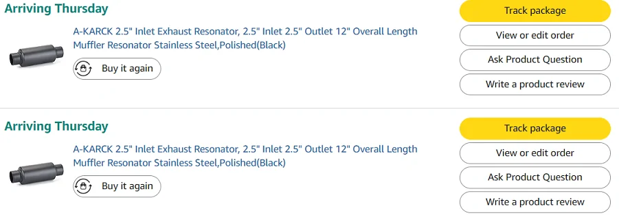

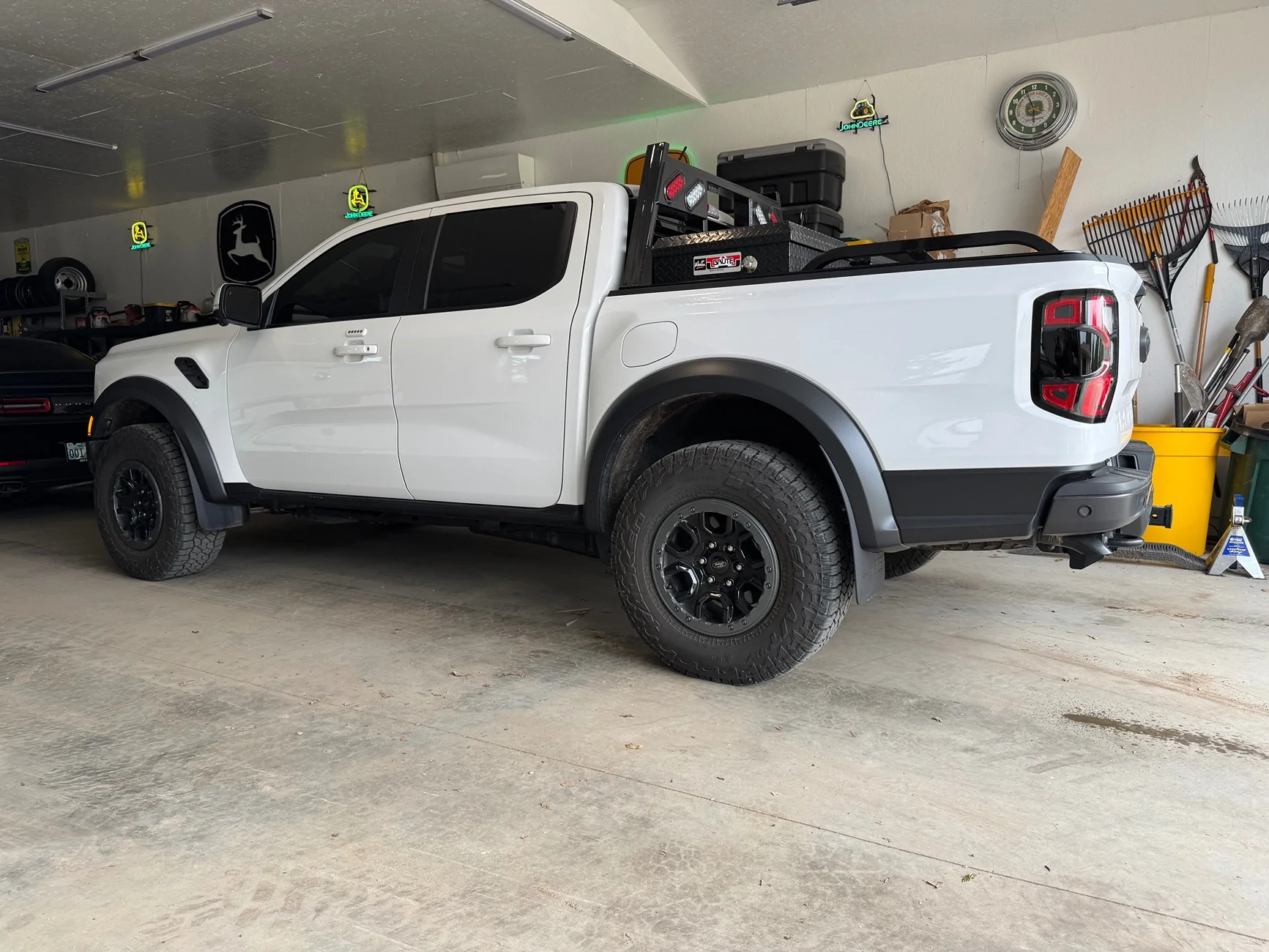

I order a 12" version of the same cans that I bought for the 2024 for the 2025 White RR with the topper. The 14" version were a tight squeeze to get them to set squared up like I wanted them.
They might be slightly louder than the 14" cans but in quiet model it is really quiet so I think it will be fine.
Ford Ranger I want a QUIET exhaust 1778017471784-z
I am going to try and get these 3" tips to work on it as well.
Ford Ranger I want a QUIET exhaust 1778017532169-kl
Setup the appointment for the other truck for the same time next Monday.

Got the Vibrant resonators installed today. Initial impressions are as the others have said...Maybe a little more than one step quieter with deeper tone. I seem to appreciate the exhaust tone now so maybe I'll find myself driving in sport or normal as opposed to quiet mode most of the time. I certainly notice the KO3 tire noise more now.
The tiny OEM resonators appear to have packing, but it looks like it is thinly packed fiberglass.
