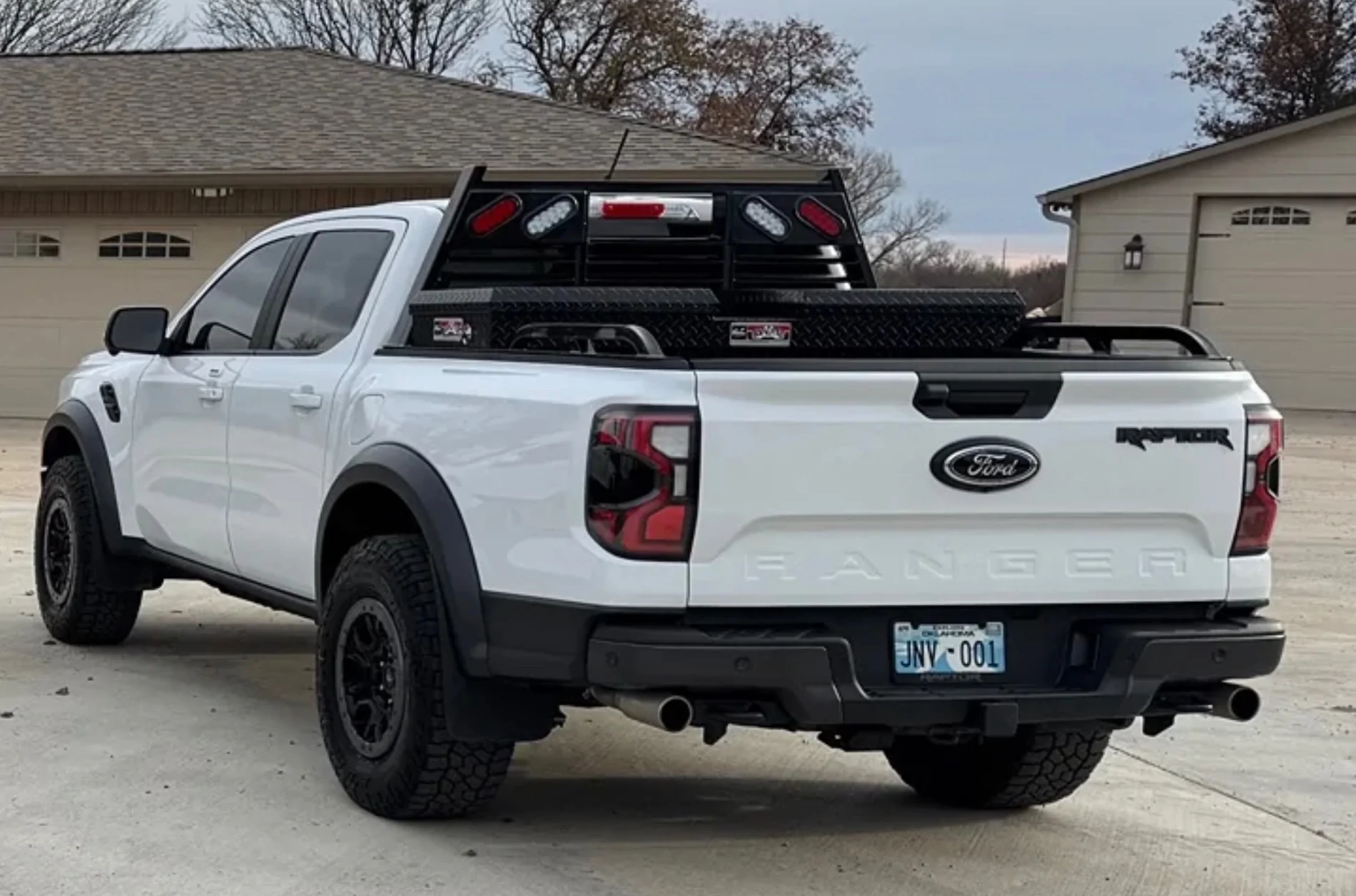

There actually looks to be enough room that you can put those resonators in their sides and put bed steps on a ranger raptor
Yea looks like there is room in there.
I was thinking the bulged raptor fenders were not compatible with the bed steps.
Has anyone been able to fit those steps on a Raptor?
I always thought those looked like they would be pretty handy to have.

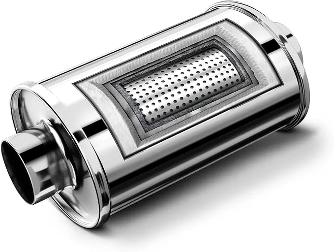

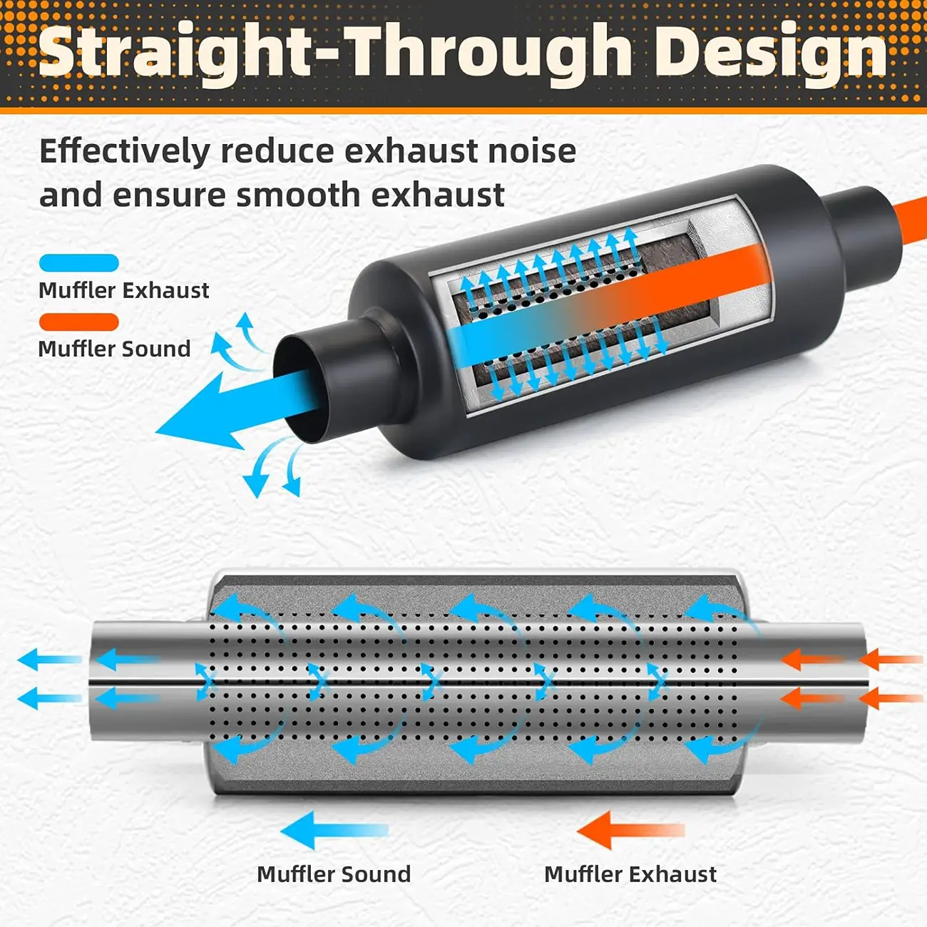

Someone was asking about the inside of these resonators.
Found these pics on Amazon.

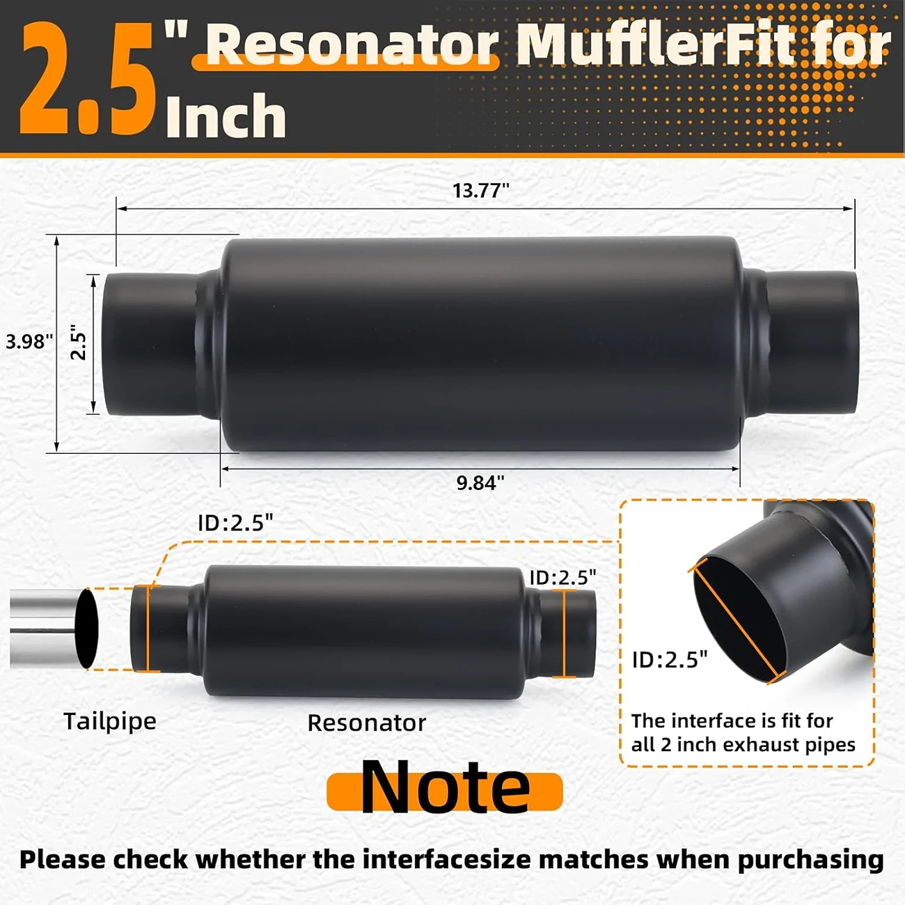

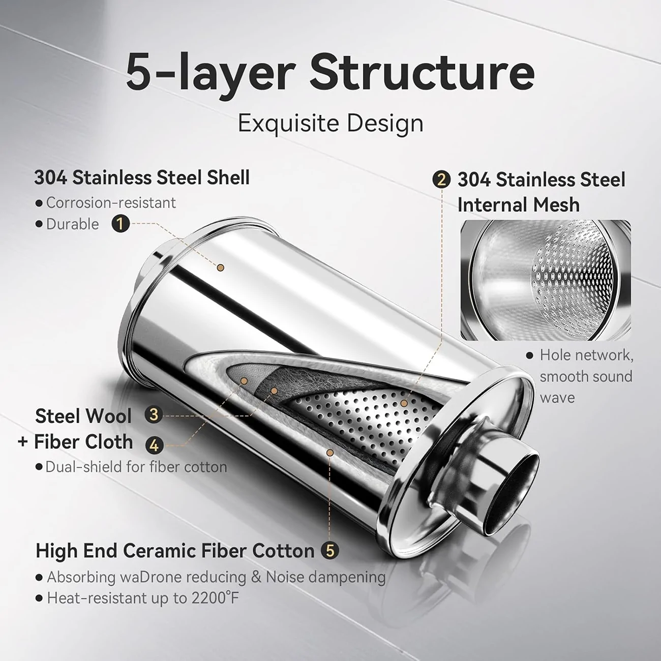

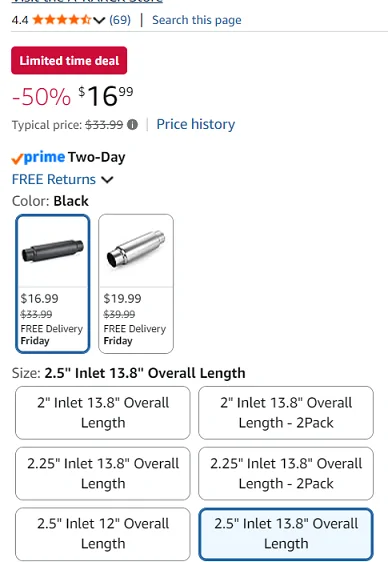

Found this one in black.
It's really close in size.
Price looks almost too good to be true.

Bear in mind, Vibrant has many sizes, but only the one was labeled super quiet. Since @Crapblaster had tried it and liked the tone, I went with it.
I've read many discussions about replacing resonators and various exhaust mods, and the Vibrant is the only one that had the results I wanted. Most people said the tone got worse, or droned etc.

I went ahead and order the two black ones I had found.
I am thinking if they fit and sound great I may order another set, or if I find them still a little lacking in some reguard follow up with one of the Vibrant sets paint them and put them on one of my other RRs. Then I could compar the two.

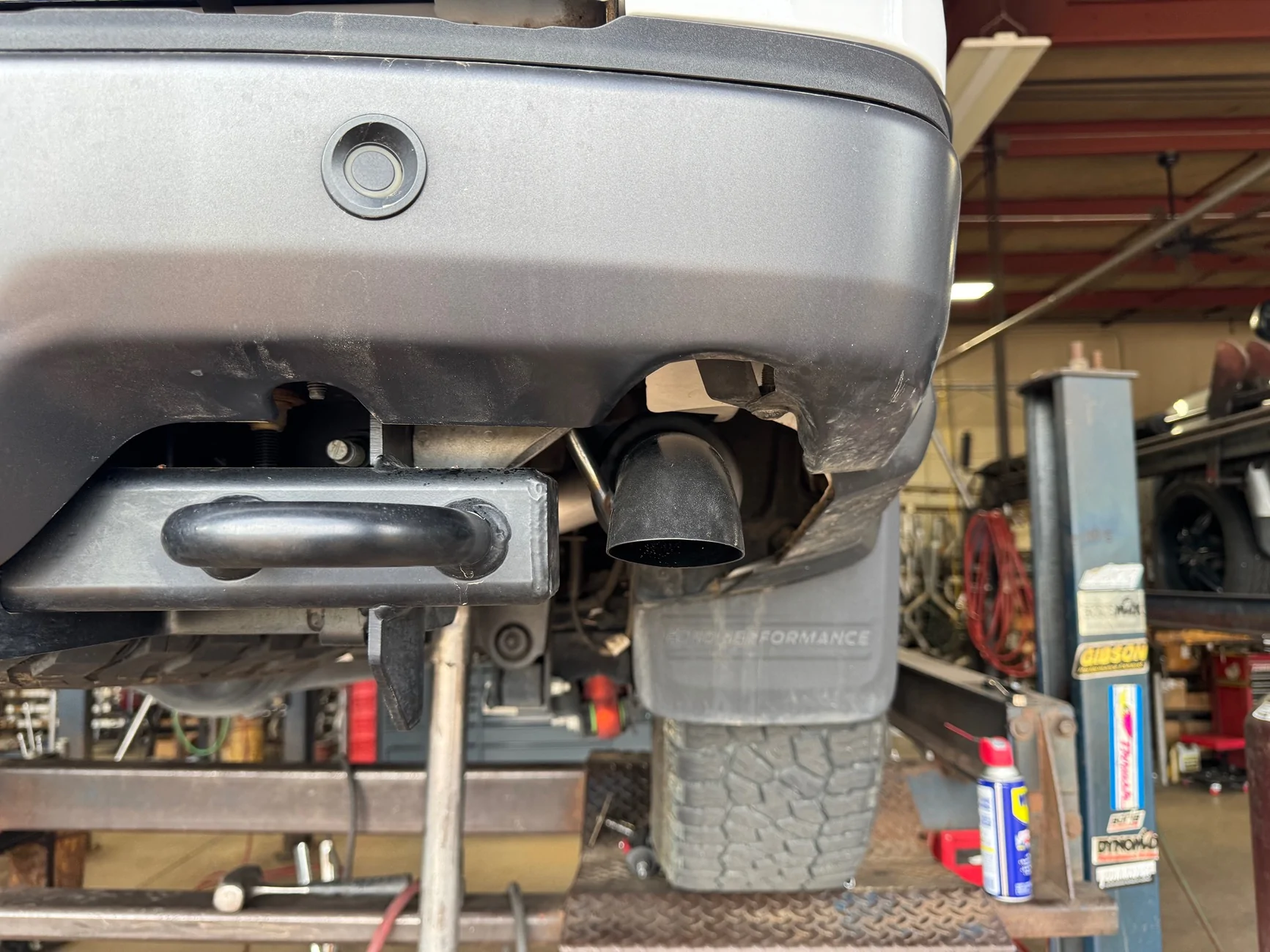

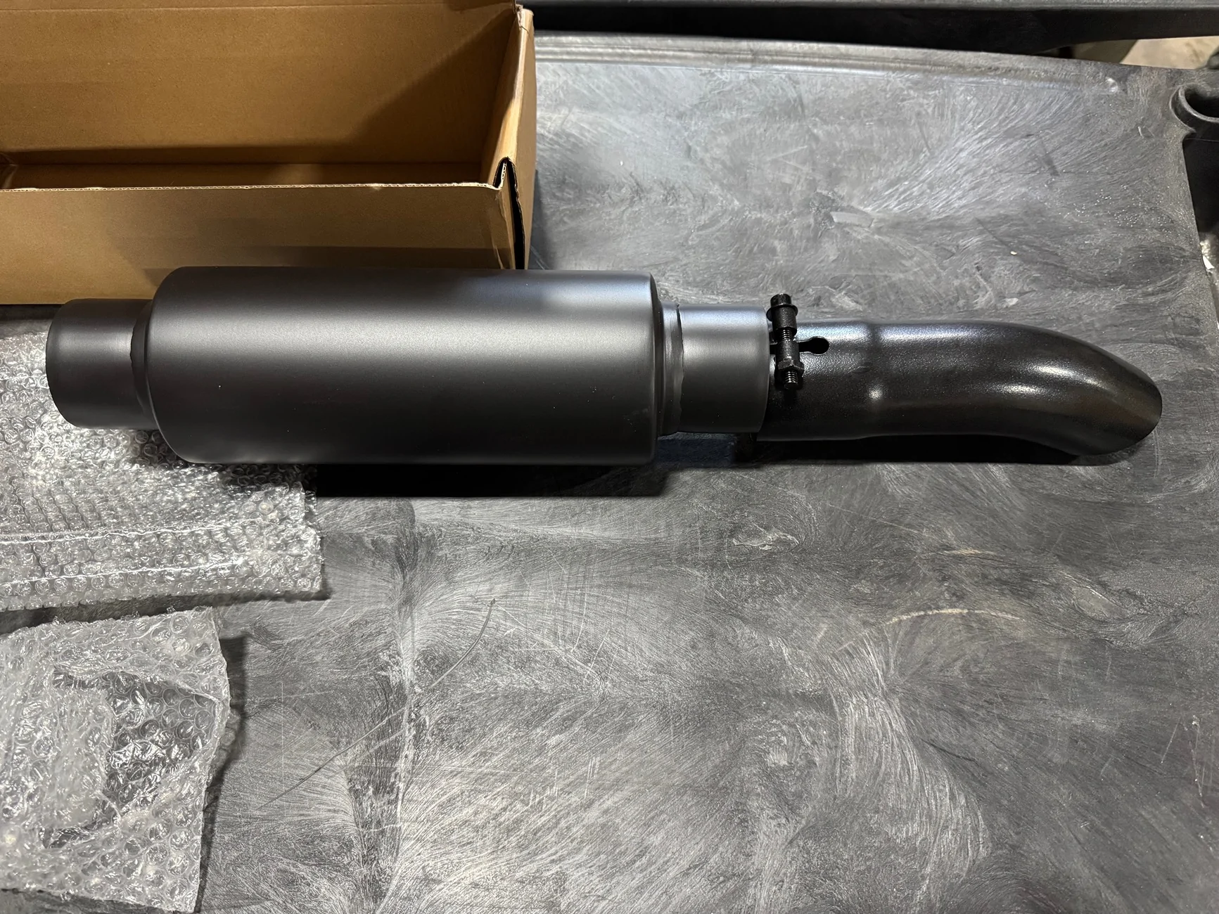

Resonators and tips came in today.
Have a 9:30 apt at my buddies muffler shop for 9:30 am Monday .
Fingers crossed it all fits and can be routed like I am wanting,
Ford Ranger I want a QUIET exhaust IMG_5644
Pic-N-Stick
Sep 28, 2025
269
471
Northern Virginia, USA
Retired Firefighter
Interested to hear how much of a difference there is from stock to these, considering they are less volume and much less expensive than the others posted here.
2,253
3,001
They are physically larger than the OEM resonators, so I am expecting a little quieter.
I am hopeful for the deeper tone as advertised as well as a little quieter.
I am little tight on space to get them mounted where I wanted them, tucked and hidden inside the back fenders, so I am probably going to be glad they are little, smaller than the others seen in this thread.
I will post up some pictures and sound clips next week if it all goes to plan.
If it is not really much quieter and there looks to be room for those larger one, I may go try those and the high temp paint on set for my 25 model, the white one with the topper on it.
These are going on my 24 model.

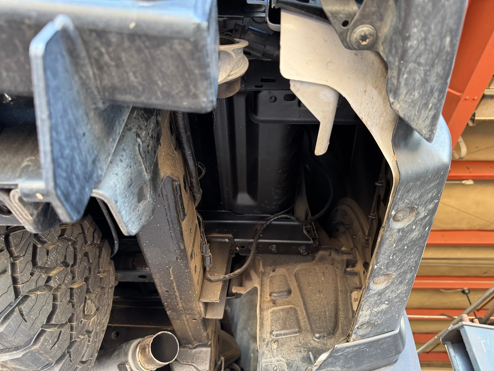

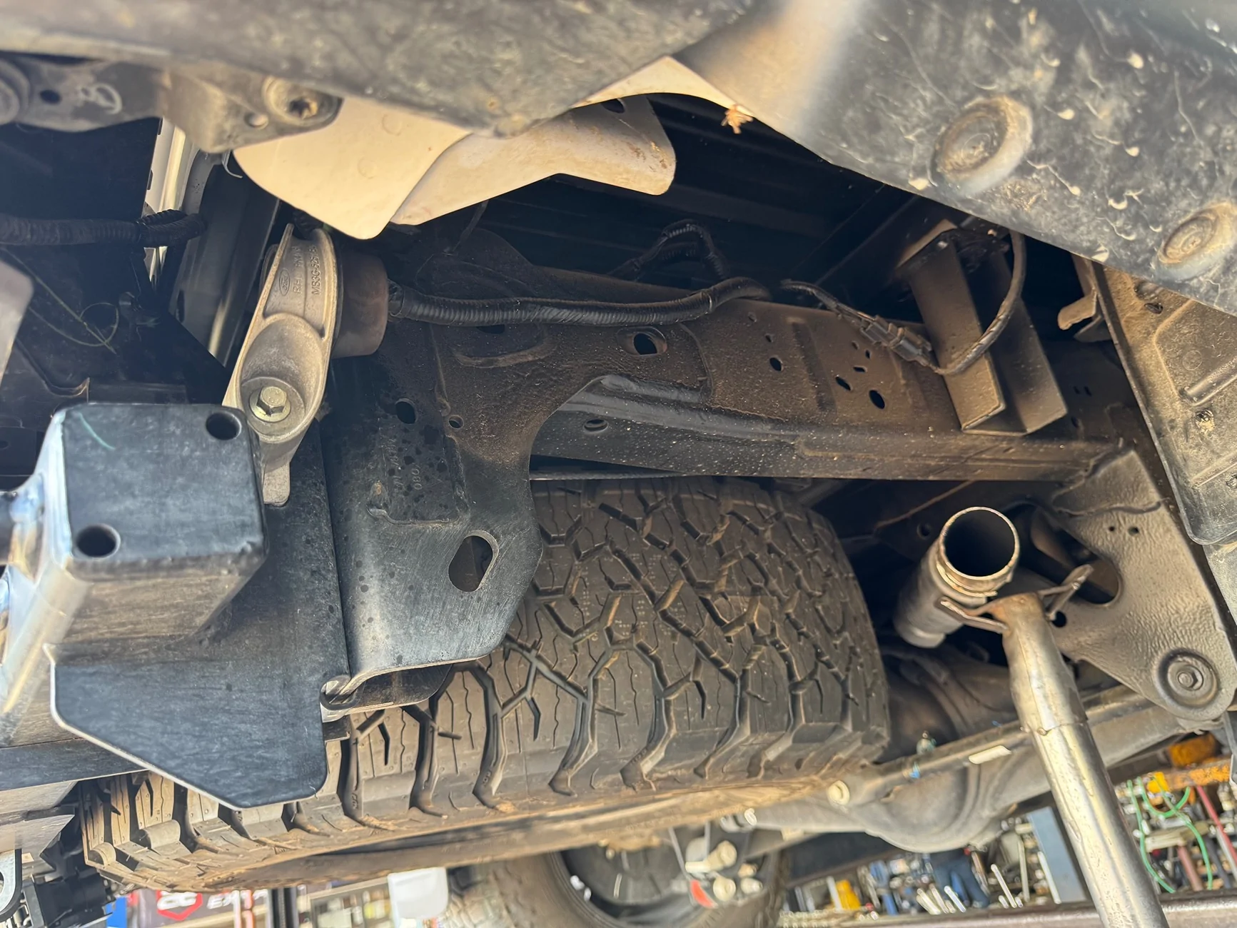

Right side in progress .
