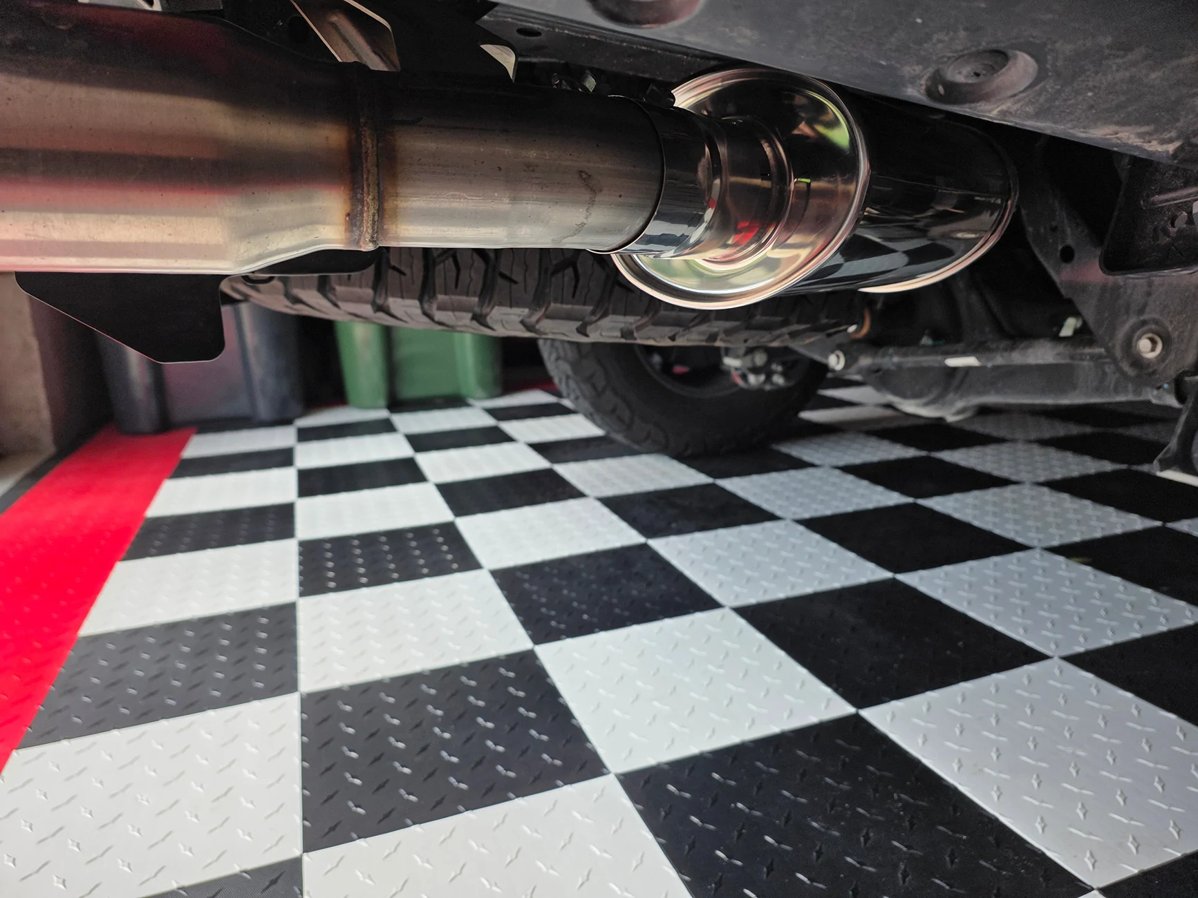

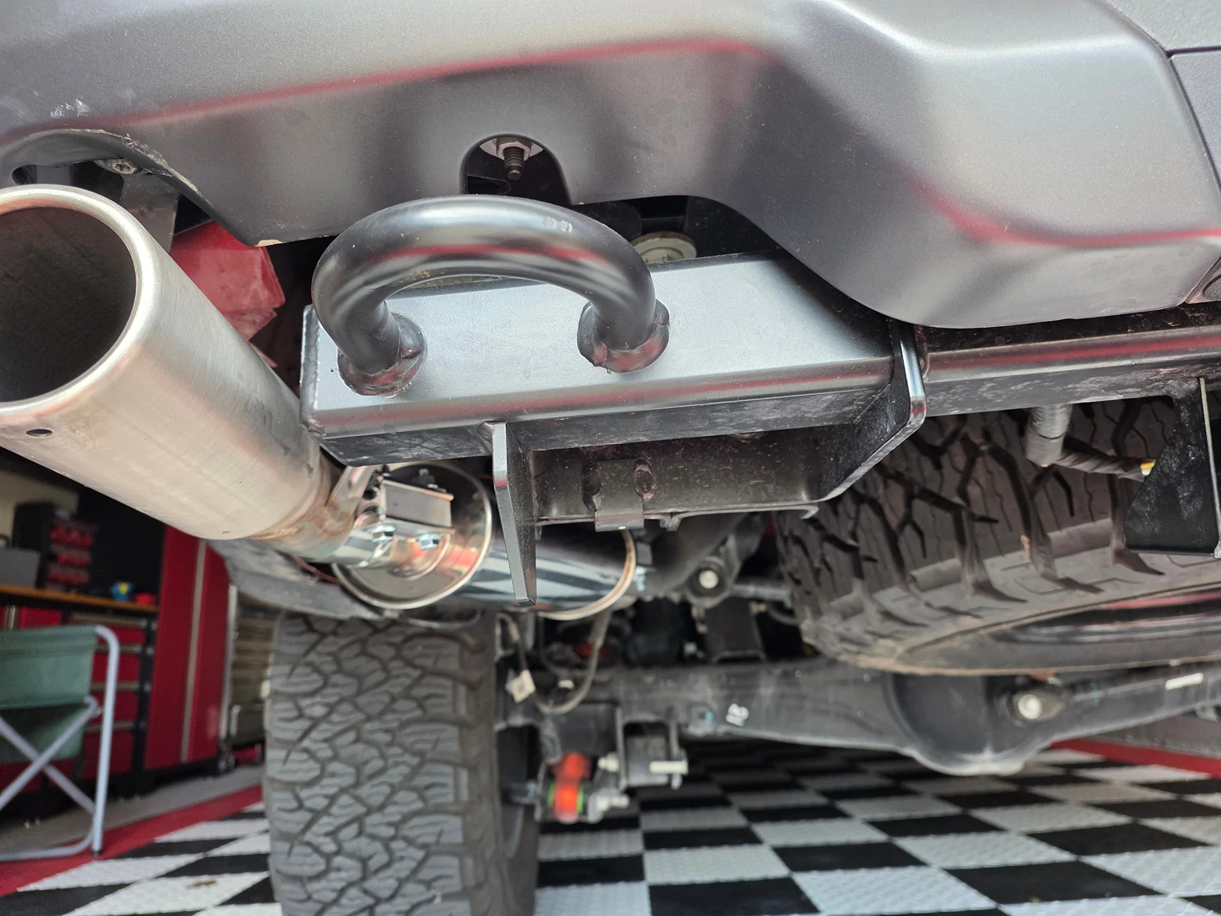

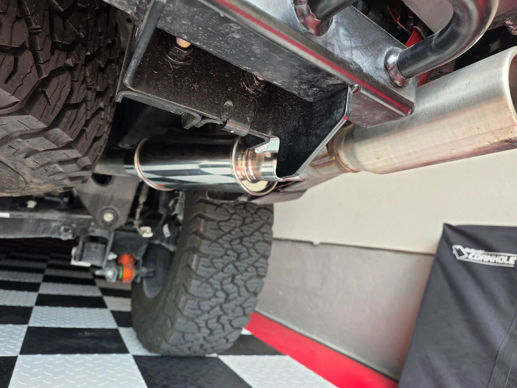

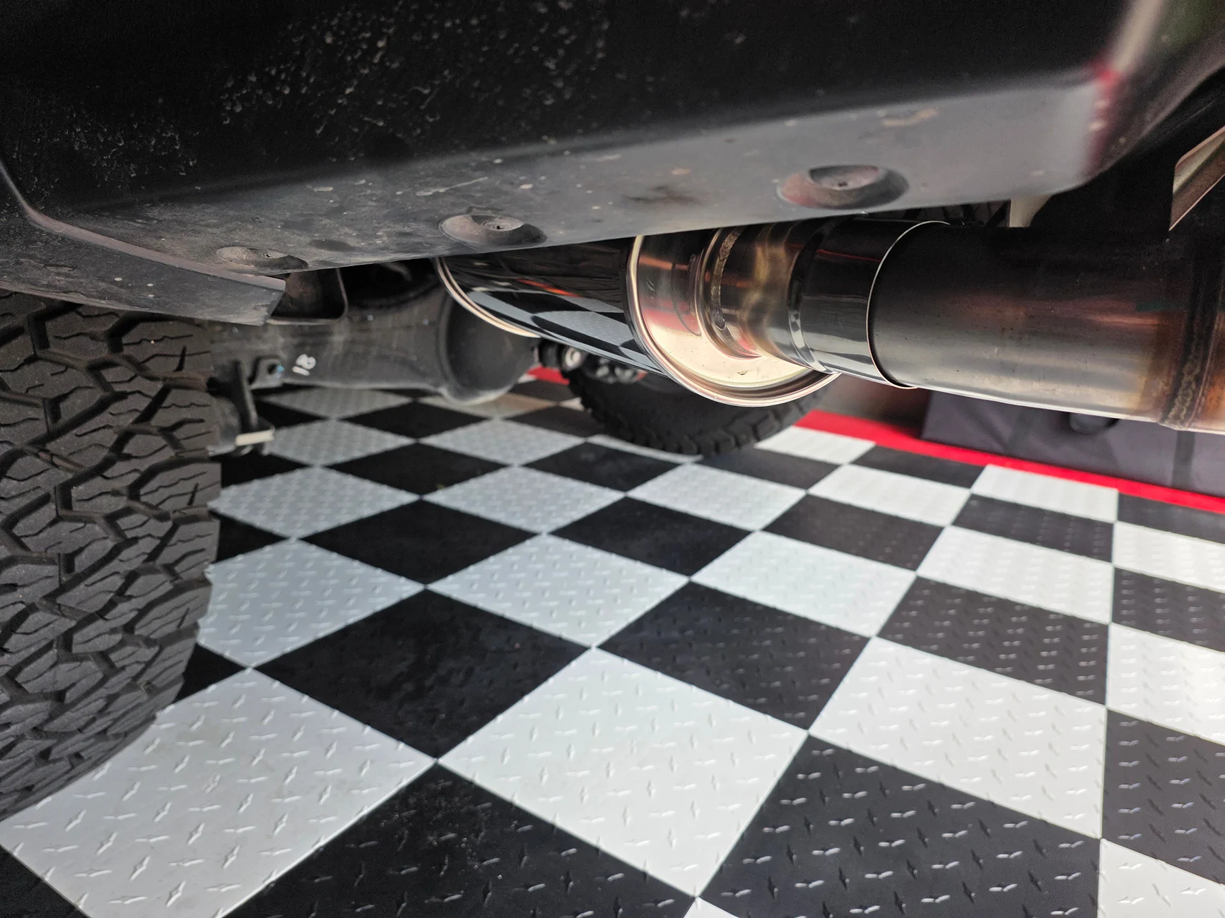

Where were they installed in terms of the chassis.
Do these go forward or aft of the rear axle?
Not a lot of room aft of the rear axle.

That sure sounds a lot quieter then stock.
Thanks for sharing the sound clip.
Would you have any pics of where and what was installed to accomplish this sound level?
Maybe a part number and brand of what was used as well?
I am tempted to try and duplicate it with at least one of my RRs.
I'm going to have the band clamps replaced with welding them on since I know they work now.
Ford Ranger I want a QUIET exhaust 20260413_154702
Ford Ranger I want a QUIET exhaust 20260413_154711
Ford Ranger I want a QUIET exhaust 20260413_154727
Ford Ranger I want a QUIET exhaust 20260413_154737

Are you going to experiment further? Trombone? Pre-muffler resonators ?
2,336
3,126
Looks like these new resonators replaced the smaller OEM versions?
