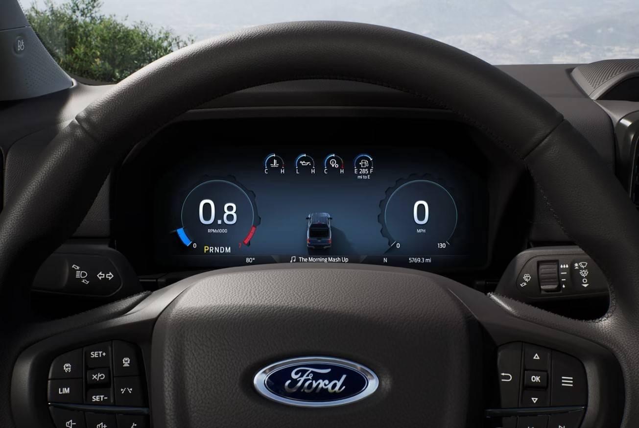

Want to confirm, you have the 2.3L gas engine, the pictures are from your truck and you're in the US, correct?, Sorry if i made that assumption incorrectly. I'll assume you are, the 2.3L does not redline at 4500 rpms. the Lariot has the 12" screen, and will display the correct redline. If what i said above was correct, whoever configured the panel used the wrong engine type, the redline is set too low and the top scale should probaly be at least 7k RPMs. Good news is that all it should take is a few tweaks in forscan. the panel will/should have the correct display for your truck installed. Pic is what it shouild look loike. C~

Want to confirm, you have the 2.3L gas engine, the pictures are from your truck and you're in the US, correct?, Sorry if i made that assumption incorrectly. I'll assume you are, the 2.3L does not redline at 4500 rpms. the Lariot has the 12" screen, and will display the correct redline. If what i said above was correct, whoever configured the panel used the wrong engine type, the redline is set too low and the top scale should probaly be at least 7k RPMs. Good news is that all it should take is a few tweaks in forscan. the panel will/should have the correct display for your truck installed. C~
I am in EU and I have the V6 diesel wildtrak :)

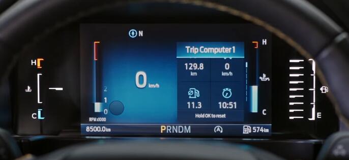

How to get the bottom dashboard (lowers pic) on my ranger. I only get speedometer thats it. Something like this
If you read this thread from the start you will understand..what you have is the 8inch cluster, and you cannot have anything of the lower pic cluster cause that is a 12inch. You can only upgrade the entire cluster
Thanks a lot for the guidance.
