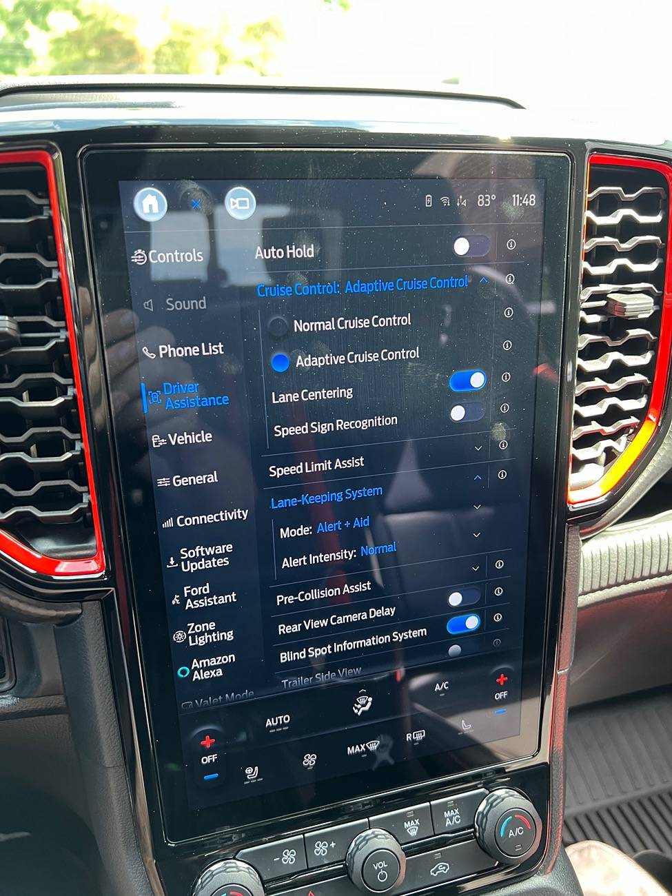

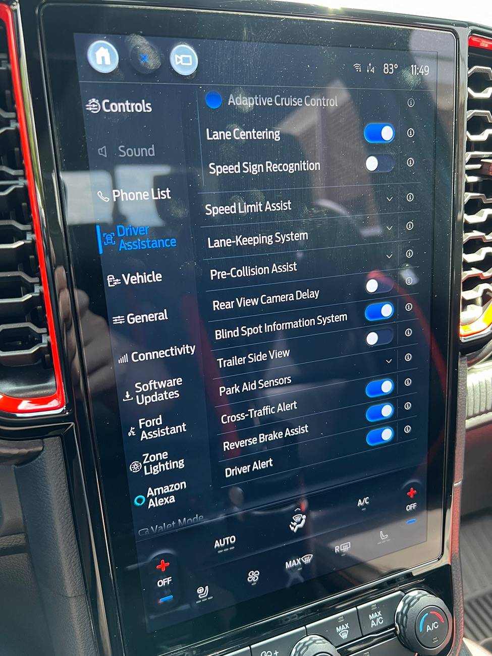

This week I have a press ranger raptor, and when I engage cruise control, lane centering stays off and only turns on when I press the button on the steering wheel, which is how it should be.
Here were the settings in the menus on that Raptor, not sure if that helps.
