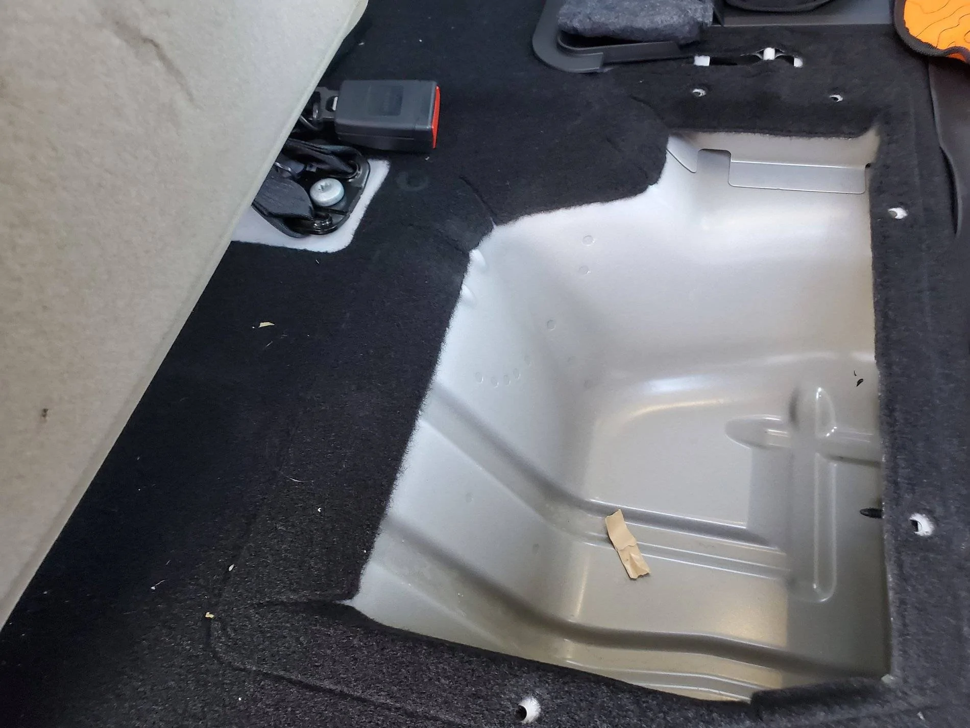

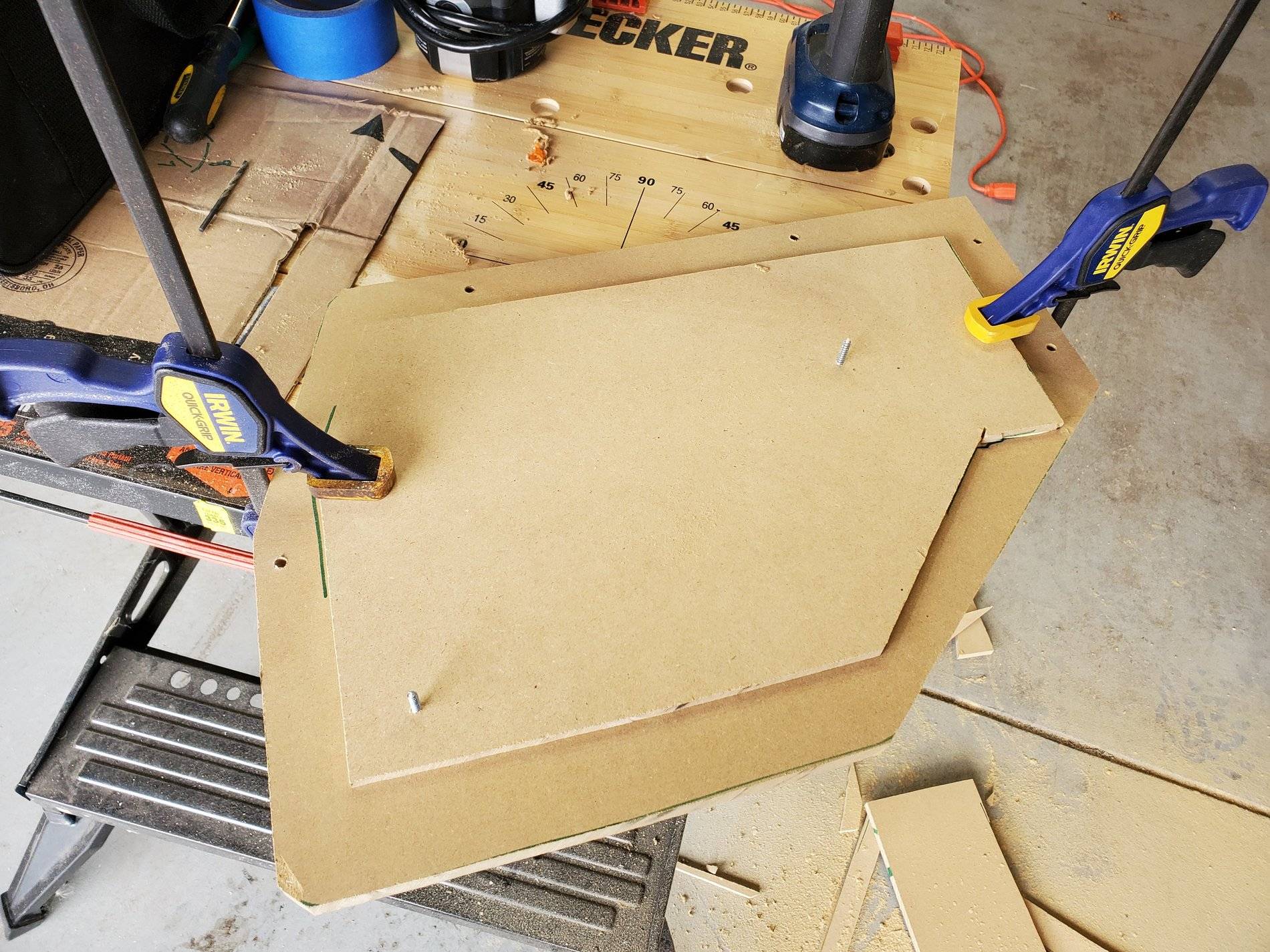

Here's the general dimensions of the B&O sub, if it helps anyone determine a shape or a volume. I'm still trying to decide what to build....

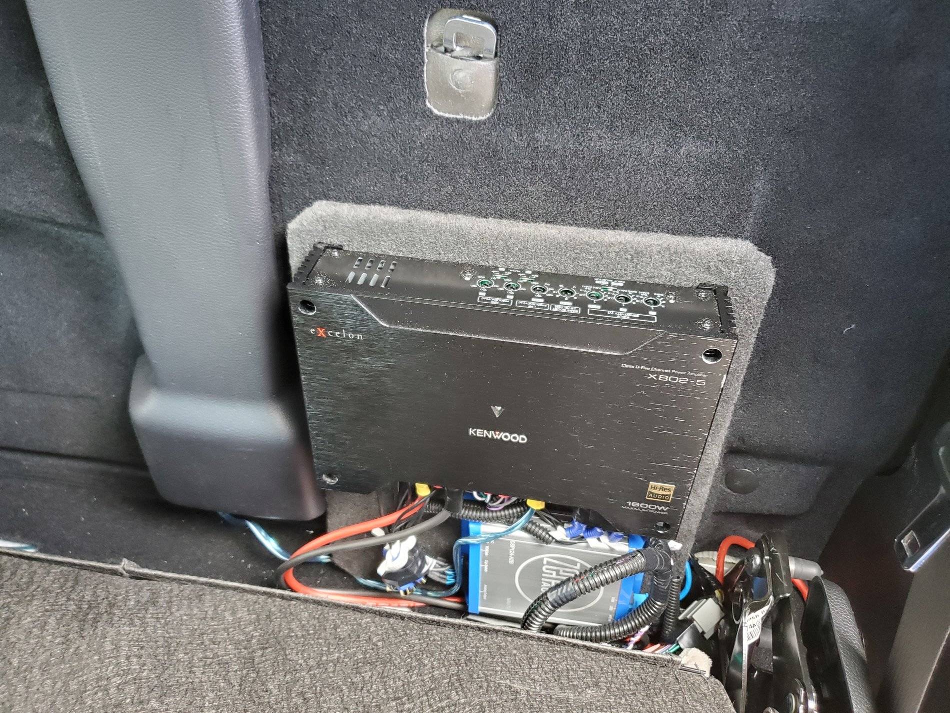

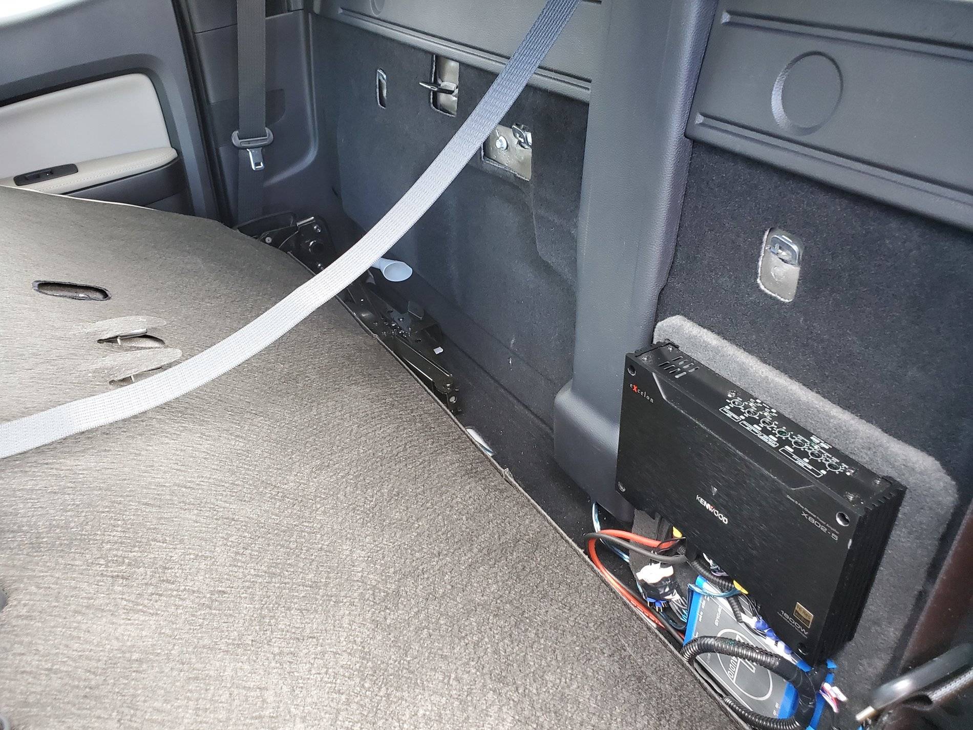

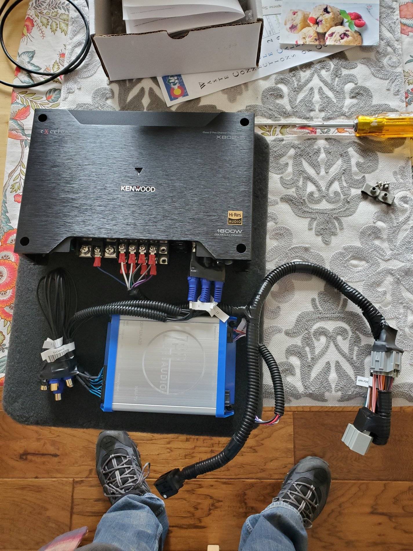

It's been a journey the last couple days. I decided behind the seat is too convoluted of a structure to build out of mdf, and that my gear in the larger under seat bin would fit in the spot where the stock sub was. So. The bin has been transformed into a sealed sub enclosure sealed with foam and a compression fit from speed nuts. I measured the volume with instant foam packing and decided not to try and build a box of that shape. This is a bittersweet determination for me. If I knew I would have the mounting depth I would have considered a beefier 8" sub. I'll stick with the Alpine S-W8D4 for now.
The amp assembly went in like a puzzle and I am worried it may need to be changed for the seat to close. Tbd.

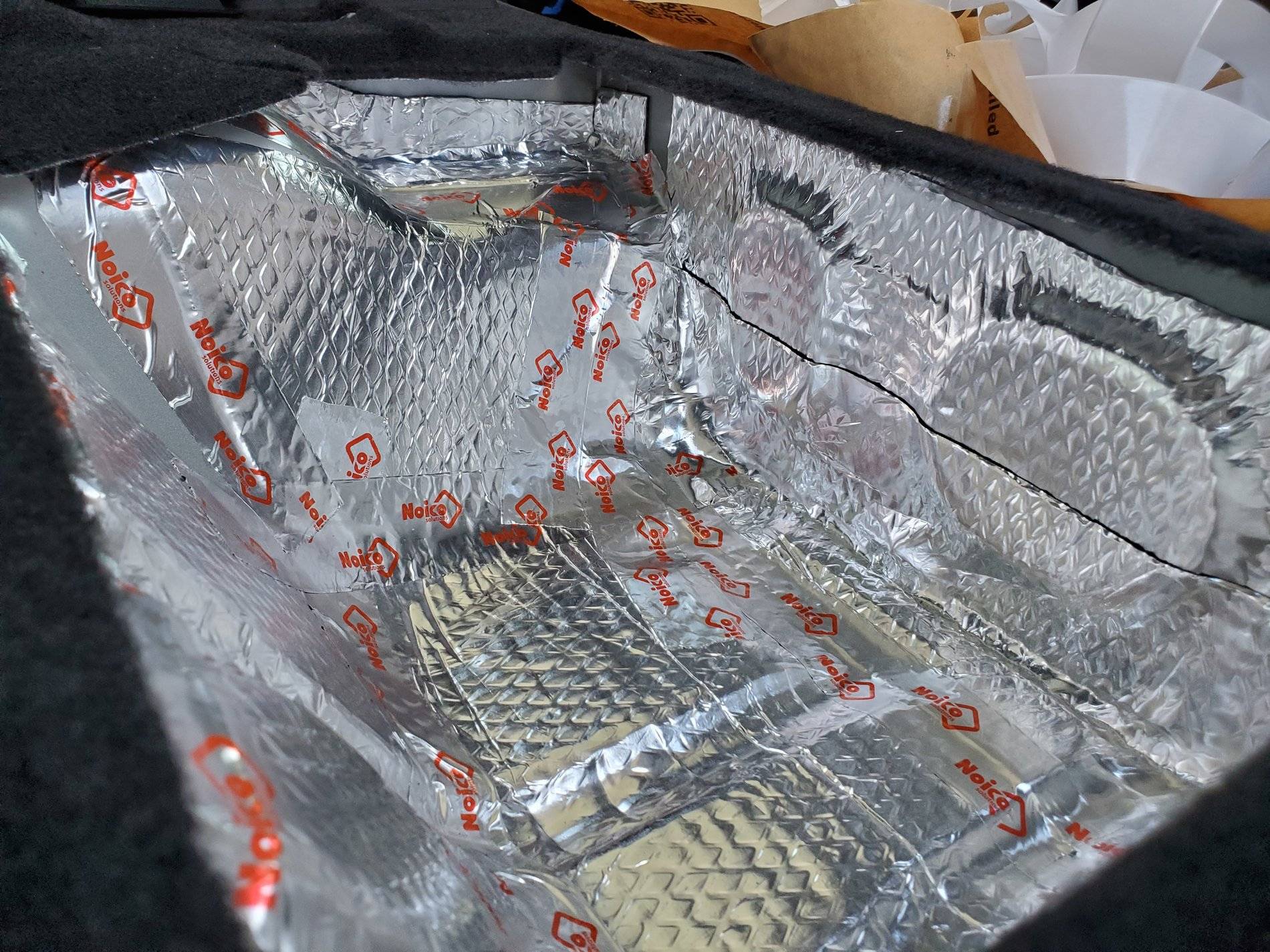

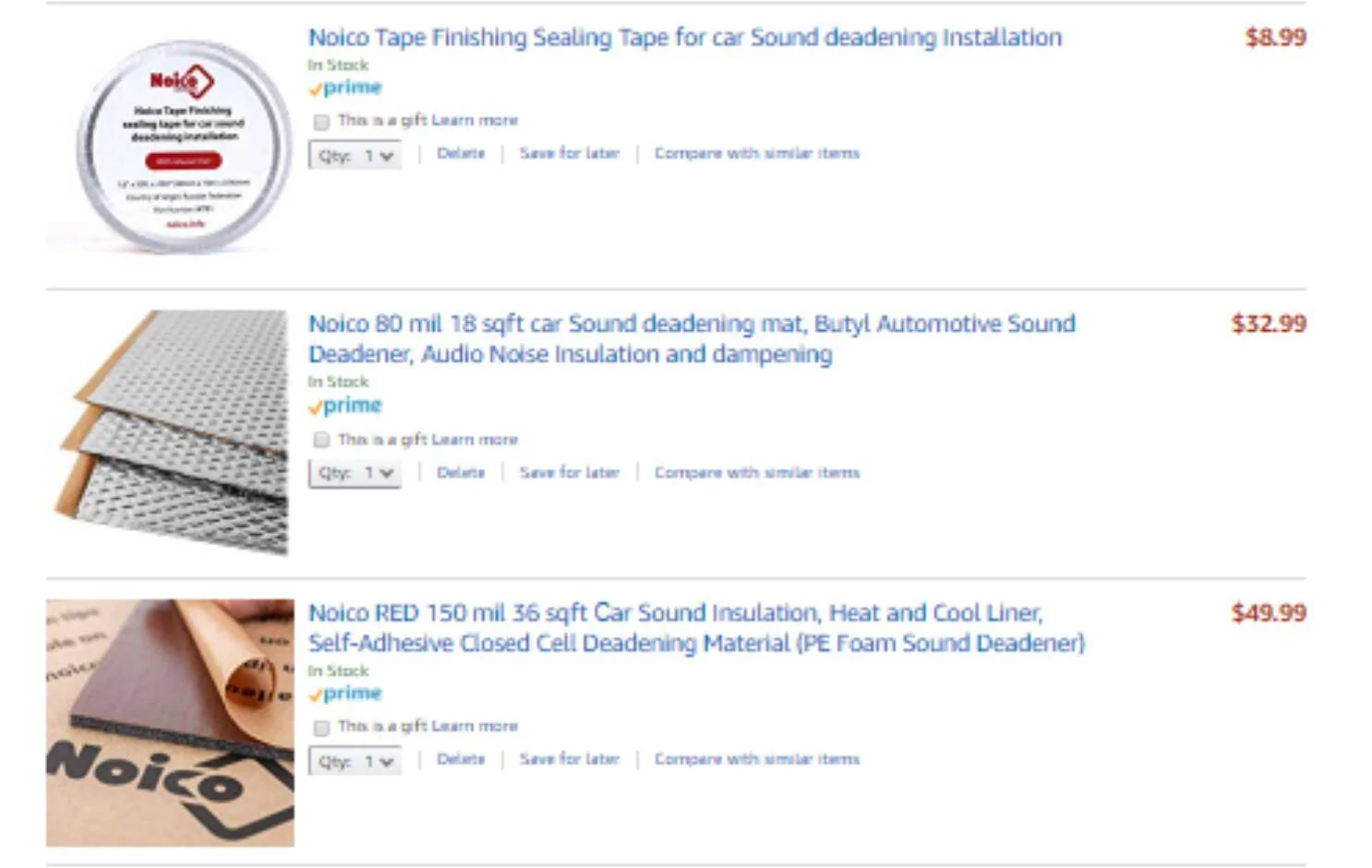

18sqft of the asphalt aluminum back stuff was not enough. I used 20sqft for 4 doors, back wall, sub spot, and wish I had got more. The Noisco stuff is a lot thicker than Streetwire, and cheaper. Glad I went with them. 36sqft of the 150mil foam was plenty. In hindsight I would have just gotten HVAC aluminum tape for finishing rather than the name brand stuff that just has their name painted on it.
Yes, the Ranger already is pretty road quiet, but let me tell you, now that I've done that it's luxury car quiet. You can literally talk at a whisper and hear yourself at 45 mph. It's just amazing. The sound deadening was the most time consuming and most work, but absolutely worth it.
Plus, the vibrations I had with the stock B&O are now gone. I have the 6" Alpine Type Rs set to full range, pairs perfectly with the sealed sub. The bass is so articulate and tactile, with no rattles or buzzes, I'm chuckling here. This is not an SPL machine mind you, it just sounds and feels really really good.
Overall the system is simply outstanding. I wasn't sure how much of an upgrade it would be, but as a hifi hobbyist I can say for sure it was worth every penny. It now has the ability to make me giggle with how good it sounds, this was not the case before. Few systems I've ever heard sound like this. This is the first time in a car, to be at this level, for me. The dsp time alignment makes a huge difference. No EQ or anything and I'm pretty happy with here it's at. The Zen was basically plug and play, everything worked on the first try.

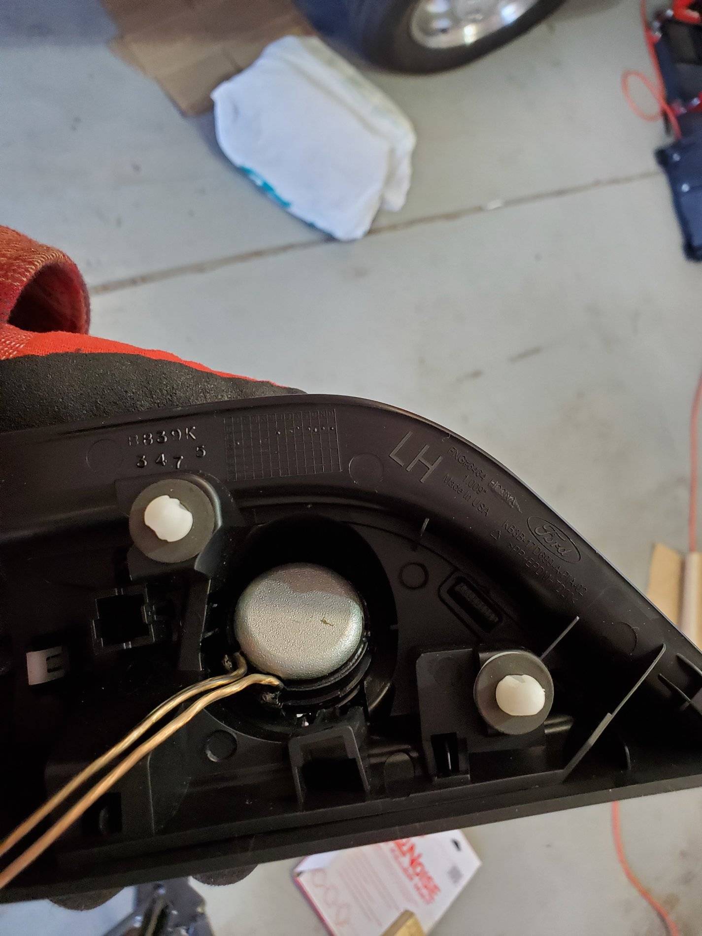

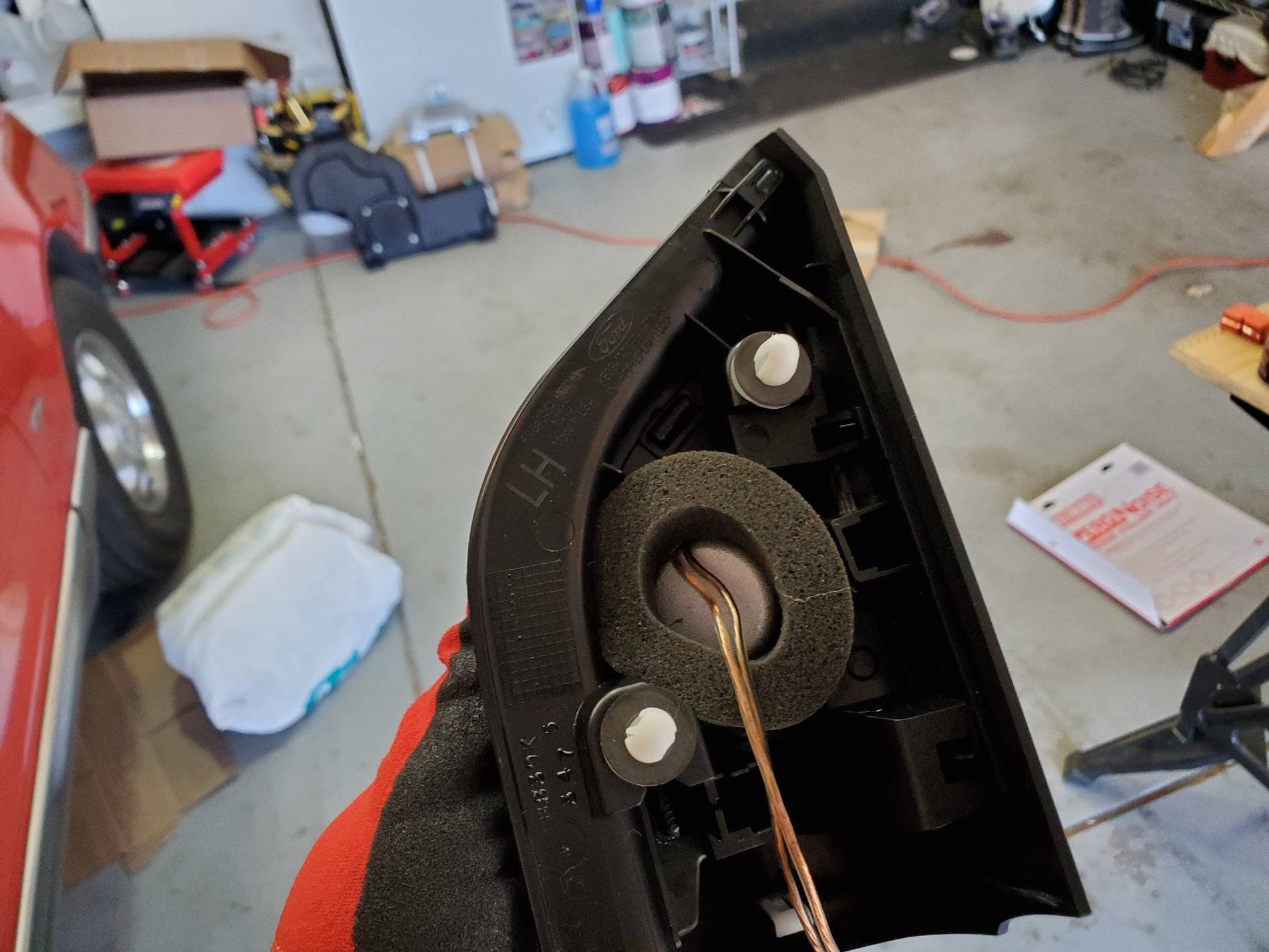

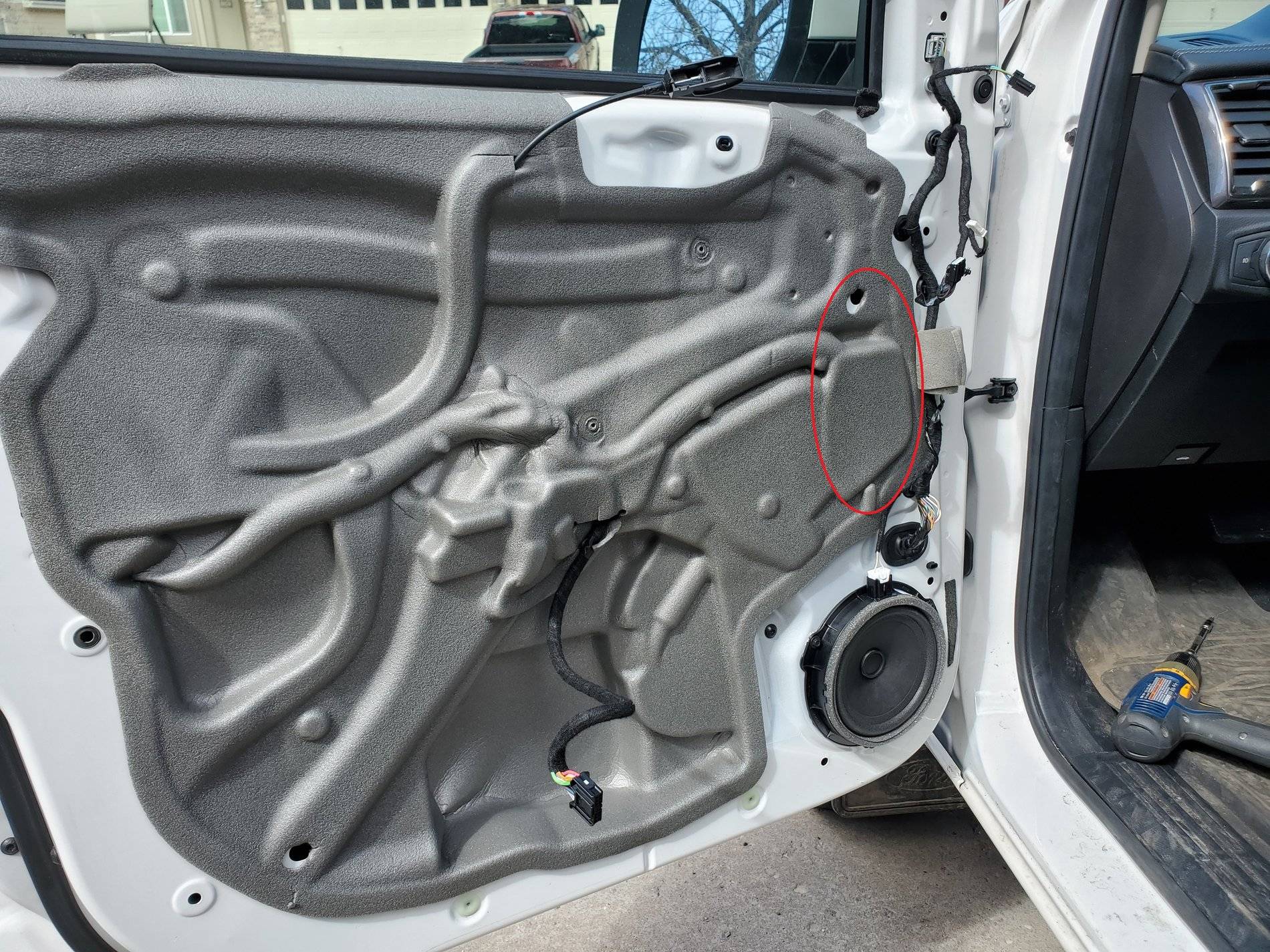

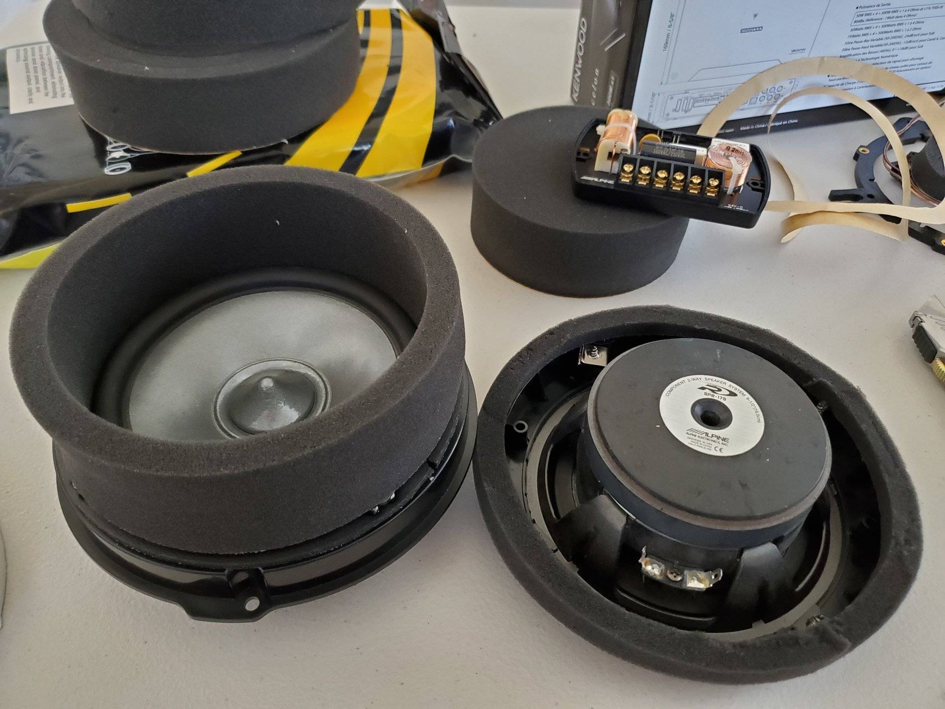

The rear speakers need tall foam rings like these using the Metra 825605 brackets. The front speakers are shown before I cut the foam down to about 1/2", not much is needed in front since the speakers are close to the door skin already.
I mounted the component's crossovers in the hole in the door frame circled since it's a bump out already there is a perfect space, it's also in range of the speaker plug and central to the woofer and tweeter. I adjusted the tweeters to -6dB since the Ranger has really good tweeter locations that are already ear level and pointing at you as possible, Alpine gives 0 to -8 in 1 dB increments. If anything I would go one more to -7 since I can barely "hear" the tweeters directly otherwise they blend perfectly.

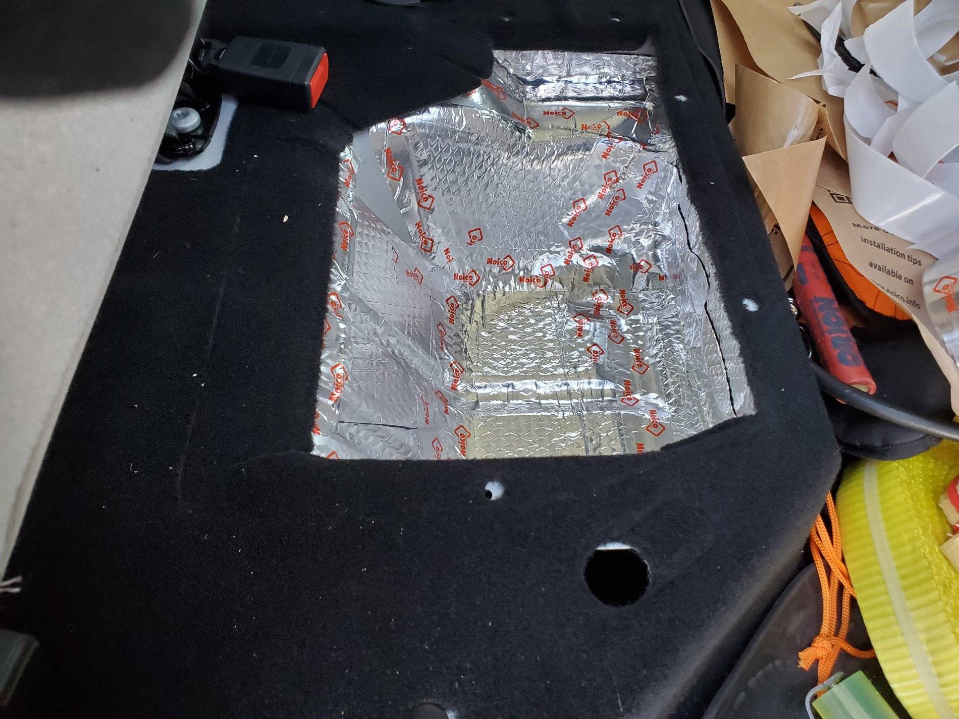

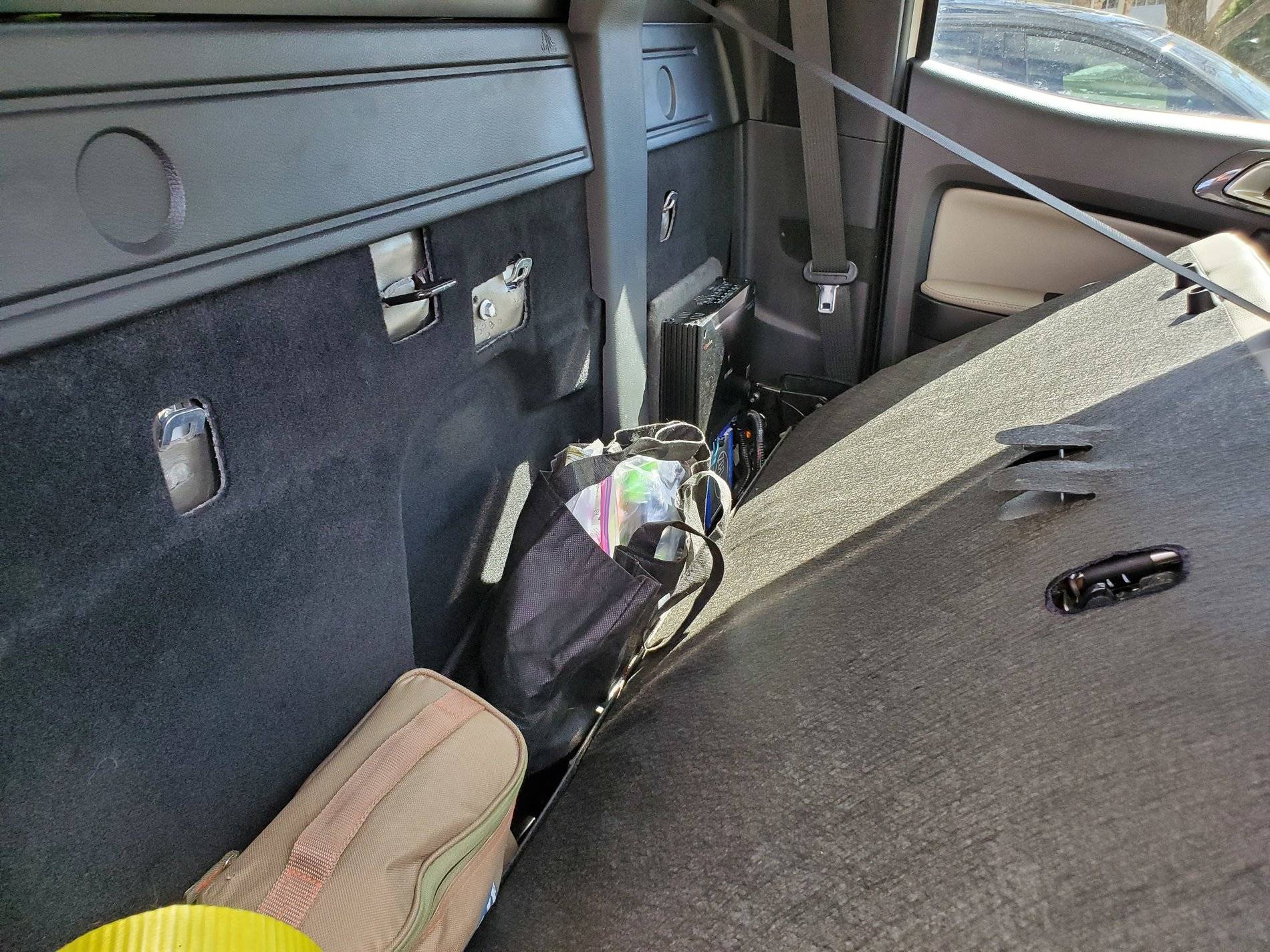

I was able to get the rear panel back in over the sound damping but had some trouble since the old retainer plugs aren't long enough anymore, I can't use them. I'll have to find some longer replacements. For now it's held in well enough from the top plastic piece and from being compression fit in by the 1/4" mdf amp board I made. I put speed nuts in where the B&O amp bolted in so my amp board is cinched in solid, and holds the rear panel in. I also stuffed acoustic foam into every nook I could find that didn't interfere with something.

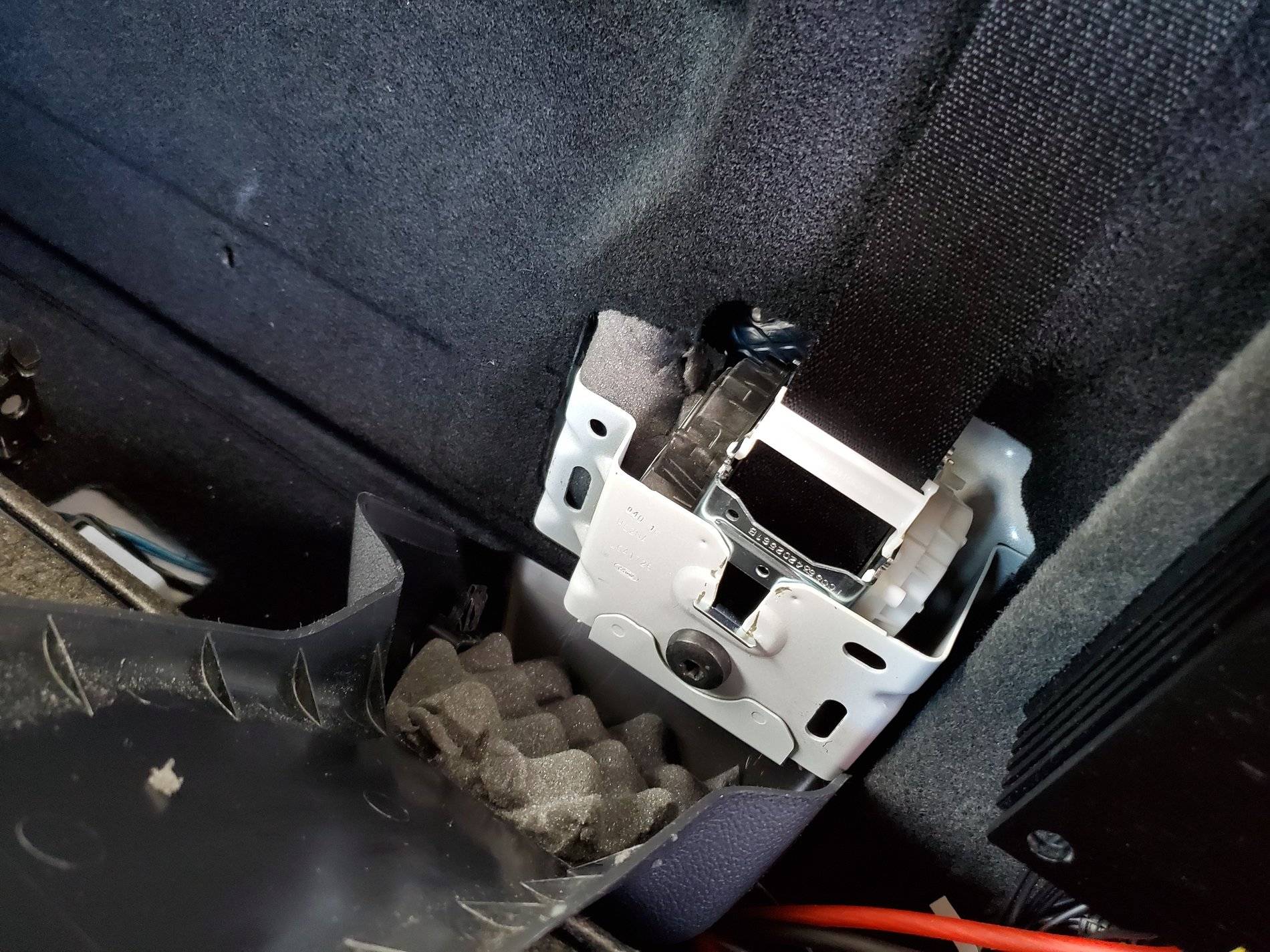

I had an oh shit experience with the middle seat belt. Unbolted and dangling it became permanently locked as if the truck had rolled or something. Nothing would unlock it until I finally rebolted it into its housing and that magically made it happy again, trip to the dealer avoided.
The top rear seat was kind of a pain to mount again, the threaded receivers need to be persuaded into position to realign the bolts. There is also quite a lot of deadening material in the Lariat's rear seat I noticed, it's a lot heavier than it looks. This is probably how they quite down the noise from the rear wall vent noise.

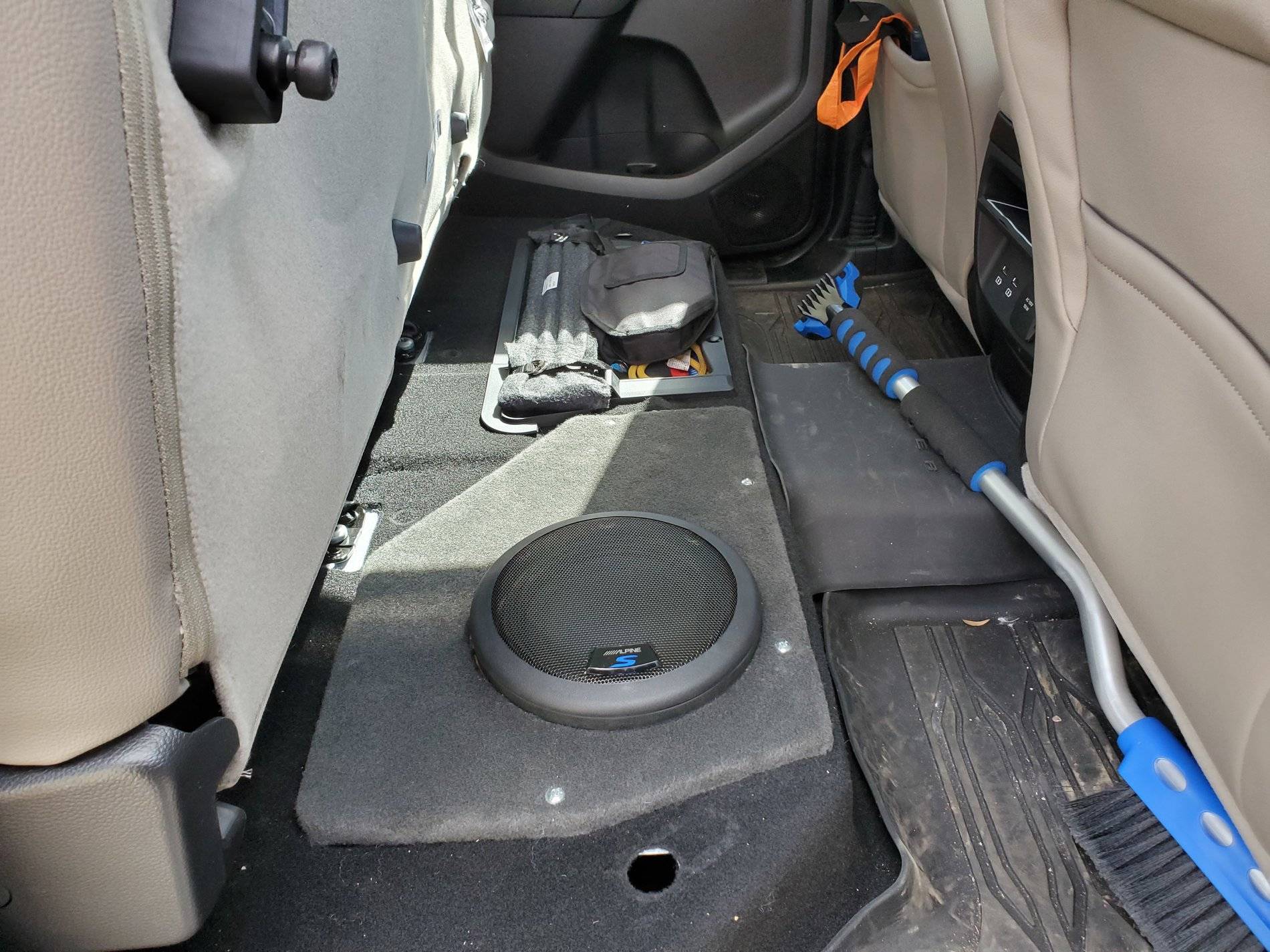

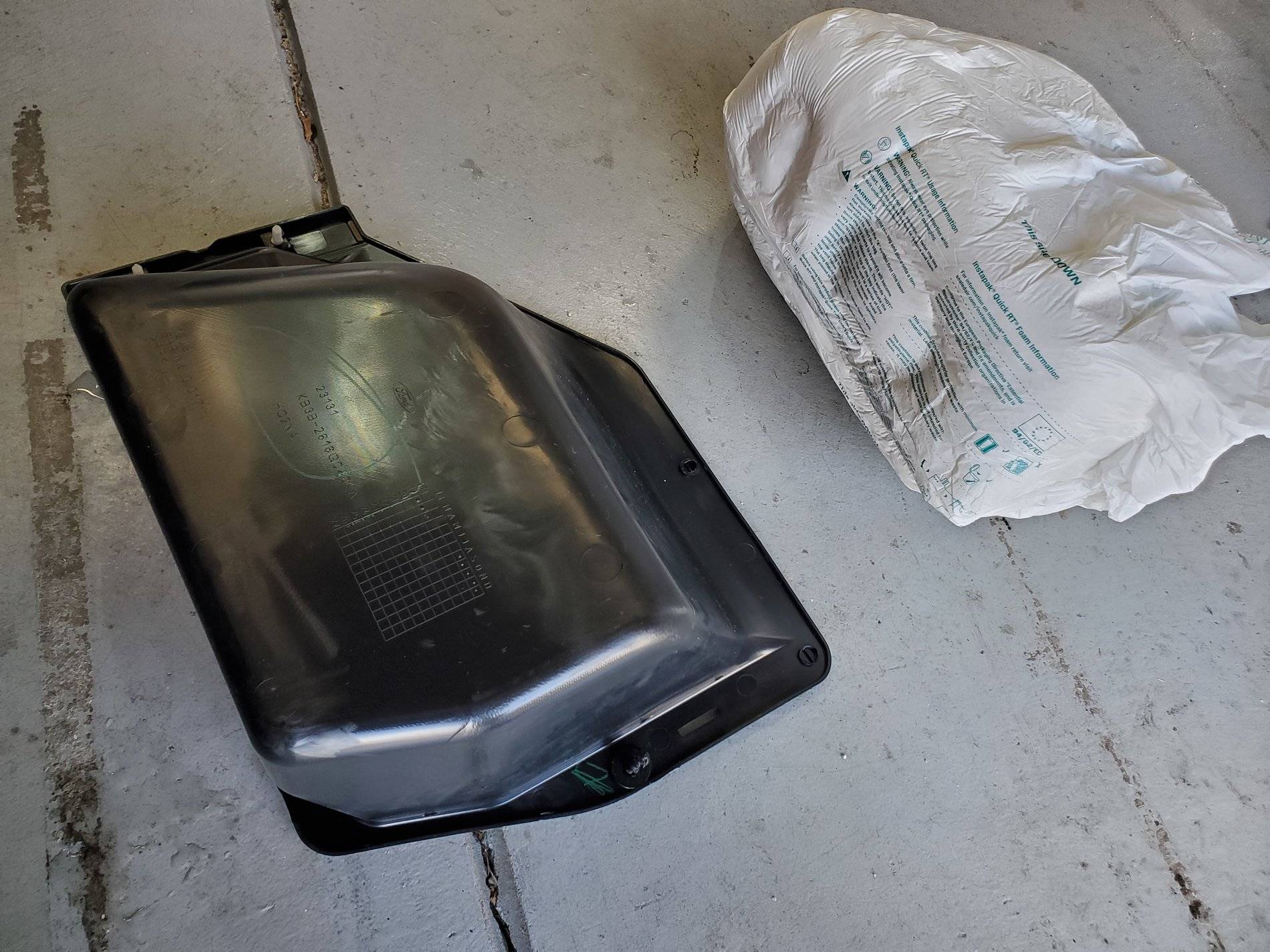

My unconventional sub enclosure seems to work so far. Rather than using the storage tub I decided to use the entire storage bin chassis itself, lined with asphalt deadening to block all the holes. Put a perimeter of foam in to seal the subwoofer baffle that I made down, which is a firm compression fit via #10 speed nuts I put in the original retainer clip locations. I filled the whole space loosely with Acousta-stuf (the real deal).
If I have issues or decide to change later I would consider the fiberglass enclosure for that spot like the one on ebay Australia.
There's a bar in the seat that the sub needs to be lined up to avoid otherwise someone and or the seat could crush it, which is why my sub is forward in the corner like it is. I made my sub baffle out of 1/2" mdf with a 1/4" mdf brace glued in for more rigidity, for 3/4" total, but this combo along with no storage bin gets the surface as flush as possible without a bottom mounted sub. Otherwise the bottom of the seat is a hollow space with flimsy carpet, which my sub actually slightly protrudes into.

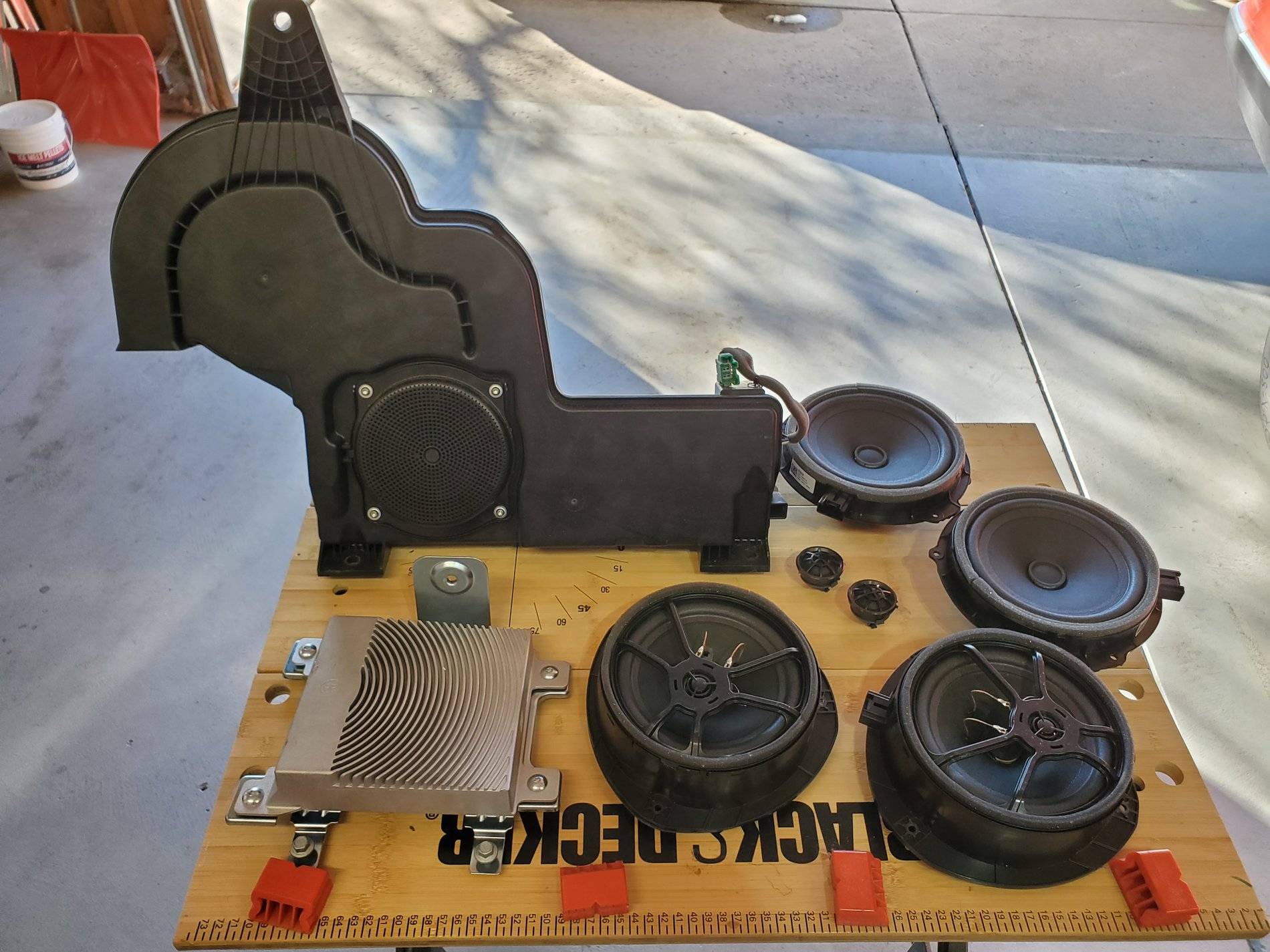

Lastly, here's all the B&O stuff together.

Hi Fusseli
Okay, based on our development of the Ranger Tremor, the sub required a specific volume of the cavity with a tinny lattitude of plus or minus. What does your sub require vs the volume you created? I hope your volume is within spec.... Otherwise, as we found out on Tremor, we failed quite a few Subs. To little or too much seemed to be the deathnell of the speakers.
