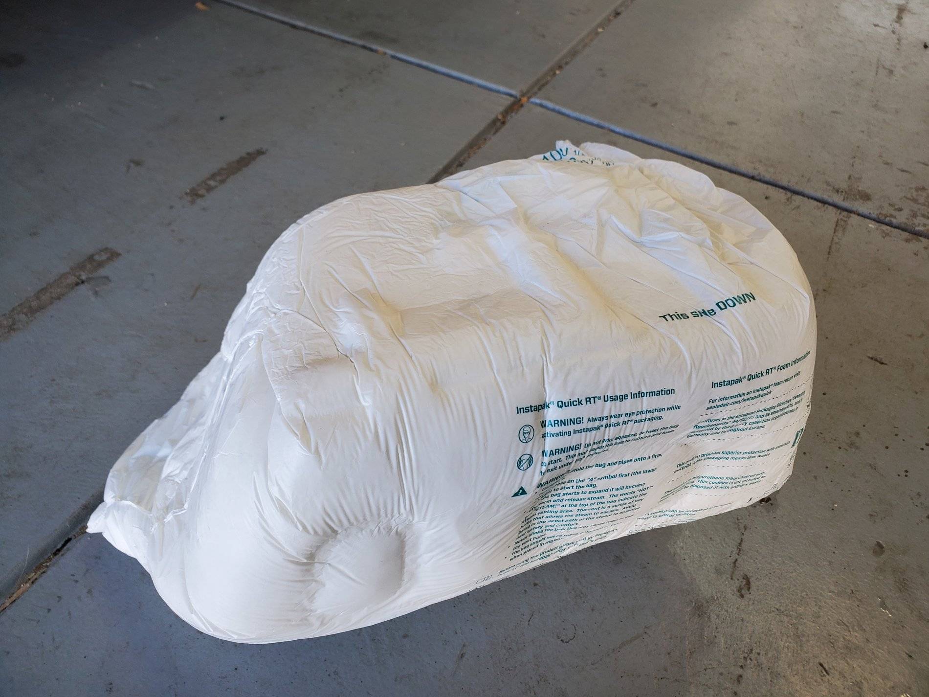

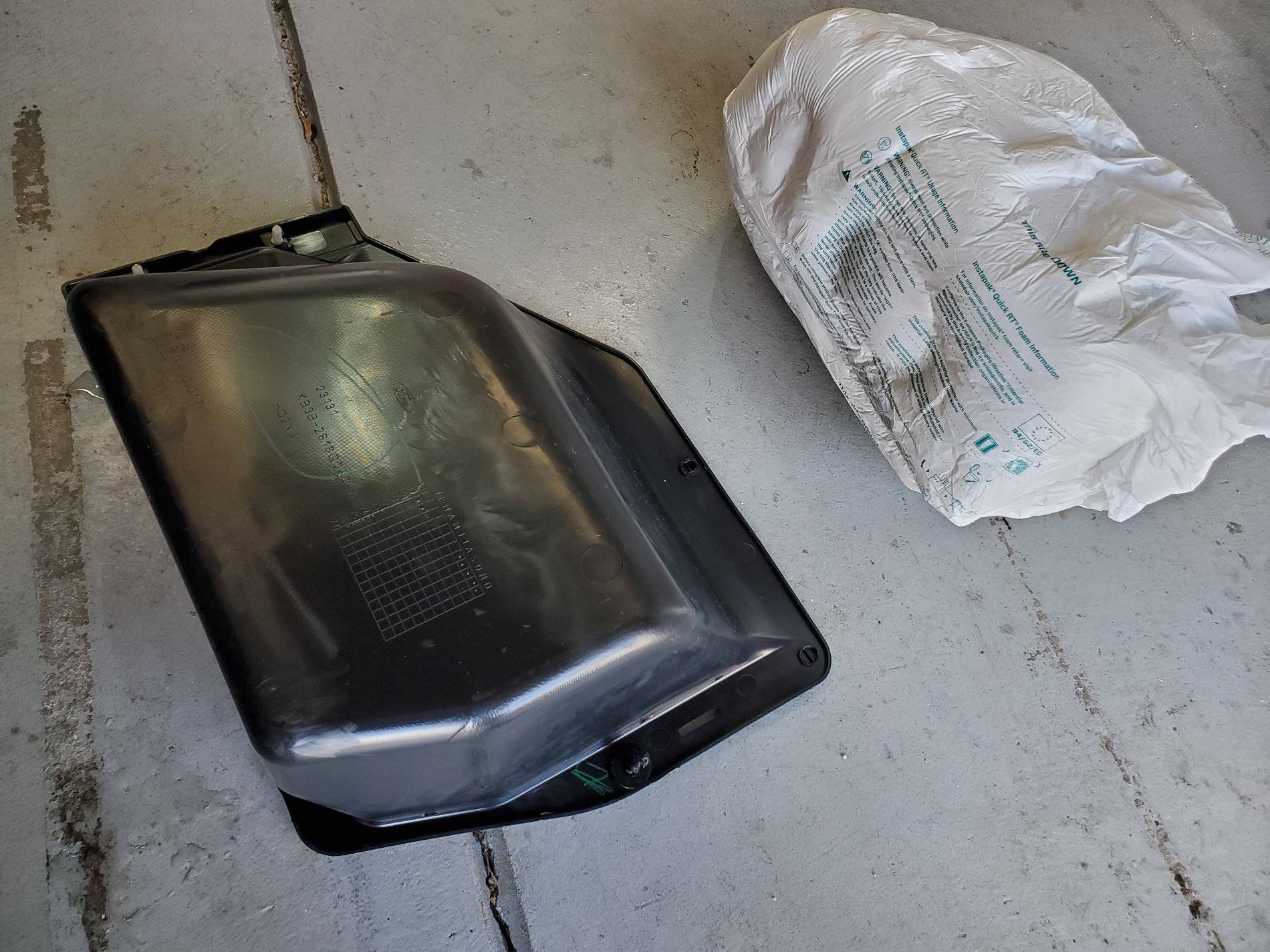

I used your idea with the modeling clay and slaming the seat shut, but instead used they chemically reacting packing foam to measure the cavity of the storage bin, the stuff is called Instapak.
https://www.ebay.com/itm/Sealed-Air-Instapak-Quick-All-Sizes-10-20-30-40-60-80-100-Instapack/133141570169?ssPageName=STRK:MEBIDX:IT&var=432583520445&_trksid=p2057872.m2749.l2649
The space is slightly larger than the storage bin itself but around 0.3-0.4 cuft. I need to go submerge this thing in a 5gal bucket to determine the exact volume. This sub says it's good for 0.15 to 0.5 cuft.

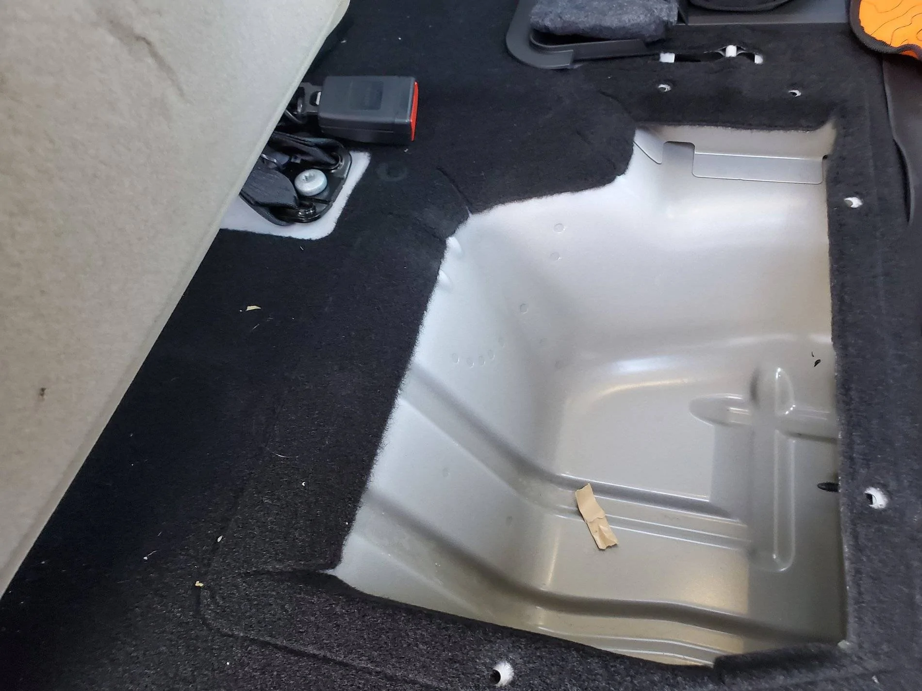

I was going to do this for the space behind the rear seat but haven't yet, since I abandoned the idea of trying to build a subwoofer box to fit the complicated shapes it would need.

Most component systems come with a crossover box for each door. I didn't use the Morel X-over since the B&O has tweeter channels. The cap protects in case the active X-over electronics fail.
There are some fairly large voids and wasted volume behind the rear cabin backing. The whole panel back there tings like a tin can concert hall, this has got to be a huge source of noise left in the Ranger. I drove around with the seat out, backing panel off, and cabin vents exposed and there was quite a bit of road noise almost like having the windows cracked. It seems like they get rid of the vent noise by channeling it down. This is a great investment area for some sound damping and acoustic foam. I did 80mil camping sheets first and then 150mil foam on top of that. I will likely put big chunks of acoustic foam in the big spots when I put it all back together.
I also placed the sub and amp back in place to give a picture of how much wasted air space there is around there. Someone could do really well with a custom rear panel or sub box meant to fit the new Ranger crew cab.
Also pictured is the B&O amp ground, using a stainless bolt, which is the same spot I am putting in my #8 Stinger wiring kit ground.
