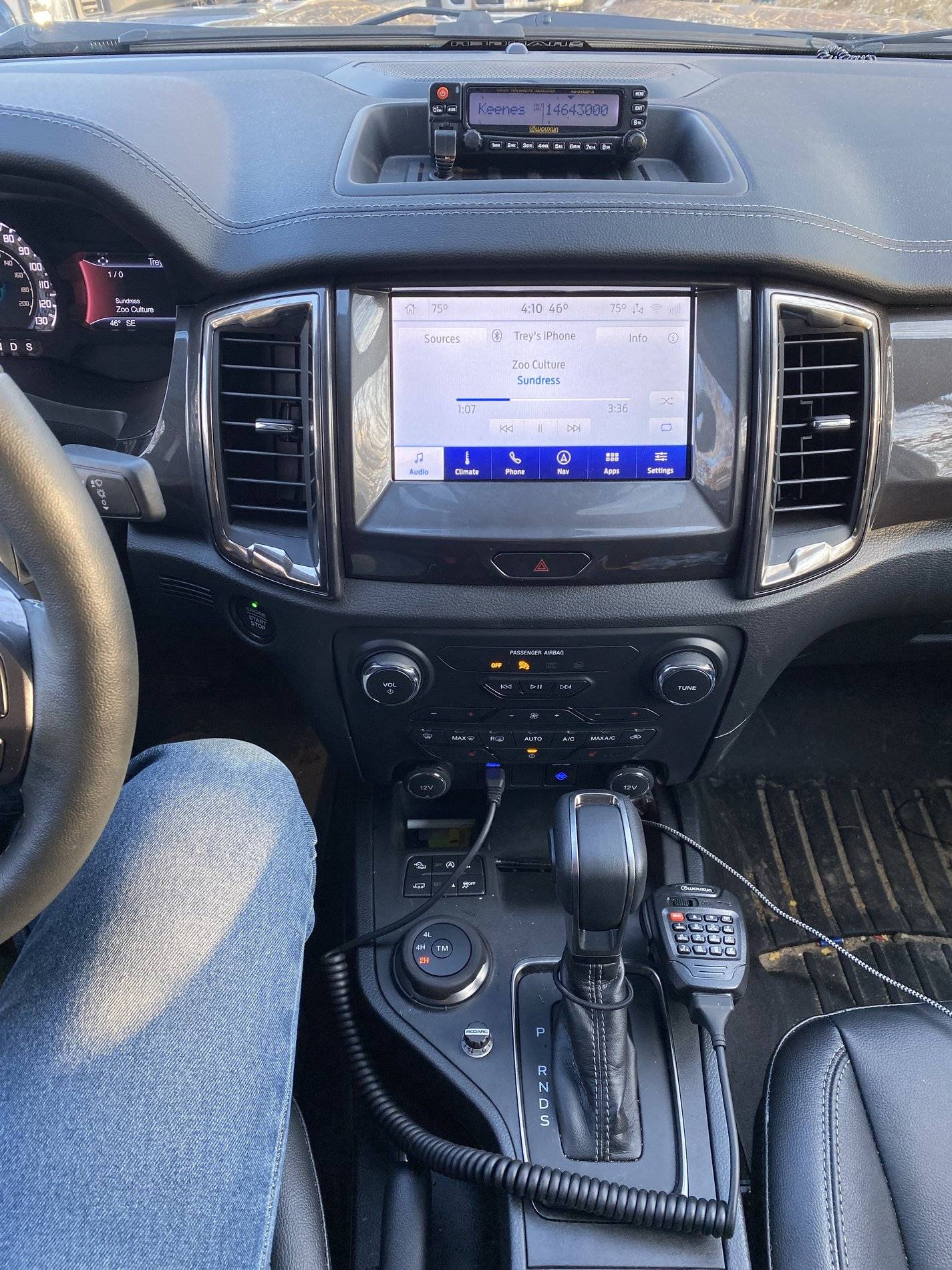

I've been towing a lot of trailers lately, and, while most of them are light, they're getting heavier. Time to install the Redarc Tow-Pro Elite that's been in my back seat for two months.
Installing the Redarc was simple enough, but dang, the factory harness wires are SHORT! They had me bent at all kinds of weird angles under the dash crimping them together. I zip-tied the Tow Pro box to the metal support under the fuse panel under the steering wheel, and mounted the control knob under the drive mode selector. There's a honeycomb structural pattern under that panel, I took a pair of pliers and sort of sheared it off until the back of the rotary knob cleared. There's a TON of room under there to work. To get under that panel, I started at the cupholder seam with a plastic trim tool and gently pried up the clips all the way to the front. I left the front clips in place and just hinged the rear of the panel upward enough to work.
While I was under the dash playing with electricity, I finished running power to my Wouxun KG-UV920P-A 2-meter/70-centimeter radio. I had already mounted the faceplate in the dash tray, the speaker mic on the console through the Lightforce fascia, and the antenna through the roof, so it was time to mount the radio chassis. I don't have a photo, but I mounted it on the C-pillar right where the rear seat hinges, so I can reach it for programming without moving the seat.
Here's an updated view of my console, also featuring Sync 3.4

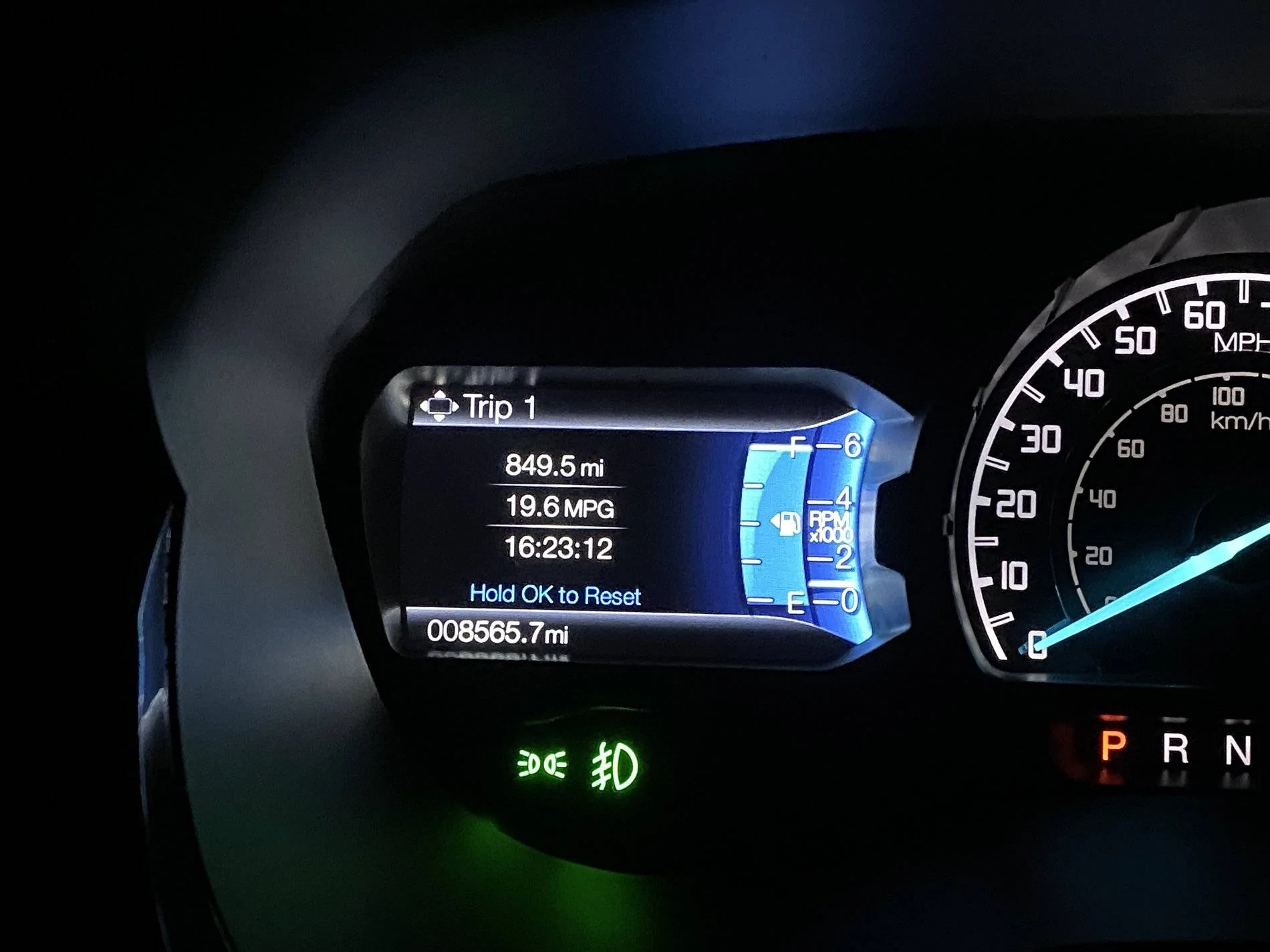

First off, a trip to Atlanta and Charlotte for my girlfriend's birthday weekend. I took her to her two favorite places, the Georgia Aquarium and ST Octane Academy! 2,467.9 miles. The trip fuel economy worked out pretty close to the hand-calculated 20.4 MPG.
