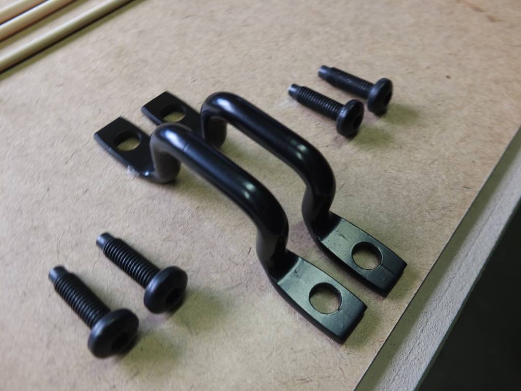

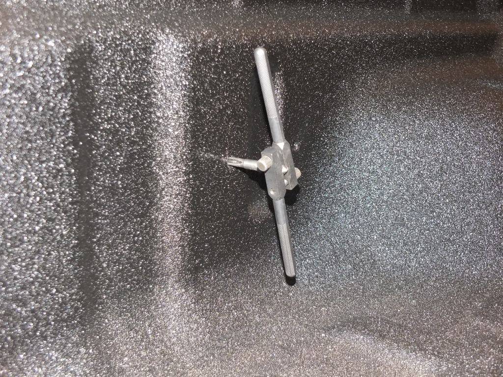

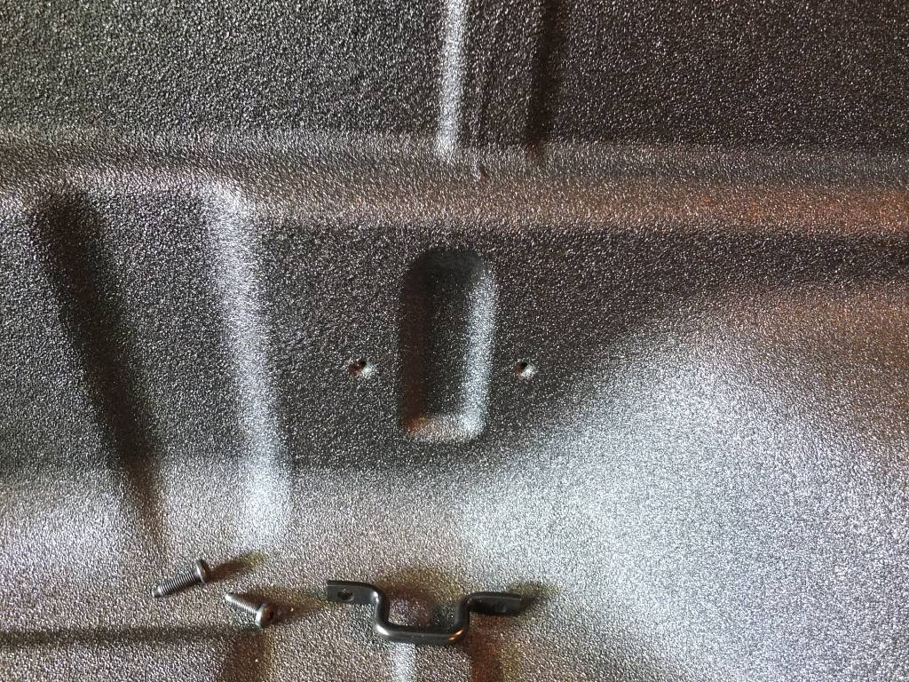

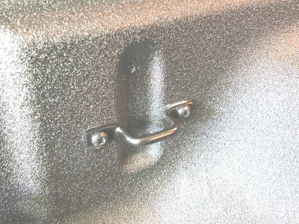

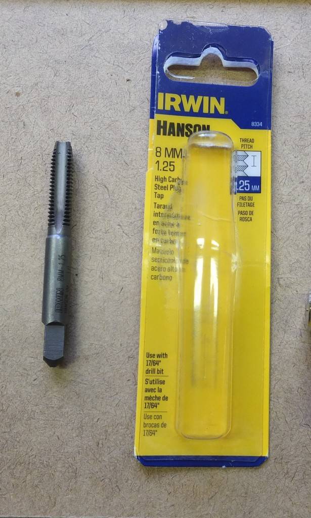

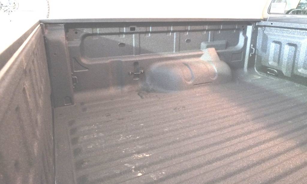

Installed Bed Tie Down Brackets
Continued from Pickup Box Bed Tie Down Hooks and Bolts

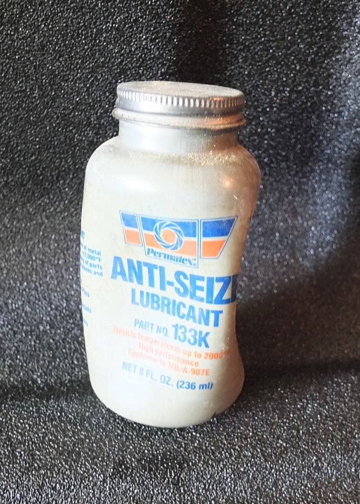

Pretty straightforward. Used a Metric 8mm - 1.25 tap to clean the bed liner out of the tapped holes. And used some never seize on the screw threads. The bolts use a T-40 Torx bit.

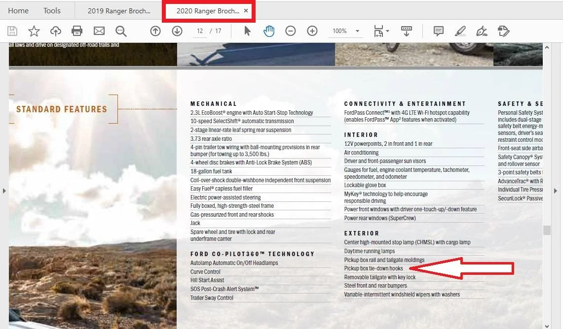

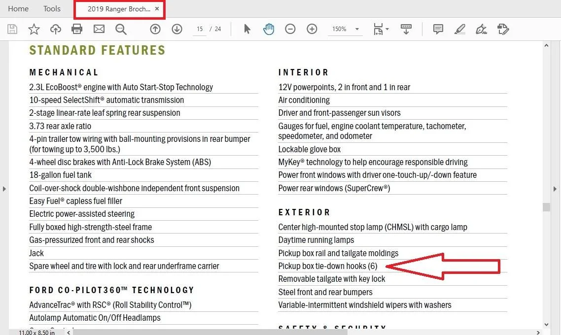

Edited 12-26-2019. Something to keep in mind, our SuperCab Ranger is a 2019 model. The 2019 Brochure states (6) Tie Down Hooks... the 2020 doesn't state quantity. Therefore a savvy dealer could state you have no grounds to justify additional tie downs on a 2020 Ranger.

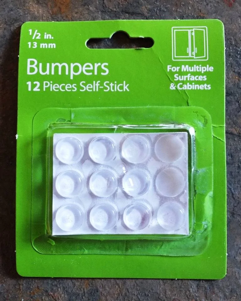

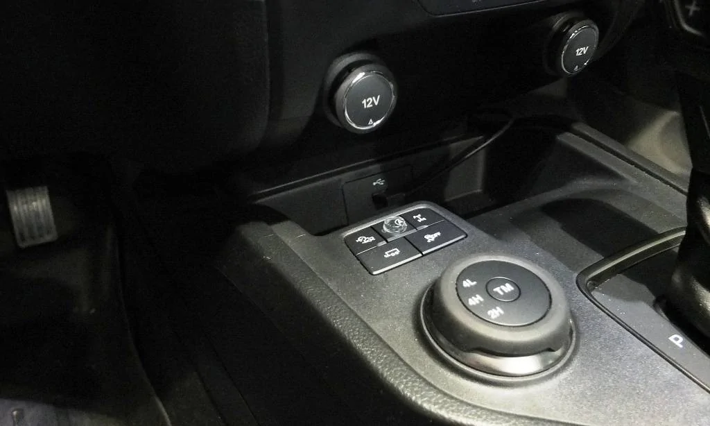

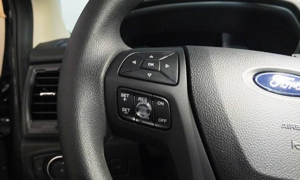

Tactile Bumpers For Cruise Control and Auto Start/Stop
Credit goes to member jubreunig for this idea :like:
Taking your eyes off the road to operate the Cruise Control buttons or to push the Auto Stop/Start button could end up with disastrous results.
Adding these little bumpers allows you to feel where the controls are, while keeping your eyes on the road.
The bumpers are available at Walmart in the hardware department.
I could swear Ford used to have a built in bump on their steering wheel mounted cruise control buttons back in the 90's???

+1 on the button bumpers.
A pet peeve of mind is the dimmer lighting because I like low lighting at night. That makes it very low during daytime. So instead of using the dimmer all the time I have a hard time seeing the AC + & - controls.
I’m going to add these to those buttons. :thumbsup:

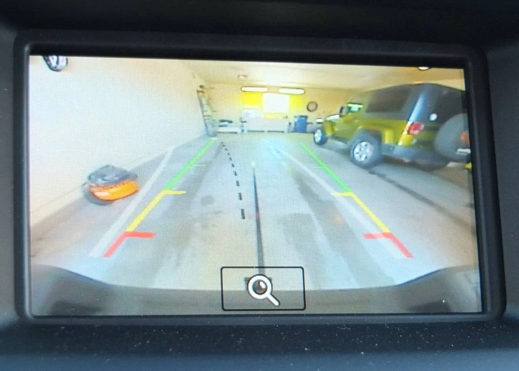

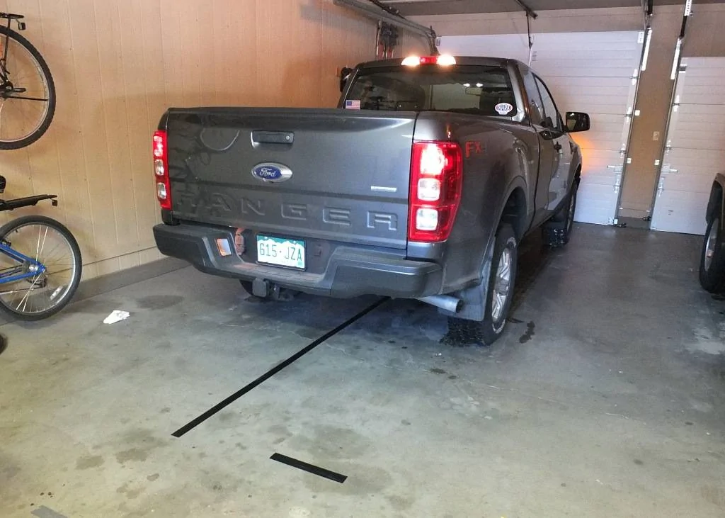

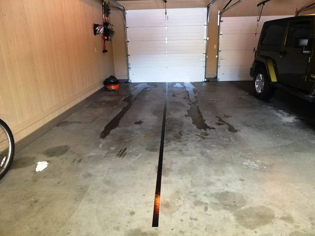

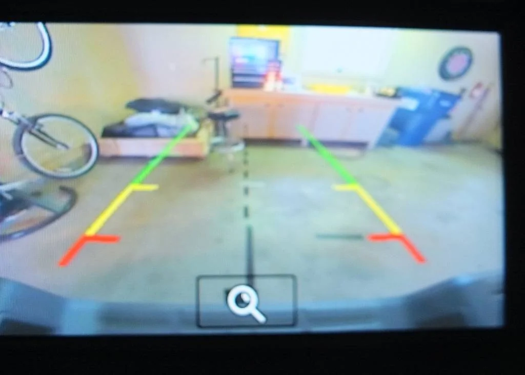

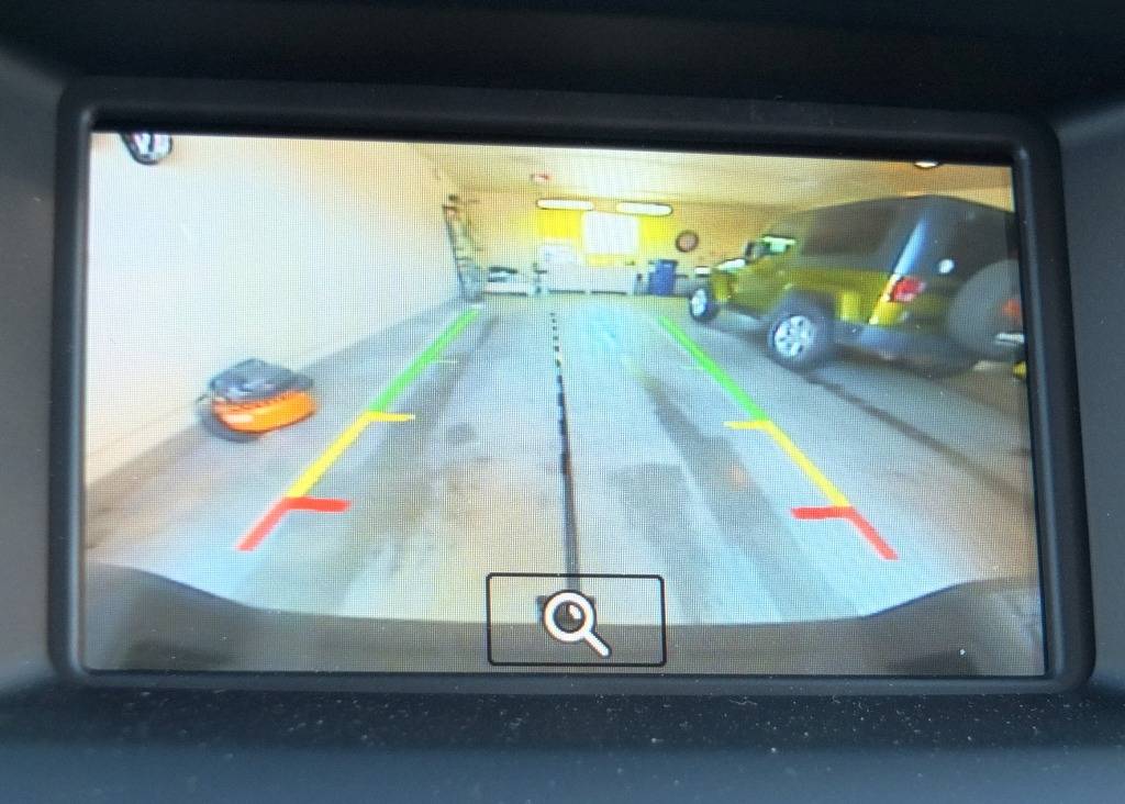

Garage Floor Gorilla Tape For Back-Up Camera... Teaching An Old Dog A New Trick
Since September I've been using the mirrors on our new Ranger pickup to back into the garage. That works on occasionally when I get out of the truck, when the drivers door is wide open, the door touches the wall if I don't get the truck centered up just right.
Our Ranger is the first vehicle we own that has a back up Camera.
Today I put a piece of Gorilla Tape down the center of the garage bay where I park the Ranger. Now I can get the truck in the same spot, every time. And I added another piece of tape at the back of the garage so I know when I'm back far enough.
Easy Peazy...

Sometimes the simplest ideas work the best... that’s not a bad idea at all!

I’ll be doing that under my car port.
edit: “Truck port”.

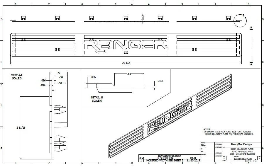

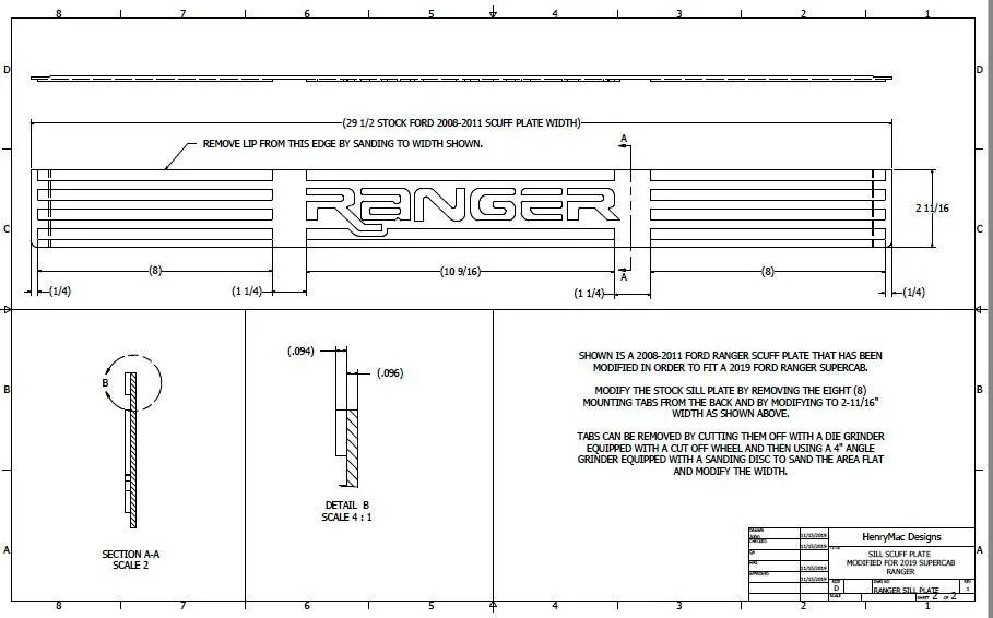

Drawing of the Door Sill Scuff Plates...
Just in case anybody want's to modify some of these for other applications.... here's a couple drawings and a pdf.
This is a GREAT idea!
