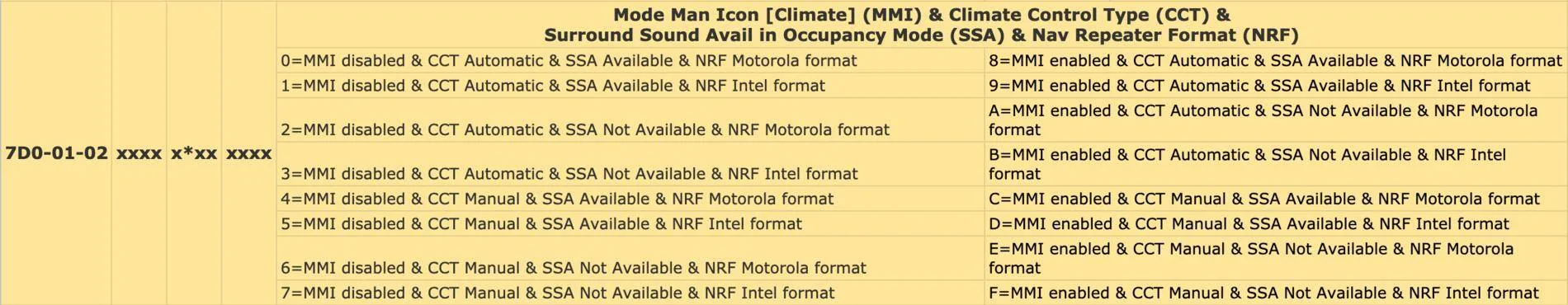

Confirmed - I had to write all the values in order for it to take, but the only change was 5553 from 5753. I now have the "US" radio format and US format speed signs again. I did find out this is definitely the "navigation in motion" change - when it was swapped I was able to search for a navigation destination while moving.
Little update: I copied your configuration and while the climate button was on the screen, none of the buttons on it worked. Also my TCS Off button stopped working, diff wouldn't lock, vents only blew defrost, etc, so I changed it back and looked at the F-150 spreadsheet to narrow down exactly what needed to be changed.
The only 2 values I changed from my config were
7D0-01-02
xxxx x8xx xxxx (the last two are a checksum in hex, I just added 8 to the current value as my previous value in the sixth position was 0)
7D0-04-01
xxxx xx0x xxxx (last two are a checksum again, mine changed from 9C to 1C)
7D0-01-02
7D0-04-01
I had to write the entire APIM module in order for it to take. I have a 2 in the position where you have an 8 in 7D0-01-02. Do you have the 501a package on your Lariat? The Climate screen is functional on mine with that setting with Sync 3.4. If/when the official 3.4 comes out, I will most likely use that in order to fix any oddities that @UofMEngineer said might occur with the unofficial release.
I do have a 501a Lariat, which is why I was surprised your configuration didn't work. According to the F-150 sheet, these are the differences in the values.
Ford Ranger RCMUSTANG's Magnetic FX4 Screen Shot 2020-01-25 at 1.37.45 PM
I used 8 because it changed my original value of 0 from MMI Disabled to Enabled without changing anything else.

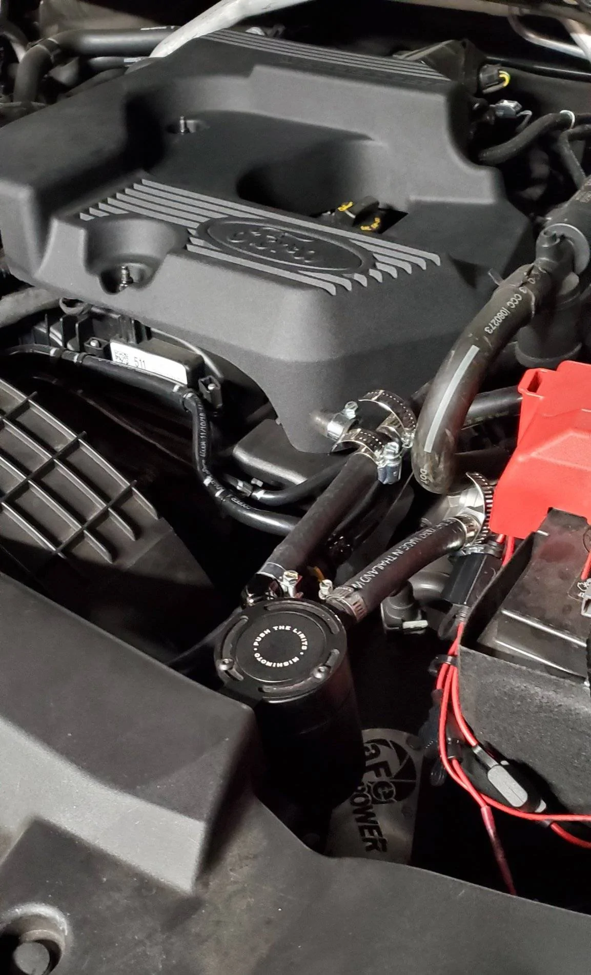

Based on 5,000 miles of testing I've picked up virtually nothing but condensation on the boost/breather side. Switched back to PVC only for the catch can.

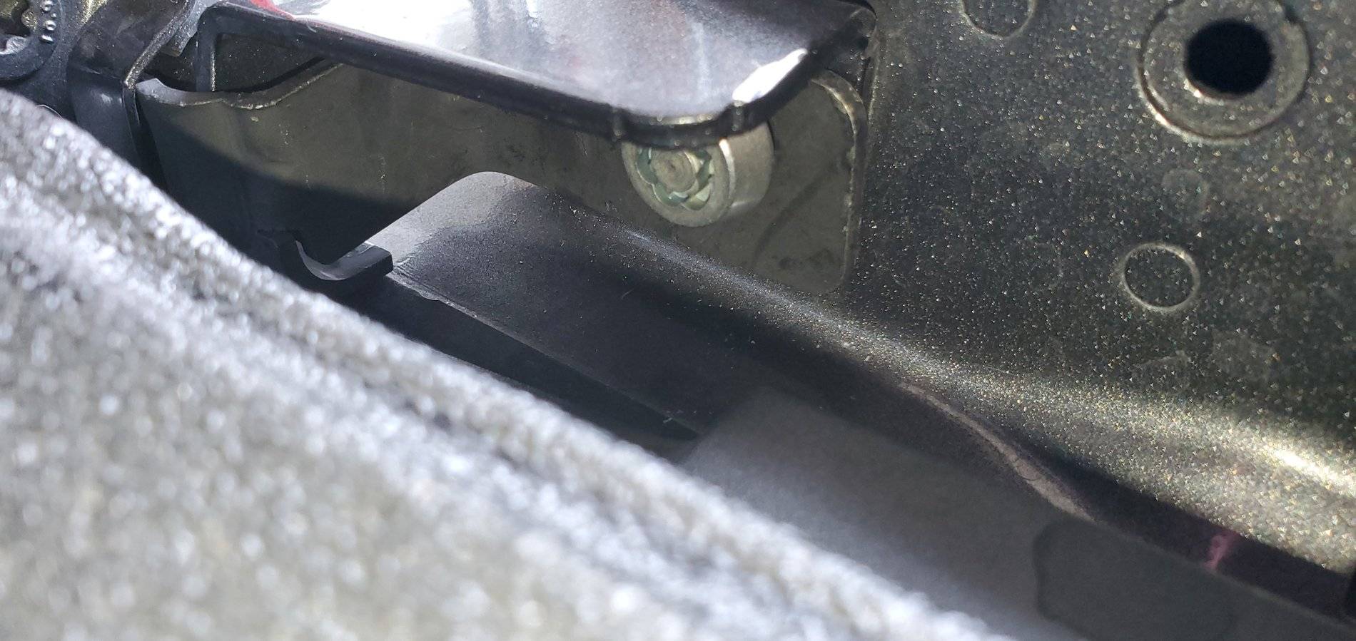

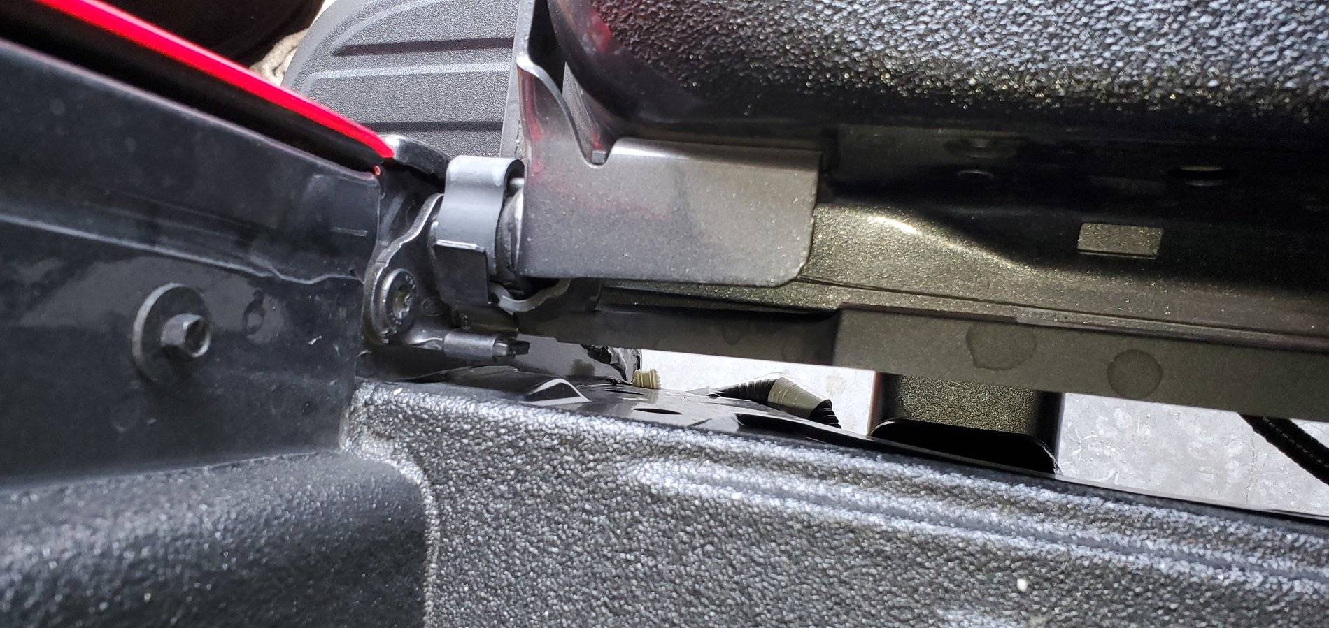

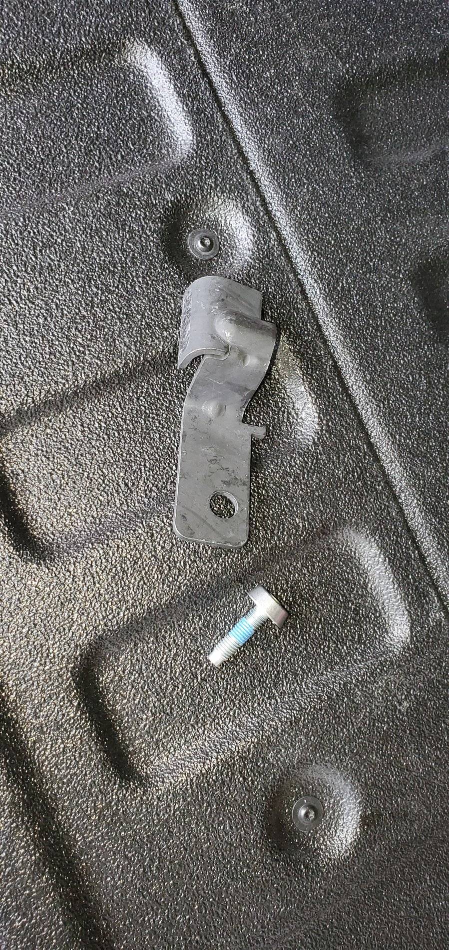

Tailgate lock. Good luck stealing the tailgate. Prevents the tailgate from lifting off the hinge. Pretty thick gauge steel. McGard under contract to Ford. Just like the DeeZee tailgate dampener. You won't see them outside of Ford till the contract is over. VKB3Z-18168-A
Ford Ranger RCMUSTANG's Magnetic FX4 20200209_115408
Ford Ranger RCMUSTANG's Magnetic FX4 20200209_115136
Ford Ranger RCMUSTANG's Magnetic FX4 20200209_115127

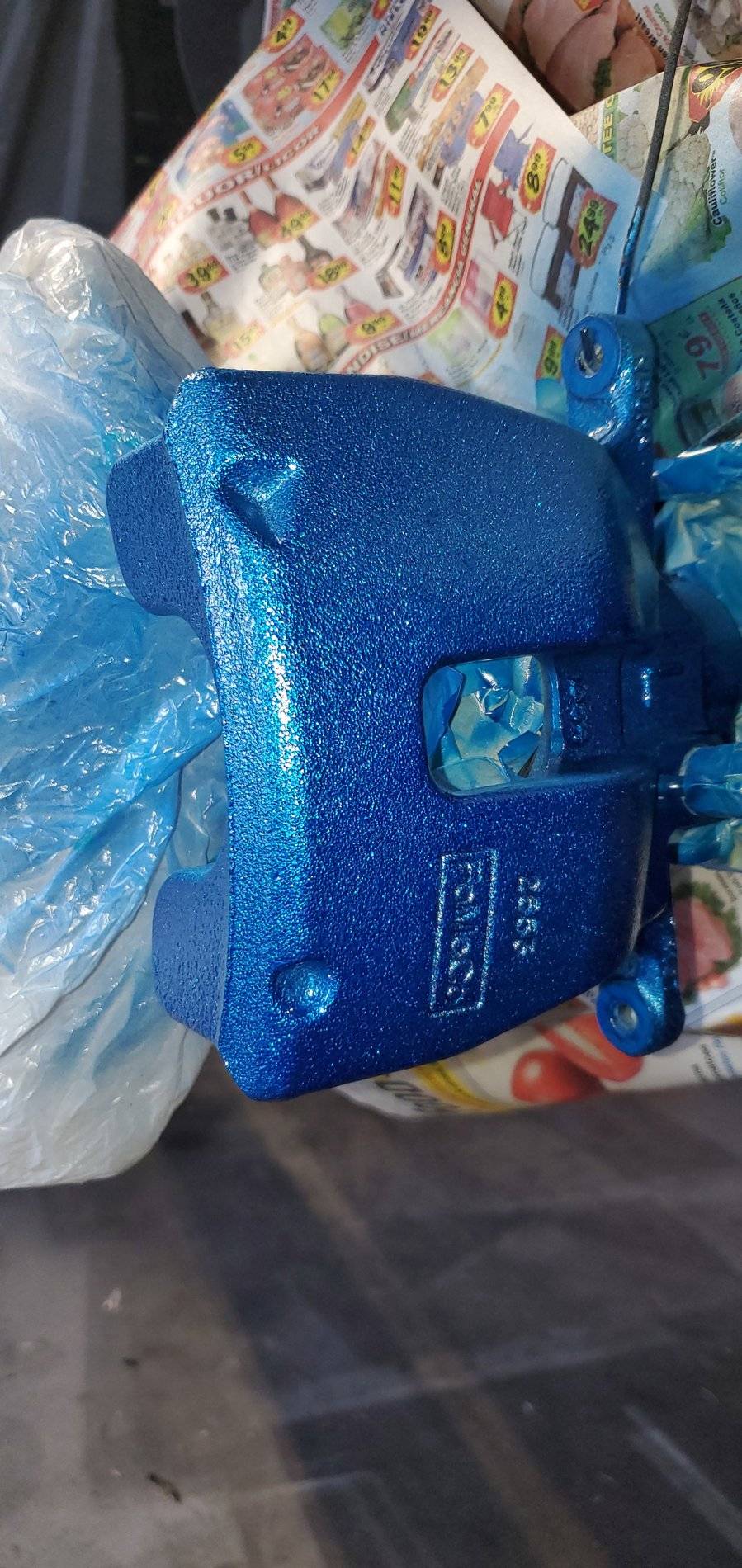

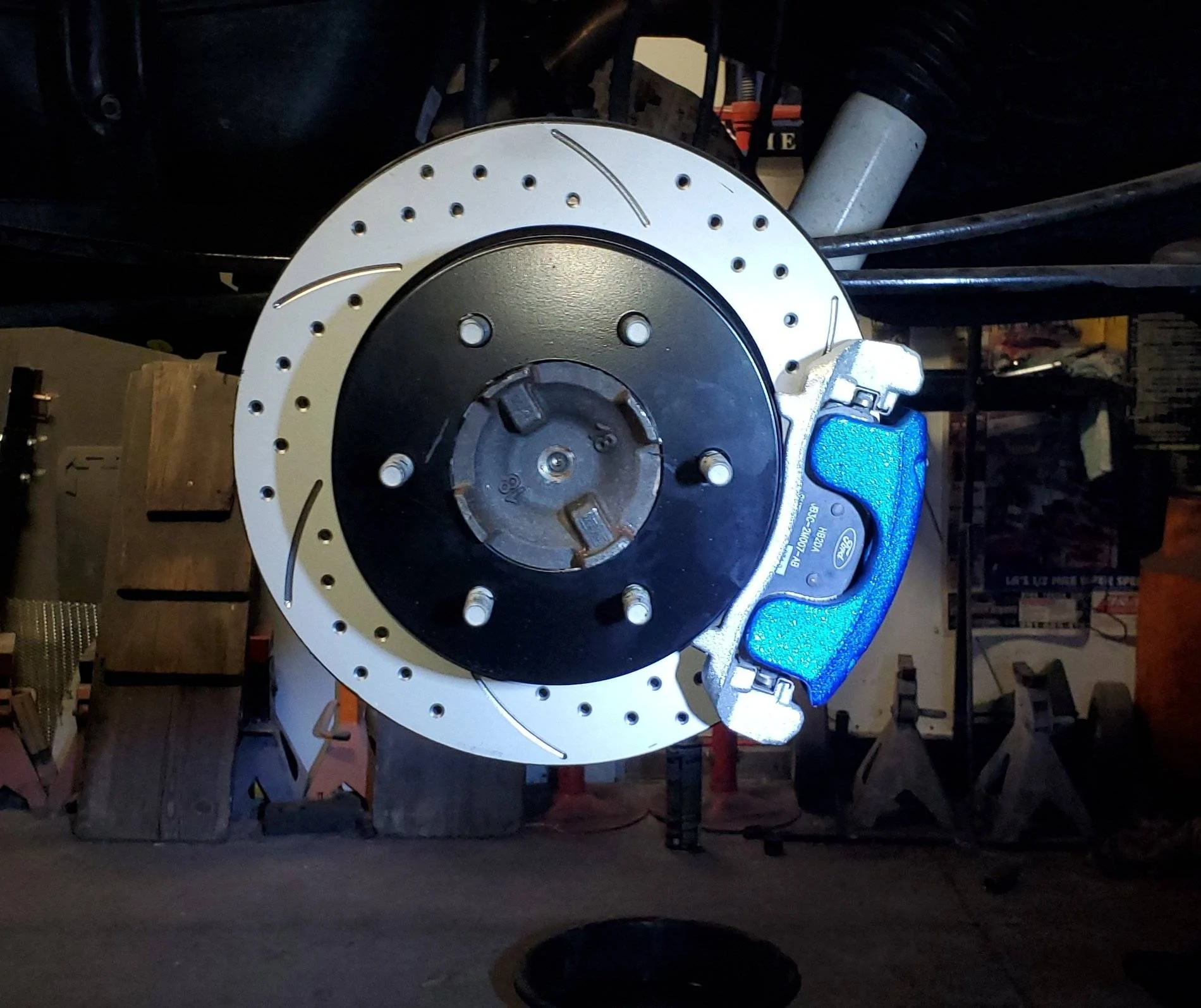

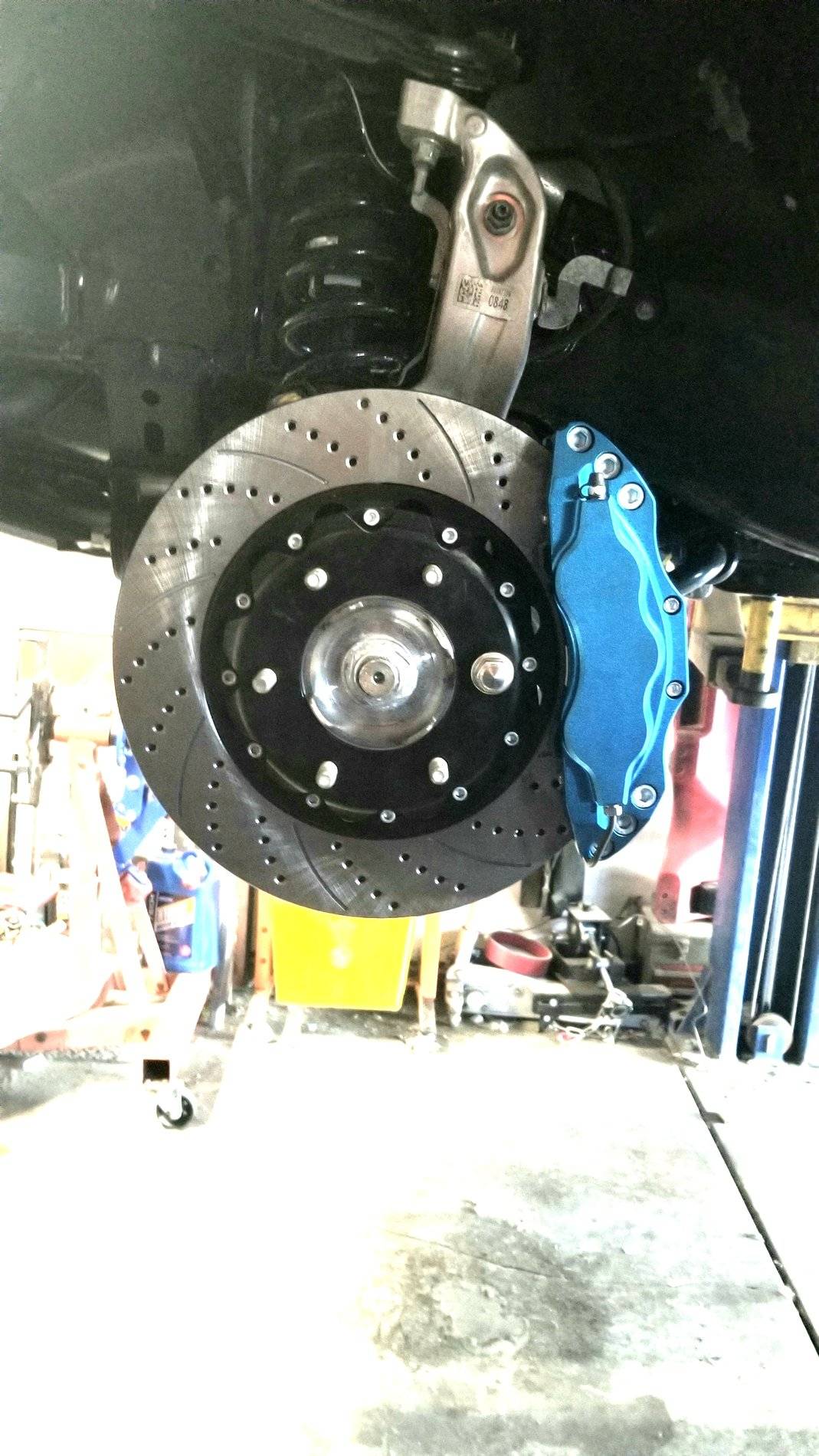

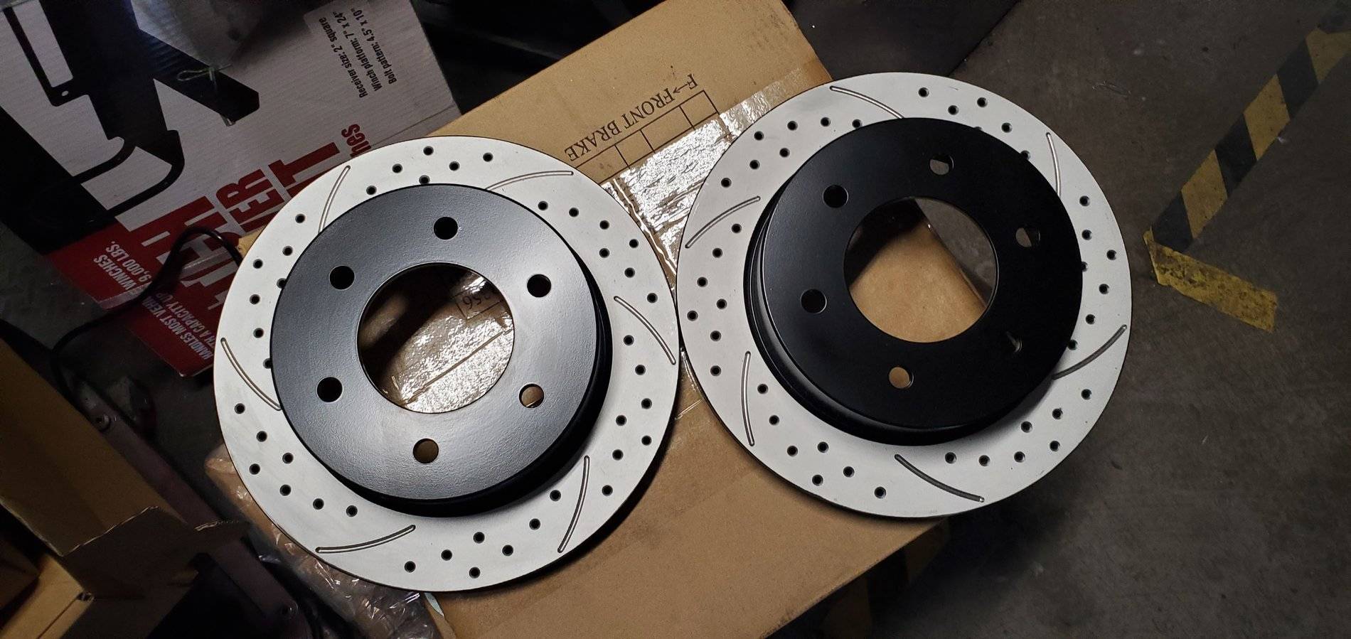

Project match front brakes.
Ford Ranger RCMUSTANG's Magnetic FX4 20200228_181845
Ford Ranger RCMUSTANG's Magnetic FX4 20200228_171812
Ford Ranger RCMUSTANG's Magnetic FX4 20200228_171206
Ford Ranger RCMUSTANG's Magnetic FX4 20191124_183416

Just painting the rotors and what not? or new beefier breaks? Always following what you up too...
RCMUSTANG
RCMUSTANG
Ray
Jan 22, 2019
1,073
255
Los Angeles
2017 Fusion 1995 Ranger
Just replaced the rotors and painted the calipers to match.
