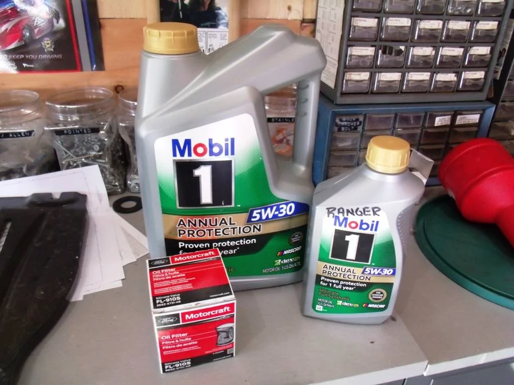

First Oil Change... and Rotated Tires

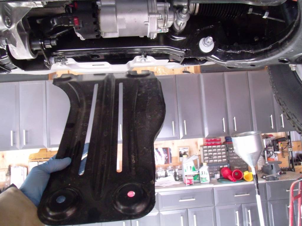

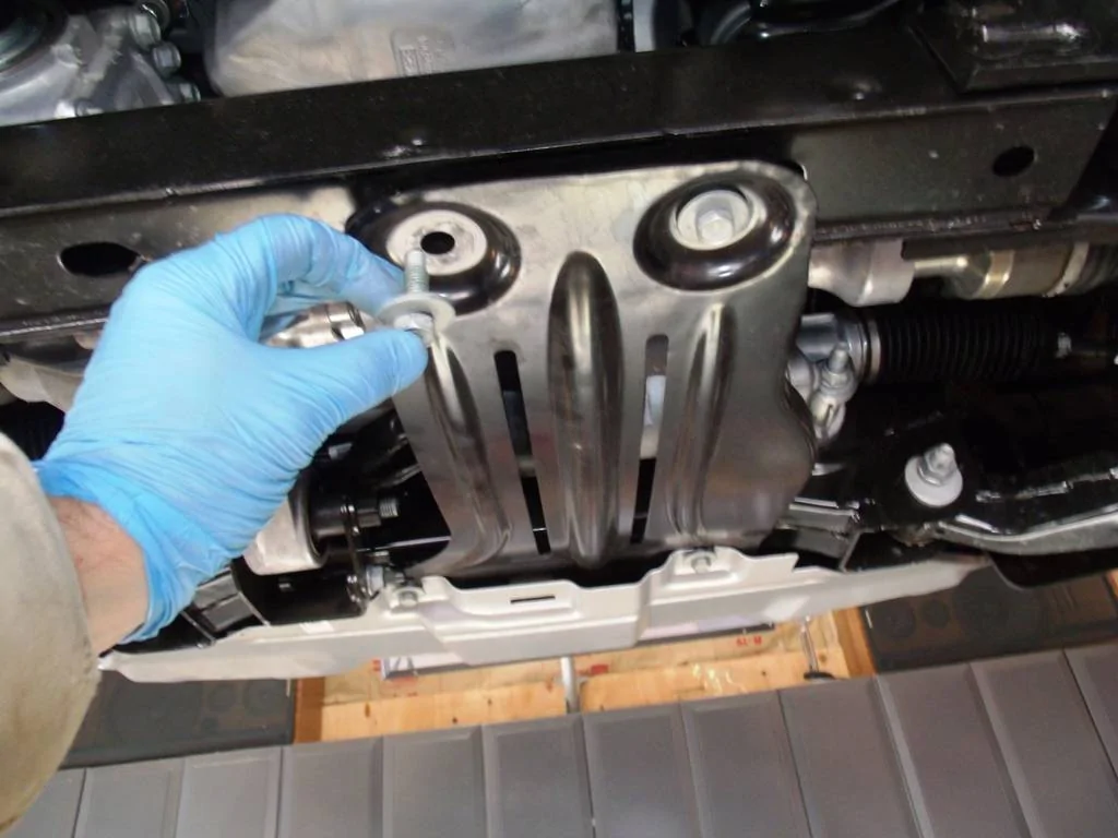

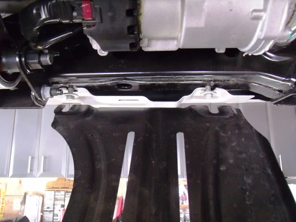

Our truck almost has 4,000 miles, and we finally got a day above freezing, so I did the 1st oil change and rotated the tires on our 2019 SuperCab.
The skid plate needs to be removed. It has (4) bolts holding it on. Only the rear (2) bolts need to be removed. The front (2) bolts only need to be loosened since the front holes on the skid plate are slotted.
Ford Ranger HenryMac's Build Thread: 2019 Ranger XL  STX  FX4 Magnetic Super Cab 001
Ford Ranger HenryMac's Build Thread: 2019 Ranger XL  STX  FX4 Magnetic Super Cab 002
Ford Ranger HenryMac's Build Thread: 2019 Ranger XL  STX  FX4 Magnetic Super Cab 003
_______________________________________________________________________________

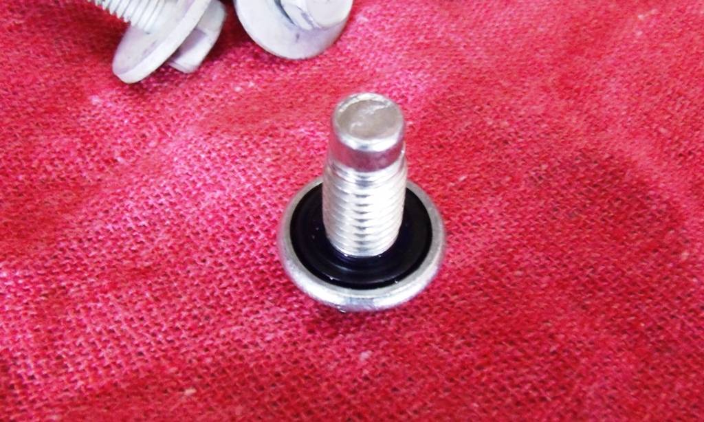

The skid plate bolts and the oil drain plug are all removed with a 15mm socket. And the oil drain plug has a built in elastomeric gasket. Well done Ford.

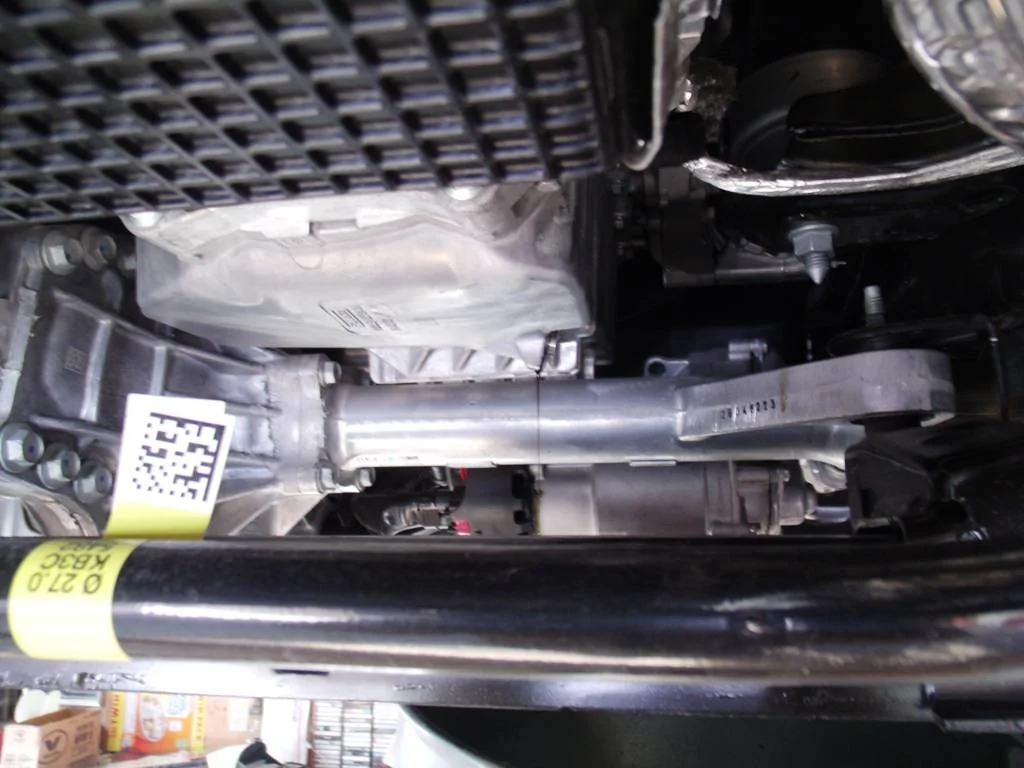

The oil drains out of the pan without hitting any suspension components or brackets... again...well done Ford.

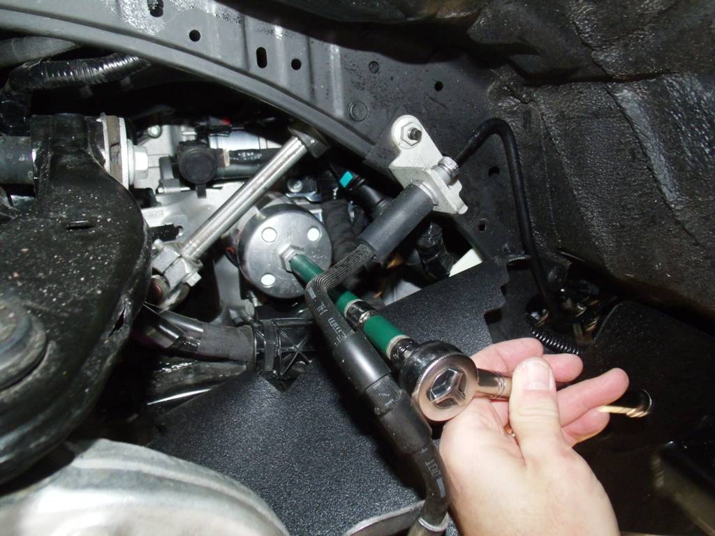

I removed the front drivers side tire... since I was rotating the tires anyway. The filter that came from the factory was different than the FL-910S Motorcraft filter. My filter wrench just spun on the factory filter.... shit! My filter wrench fits nice and snug on the FL-910S?
Ford Ranger HenryMac's Build Thread: 2019 Ranger XL  STX  FX4 Magnetic Super Cab 006
Ford Ranger HenryMac's Build Thread: 2019 Ranger XL  STX  FX4 Magnetic Super Cab 007.JPG
_________________________________________________________________________________

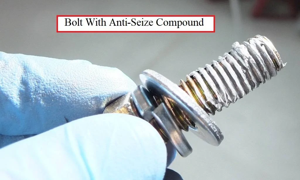

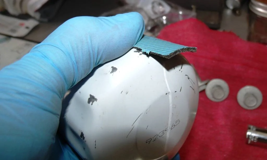

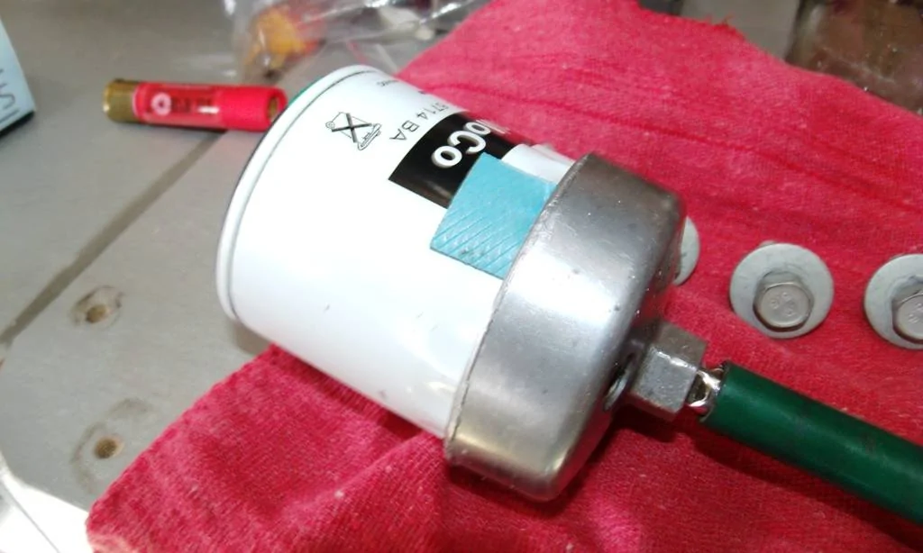

I tried some different wrenches I had, those didn't work. ended up wedging a small piece of rubber friction tape. between the wrench and the factory filter. That worked. Pictures are after removal, just to show what I'm talking about. The trough Ford supplied to capture and re-rout the oil that runs out of the filter worked great. Well done Ford.
Ford Ranger HenryMac's Build Thread: 2019 Ranger XL  STX  FX4 Magnetic Super Cab 008
Ford Ranger HenryMac's Build Thread: 2019 Ranger XL  STX  FX4 Magnetic Super Cab 009
Ford Ranger HenryMac's Build Thread: 2019 Ranger XL  STX  FX4 Magnetic Super Cab 010
Ford Ranger HenryMac's Build Thread: 2019 Ranger XL  STX  FX4 Magnetic Super Cab 011

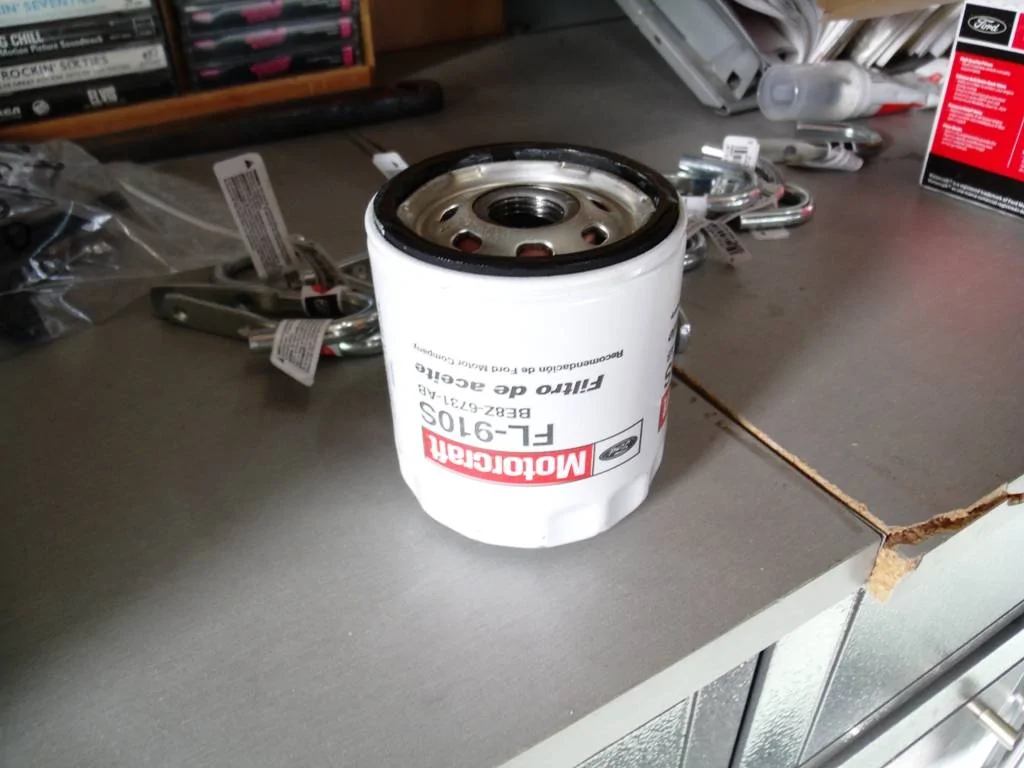

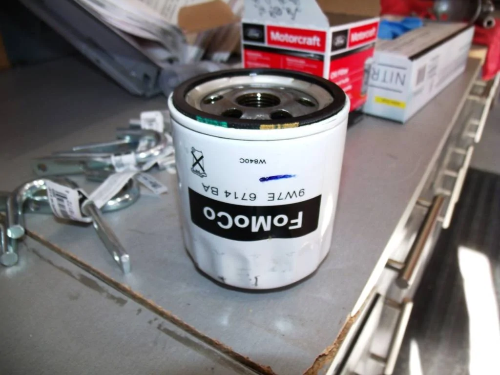

I then installed the new FL-910S Motorcraft filter, easy peasy.

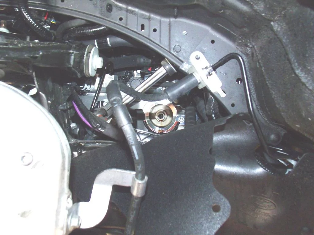

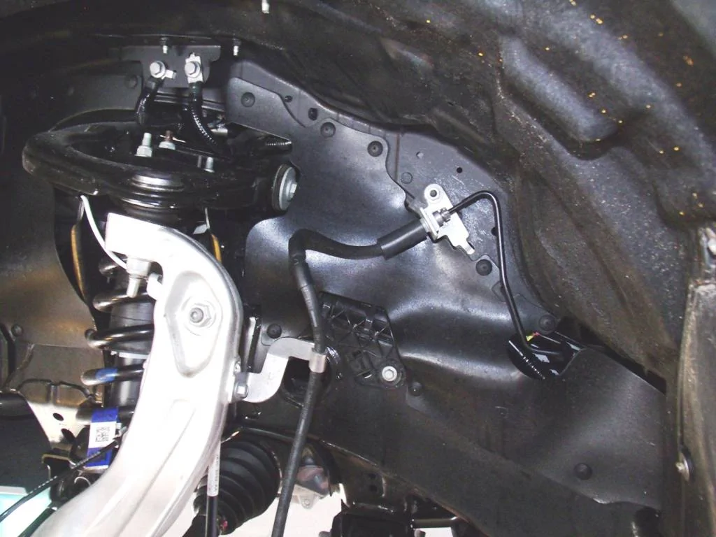

The cover in the wheel well needs to be removed down past the brake line to allow cleaning out the oil filter trough. I shot some brake cleaner in the trough and then wiped it out with a paper towel.

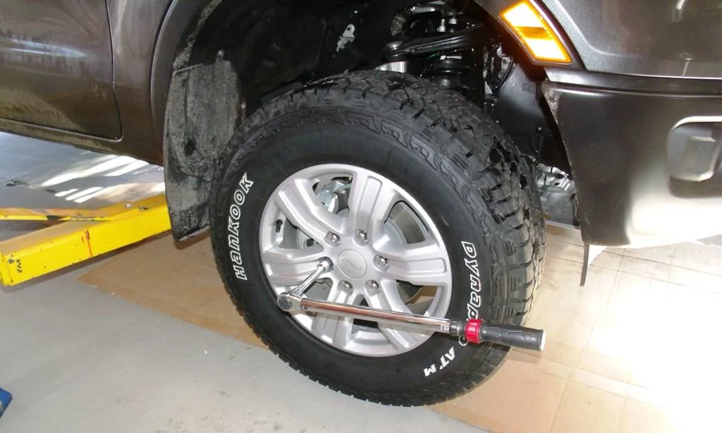

Buttoned everything back up and then used 6 quarts of Mobil 1 5W-30 Annual Protection.
Ford Ranger HenryMac's Build Thread: 2019 Ranger XL  STX  FX4 Magnetic Super Cab 013
Didn't spill a drop of oil on the floor. I'd say Ford gets a 9 out of 10.
Rotated the tires, torqued the lug nuts to 100 ft-lbs.. and we're good for another 4,000 miles.

About the carpet in fender wells, that is the exact thing I questioned myself. Its on both my Fords, only the rear though.
I'm told it's supposed to act as a sound deadener... helps keep noise down.

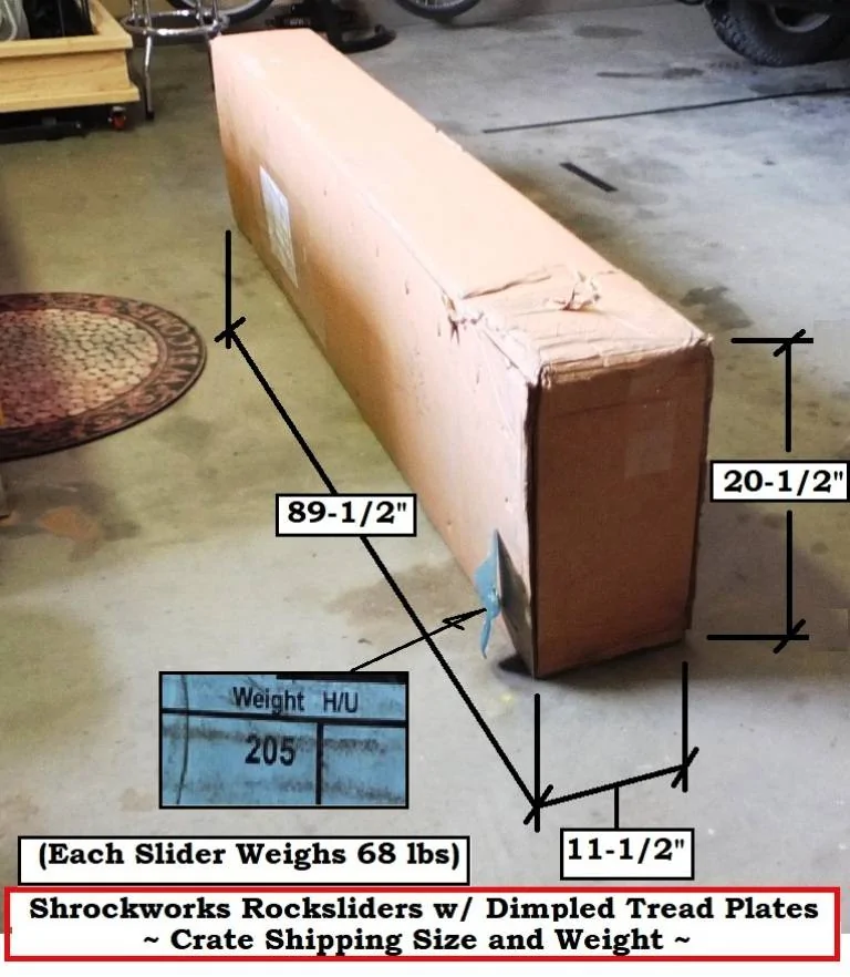

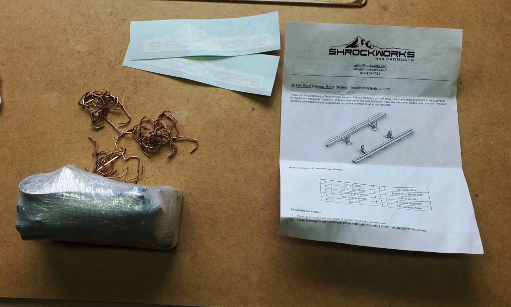

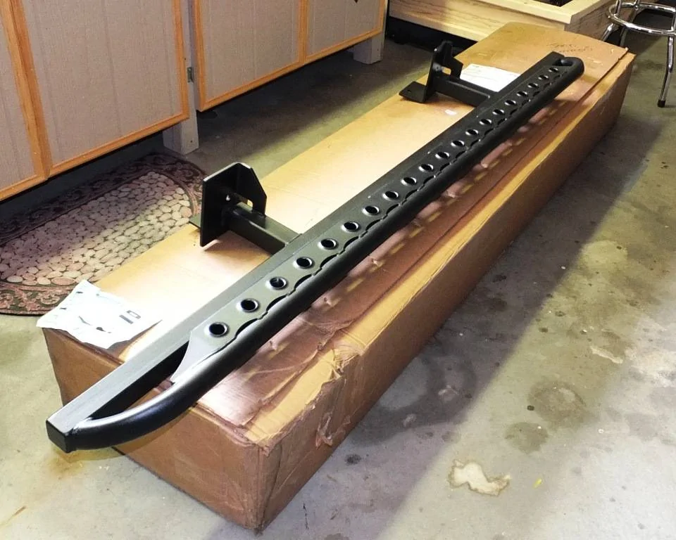

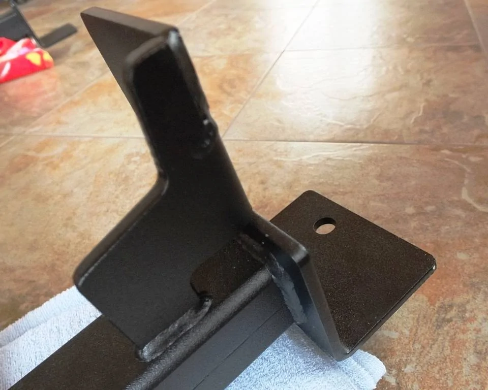

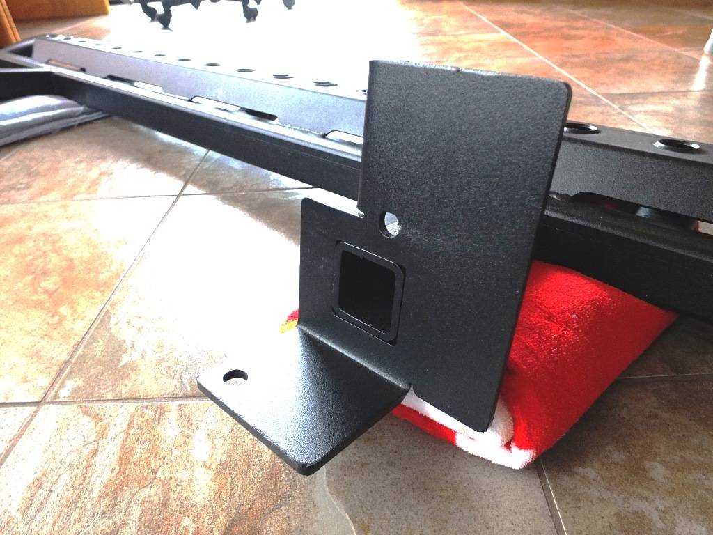

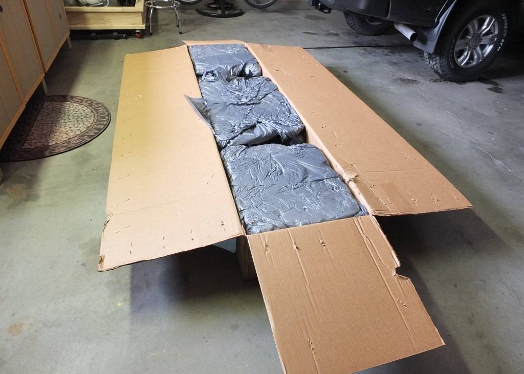

The rocksliders showed up Thursday, 2020-01-16. I've seen folks asking a lot of questions regarding these so I'm posting up lots of information and photo's.
  • They arrived exactly 4 weeks from the day we ordered them,
  • The cardboard shipping crate that they came in was marked as weighing 205 lbs. I have my doubts about that being correct, I think it was a bit less than that,
  • Each of the individual sliders weighs 68 lbs,
  • The crate is heavy cardboard and they use spray foam to secure all the parts. The crate was a bit scarred up but the contents were all in good shape.
The contents of the crate consisted of:
  • Drivers Side Slider,
  • Passenger Side Slider,
  • A Shrink Wrapped Bundle Of Fastening Hardware & 1/4" Shims,
  • Installation Instructions,
  • (2) Shrockworks Decals.
The metal staples that hold the crate together can be easily removed by pulling them out, on at a time, using needle nosed pliers.

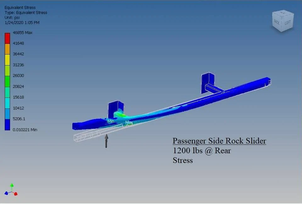

As for the sliders themselves... all I can say is WOW! The quality is superb. The raw materials were all nice and smooth, almost no weld splatter was on the parts, the welds look uniform and equally sized and the textured black powder coat is uniform and undamaged.
The folks at Shrockworks certainly did an awesome job designing, building and finishing these.
I'm hoping to install them on Sunday...

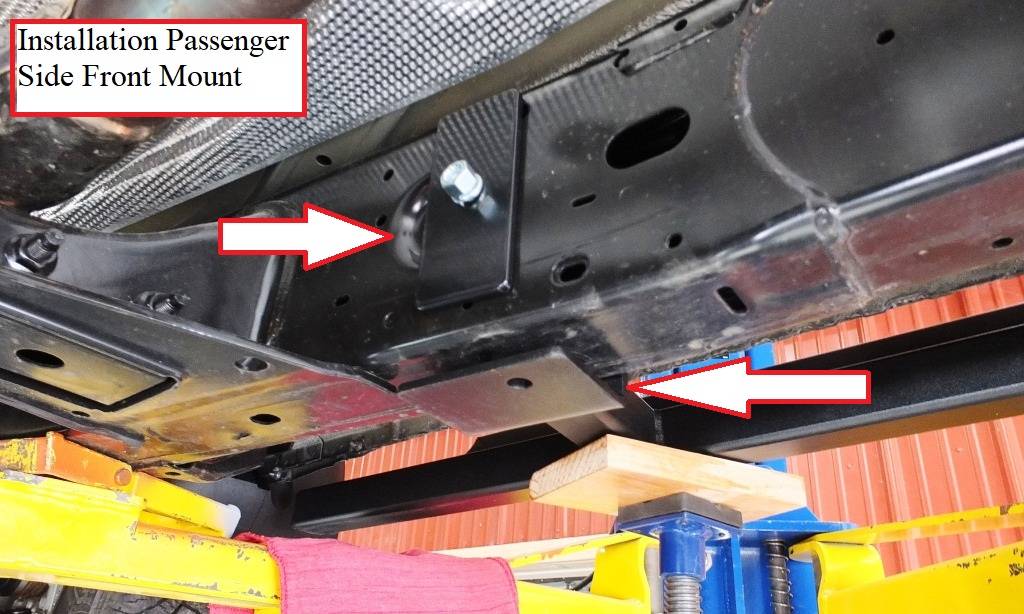

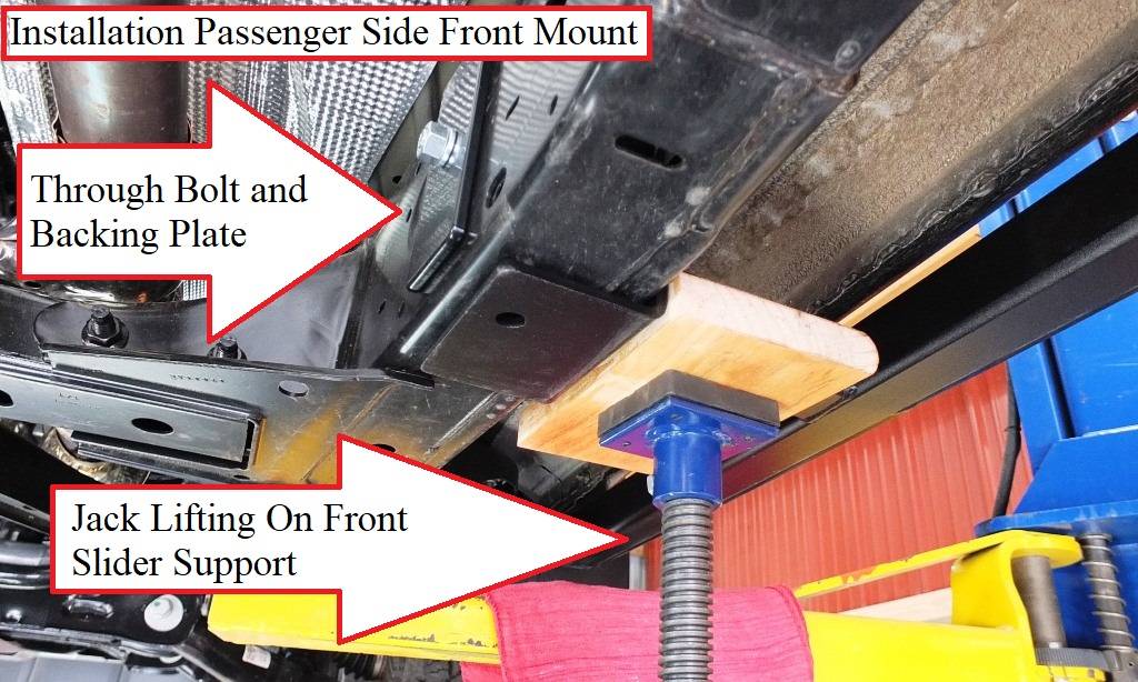

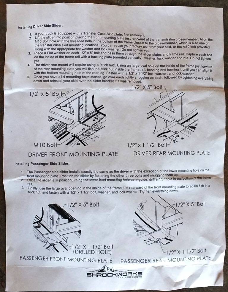

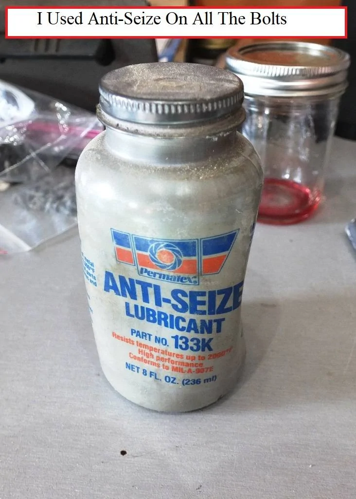

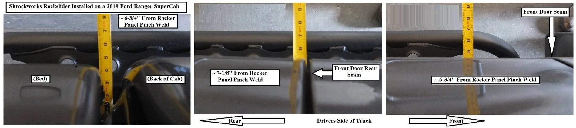

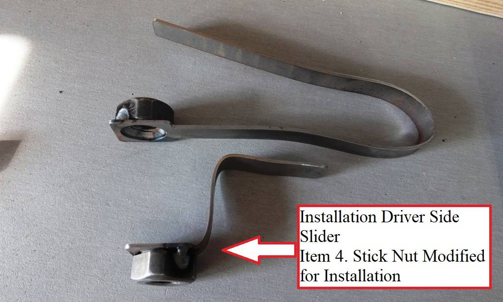

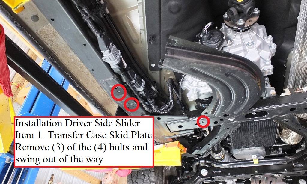

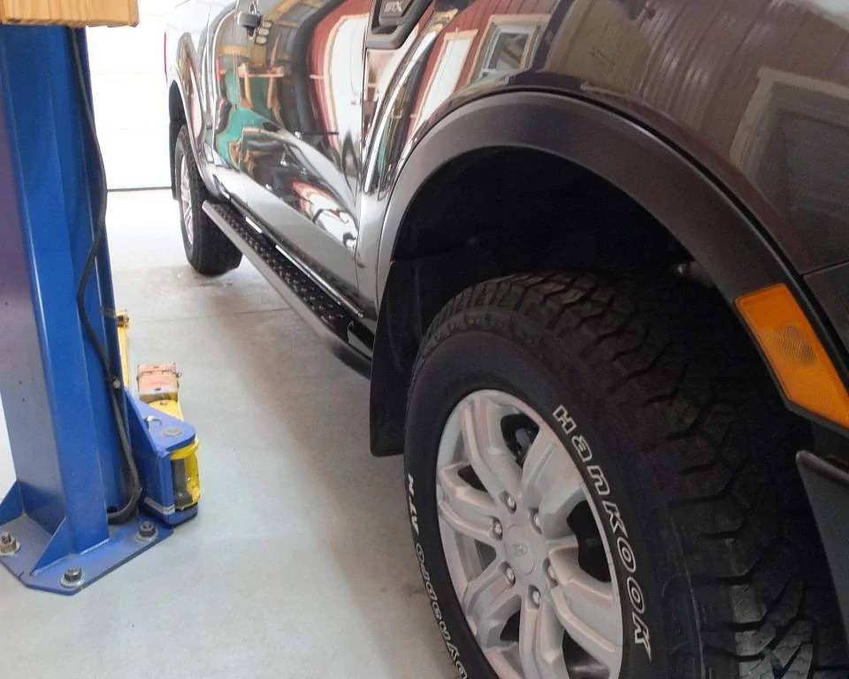

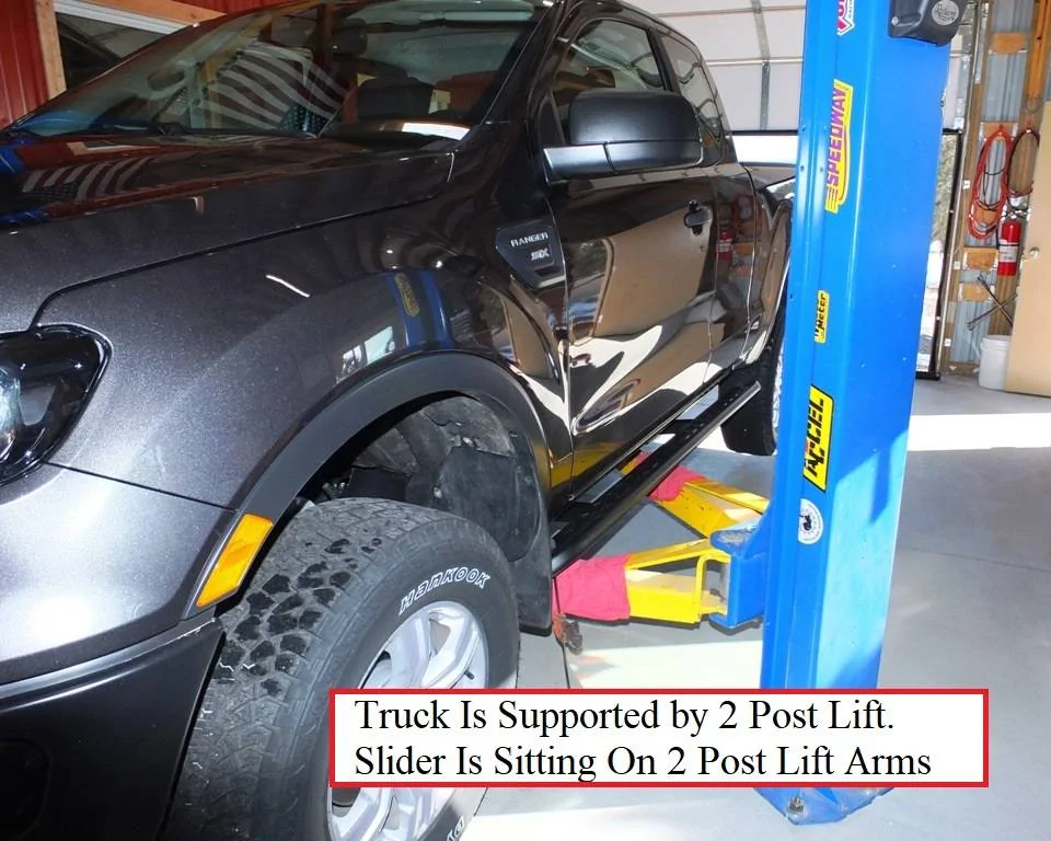

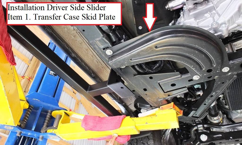

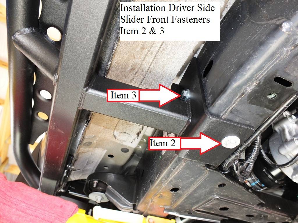

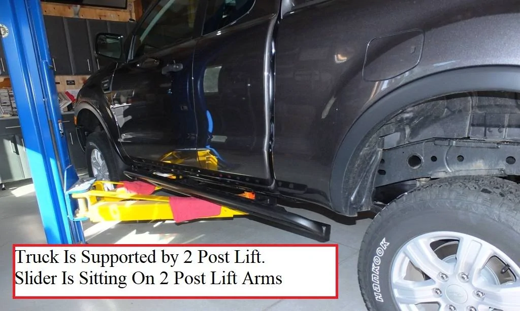

Installation of Shrockworks Rock Sliders

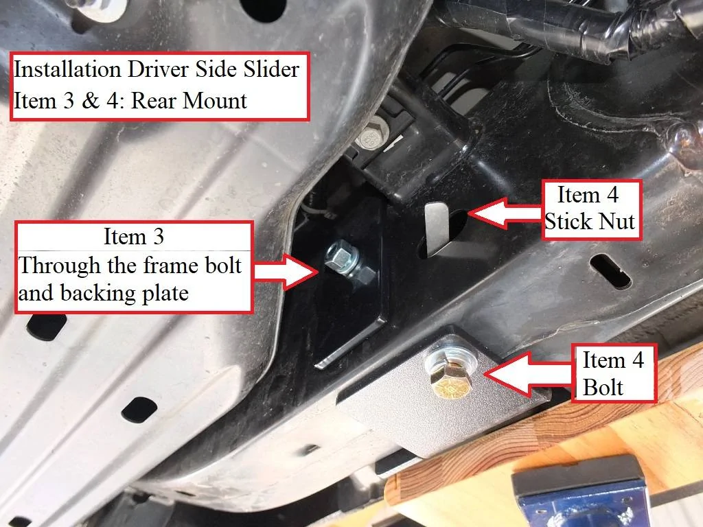

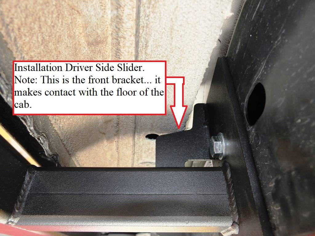

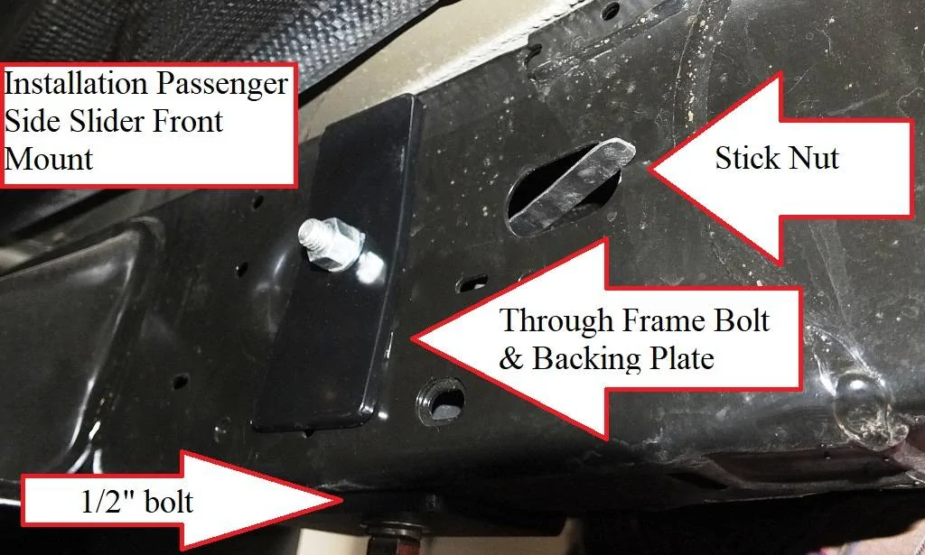

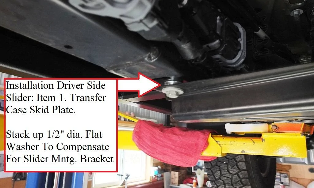

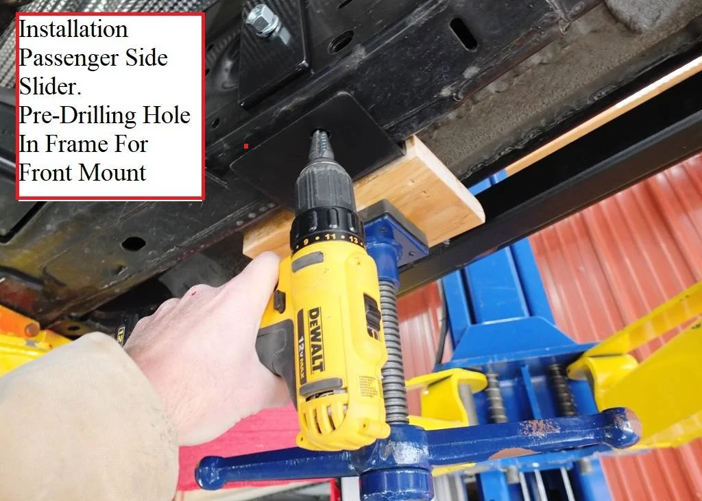

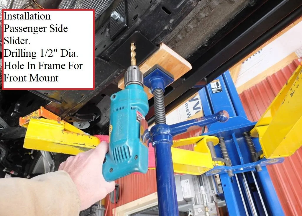

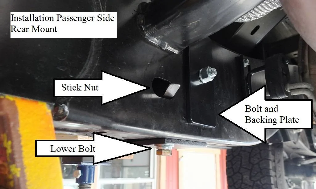

Really impressed with these... everything bolted up just as specified by Shrockworks.
Love how they tuck up nice and tight to the rock panels... and they don't stick out past the mudflaps or the tires.

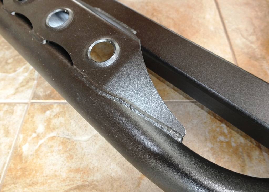

Only (1) thing I didn't care for is the gusset on the front drivers side support bracket touches the floor of the cab... zero clearance.
Item numbers on photo's below are based on the Shrockworks Installation Instructions. It took about 2 hours to installs these, working by myself.

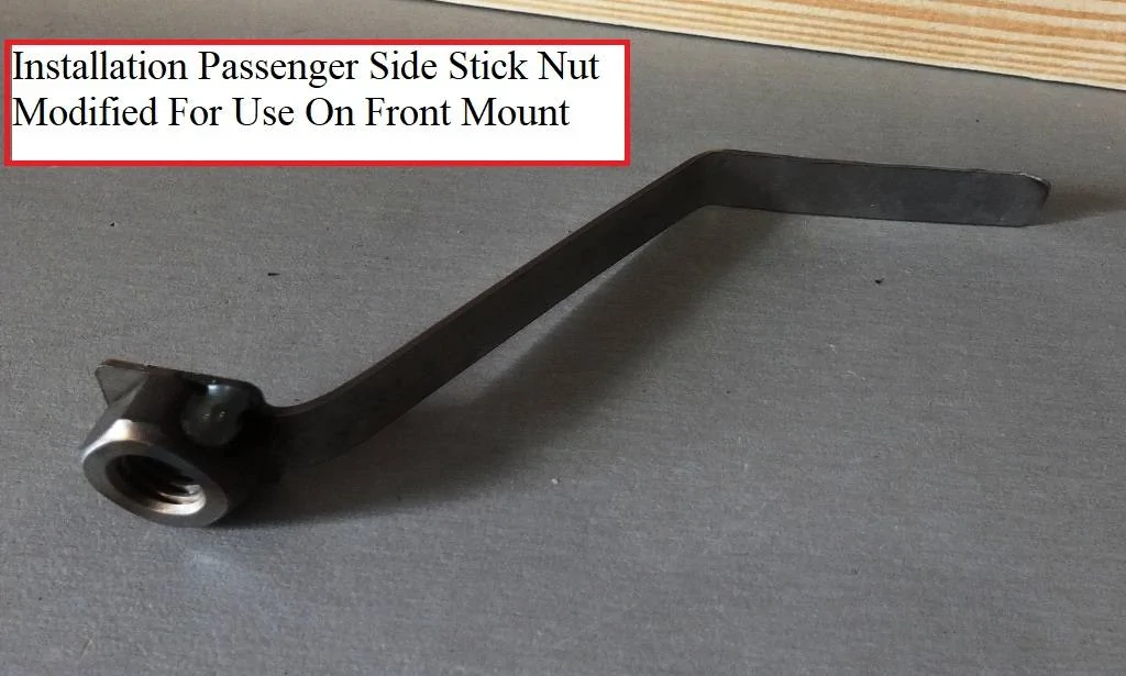

Nice write up! Wish you'd done this before my install LOL...pretty much as you documented John:)

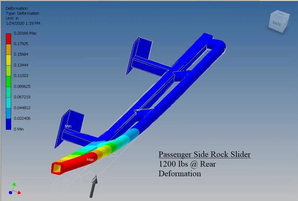

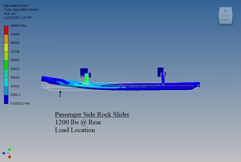

RockSlider FEA

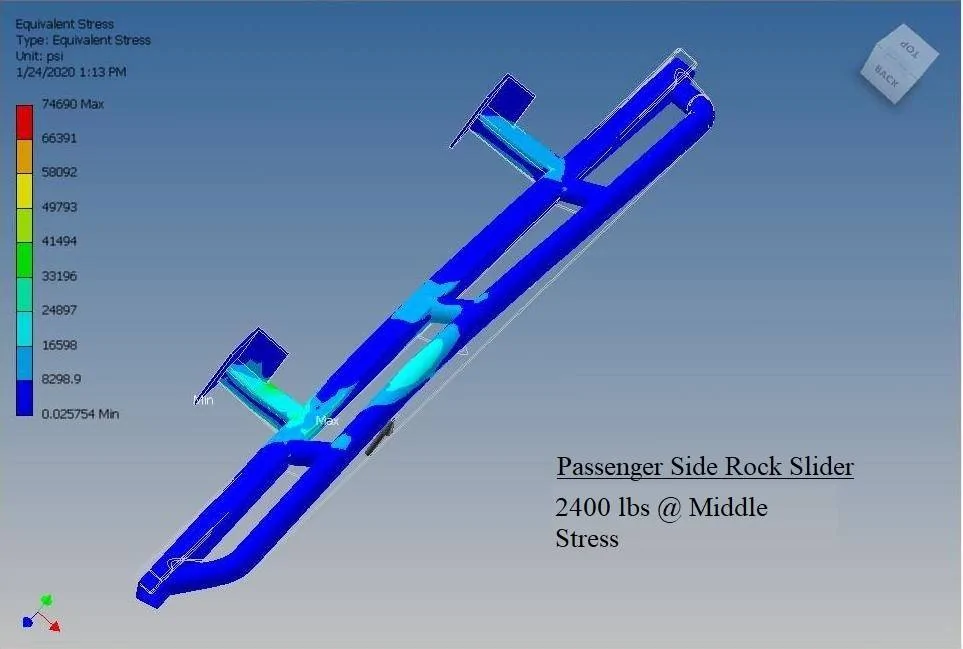

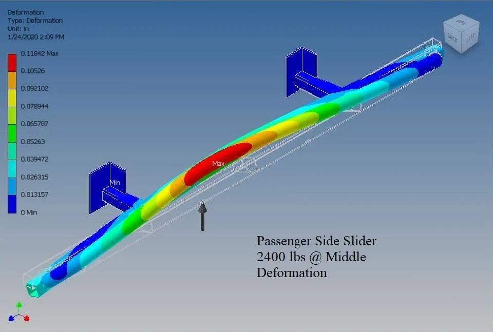

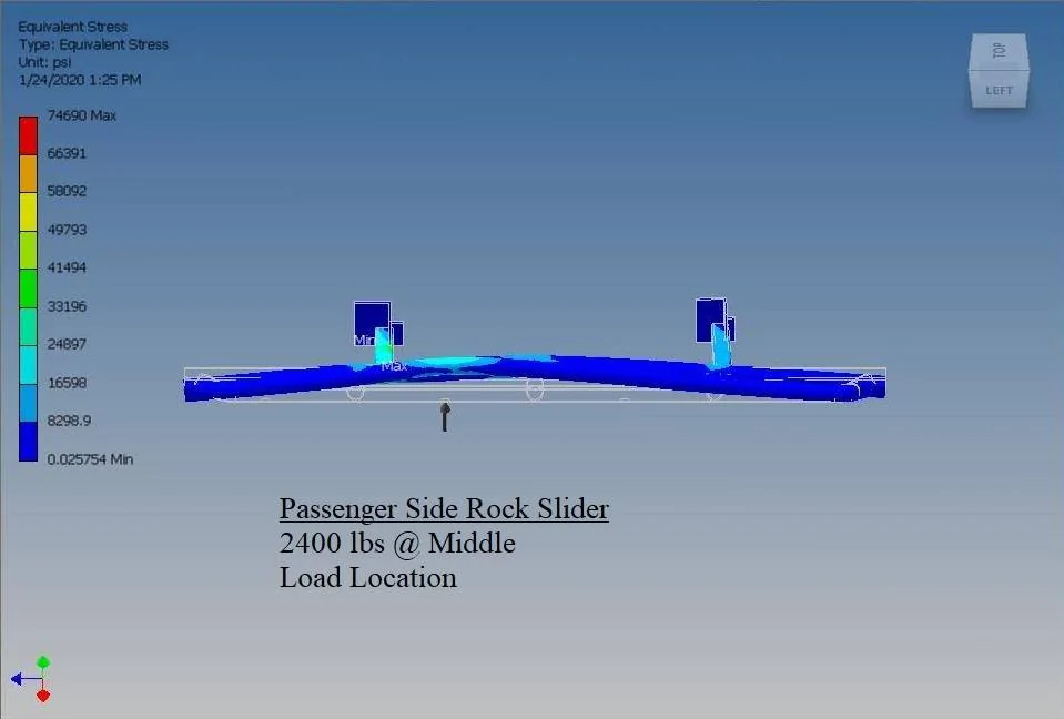

Sooo.... I wonder just how much weight will those Rocksliders will take? Let's look just for shits and giggles..
Since I installed the Shrockworks Rocksliders I've been curious just how much weight they can handle. I fired up an older Finite Element Analysis program I have on a PC and applied various loads to the CAD model that I made of the slider before I installed them.
Weight of our 2019 SuperCab Ranger 4x4 truck is about 4,600 lbs. (includes tow package, LT tires and the rocklsiders). So if it's hung on a rock with one wheel off the ground that's about 1,200 lbs. Both wheels off the ground lets say 2,400 lbs.
The rear of the slider hangs out farther from the frame support than the front... therefore it's weaker than the front of the slider. So 1st analysis assumes 1,200 lbs near the rear of the slider.
Next analysis assumes a rock at the middle, and both tires on that side of the truck off the ground. That's about a 2,400 lb load.
Looks like the sliders are "hell-for-stout" and up to the task.

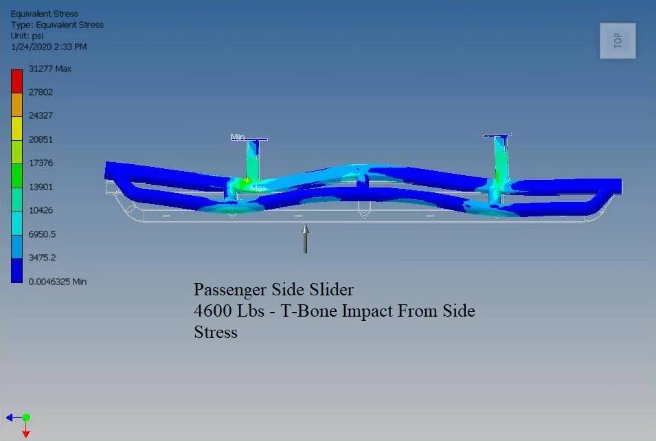

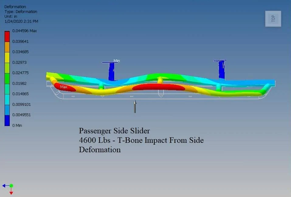

I also looked at a side impact, like somebody t-bones the truck. I used the full 4,600 lb load on that analysis. And once again the sliders appear to be of an adequate design. That's not enough load if the vehicle that t-bones the truck is moving at a pretty high rate of speed....
It's all for reference... but it's kind of neat to ponder "What If".
Seems like these sliders are a great investment.
Ford Ranger HenryMac's Build Thread: 2019 Ranger XL  STX  FX4 Magnetic Super Cab 1200 LBS AT REAR OF SLIDER - DEFORMATION
Ford Ranger HenryMac's Build Thread: 2019 Ranger XL  STX  FX4 Magnetic Super Cab 1200 LBS AT REAR OF SLIDER - LOAD LOCATION
Ford Ranger HenryMac's Build Thread: 2019 Ranger XL  STX  FX4 Magnetic Super Cab 1200 LBS AT REAR OF SLIDER - STRESS
Ford Ranger HenryMac's Build Thread: 2019 Ranger XL  STX  FX4 Magnetic Super Cab 2400 LBS BEWTEEN 2 INCH SUPPORT TUBES - DEFORMATION
Ford Ranger HenryMac's Build Thread: 2019 Ranger XL  STX  FX4 Magnetic Super Cab 2400 LBS BEWTEEN 2 INCH SUPPORT TUBES - LOAD LOCATION
Ford Ranger HenryMac's Build Thread: 2019 Ranger XL  STX  FX4 Magnetic Super Cab 2400 LBS BEWTEEN 2 INCH SUPPORT TUBES - STRESS
Ford Ranger HenryMac's Build Thread: 2019 Ranger XL  STX  FX4 Magnetic Super Cab 4600 LBS HIT FROM THE SIDE - DEFORMATION
Ford Ranger HenryMac's Build Thread: 2019 Ranger XL  STX  FX4 Magnetic Super Cab 4600 LBS HIT FROM THE SIDE - STRESS

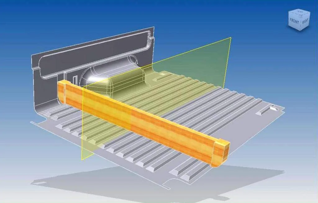

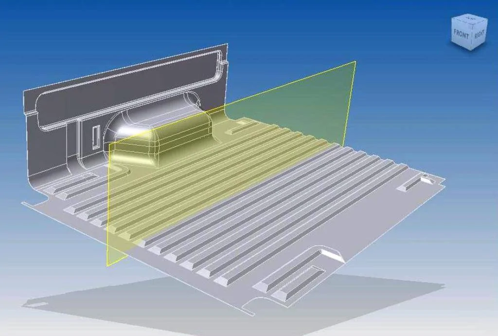

CAD Model Of The 6 Ft Bed
Started to create a CAD Solid Model of the bed on my Supercab today.
I've got some projects I want to build, such as a wooden support structure to hold 4' x 8' sheets of lumber and thought having a CAD model would make it easier for me to design the structure.

Some things are easy to model... others not so much. I wouldn't feel comfortable sharing the model of the bed. It just isn't accurate enough.
I made the model knowing that I was building a wooden structure that I could check each board for 'fit". I have yet to build the "Lumber Rack".

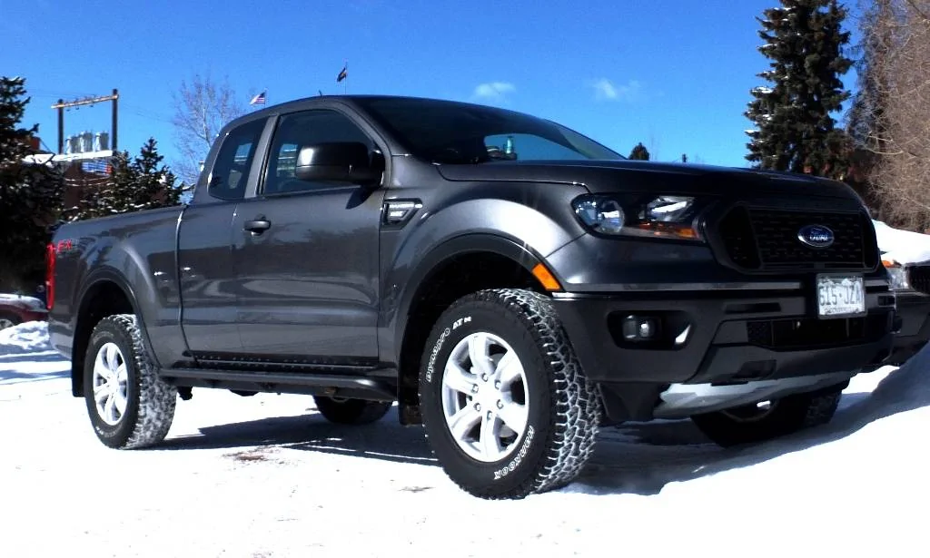

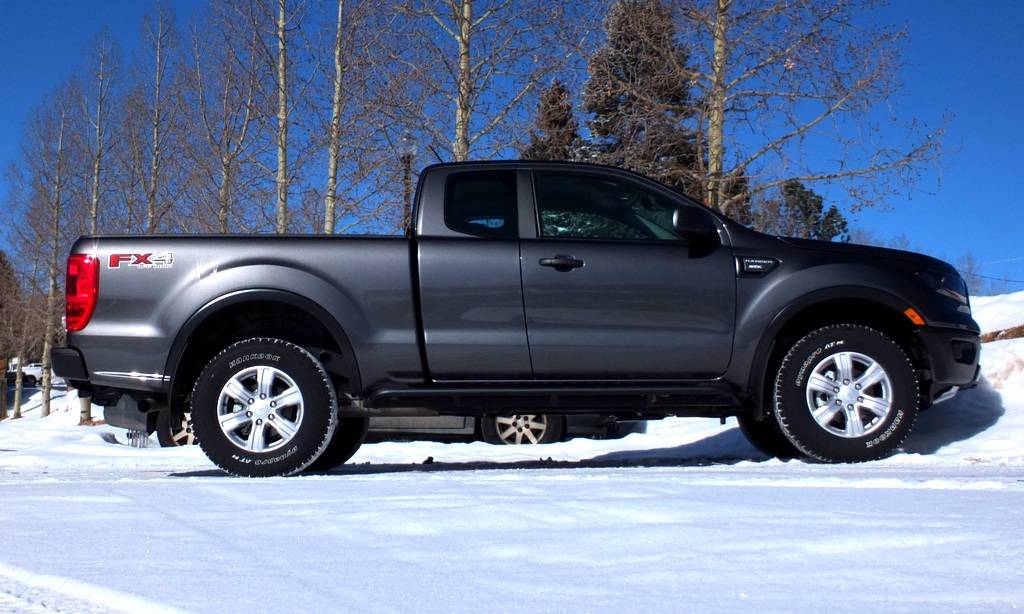

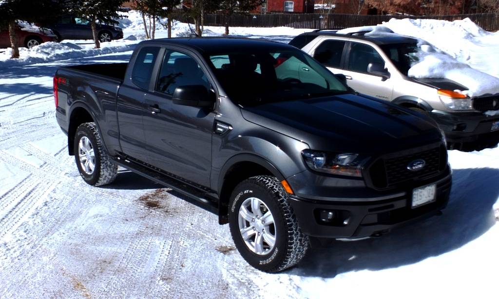

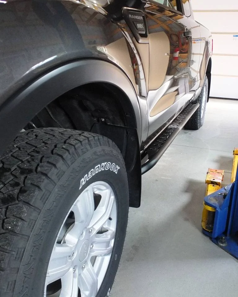

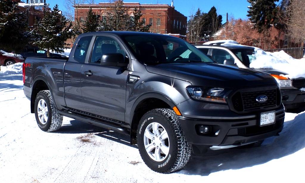

Shot a few photo's of the truck today.
The Shrockwork Rocksliders really do compliment the lines of the Ranger and look like they are a part of the truck, not some aftermarket afterthought.
Link To Installing The Rocksliders
