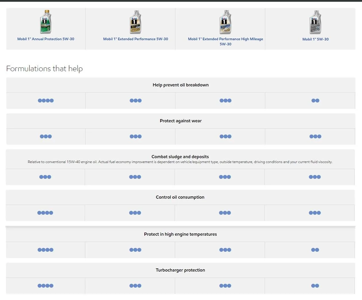

And interestingly enough the Mobil 1 site shows that the Mobil 1 Annual Protection Ultimate Full Synthetic SAE 5W-30 Motor Oil is superior to all their other oils for our turbocharged Ranger motors.
https://mobiloil.com/en/product-comparison?p1={750237b0-a15c-4fd5-bdaa-24d61c3519e7}&p2={6f399141-eac1-4ba1-940a-f409f3e10238}&p3={91d544a1-74d6-4033-9266-5e863373453e}&p4={13d37eac-ed45-4e21-ba36-944912a51197}
I was originally planning to switch to the Ford full syn. Did you fid the noack number for that in your research?

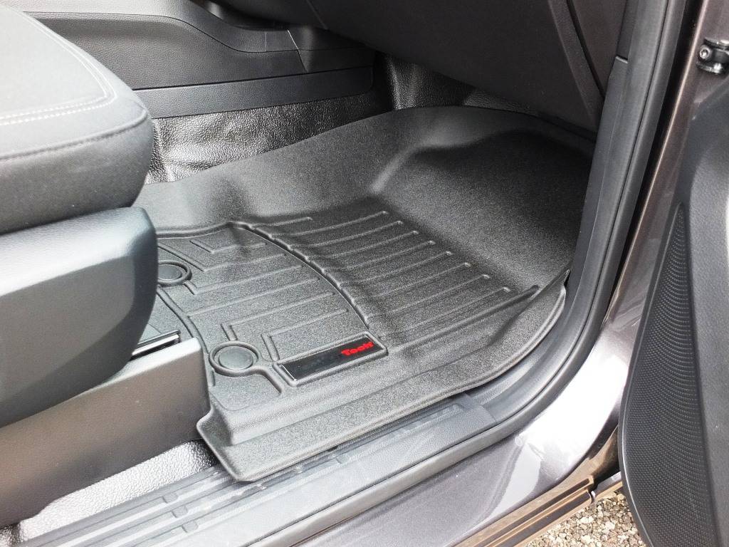

WeatherTech Floor Liner Installation

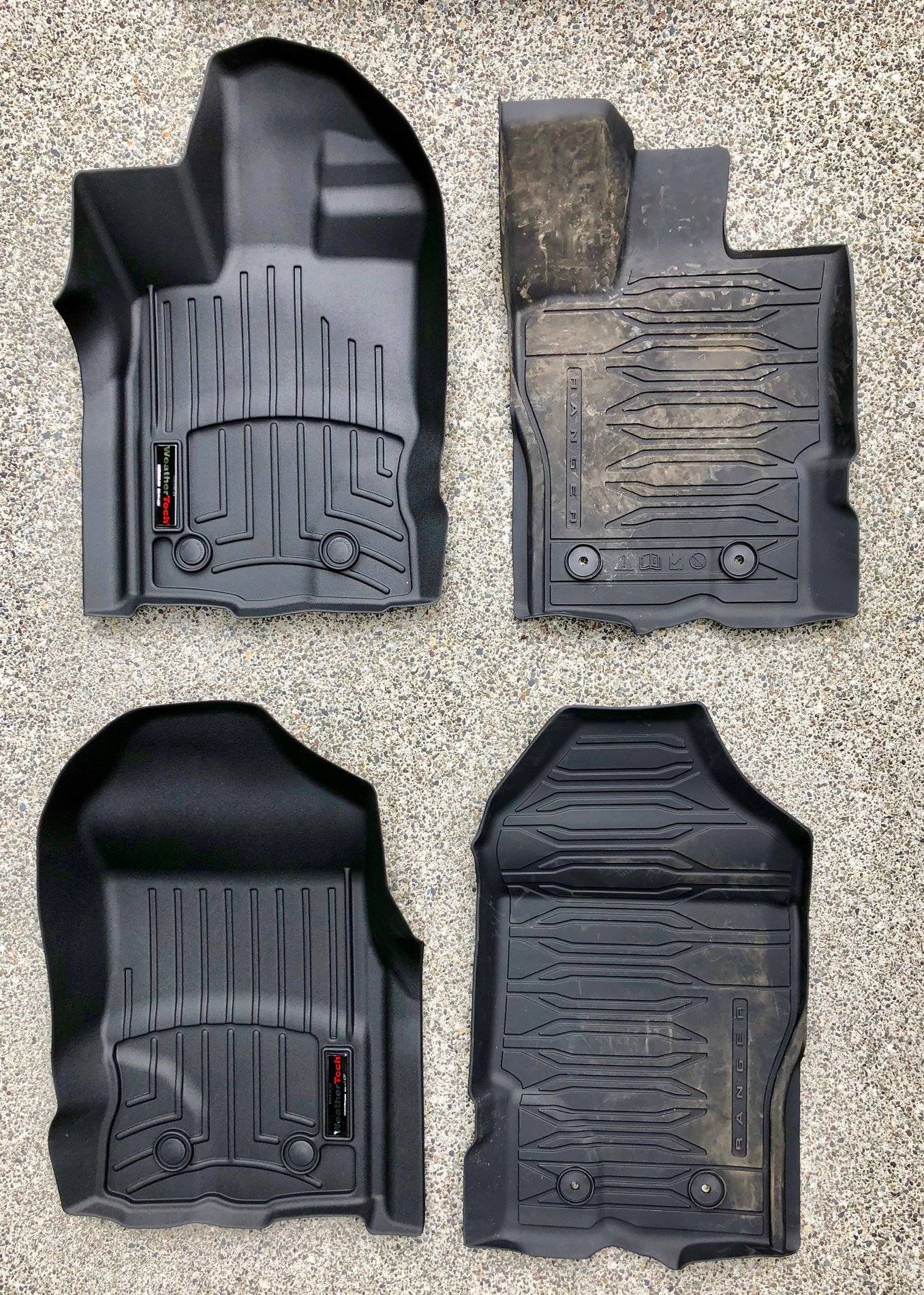

I installed a set of WeatherTech Floor liners today. What a great product.

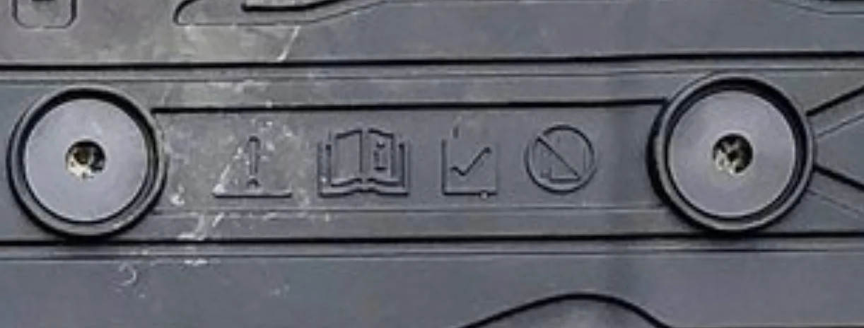

Here's a comparison from member Northlight comparing the WeatherTech's and Ford's optional liners. The Ford liners are just a piss poor design. There isn't even any tray under the gas pedal, so all the "gunk" on your foot ends up going on the floor, not into the liner? And there "safety warnings" molded into the drivers side mat is lame too.

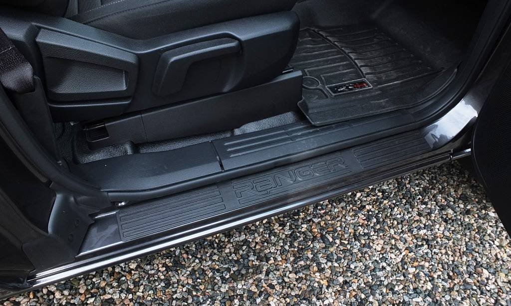

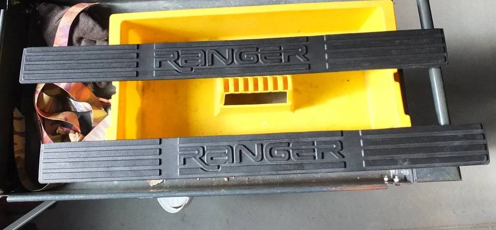

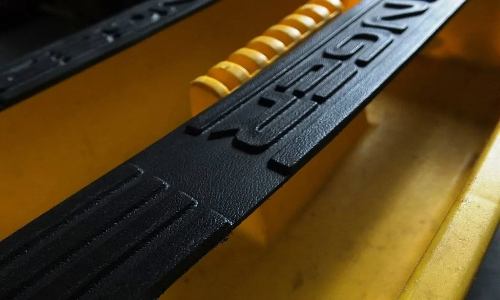

Door Sill Scuff Plates, continued from Post 42

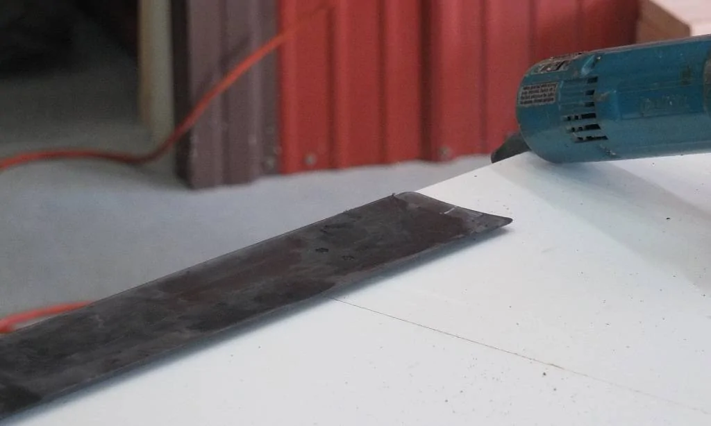

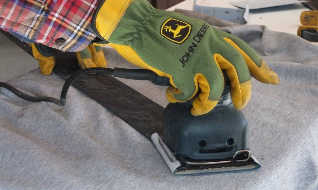

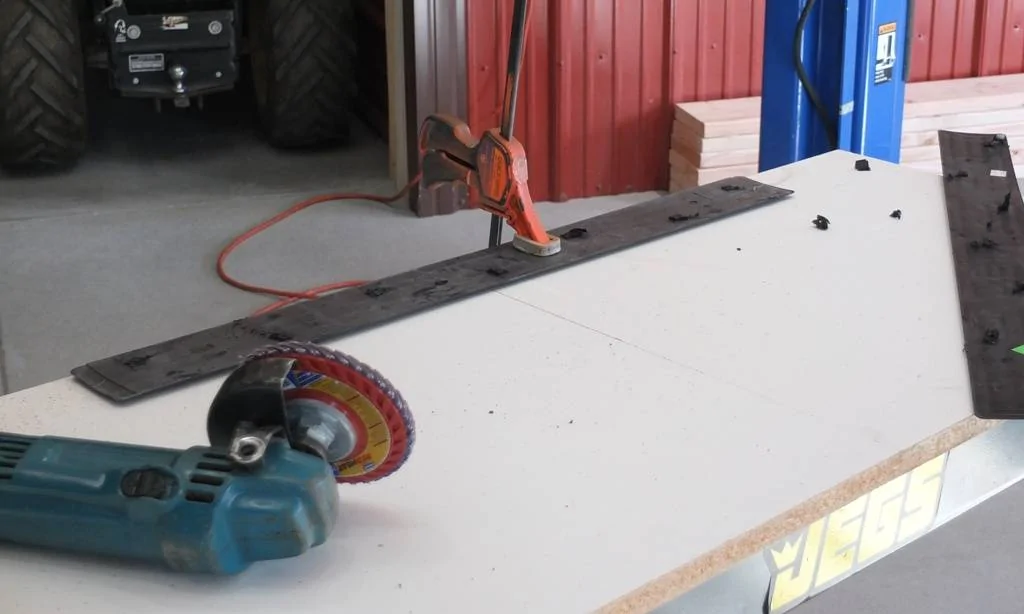

Modified the sill plates by using an air die grinder and cut off wheel to remove the rear mounting tabs.
Ford Ranger HenryMac's Build Thread: 2019 Ranger XL  STX  FX4 Magnetic Super Cab 001.JPG
_________________________________________________________________________
Then used a 4-1/2" angle grinder with a 60 grit flap disc to level out the remaining stubs of the mounting tabs.
Ford Ranger HenryMac's Build Thread: 2019 Ranger XL  STX  FX4 Magnetic Super Cab 002.JPG
Ford Ranger HenryMac's Build Thread: 2019 Ranger XL  STX  FX4 Magnetic Super Cab 003.JPG

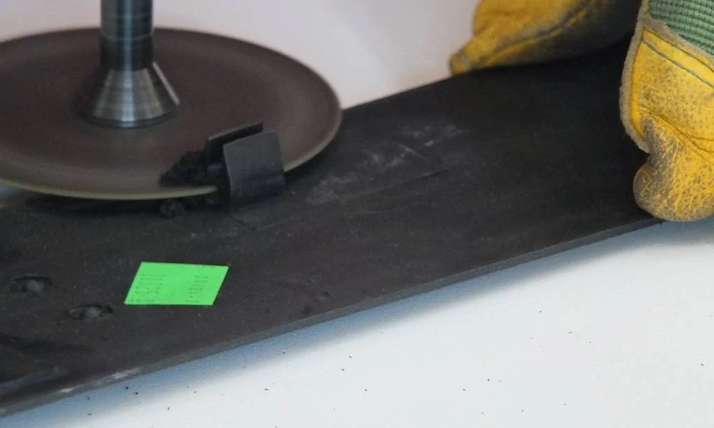

Next step was using a palm sander and 80 grit.
Ford Ranger HenryMac's Build Thread: 2019 Ranger XL  STX  FX4 Magnetic Super Cab 004.JPG
Ford Ranger HenryMac's Build Thread: 2019 Ranger XL  STX  FX4 Magnetic Super Cab 005.JPG

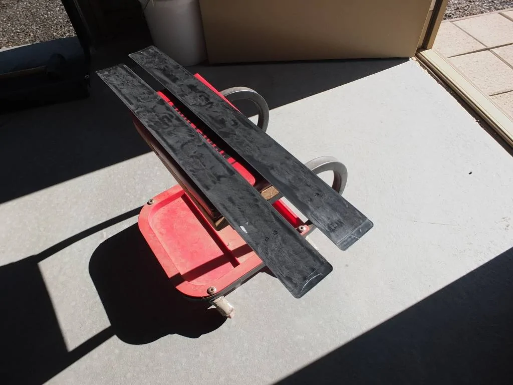

When I test fit the sill plates they were a bit to wide and hung out over the edge of the sill. I used the angle grinder and 60 grit flap disc to remove the top lip and sanded it down flush with the top rib.
Ford Ranger HenryMac's Build Thread: 2019 Ranger XL  STX  FX4 Magnetic Super Cab 006.JPG
Ford Ranger HenryMac's Build Thread: 2019 Ranger XL  STX  FX4 Magnetic Super Cab 007.JPG
And here they are mocked up, ready for tape.. or silicone.. or ????.
Ford Ranger HenryMac's Build Thread: 2019 Ranger XL  STX  FX4 Magnetic Super Cab 008.JPG
Ford Ranger HenryMac's Build Thread: 2019 Ranger XL  STX  FX4 Magnetic Super Cab 009.JPG
The tape I bought to mount these isn't going to work. It doesn't stick to the plastic sill plates. Here's what I tried to use. Anybody have any suggestions on what type of tape would work best in this application? How about clear silicone?
Link to Installation Using Silicone
Ford Ranger HenryMac's Build Thread: 2019 Ranger XL  STX  FX4 Magnetic Super Cab 010.JPG

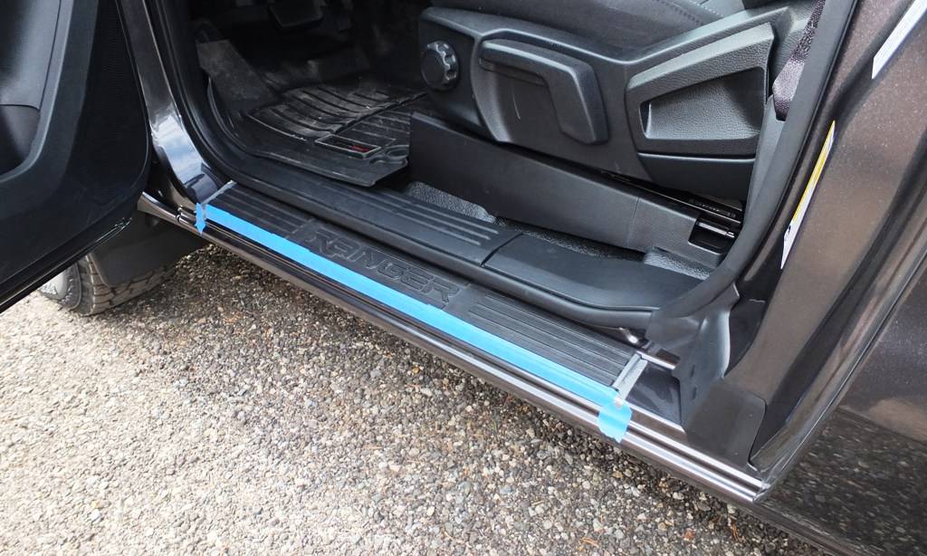

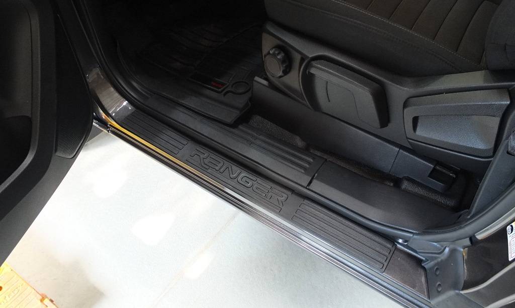

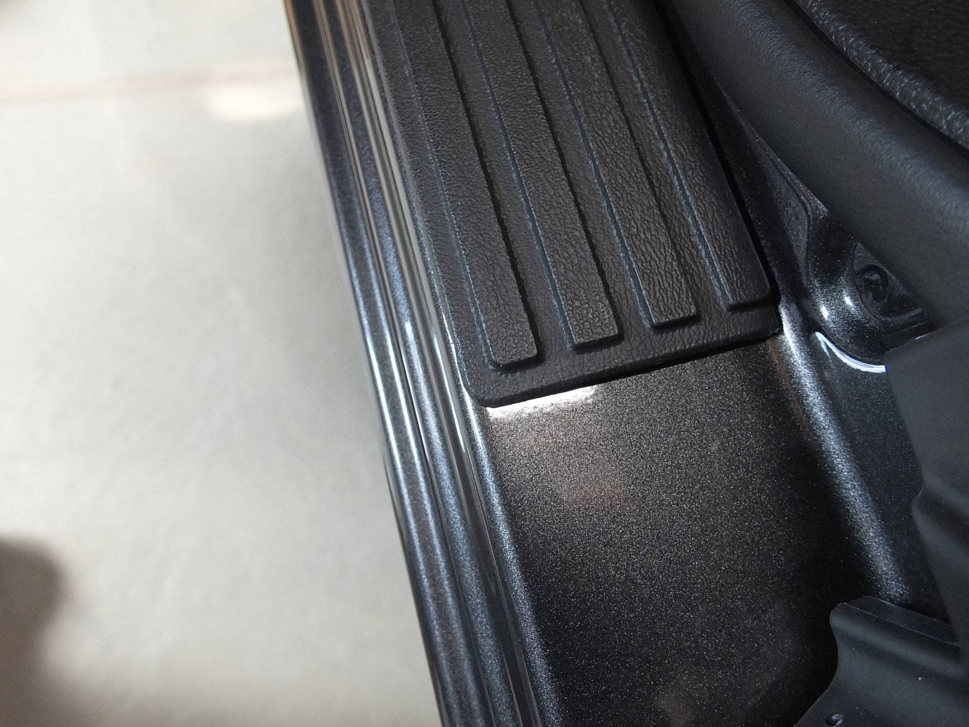

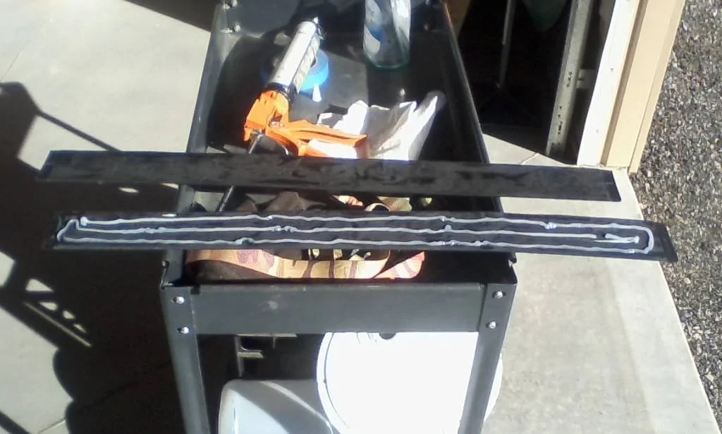

Door Sill Scuff Plates, continued from Post 52

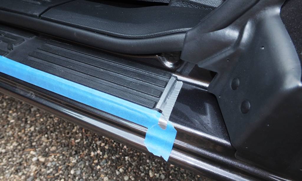

Ended up using some GE 100% clear silicone to attach the scuff plates to the door sill plates. Used blue painters tape to hold them in place... and some duct tap on the end just to make sure they didn't lift up while curing.
Ford Ranger HenryMac's Build Thread: 2019 Ranger XL  STX  FX4 Magnetic Super Cab 000.JPG

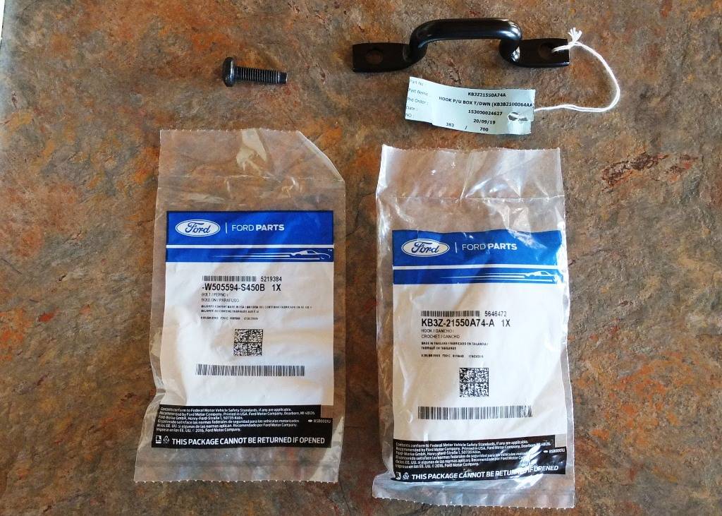

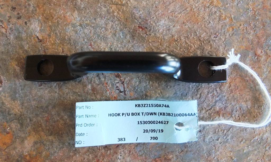

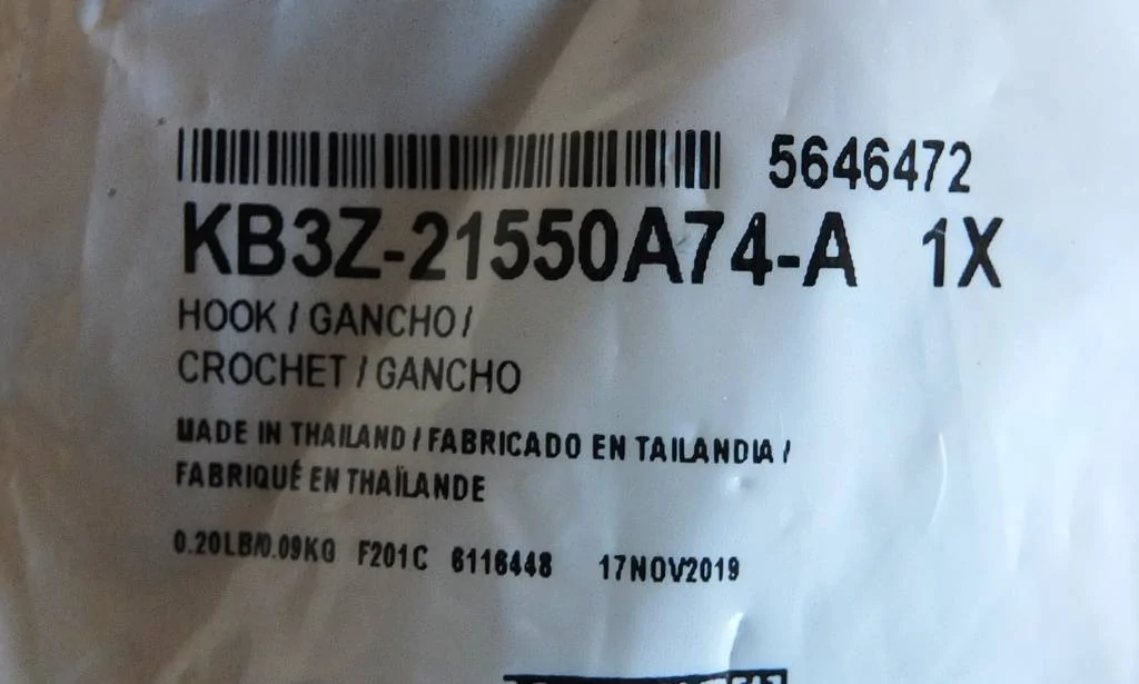

Pickup Box Bed Tie Down Hooks and Bolts
Continued from: Where are my missing bed tie down hooks

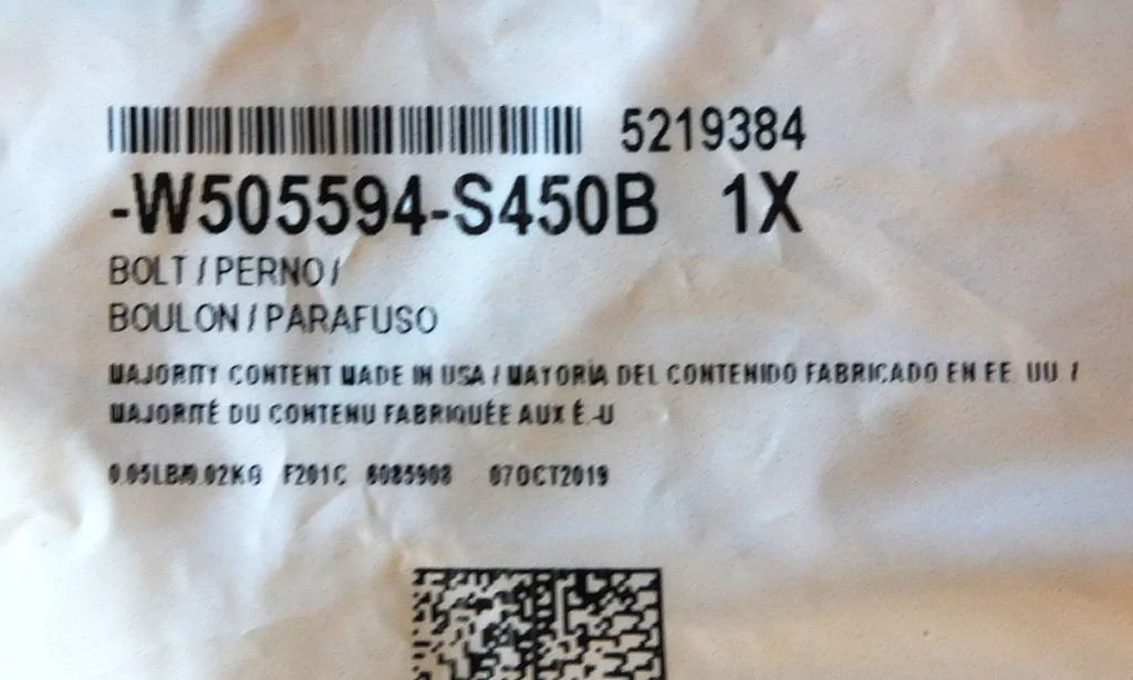

Got a call from my local Ford Dealer today. The back ordered Bed Hooks and Bolts were ready for pickup.
They wrote it up as a Service Warranty Claim so there was no charge.
Here are the part numbers in case you need them:
Tie Down Hook - Ford (KB3Z-21550A74-A) $6.49 ea, Quan. (2) = $12.98
Tie Down Hook Bolt - Ford (-W505594-S450B) $3.90 ea, Quan. (4) = $15.60
__________________________________________________Total = $ 28.58
I need to buy a tap to chase the threads in the truck since the truck has the ford factory sprayed Toughbed liner in it.
