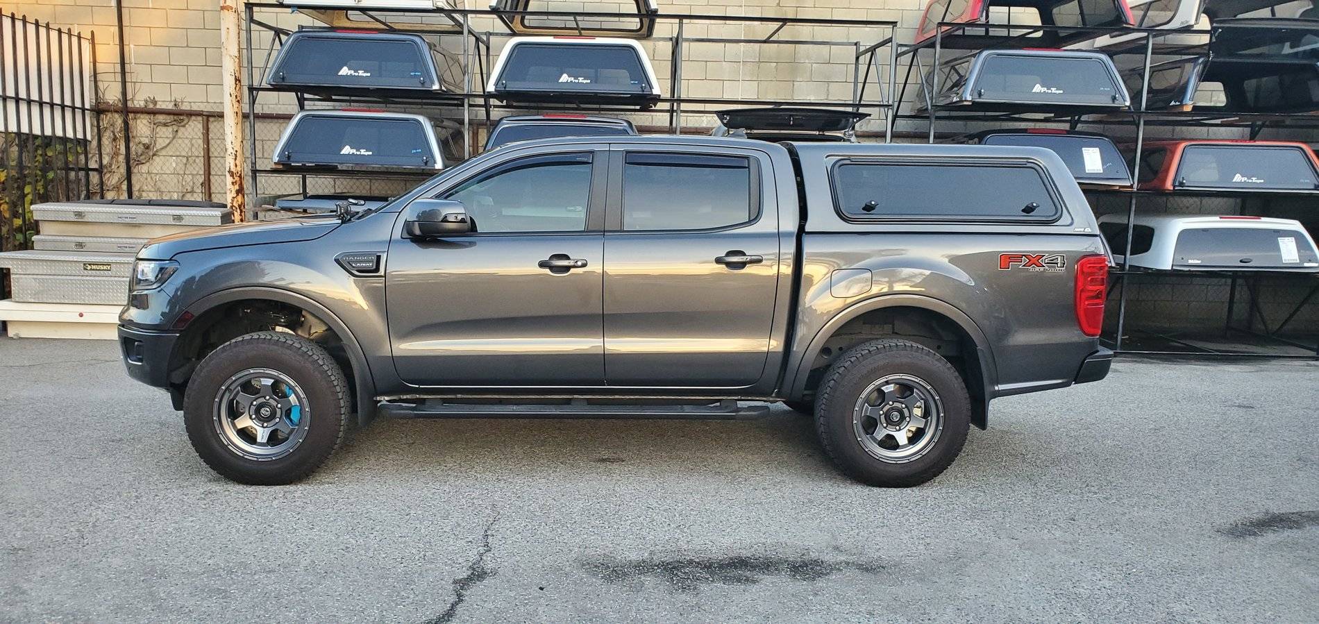

A.R.E. CX Evolve. Finally showed up but at the same time a month early.

That topper is sweet, what make and model ?
That looks great! I have never had a topper on any of my trucks, but It might possibly happen with my ranger.... Doing research and deciding what will be best for my camping set up.
Where did you get yours installed and do you mind If I ask how much?
Your authorized dealer will install. Got mine at Sno Valley in El Monte. Cheapest I could find in my area. Ask for Stephanie.
