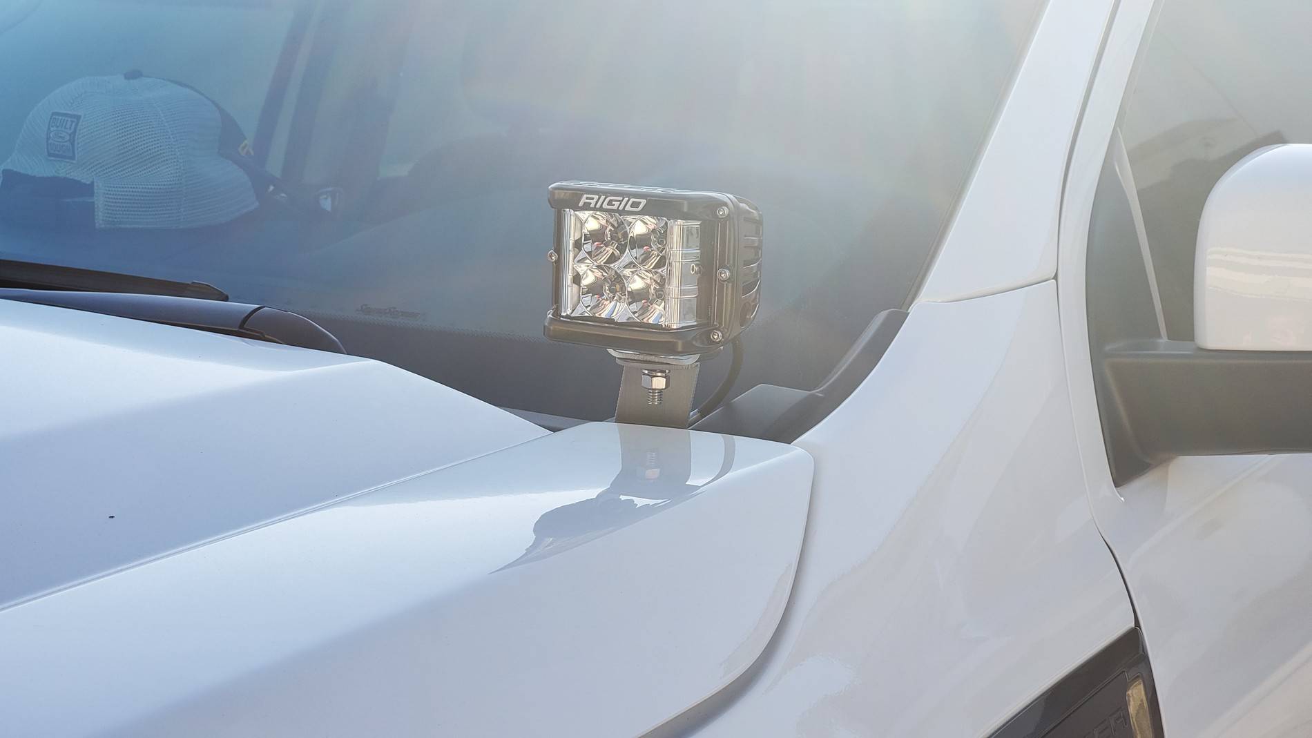

Test fitting the 3d printed piece
Ford Ranger J0shM1lls' Ranger Build Thread! 3gaeNoH

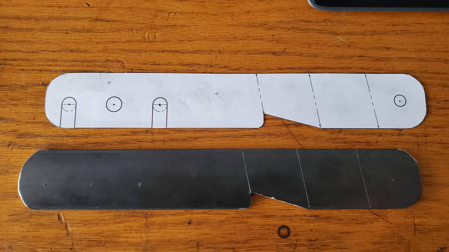

Printed out the template, cut it out of 1-1/2 x 1/8 flat bar steel
Ford Ranger J0shM1lls' Ranger Build Thread! NcfV8vL

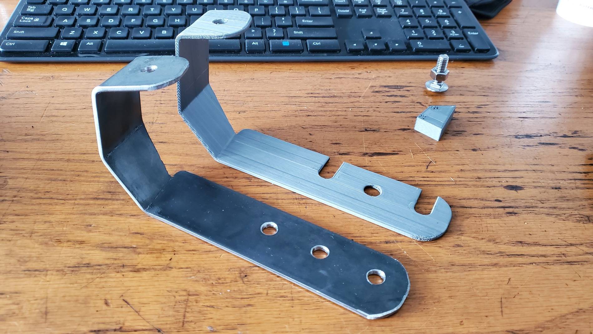

Bent it up and compared to the 3d printed piece
Ford Ranger J0shM1lls' Ranger Build Thread! xUVMNrJ

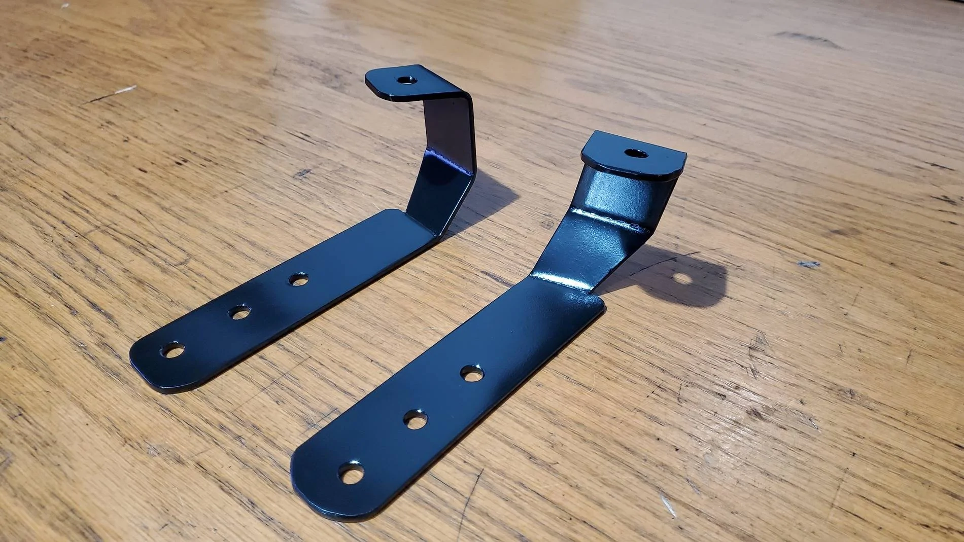

Gave em a good 3 coats of VHT Roll Bar & Chassis black
Ford Ranger J0shM1lls' Ranger Build Thread! eAP0fJi

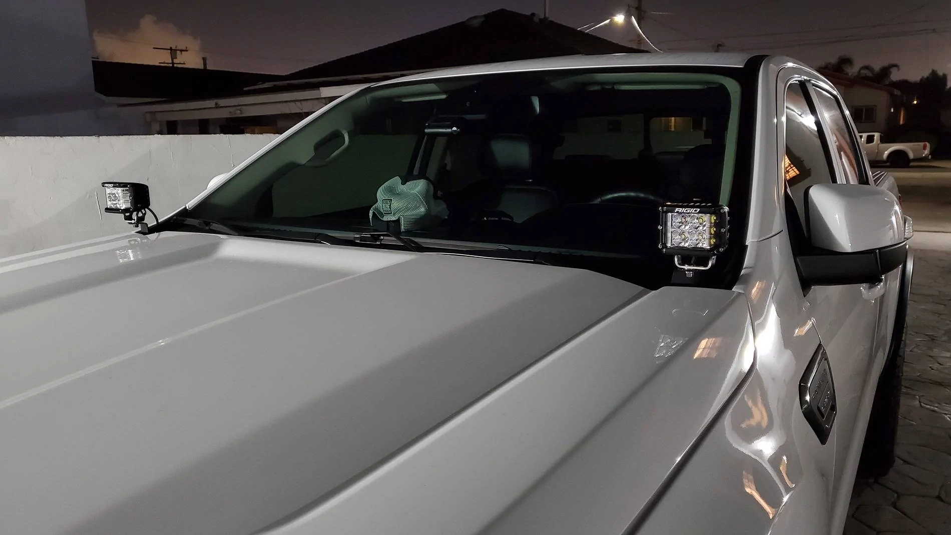

And here we are
Ford Ranger J0shM1lls' Ranger Build Thread! TY0VRMd
Whattya guys think? :)

Sure you saved the $132and still have all your fingers.... but the sense of pride/accomplishment = PRICELESS!
Great job Josh!
Now let there be light!
