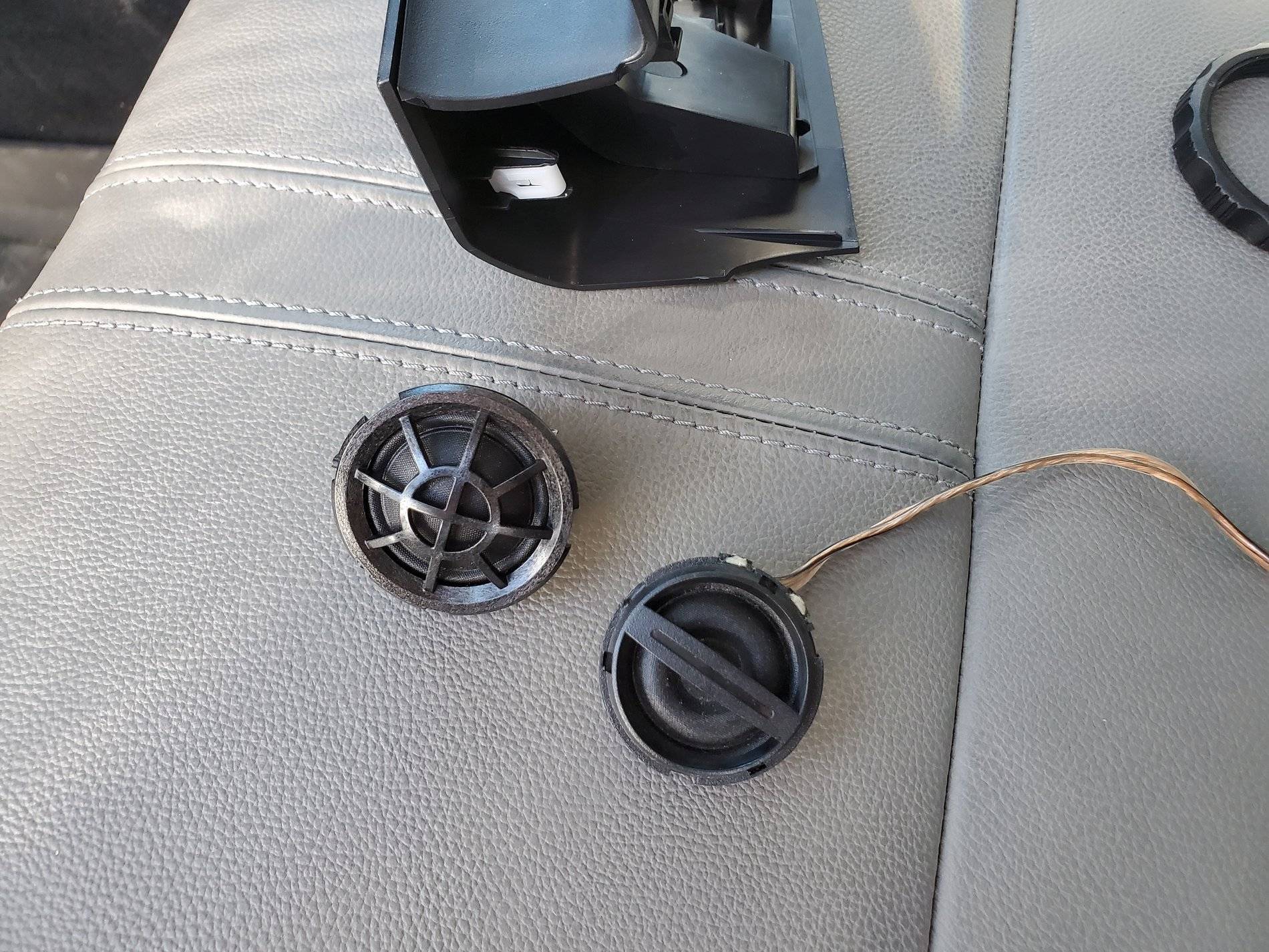

Here's the tweeter situation in the Ranger B&O stereo. Looks like a silk dome, which is good, but a filter cap off the back, which is not what I was expecting. It's possible there's factory digital filtering at the amp in addition to the filter cap, I'm not sure. No issue for me since it looks like the Alpine component tweeter will fit into the sail really well with some minor modifications.
I'm pretty sure the cap is a bass blocker to protect the tweeter at high volumes. I wired one in with each new tweeter. Do you think that was a bad idea?
It didn't seem to hurt the highs at all. I used high quality 22mfd Non Polarized electrolytic caps per some tables I googled.
I had to buy 10 so if you want a couple of free ones, PM me.
What new tweeters did you put in? Yeah a 22 uF would be a fairly low high pass filter, added to whatever signal the tweeter is getting already.

What value is the cap that was on the OEM tweeter? That would point out if it was just a click/pop/thump filter or if it was actually in place as part of the tweeter's rolloff.
I installed a pair of Morel TEMPO ULTRA 602 6.5" component speakers in the front. The Morel tweeters are 1.25 in. and rated to go down pretty far so I used 22mfd. I think the original tweeters had 33mfd. protectors but they looked like 1 in. diameter tweeters so probably rated higher range. The Morel components seem to have a more balanced sound than the originals so I'm using the OEM amplifier.

Oh ok I see that. Yes, just there for protection it appears, and it's a good idea to keep something in place, unless you are using a passive crossover with a component system.
With my non- B&O system, which appears to not have a dedicated tweeter amp, I would suspect the cap is a 2.2 uF or something like that. looks easy to get at, I'll have to pop it open and take a look.
