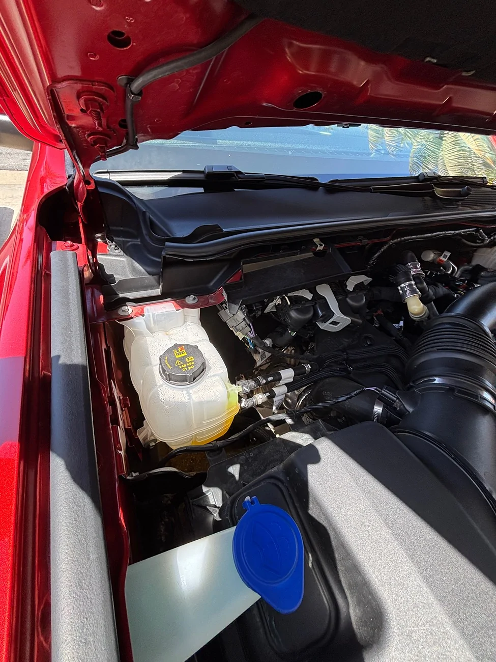

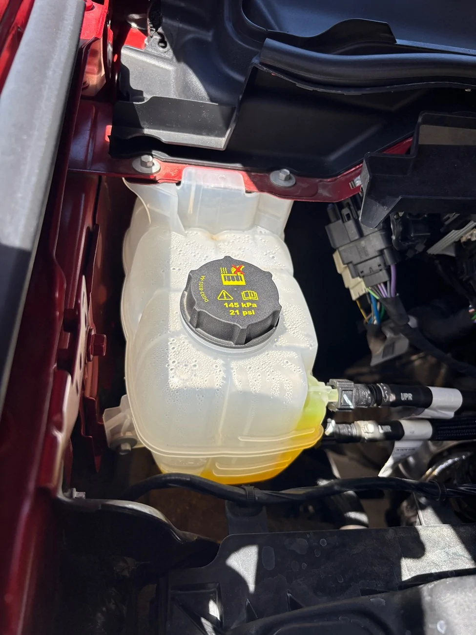

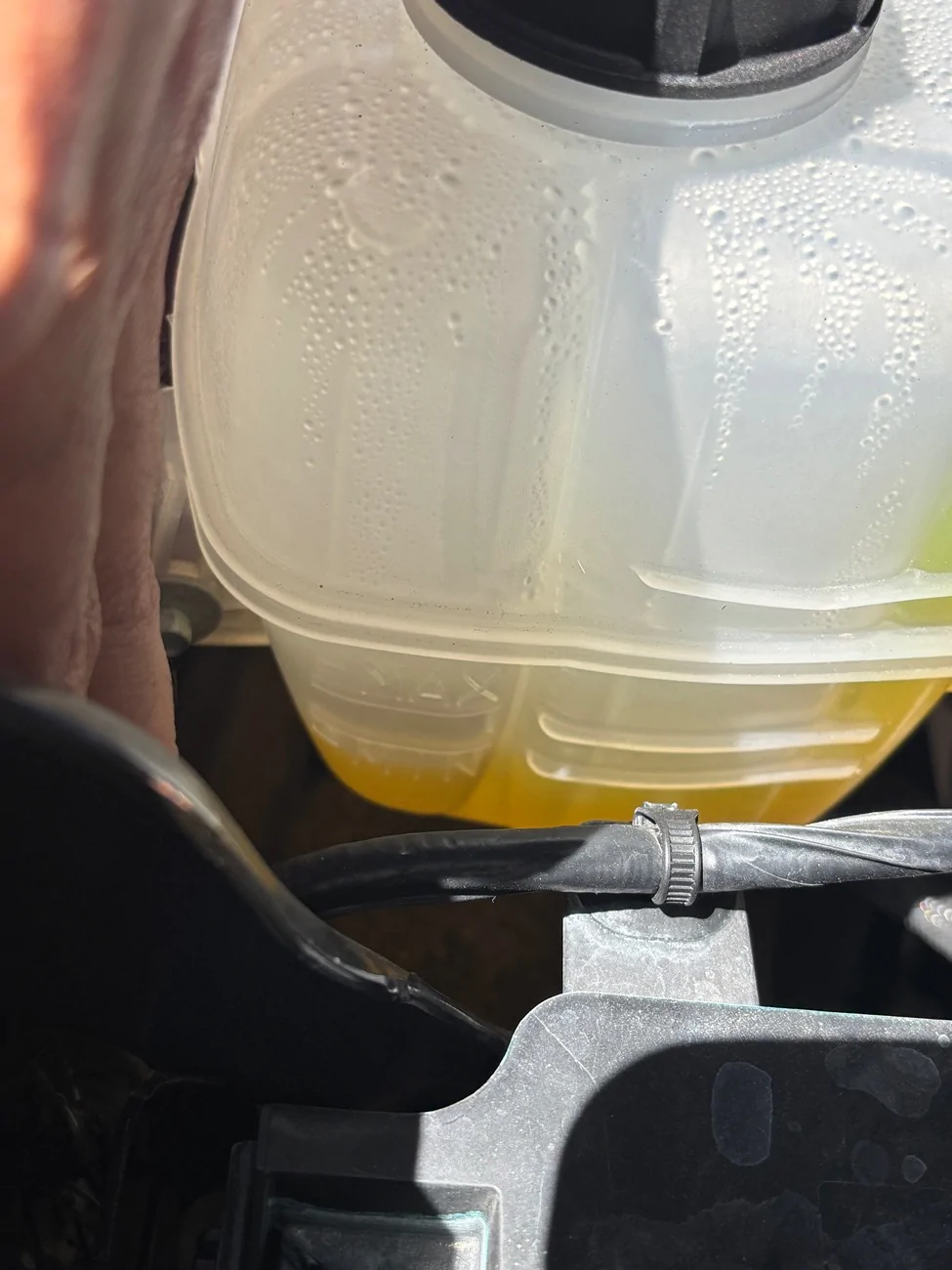

Bought my new to me Ranger Raptor and realized it’s low on coolant.
Anyone else had to add coolant within the first year of ownership?
Not a big deal, just never had to add coolant. Not at 13,000 miles.

Anyone else? I’ll check it when hot too and see after it expands, where it sits.

See here:
https://www.ranger6g.com/forum/threads/coolant-level.12591/
Maybe need to check level after engine is warmed up. I haven't confirmed this in the manual myself.
*EDIT*
Looks like you check with the engine cold. See page 408.
https://www.fordservicecontent.com/...r_information/2024_P703_Ranger_TRD_OM_ENG.pdf
Sometimes the fluid gets sucked up into the engine and it takes a bit to level out. let it sit for a few hours maybe? It's hard to tell from your photos but it looks like it's right at the min line, which I would personally think is OK.

Thank you for digging this up for me! I was just about to download the service manual and start reading.

My Bronco lost a tiny bit of coolant. Mechanic said it was normal on new engine. Filled up to full mark after it sat for a day. Haven’t had to fill it since in over 2 years. Watching my Raptor now. See how it goes.

My Raptor had 2,100 miles and coolant was at the brewery minimum level. I got a gallon of the coolant for the Ranger raptor and added. Haven’t checked it a few weeks - so sounds like a stranded practice.

My fx4 was below the min level, brand new. Factory oversight. Had dealer top it off, good to go.... At 8k now
