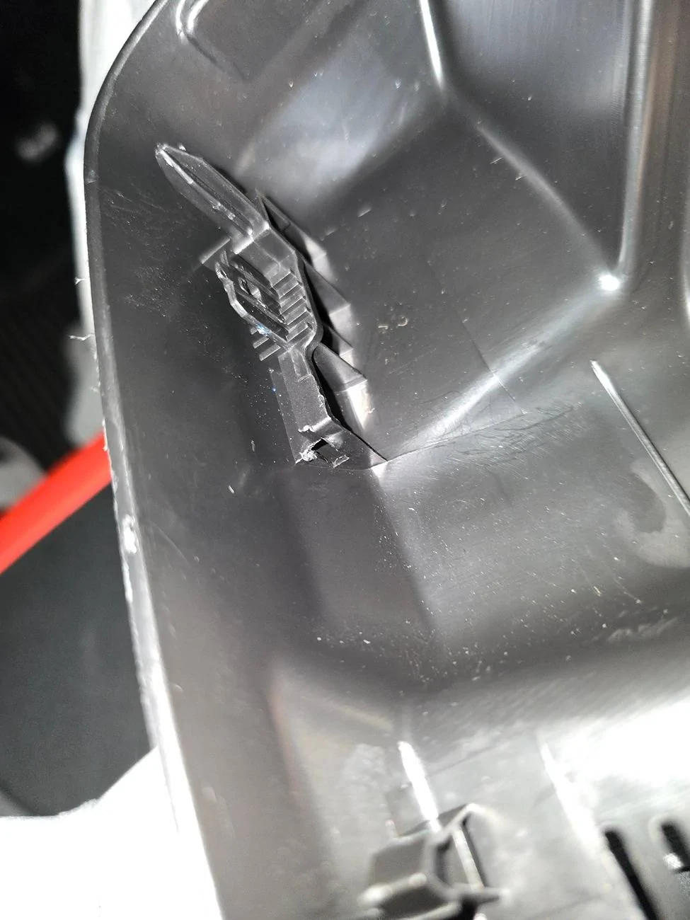

Are there any videos yet of removing that rear view mirror cover assembly? Stuck on trying to figure this thing out

Can you explain that pull tab clip on the front side a little more? I have everything off but struggling with that last front clip. Don't want to yank it.
You likely won't break it. But you should be able to pull that long pull tab towards the drivers side (if I remember correctly). If I get time I'll try to remove and get better pictures. I'll likely have to take it off again anyways. Dash cam arrived.

I figured it out. Once you get those bottom clips undone. And you can feel that pull tab. You have to twist the bottom part of it to allow it to be removed from the mirror cover.
Can you show on the cover what the other clips look like?

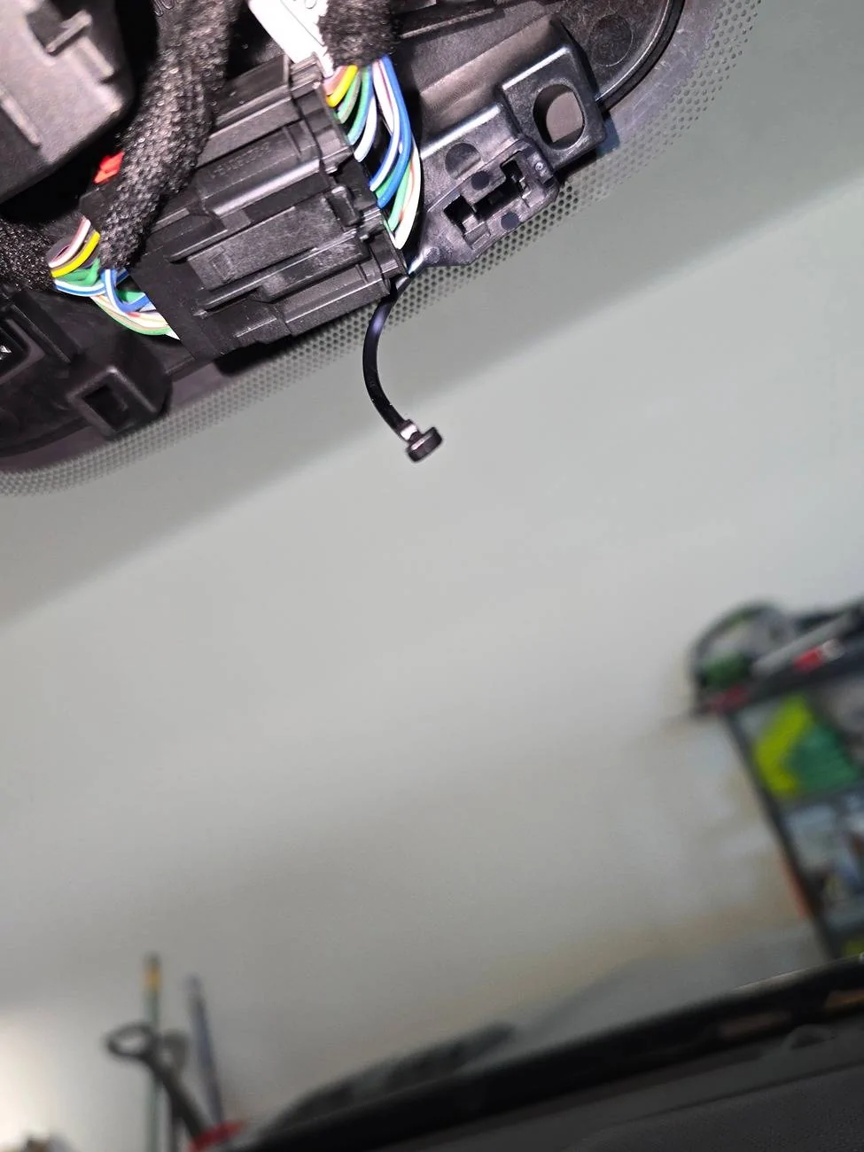

I'm gonna be real with all you. That wire seems like a "theft deterrent" sorta wire. Does not seem relevant to actually keeping this cover assembly securely attached. Once you understand how it works getting it off is easy. But in order to re attach it with the rearview mirror still attached seems next to impossible. I just unclipped it and deleted that SOB.
