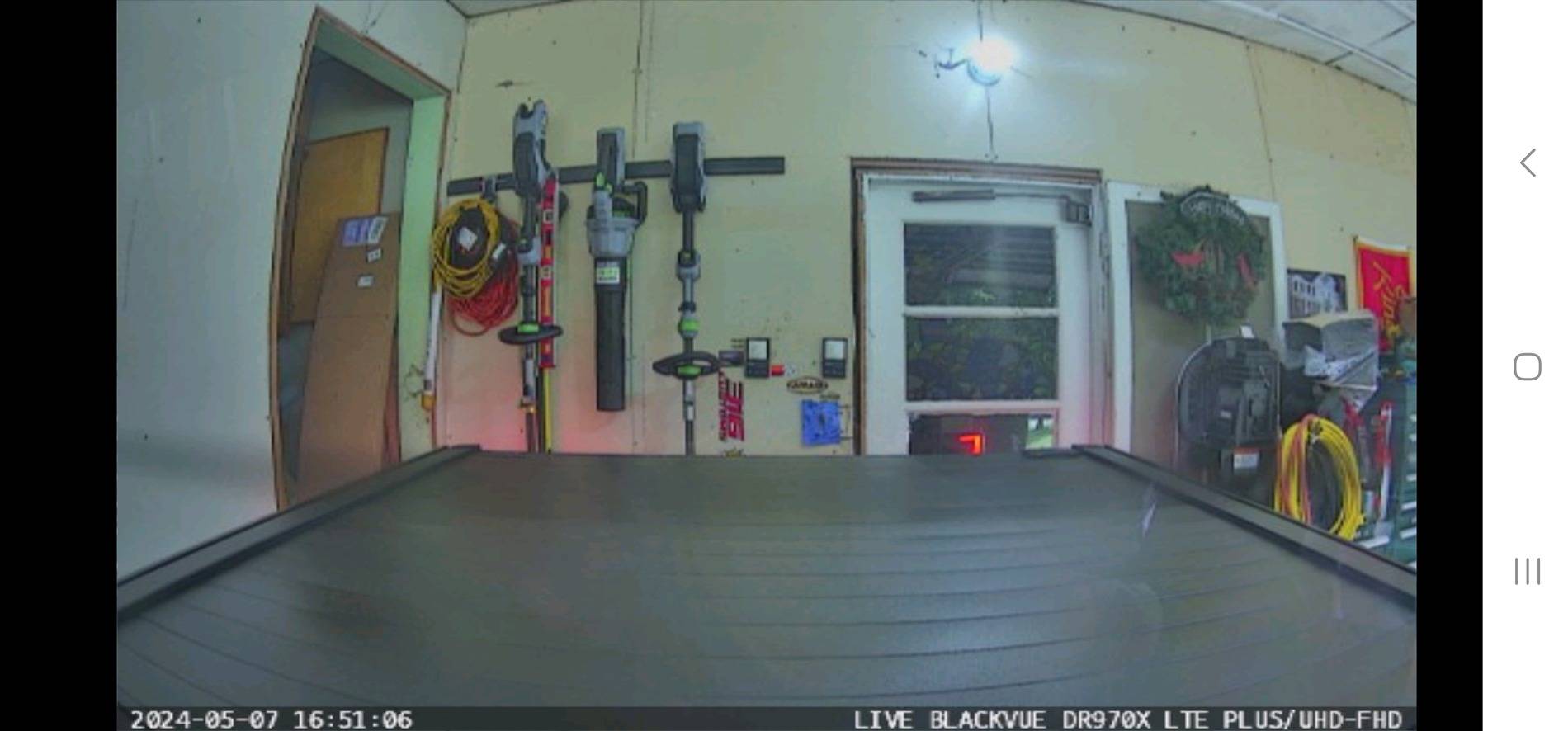

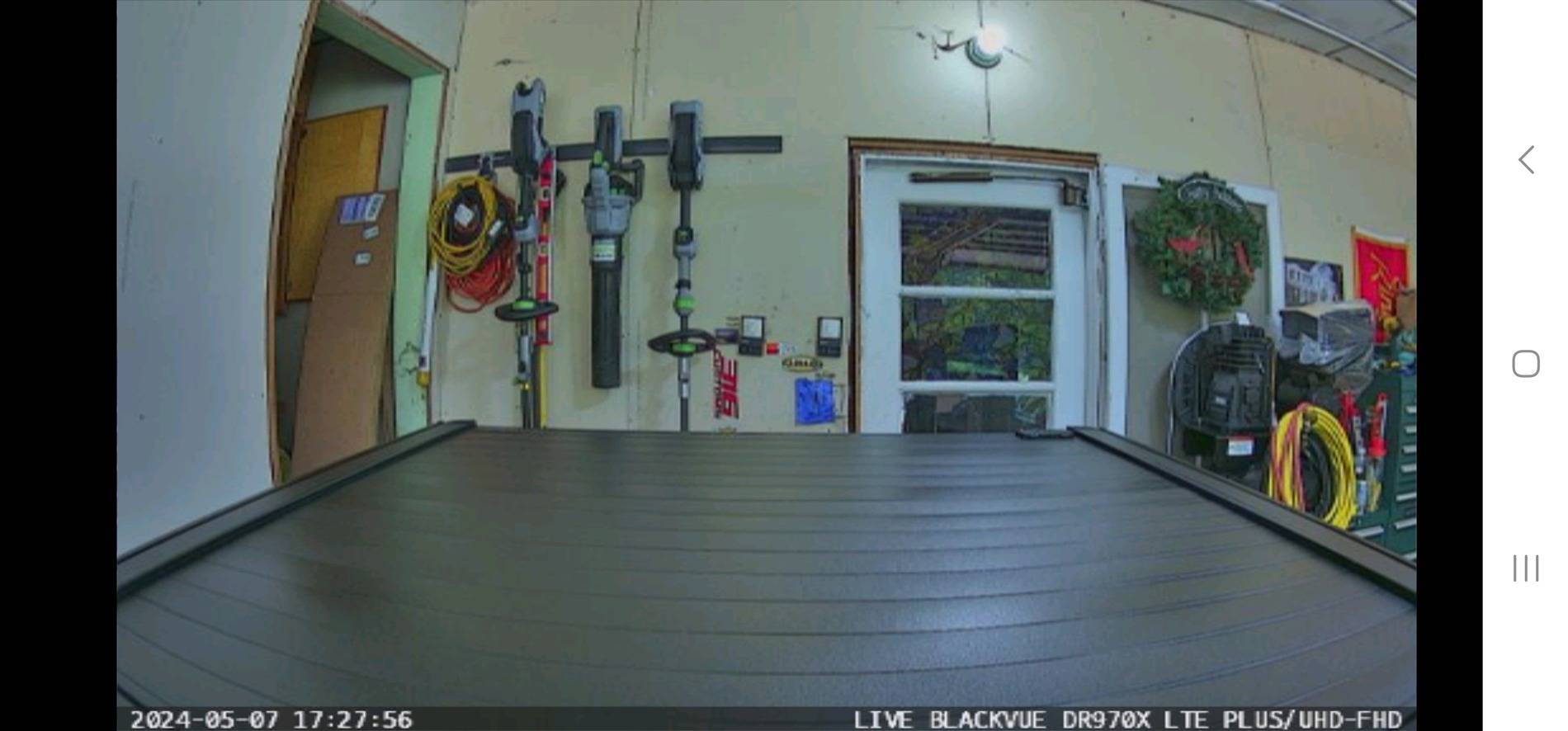

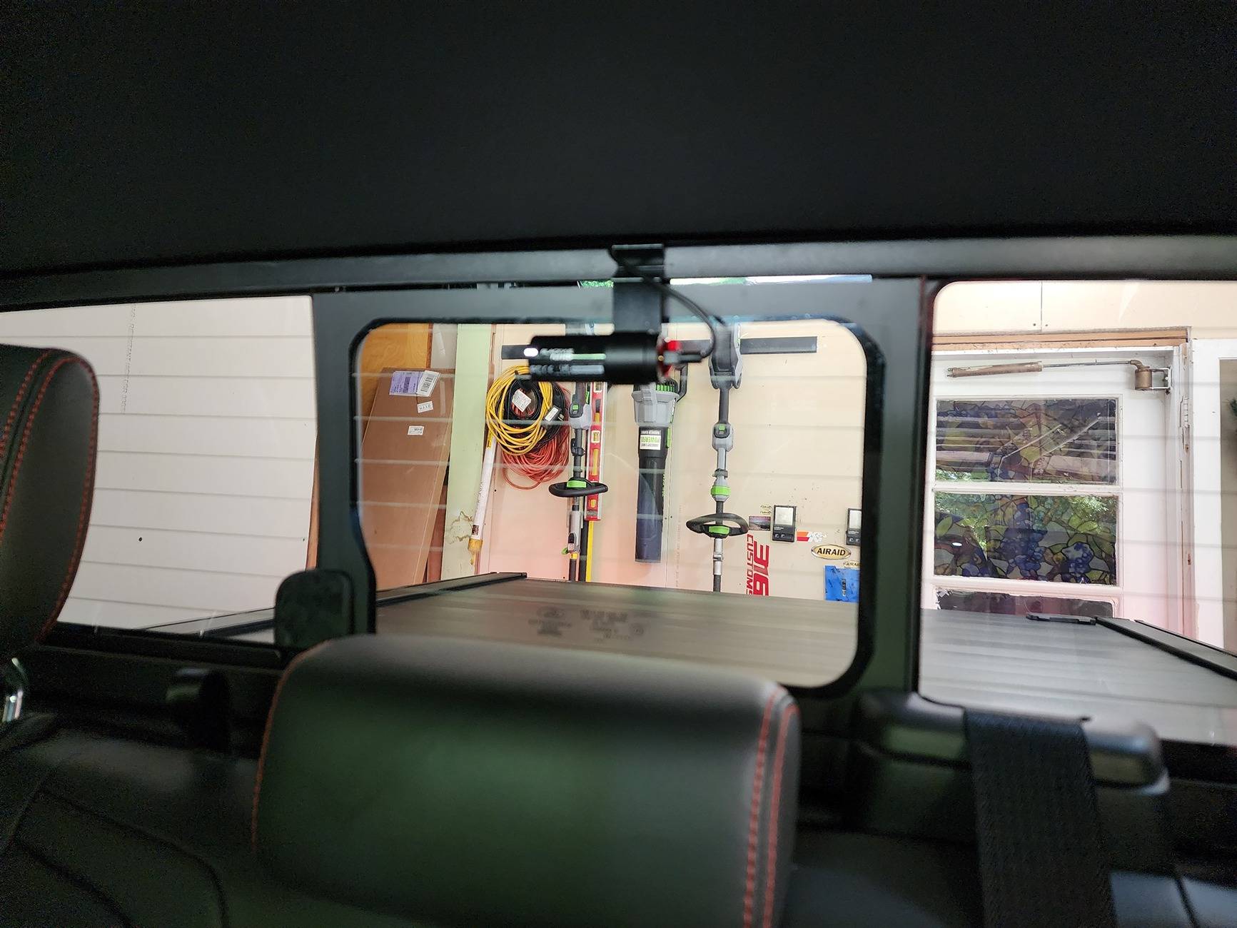

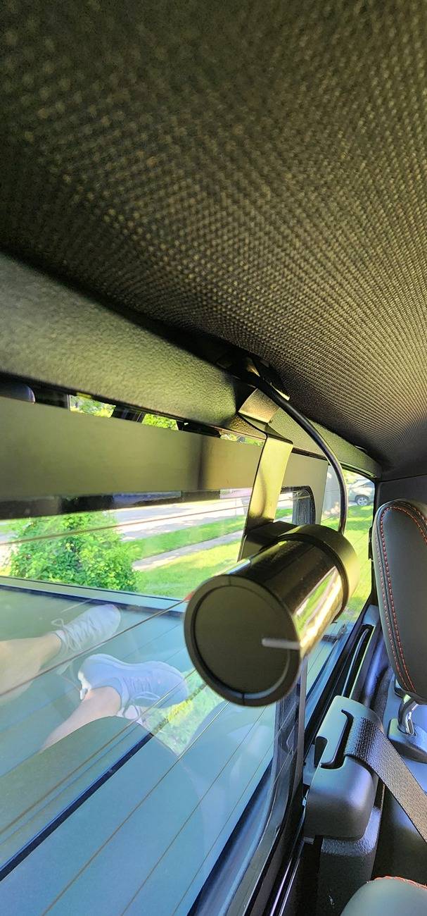

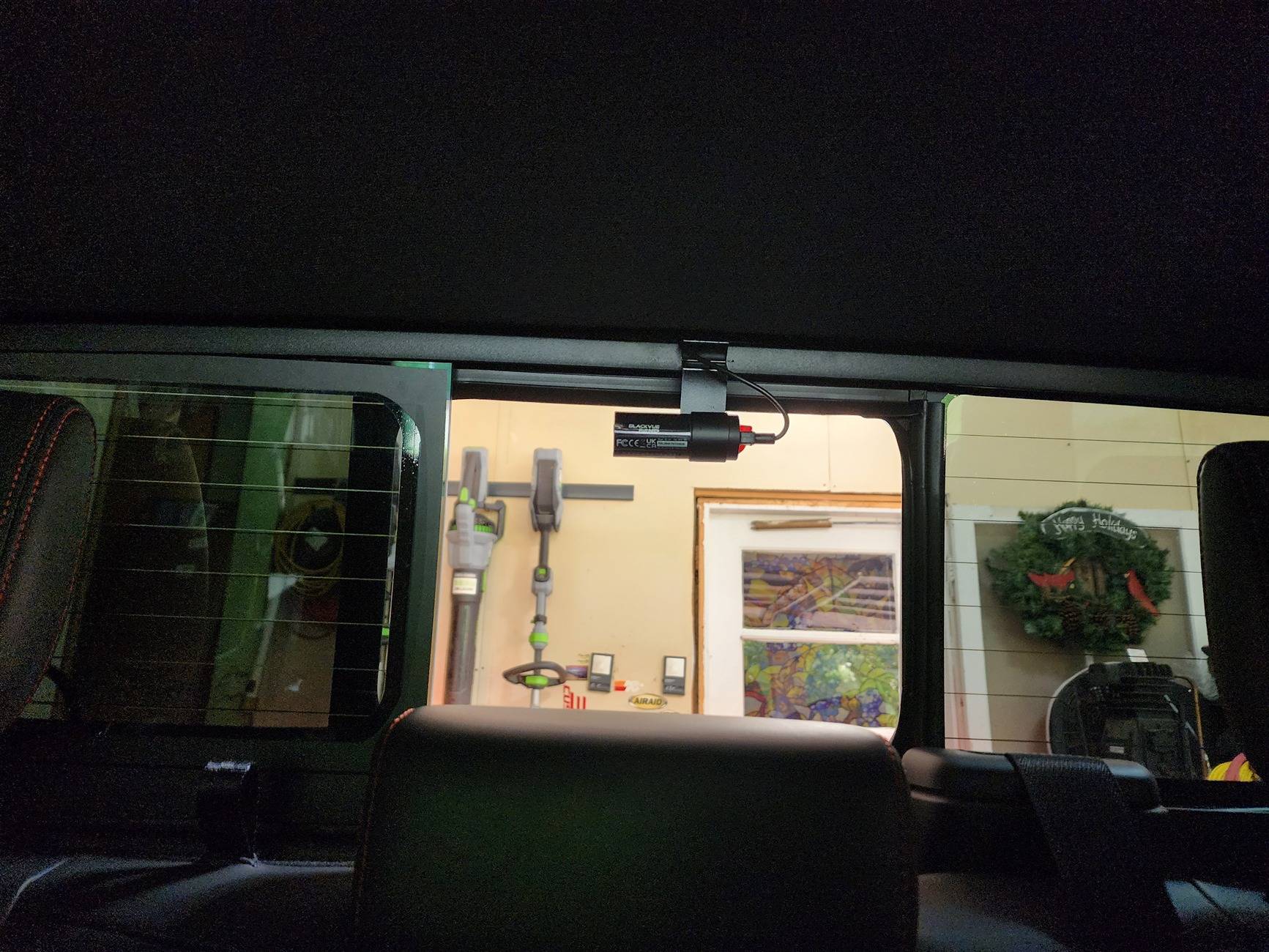

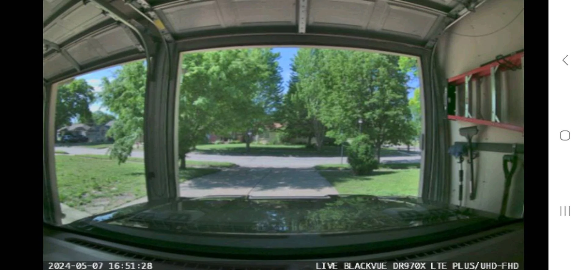

The bracket worked decently. Just wedged it between the headliner and did just bend it to clear everything so I can open the window without issues. Works good, I think. Anyways more pics, less talk.
Screenshots from phone, actual images and video is much much clearer @ 4K.

Very cool. Thanks for sharing. I've only installed the 2 channels in my 2 door sports coupes.
Which side of the vehicle did you run the rear channel up? Passenger?
Did running the rear channel cable require removing any roof liner or B pillar trim? Or were you just able to tuck it as you went?
Have you had the opportunity to drive yet? Does that bracket seem secure and tight? No rattle?
Appreciate you trailblazing for us. Think I'm going to order my dashcam tonight lol

I took the lazy route and ran everything on the drivers side. Had to pull the A-pillar out but not remove to run the hardwire kit to the fuse box. A-pillar has that same weird retention clip that's in the mirror shroud, just a much larger version. But it's not an issue; I didn't even mess with it. Everything else was just removing the door seal (front and rear) and tucking the wires into the headliner with a trim tool. Didn't pull the B-pillar, just used tool to feed wires through, just tuck and go.
Just got back from dinner and checked the recordings. Worked really well. Not as solid as the front mount, obviously, but not shaky and no rattles or noises at all. Very happy with it.
Only hindsight is the choice of camera. Don't know if I'm going to benefit from LTE cloud connection or paying for one. Just felt like I really wanted to be able to check on the truck with a live view at any time from any where. Time will tell. Plus I wanted a mirror mount, all the windows are tinted so no sticky 3M tape allowed. Kind of limited on choices so I'll wait to second guess myself for now.

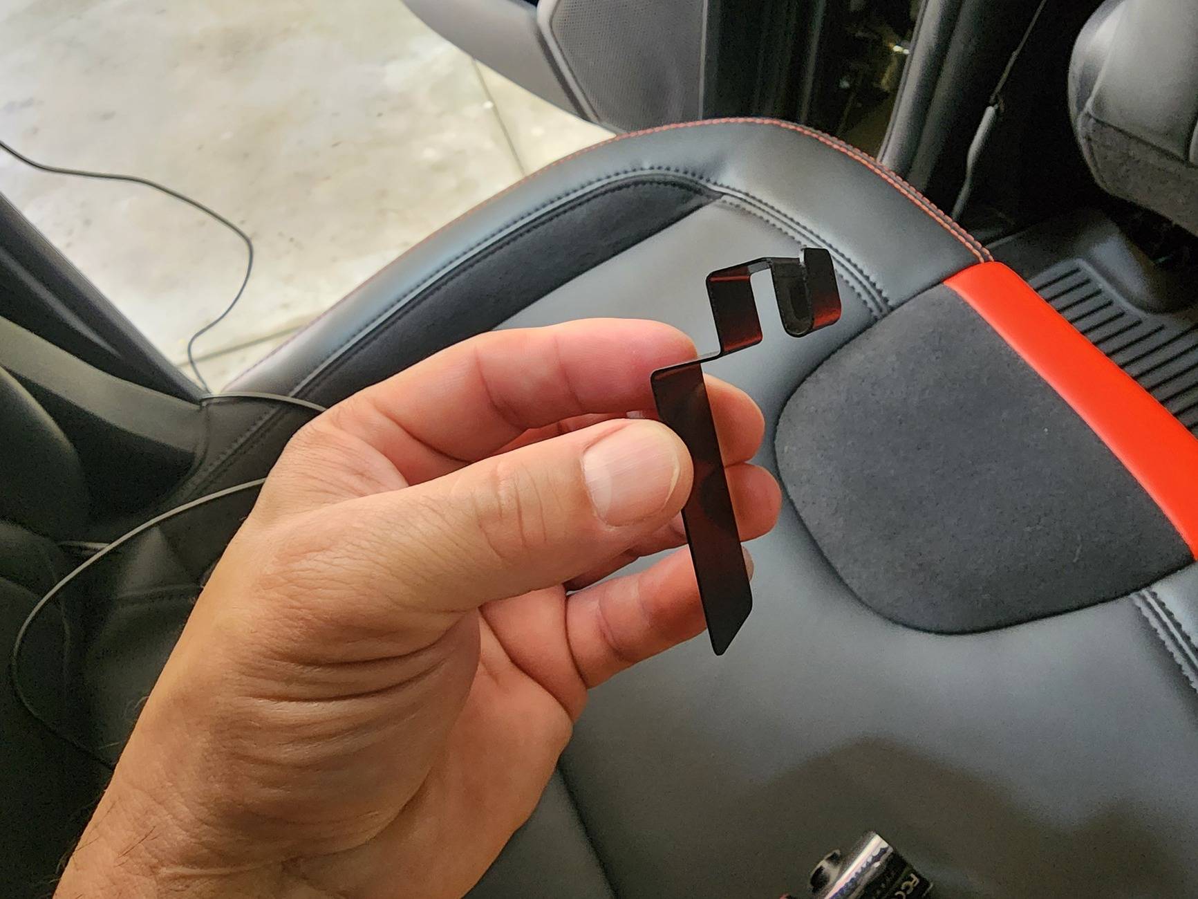

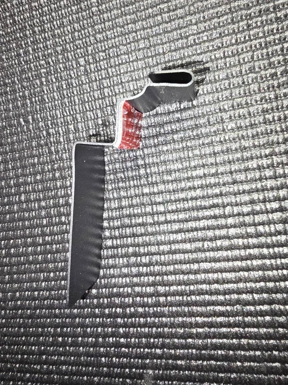

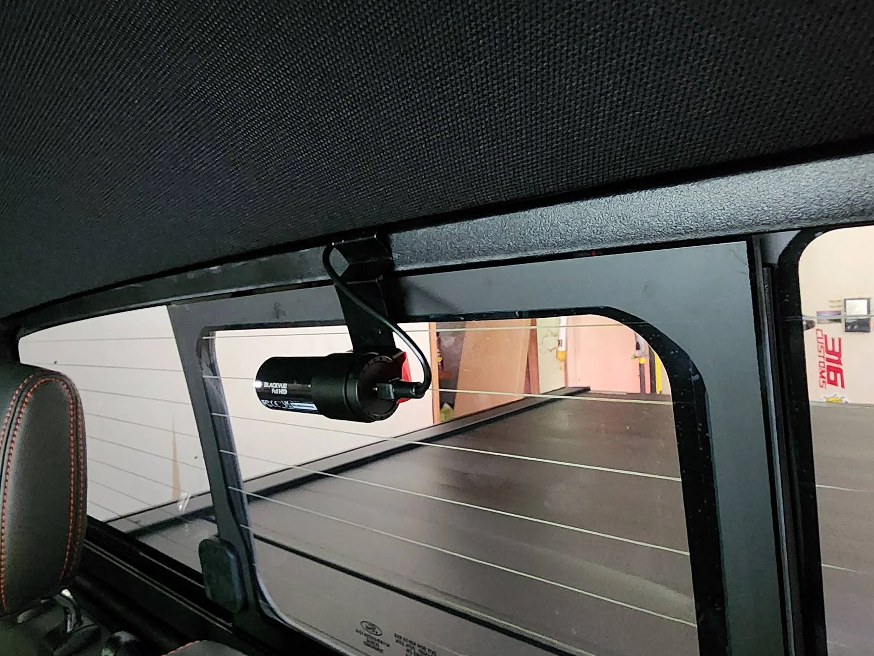

Hey out of curiosity is this somewhat close to the shape you ended up bending the bracket to? Did you also attach any 3M tape to the small portion that sits above window before the headliner?

I actually didn't bend it very much at all. Wish I'd have taken a picture before installing it. Just took a picture, see if this helps:
And no tape other than the tape to put the camera on. Just wedged in there, friction fit. Doesn't move at all.
