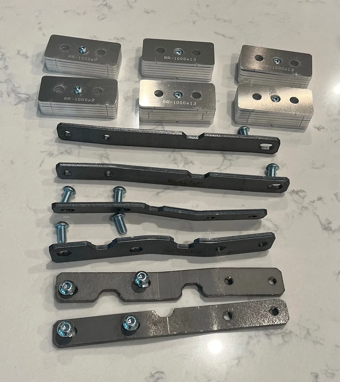

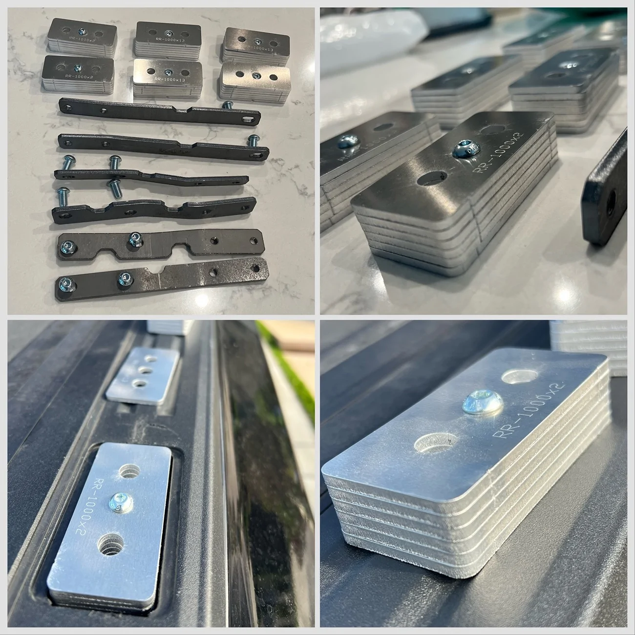

OK, Just the spacers than.

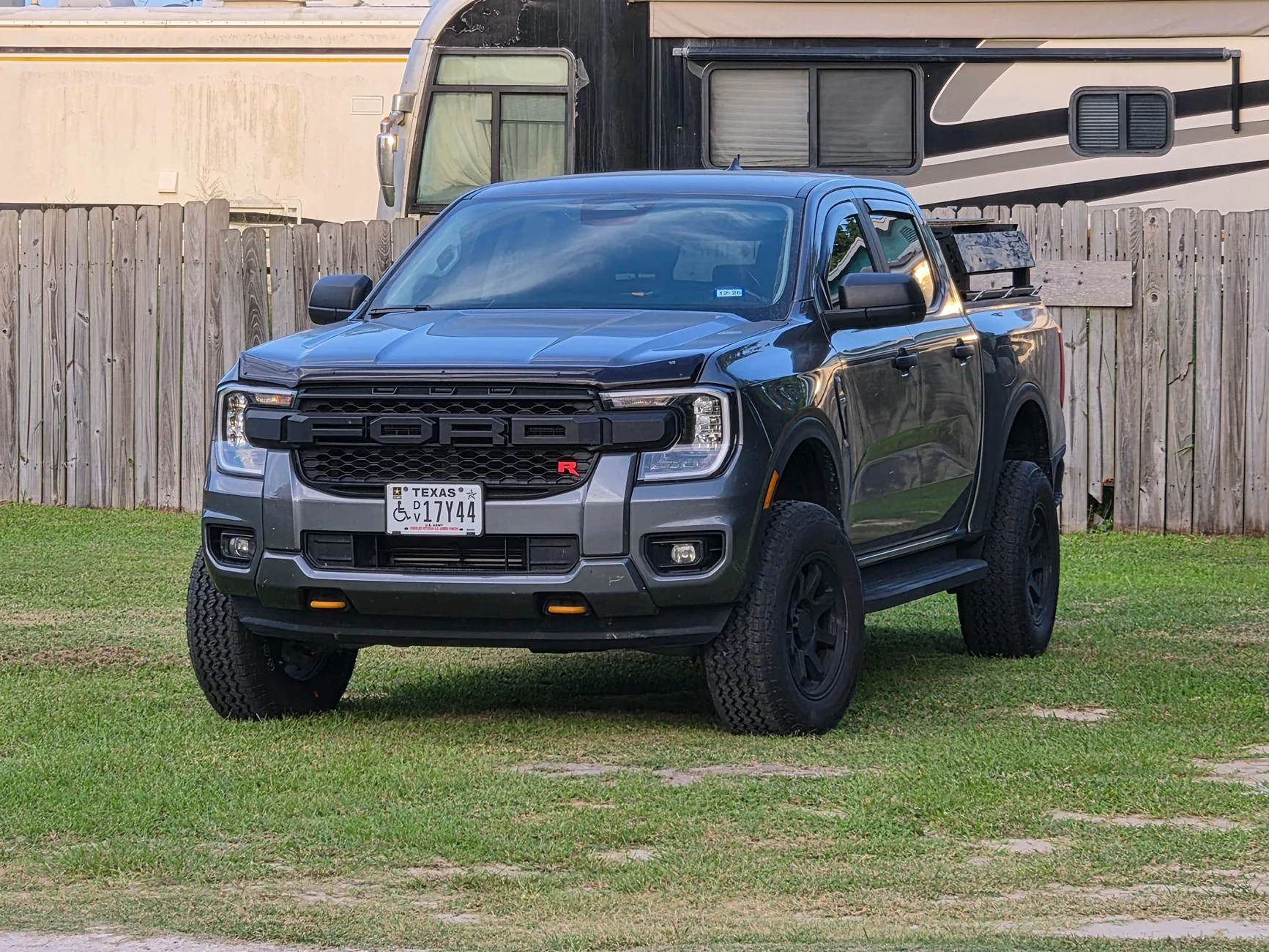

The American adventure labs spacers and nut plates are great. I bought them and used them put an overland rack in my truck that will also get a tent on top.
Ford Ranger Mounting an overland rack to the bed rails 20260719_195133
Sorry but I apparently have no other pics

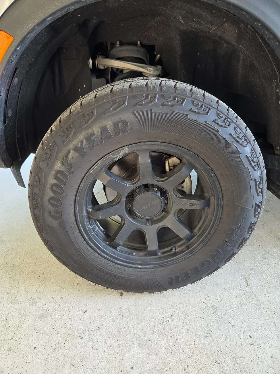

Thanks man, thats super helpful! What tires are those btw? Hows the traction. Im running the stock good year all terrains that came on it now and theyre pretty good here in Florida but id like to upgrade once these go bald.
I have the higher version of the stock goodyear territories. We have nothing for off roading here in south Texas so these are great for normal use and occasional dirt trails.
they are called territory at s

I have to say, if Ford did a Wildtrak variant, it should have that front end. That looks much so better than I would have expected. Beefy goodness.
3,819
3,627
3,819
3,627
Yup. I love how the truck looks with that grill assembly

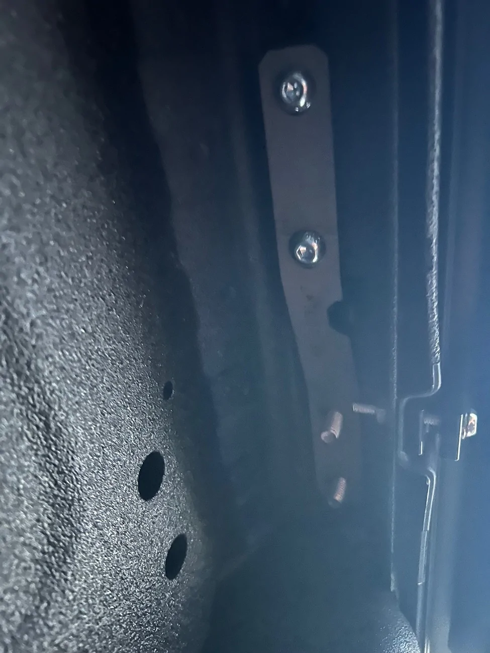

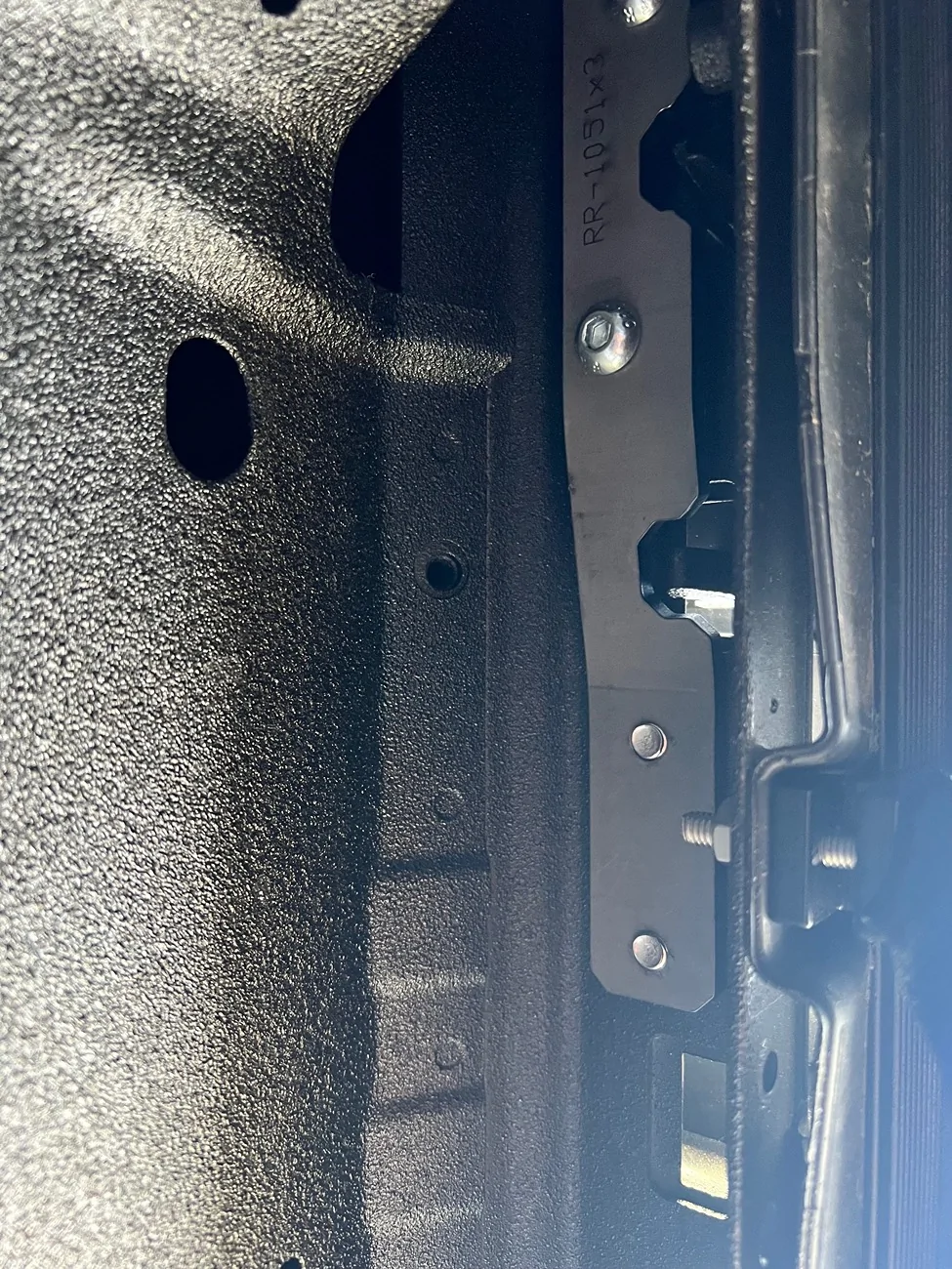

I did the same shims plus nut plates.How do you physically check if your truck has the j-braces?

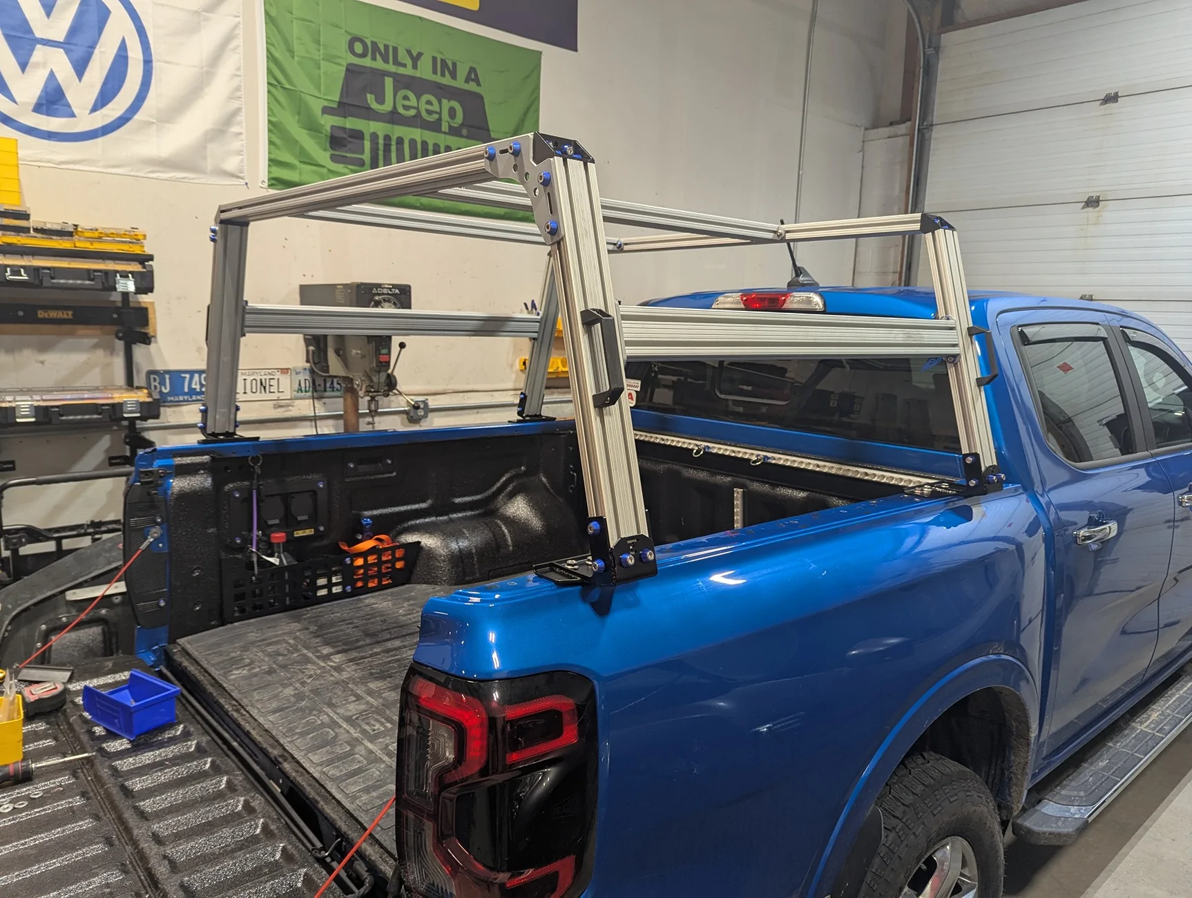

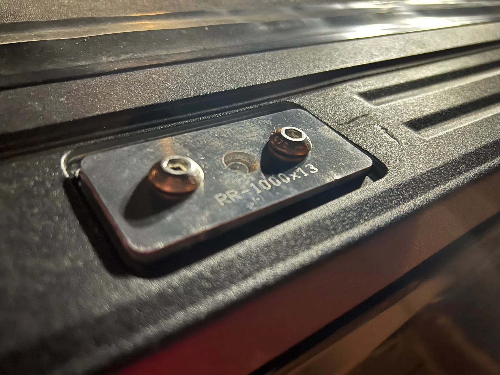

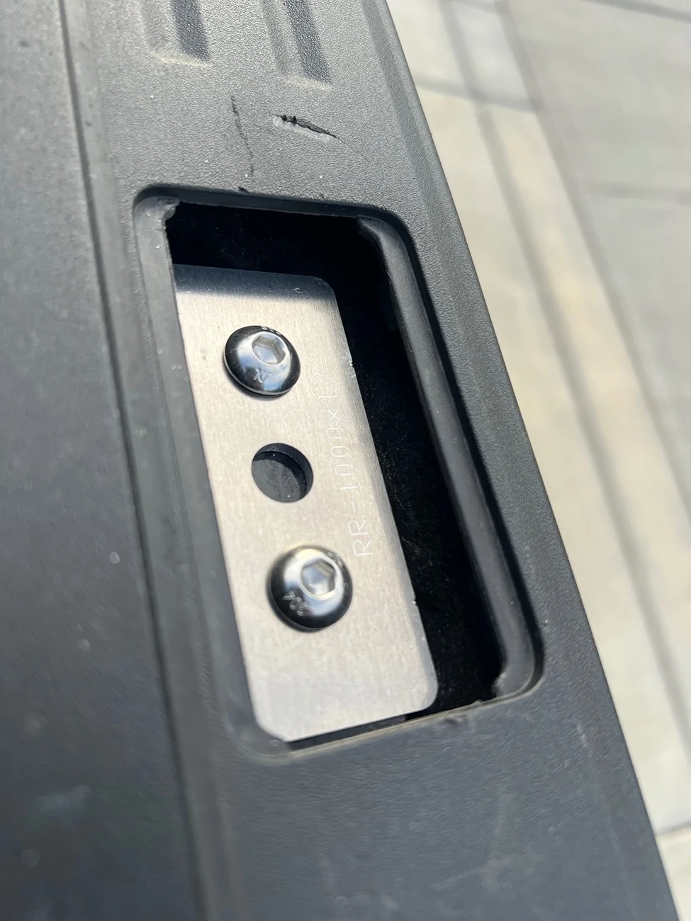

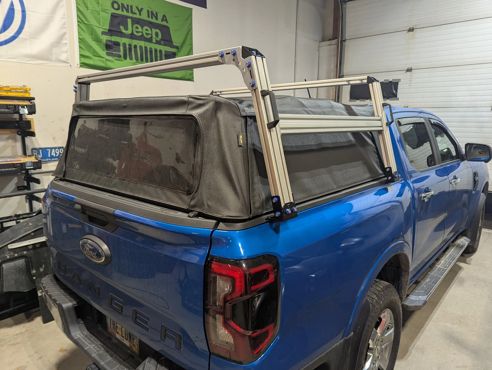

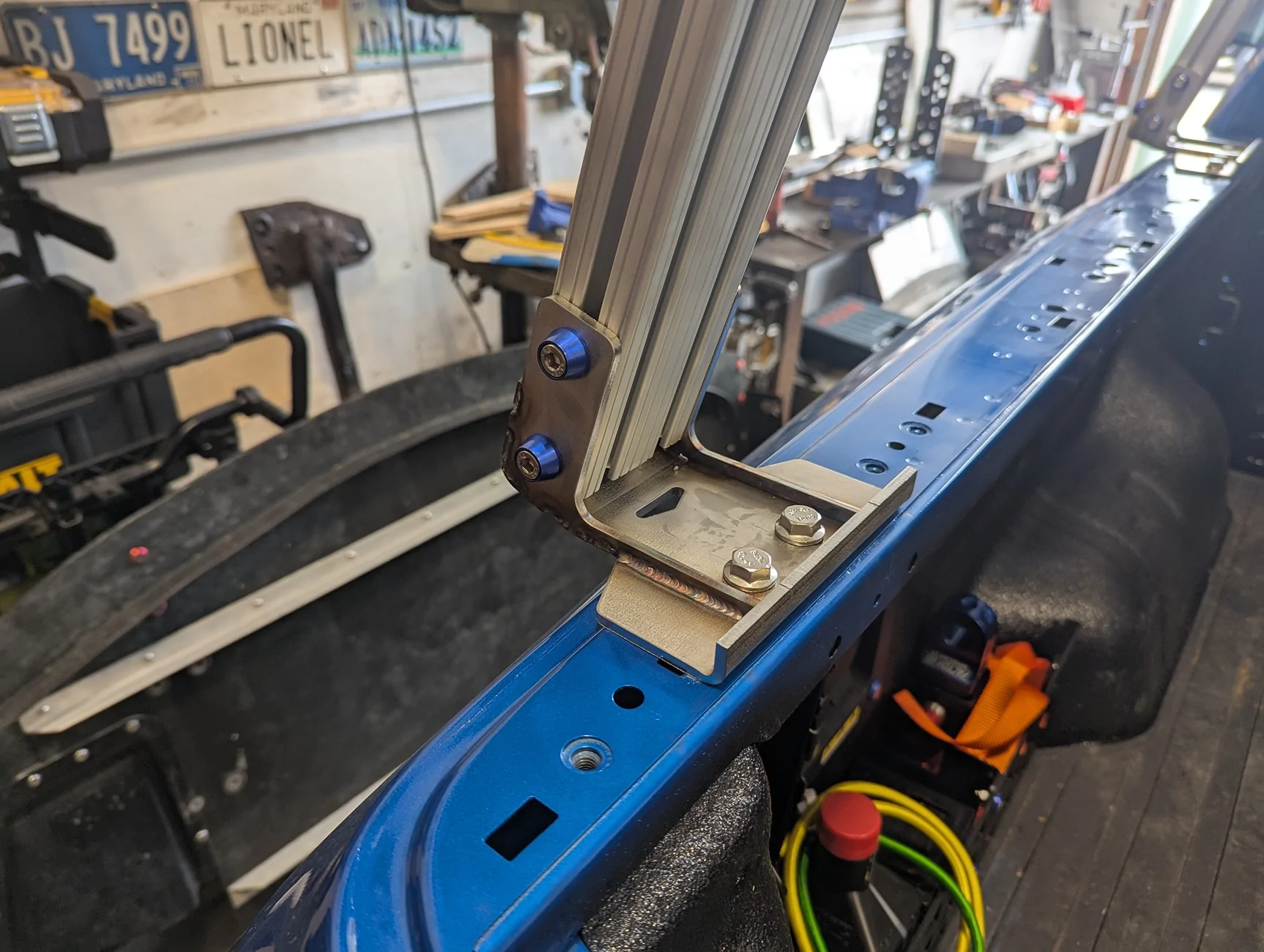

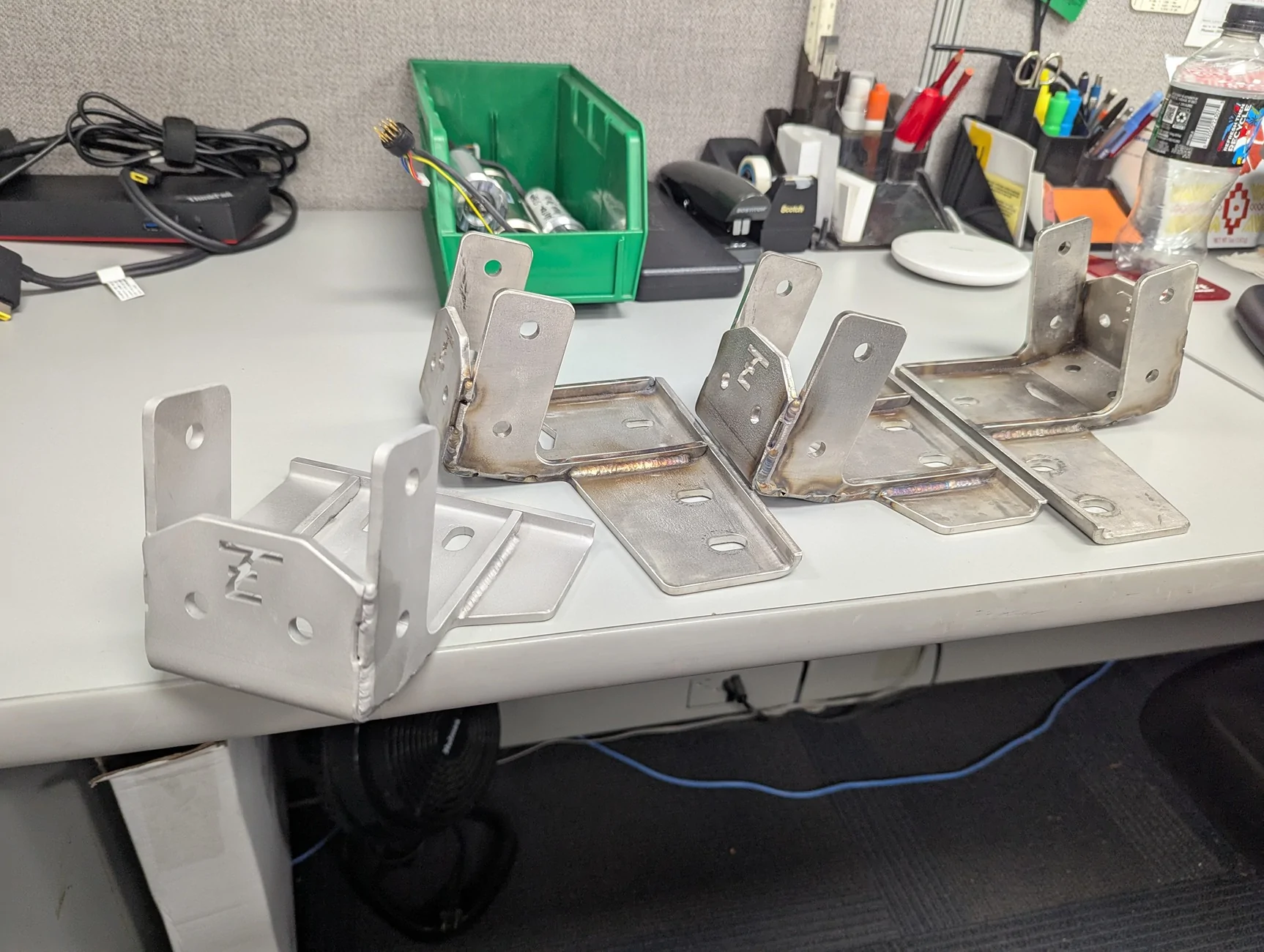

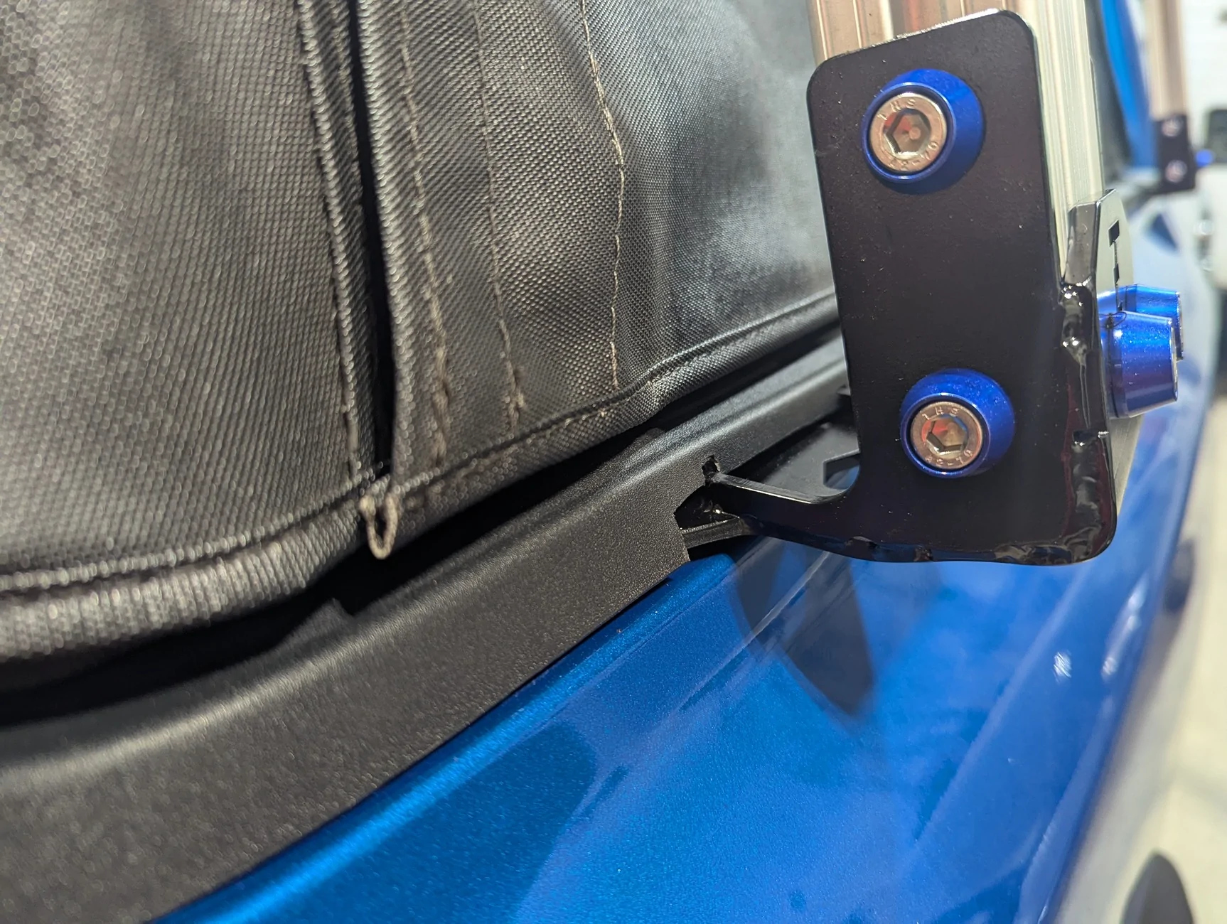

I went with the second option; remove caps, mount directly to the bed rails, and then reinstall the caps (after some trimming). This required making fully custom mounts and although I could probably have worked with a company like Xtrusion Overland to build the rest of the rack, once I started down the custom path I just "made" everything myself.
Custom SS welded mounting brackets (oversized under-rail mount plates not shown):
Ford Ranger Mounting an overland rack to the bed rails PXL_20250717_165646375
Rack mounting:
Ford Ranger Mounting an overland rack to the bed rails PXL_20250713_173731292
Ford Ranger Mounting an overland rack to the bed rails PXL_20250719_231705297
Trimmed rail caps:
Ford Ranger Mounting an overland rack to the bed rails PXL_20250723_011929223

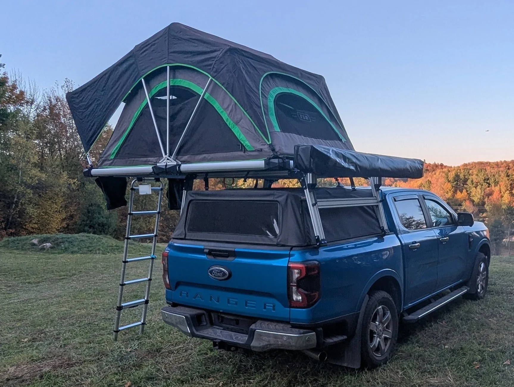

Finished rack:
Ford Ranger Mounting an overland rack to the bed rails PXL_20250723_011840127
Ford Ranger Mounting an overland rack to the bed rails PXL_20251005_212918595~2
You lay in front of the rear wheels and look up to a certain brace under the forward part of the bed. If the brace is completely an L shape with no breaks, you have the updated bed but if it's got the corner missing, you have the bed n3eding the brace. If I remember right
