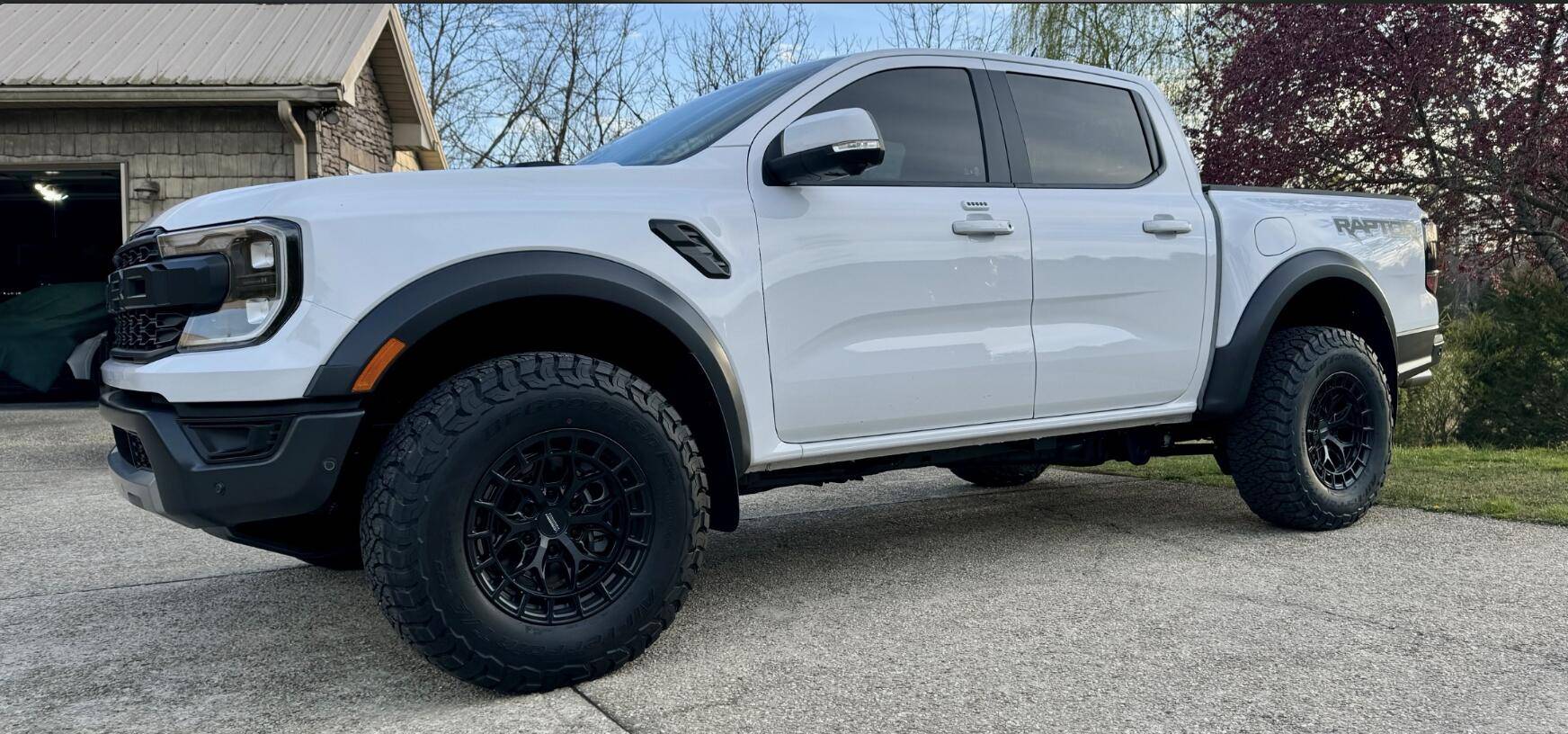

Wheels: Method 703 Beadgrip 17x8.5 +35mm
Tires: Toyo RT Trail 285/75/R17 10ply E
The tires are going to be a 33.8x11.3. Skinny / tall for some Baja & Mojave runs.
I will not be running any perch collars or spacers so stock front end height till Camburg & King develop aftermarket fitment.
based of the Aussie side research I have done, I may have to do minor plastic trimming with this setup but much less than running 315s or true 35s. I will document once I get the truck in hand in hopefully about a month
