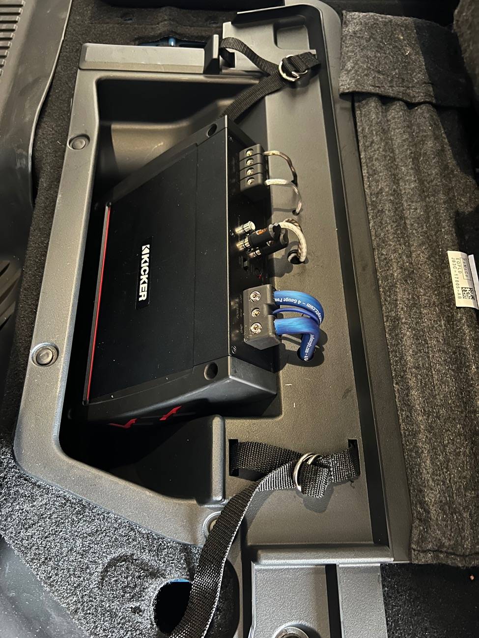

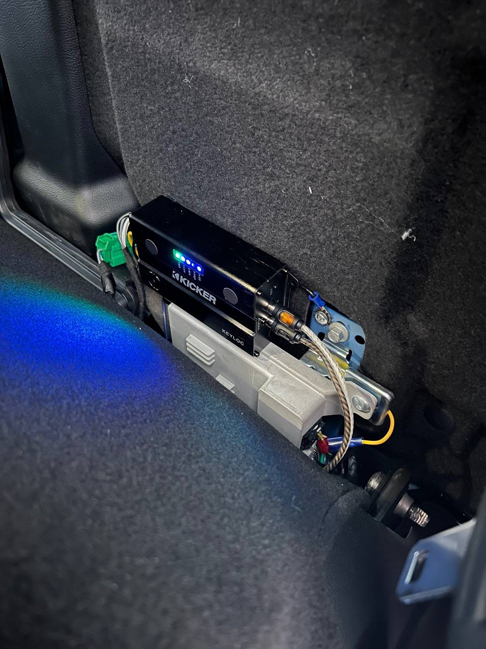

Actually the sub behind the seat isn’t a 6x9, it’s a round speaker about a 5-3/4 size as where a 6x9 would be oval shaped. I purchased an under seat sub box for a 10” sub from Australia. I’m installing a 10” 2ohm Hertz mille pro shallow sub paired with Kenwood KXA800.1 mono amp. I purchased a Kicker KeyLoc plug and play unit from Soundsgoodstereo.com that easily cancels out the factory bass roll off. Really simple install. Run the power wire find a proper ground, done.
Subwoofer-$449
Amp-$300
Box-$185-ebay
Plug and play-$250

This is the sub enclosure
https://www.ebay.com/itm/1926103196...-aneEvjQ1K&var=&widget_ver=artemis&media=COPY
this is the sub I got and it fits and sounds fantastic
https://volunteeraudio.com/product/hertz-mps-250-s2
This is the plug and play adapter, no cutting into wires and comes tuned and set with the kicker keyloc. I picked the option to get rid of the factory bass roll off.
https://soundsgoodstereo.com/produc...-o-including-unleashed-read-description-below
As for the amp, you can pick any brand you want, if you’re only adding the sub you will need a mono amp with a RMS of 600 watts. The kicker amp I used has is a 800w amp which pushes this sub perfectly. But I’ll attach the link to the amp I used, I like this amp because it has a Bluetooth bass knob so you don’t have to run a remote wire.
I had it installed at a custom stereo shop, they were ranting about the ease of the install with that harness and the quality and sound of the system
https://a.co/d/aWzJ4E1
any other questions just ask
