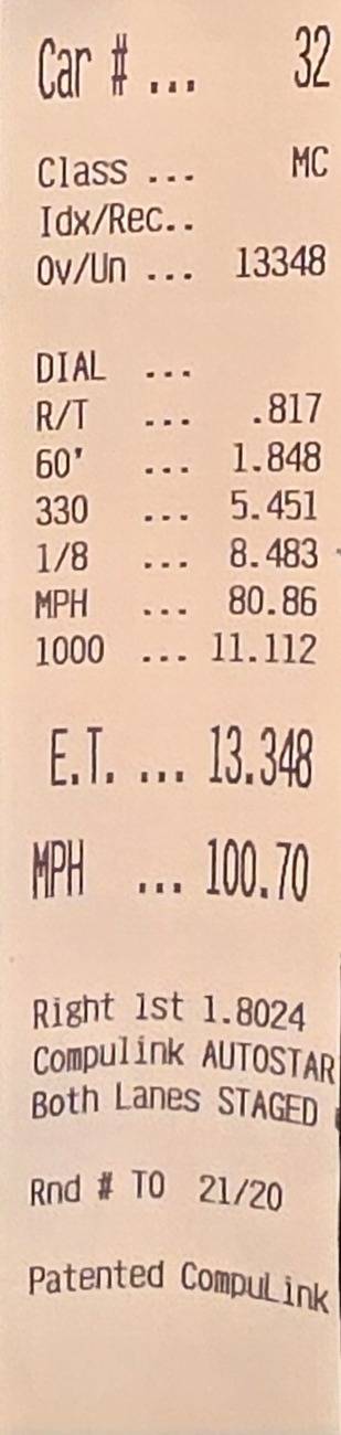

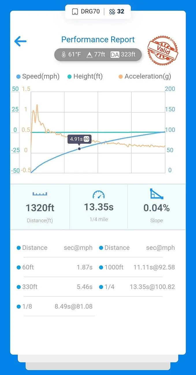

In the event this wasn't trolling, and you are simply out of touch with modern technology...the Dragy is very accurate as long as the time shows verified or valid. Plenty of independent supporting evidence online.
A non raptor thread once again hijacked, this time by a mythical low 13' Raptor. 😂
With stock Raptors running 14.1...why do you think it is mythical to run low 13's with the Ford performance Tune? Much of the ET gained is from the ability to launch at higher RPM and under full boost.
Due to the amount of traction compound and the effect on rolling resistance, times are generally even quicker on the street since traction is not a concern at this power level.
These two times are from the same run and you can see how exaggerated the ego booster phone app is for this mythical Raptor :giggle:
Ford Ranger Performance Test Review: 2024 Ranger XLT w/ Optional Twin-Turbo V6 13.35-2
Ford Ranger Performance Test Review: 2024 Ranger XLT w/ Optional Twin-Turbo V6 13.35-1
PS. Once Ford releases the Performance Tune for the 2.7, I bet we'll see some of those in the low 13's too.
Thanks for this info. Traction is indeed key to successful and consistent straight line runs. I come from the high hp gt500 world. It was always interesting when folks with 800 hp at the engine struggle to get into the 12s without dealing with the need for better traction
