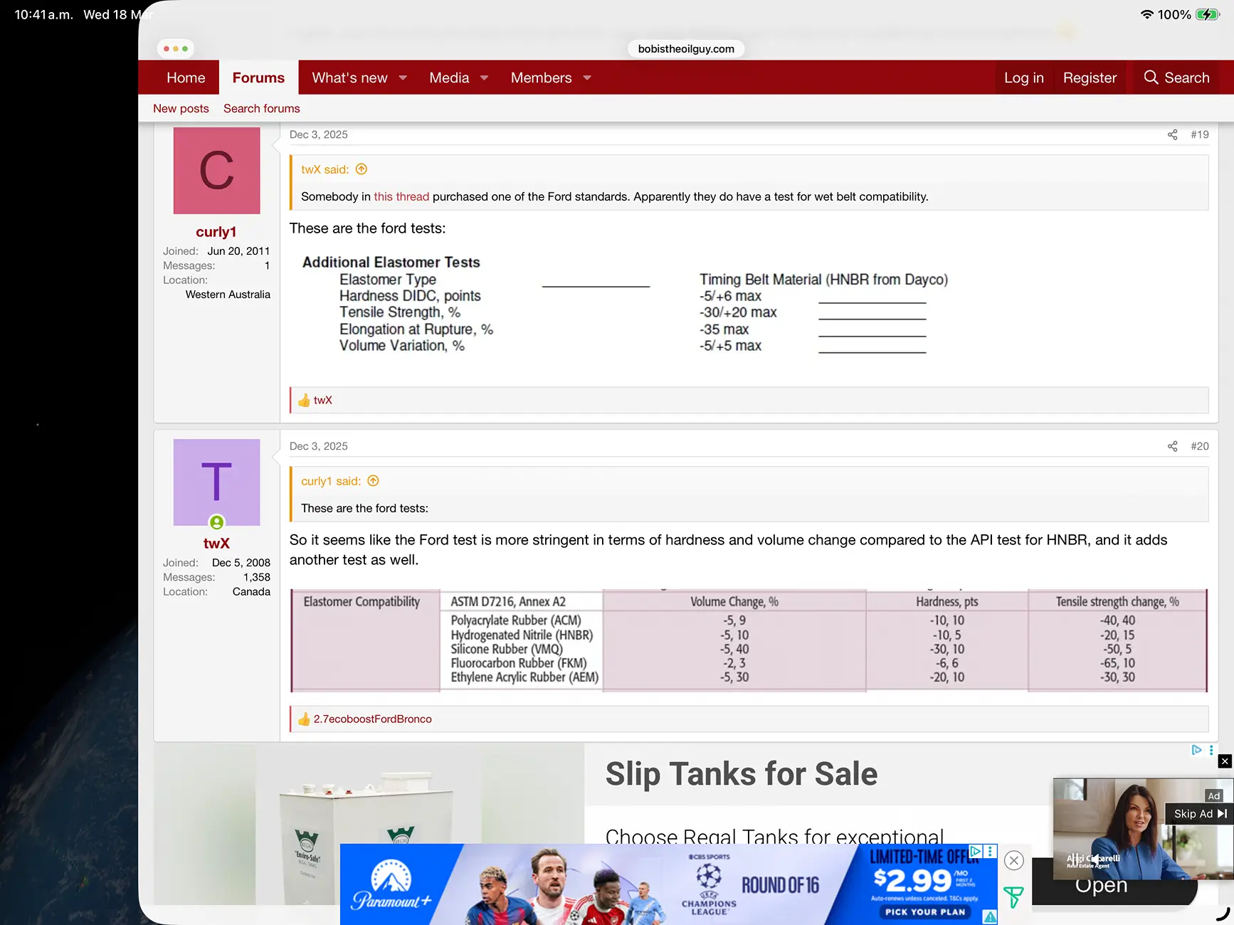

The question is in my view, did the owner of the engine cause the failure? Suppose he ran non-spec oil? The wet belt potential issue of deterioration is related to not using the approved oil. Specifically Ford specs are tougher for wet belt than API.

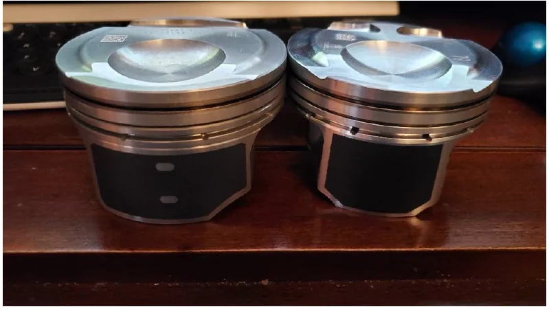

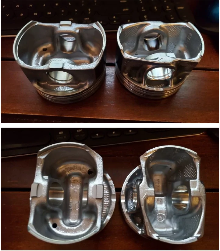

Go on auto trader and look to see how many high mileage 2018 or newer 2.7L F-150's are for sale still running as fleet vehicles or work trucks. There's a ton in my area with anywhere from 215k to 285k miles.
Although there is some misinformation in the video about the pistons. The 3.0L pistons are more robust than the 2.7L pistons, neither are forged though, turbo diesel pistons are forged like what would be used in a built race engine.
The 2.7L and 3.0 still use hypereutectic cast aluminum, but well designed with cast in steel ring liners on both. The 3.0L pistons also have oil cooling galleys like the 6.7L Power Stroke pistons, another turbo diesel feature not commonly found in gas engines.
The 3.0L features much bigger skirt and thicker walls. The 3.0L has a noticeably more robust wrist pin bearing support. Yes, both use a bowl design similar to turbo diesel piston.
3.0L on the left, 2.7L on the right.

BTW, the belt driven oil pump is just one of several reasons I only run OE spec oils now in all my cars. I looked through a bunch of used oil analysis results and rarely saw OE spec oils of any brand come back poor.
Usually, the ones with results that were not good were using a non-OE spec brand (off-the-shelf) and had to switch through multiple brands to find one that worked. So basically, if they had just gone with OE spec, they wouldn't be switching through different brands trying to find one that worked well with their car since the OE's know the engine best and do all their original development testing with their oil blends.
With Ford Ecoboost engines, the 2.7L, 3.0L and 2021+ 5.0L, I think OE is probably the safest bet for belt compatibility and durability.

The point to make regardless what EcoBoost engine is on the 500,000 teardown is his description of HNBR wet belts and the SP/SQ oil standards to keep them working. His statement is as long as this oil is used there will be zero issues as long as normal OCI. Add to that the Ford standards are tighter for HNBR belts. The video teardown with the failed 2.7 Ecoboost engine showed an issue with that HNBR wet belt. Wrong oil or oil failure on that engine.
