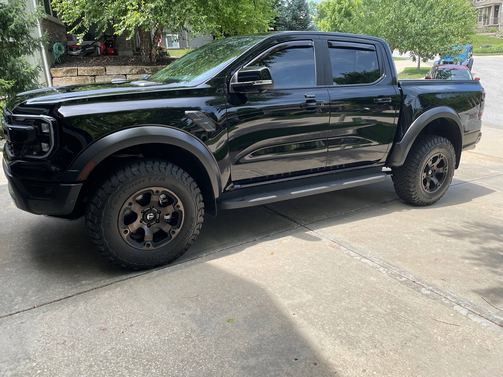

I did both. PPF professionally done and paint correction and ceramic myself. Absolutely the ceramic is a must. I was in the fence initially but used C6 Hydro Lite. Easy to apply and the self cleaning in rain or a touch less carwash has kept it amazing
Ford Ranger PPF, Ceramic Coat or Both? IMG_0733

Looks great....just curious why do you think Ceramic is a must? Was keeping the truck looking clean and easy rinse-offs your main motivation or something else?
