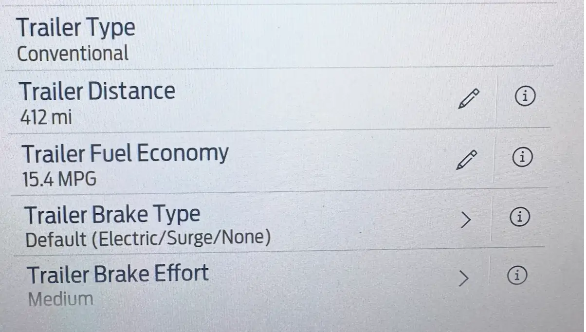

Hi, I have the advanced towing package. One of the apparent features is that it will track the mileage accumulated by my trailer. However, I'm finding this is quite erratic. The first time it just stopped at 100 miles (about 125 miles short). I manually corrected it and the next time it was pretty close but about 4 miles short. I would have thought this is a pretty simple thing to get right. Anyone else seeing this, or is it working correctly for others? The attached photo is from the trailer setup page.

I cannot help, I have the regular tow package but it's very odd it stops tracking the miles suddenly

The Ranger's trailer mileage tracker relies on continuous 7-pin plug connectivity. When the connection drops—even briefly—the tracker stops. Road bumps, tight turns, or dirty plugs cause signal drops. This explains your erratic and short mileage totals.

I have noticed similar issue on mine, I was missing about 25% of my tow miles so I added them back in. (2025 Lariat 2.7 with advanced tow). I have not been able to narrow it down to any specific cause. Leaving in two weeks for a 2,500 mile 2 week trip with camping trailer so will be checking daily and seeing what I can figure out. Will make triple sure the 7 pin connector is tight, but all is new and seems real solid so am doubtful of a connector issue.
I was thinking it might have dropped a bunch of miles during the last OverAirUpdate about 2 months ago, or other possibility was I did tow my connected trailer in Normal Mode vice Tow/Haul once inadvertantly so maybe the miles are not logged unless also in Tow/Haul mode. Seems to somehow be counting something because the remaining oil life miles drop twice as fast while in tow/haul mode. Also, I get 15.2 mpg with 4,600 Lb (dry wt) camper. Regards...

I guessed at the same cause. Planning to check the harness and plug for dirty connections/loose wires.

I think I've been using normal mode the whole time (~4500 lb trailer loaded). Tows well, but I would expect the mileage tracking to be all or nothing. I'm leaning towards the 7 pin connector either being loose/dirty. Stay tuned.

I have the same problem with mine. Sometimes works 100%, other times i have to correct mileage. I can only assume its some type of issue where the software or hardware or something just has a glitch not big enough for us to see and stops? Thats with a 4 pin connector. Usually no problems with a 7 pin. Usually. I have not found a rhyme or reason.

This is an interesting thread to me because I read the relevant towing section of the manual a few times, and mention of trailer mileage tracking is light and brief, and I thought that it tracked vehicle fuel mileage while in tow mode (or even more specifically it might track fuel mileage with a given trailer attached), and adjusts DTE (distance to empty) accordingly. It didn't occur to me that it was tracking trailer miles rather than mileage with trailer attached. I've towed a fair amount but only have one trailer configured and haven't spent any time looking at any data it might have gathered.
