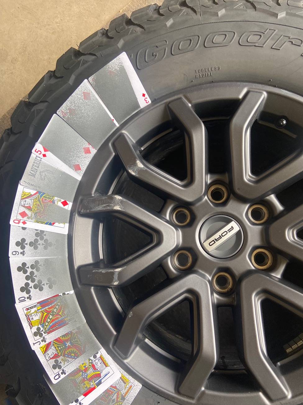

Finally made time to repair my trail damage. I decided that while this is a beautiful, brand new truck, its also my occasional daily driver/snow vehicle/gravel road runner and it will never stay pretty. I decided to go with the cheaper, acceptable repairs vs full replacements or hiring professional body shop.

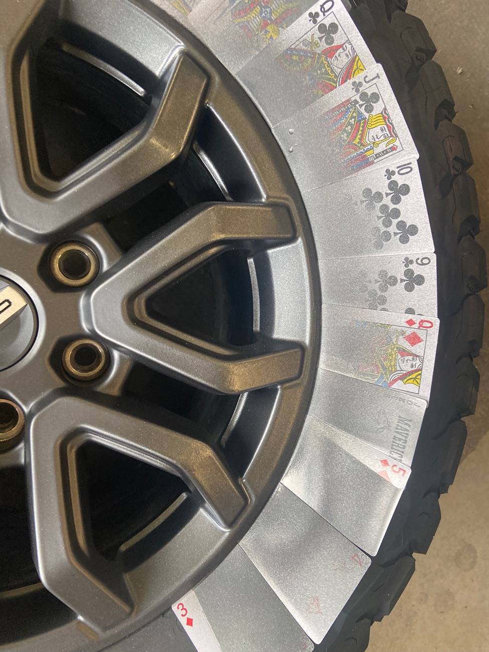

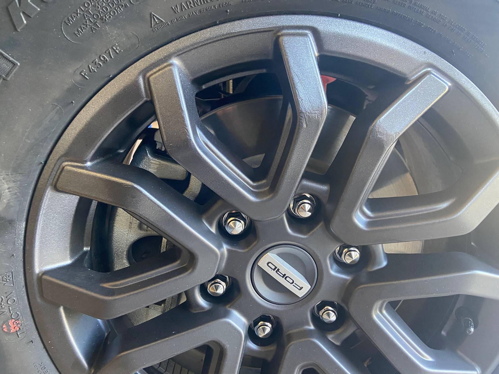

Two scuffed wheels:
Removed them from truck. Lightly sanded the damage with orbital to smooth and scuff paint, but didn’t take off much paint.
“Masked” the tire with playing cards.
Ford Ranger Ranger Raptor in Moab and Hells Revenge IMG_1119
Hit it with four or five light coats of duplicolor magnetic grey.
Ford Ranger Ranger Raptor in Moab and Hells Revenge IMG_1121
Back on the truck. Can’t tell till I get it out in the sun, but looks quite acceptable in the shop.

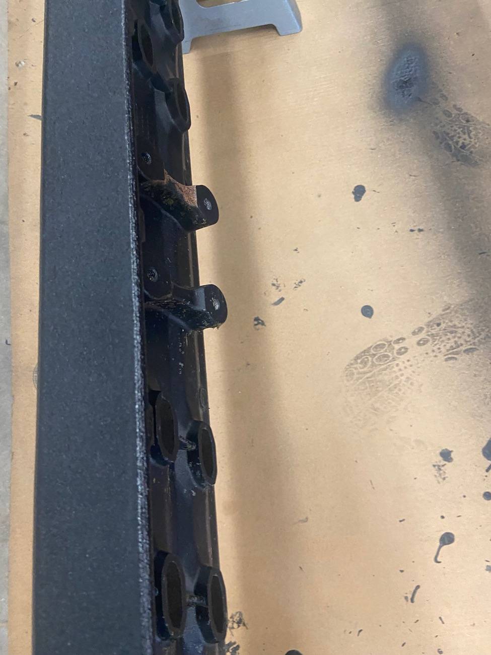

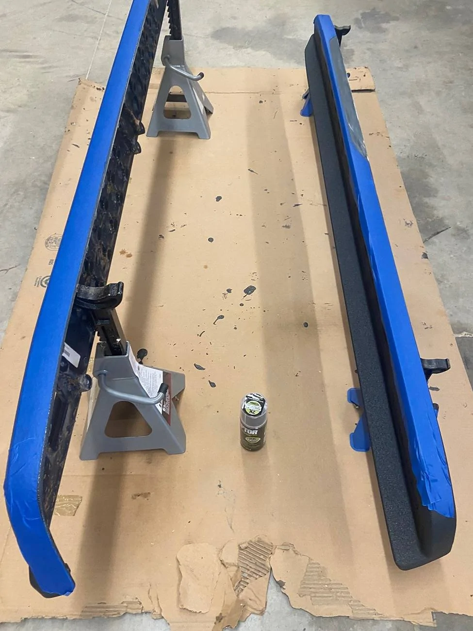

Running board:

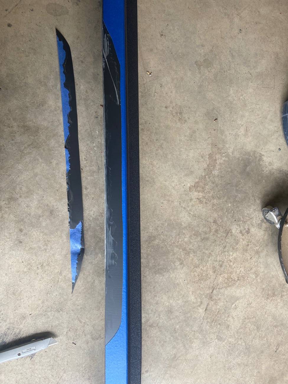

I crawled under the truck and noticed that the running board was super easy to unbolt. I removed it to make it easier to work on and avoid overspray issues.
I masked over the damaged area, then cut the bedliner for a straight seam. I was highly disappointed how easily the factory bedliner peeled off the powder-coat underneath, it peeled off in one piece with the masking tape.
Ford Ranger Ranger Raptor in Moab and Hells Revenge IMG_1116

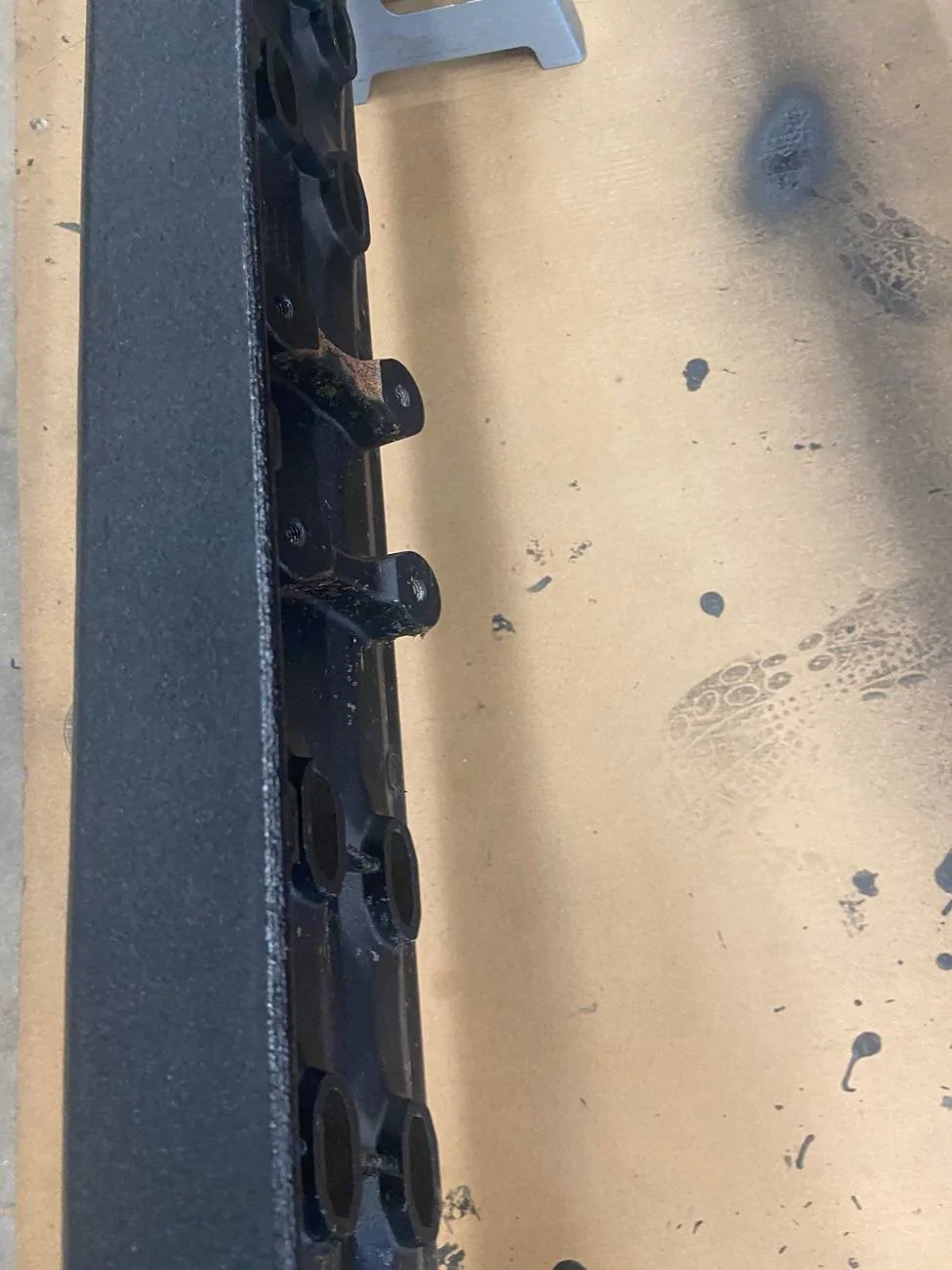

I finished masking the board, and scuffed the powdercoat with an orbital sander, cleaned with alcohol. I also pulled the driver side board, as i knew the bottom was scuffed and was scared of the bad adhesion, so wanted to seal it up.
Ford Ranger Ranger Raptor in Moab and Hells Revenge IMG_1117

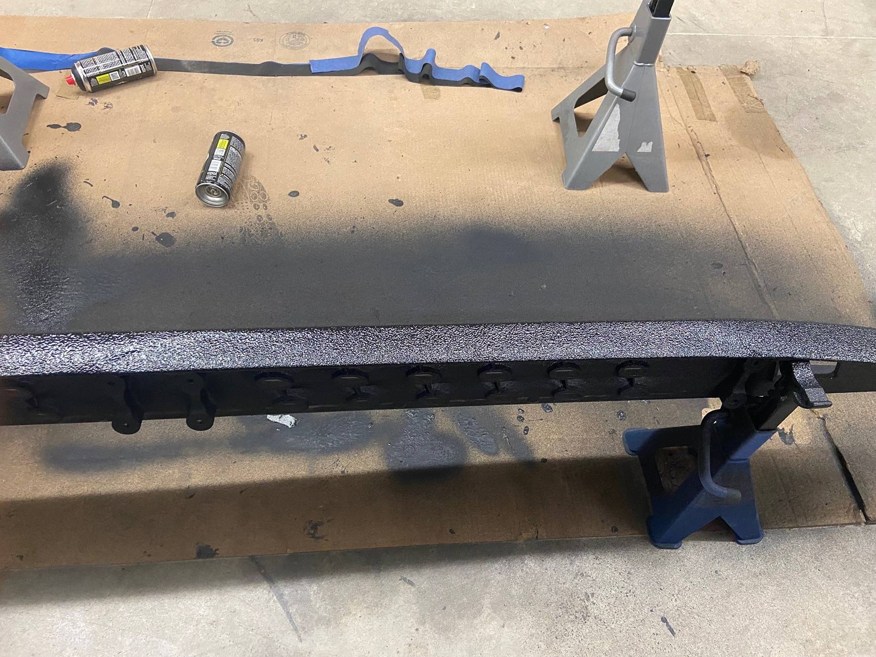

I sprayed both boards with raptor liner 2x at 10 minute intervals. The instructions said 20 min between coats, but i needed to build thickness to match factory liner. The spray can is only good for 60 minutes once activated. I peeled the mask off the driver side board after two coats, and considered it successful.
Ford Ranger Ranger Raptor in Moab and Hells Revenge IMG_1118

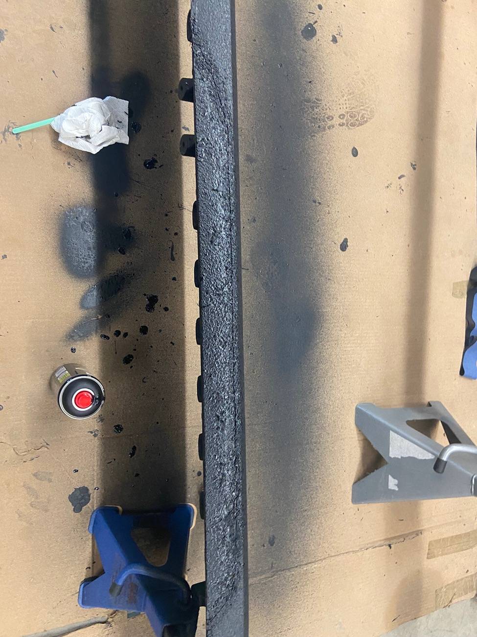

The passenger side board, I pulled the mask after 4 coats, and was quite surprised to find the new liner thicker than factory. I kinda panicked and attempted to fix with multiple foam brushes and roller covers, but made things worse. I shot the remainder of the can over the top, to see if it would help.
Ford Ranger Ranger Raptor in Moab and Hells Revenge IMG_1120
After 15 min, it still looked pretty bad, so
I once again made the wrong choice and messed with it more. Then tried to spray the can and it just spattered big globs.
Ford Ranger Ranger Raptor in Moab and Hells Revenge IMG_1131
Plan now is to let it cure, sand it smooth with orbital tomorrow afternoon, buy another $50 can of raptor liner, and spray it again without masking.

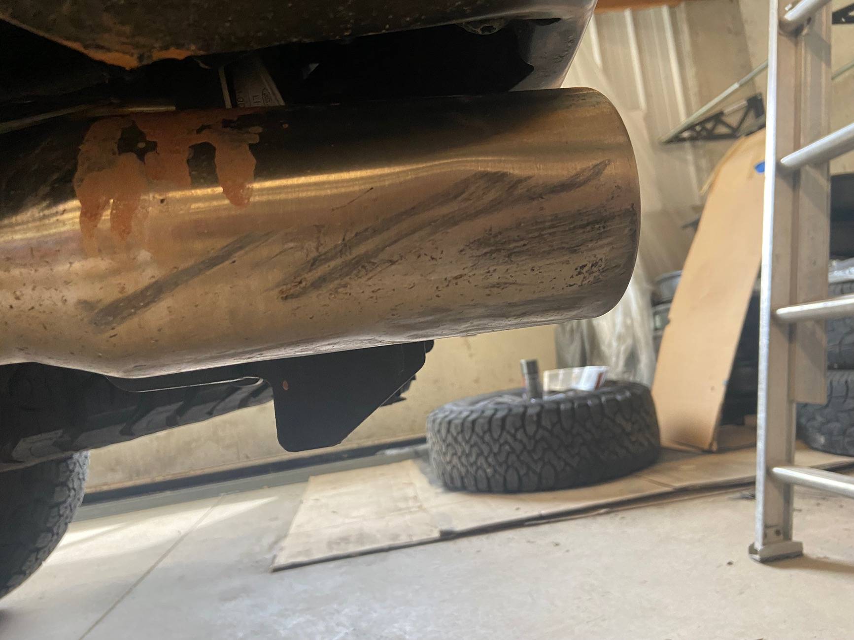

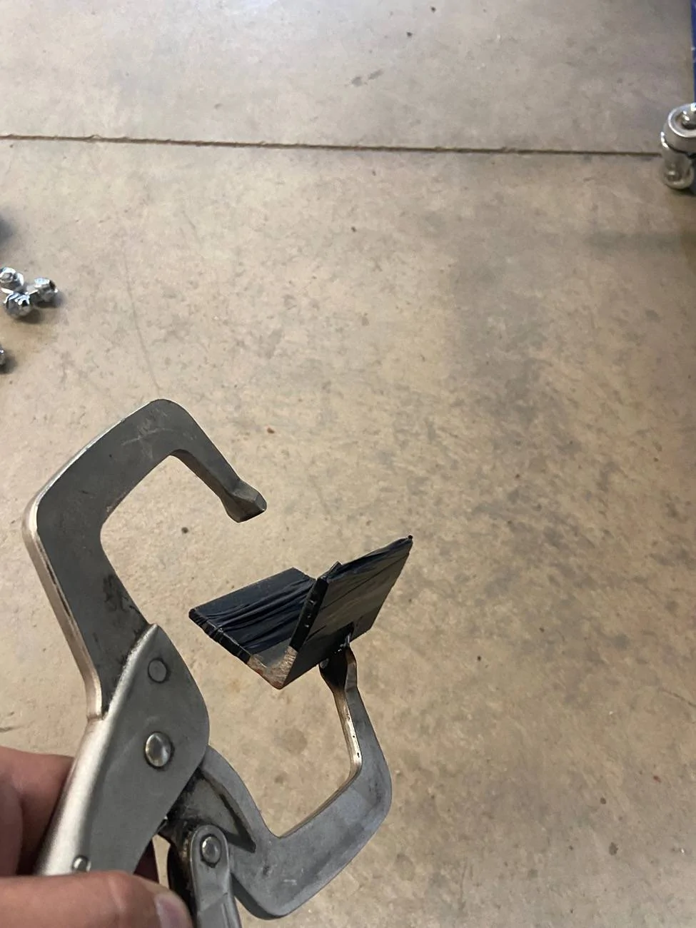

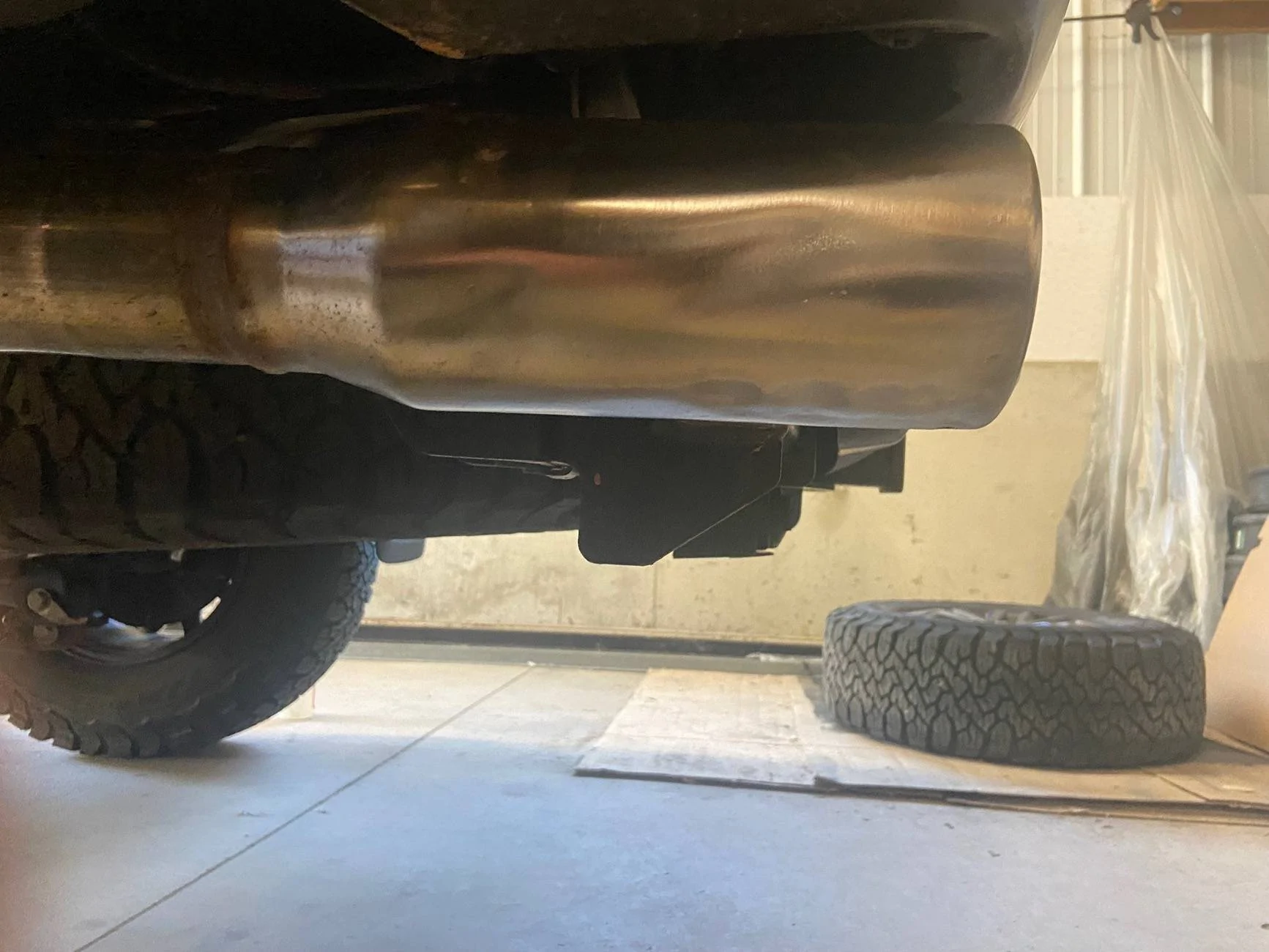

Exhaust tip:

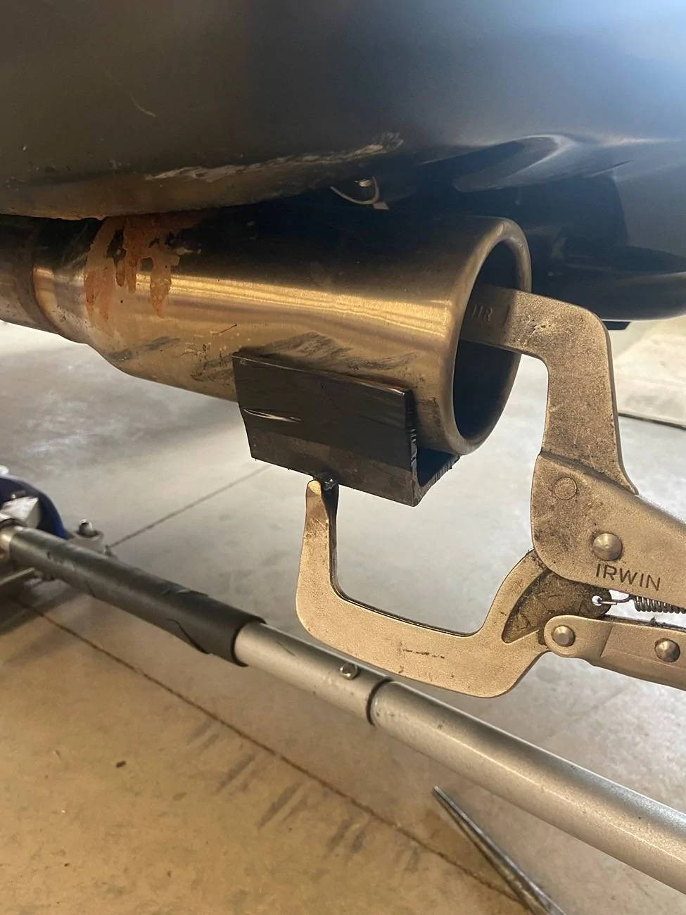

I tried tapping out the dent with a hammer and rounded end of a large punch, but the angle and unsupported work piece made it ineffective.
I made a quick press tool by tack welding a scrap of angle iron to a welding clamp.
Ford Ranger Ranger Raptor in Moab and Hells Revenge IMG_1122
I worked the clamp around the dent trying to push it out evenly.
Ford Ranger Ranger Raptor in Moab and Hells Revenge IMG_1123
I didn’t get it perfectly smooth by any means, but did restore it to its original profile.
Ford Ranger Ranger Raptor in Moab and Hells Revenge IMG_1124
I considered sanding and polishing out the scuffs, but noticed the tip had a brushed finish from factory. I chucked up a wire cup in a drill and worked over the scuffs.
Ford Ranger Ranger Raptor in Moab and Hells Revenge IMG_1130
I’m not sure if theres a coating on factory, so if it oxidizes, I’ll brush again and spray with high temp clear.

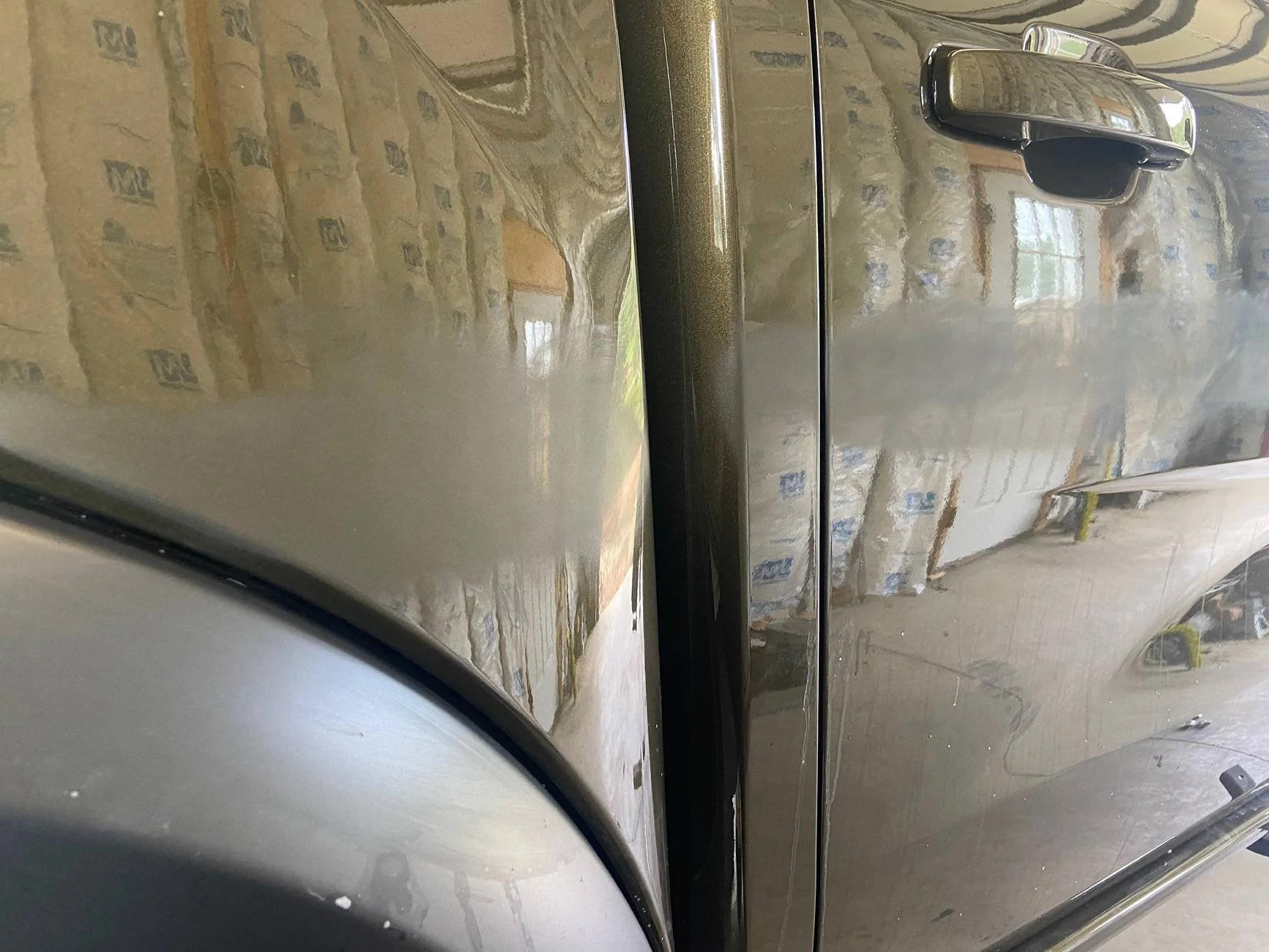

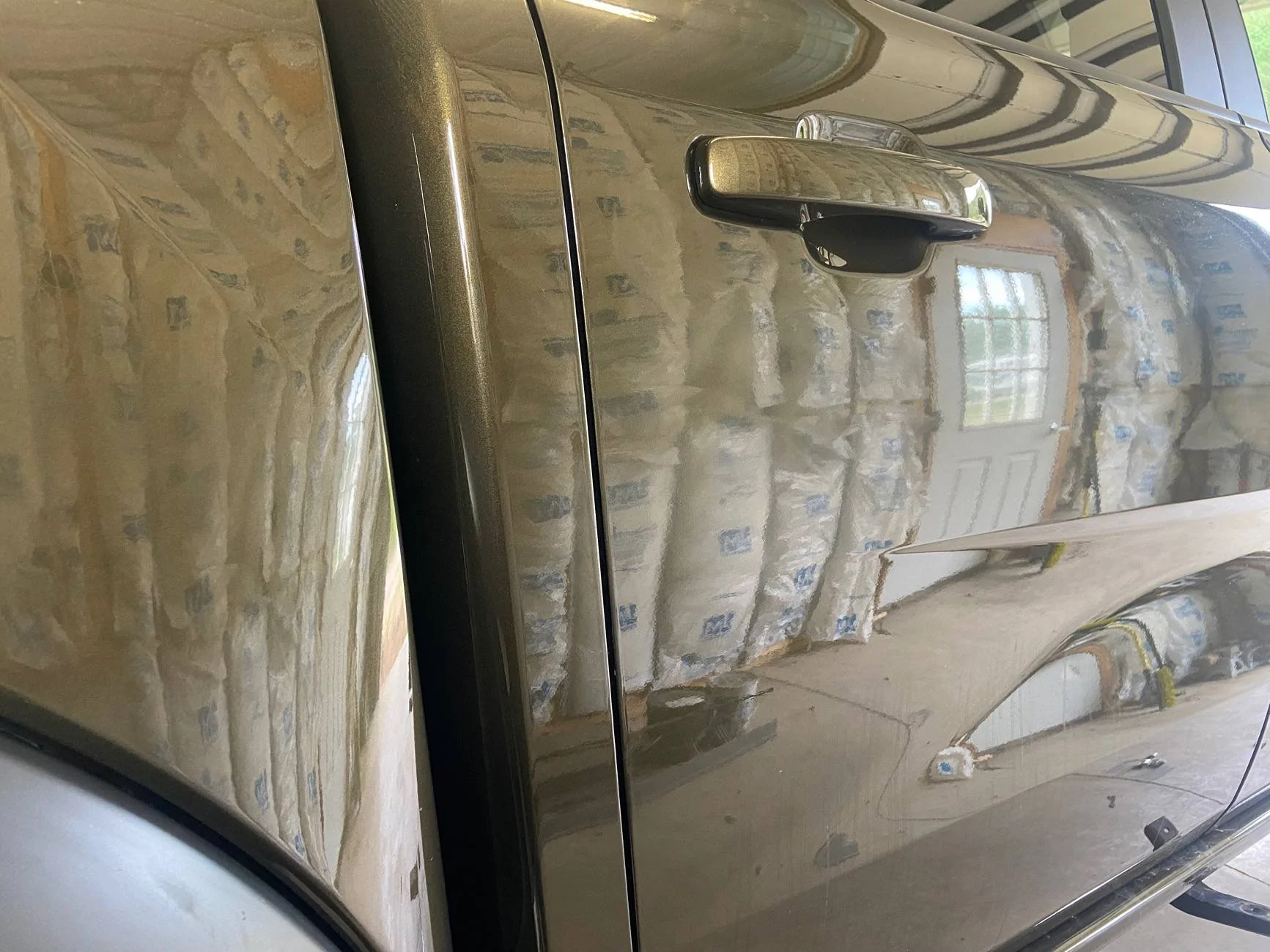

Trail pinstripe:
After some internet research into auto scratch repair, I bought this kit.
Ford Ranger Ranger Raptor in Moab and Hells Revenge IMG_1134
Wet sanded by hand with the 3000g foam pad till the scratch was gone.
Ford Ranger Ranger Raptor in Moab and Hells Revenge IMG_1125
Performed two applications of the rubbing compound, then two applications of the scratch remover compound on the drill wheels. I noticed after the first pass of rubbing compound that scratch was still barely visible, but didn’t want to sand off more clearcoat.
Ford Ranger Ranger Raptor in Moab and Hells Revenge IMG_1126
Applied two applications of lucas wax, and called it fixed.

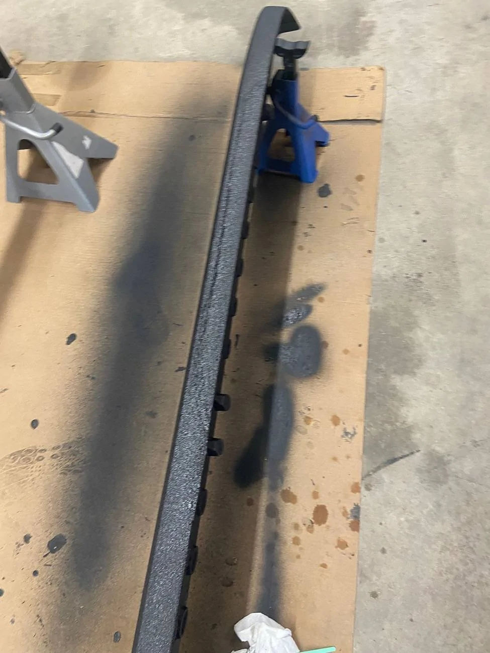

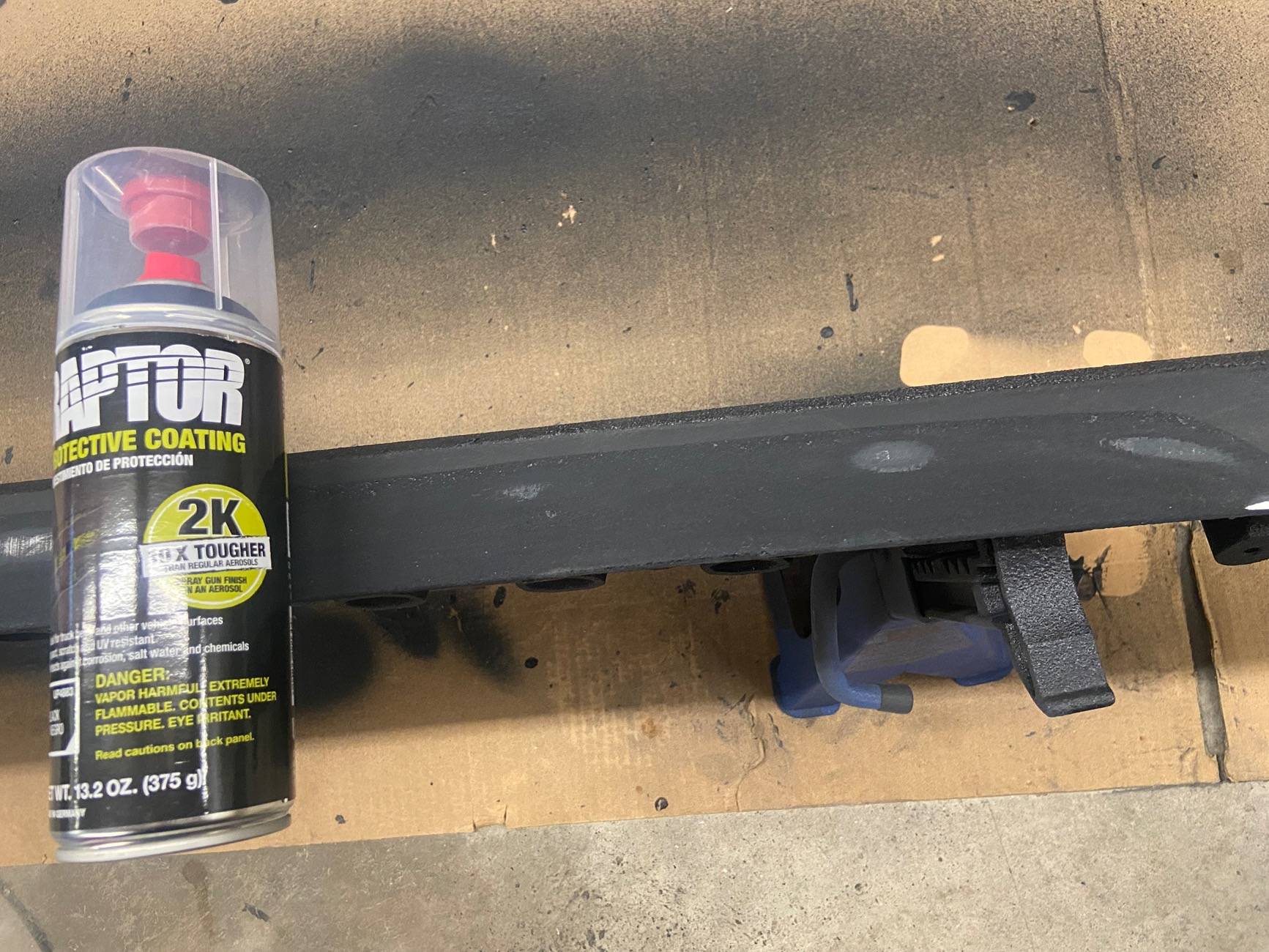

Running board try two:
Sanded the repair area smooth. Used orbital sander with 80g pad. The day-cured raptor liner was much softer than the original of course, so ended up leaving the original a bit proud and punched through the raptor in spots.
Ford Ranger Ranger Raptor in Moab and Hells Revenge IMG_1142
Sprayed 4 coats at 20 minute intervals.
Ford Ranger Ranger Raptor in Moab and Hells Revenge IMG_1150
Not perfect, but good enough. Plus, I’m tired of buying $50 rattlecans.
I am now calling all repair areas successful, assuming they hold up to time and weather. Total cost: under $200.

Two scuffed wheels:
I recently rashed a wheel and need to get it painted. a few questions for ya:
- Did you clearcoat over the paint?
- How has the duplicolor held up?

I did not use clear on the wheels.
The paint held up great until i took it back to moab in april. All 4 took new damage. Haven’t gotten around to the repair yet.
