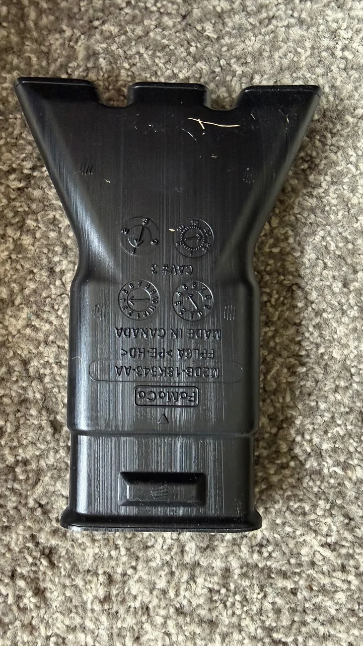

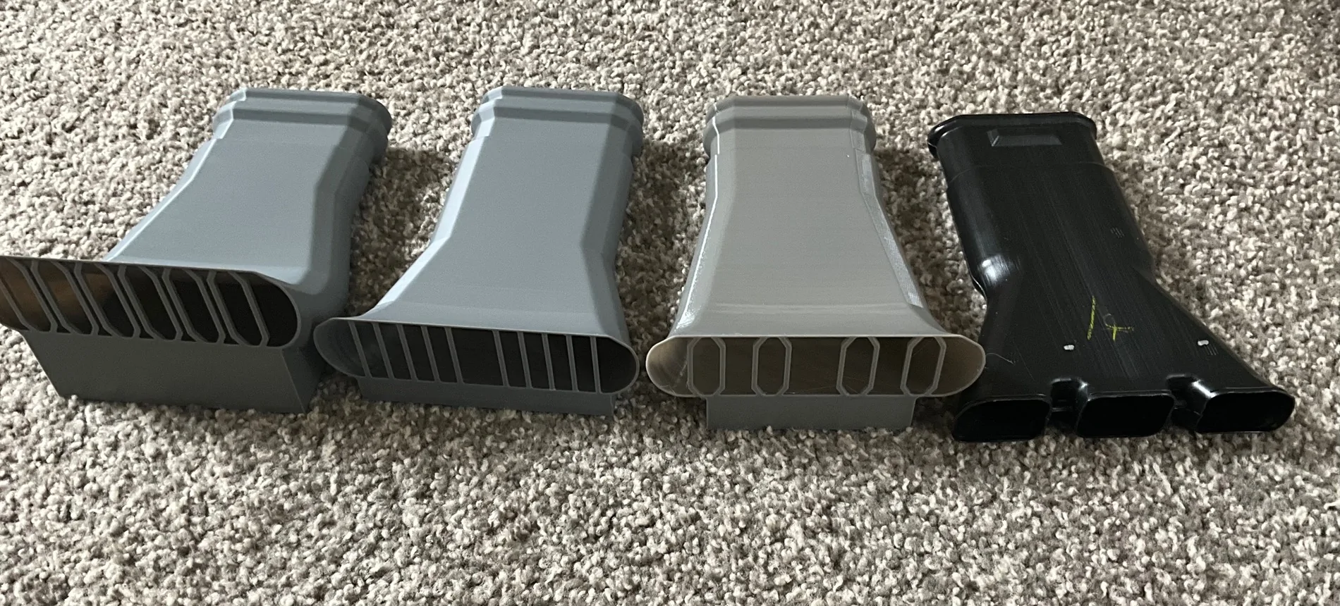

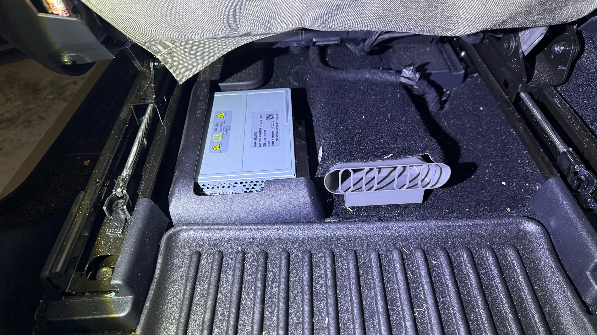

I guess I got inspired to look at the rear seat vent that goes under the seats.
the existing vent exhaust blows out too low right into the carpet and mat bump.
so I though why not deflect it upward?

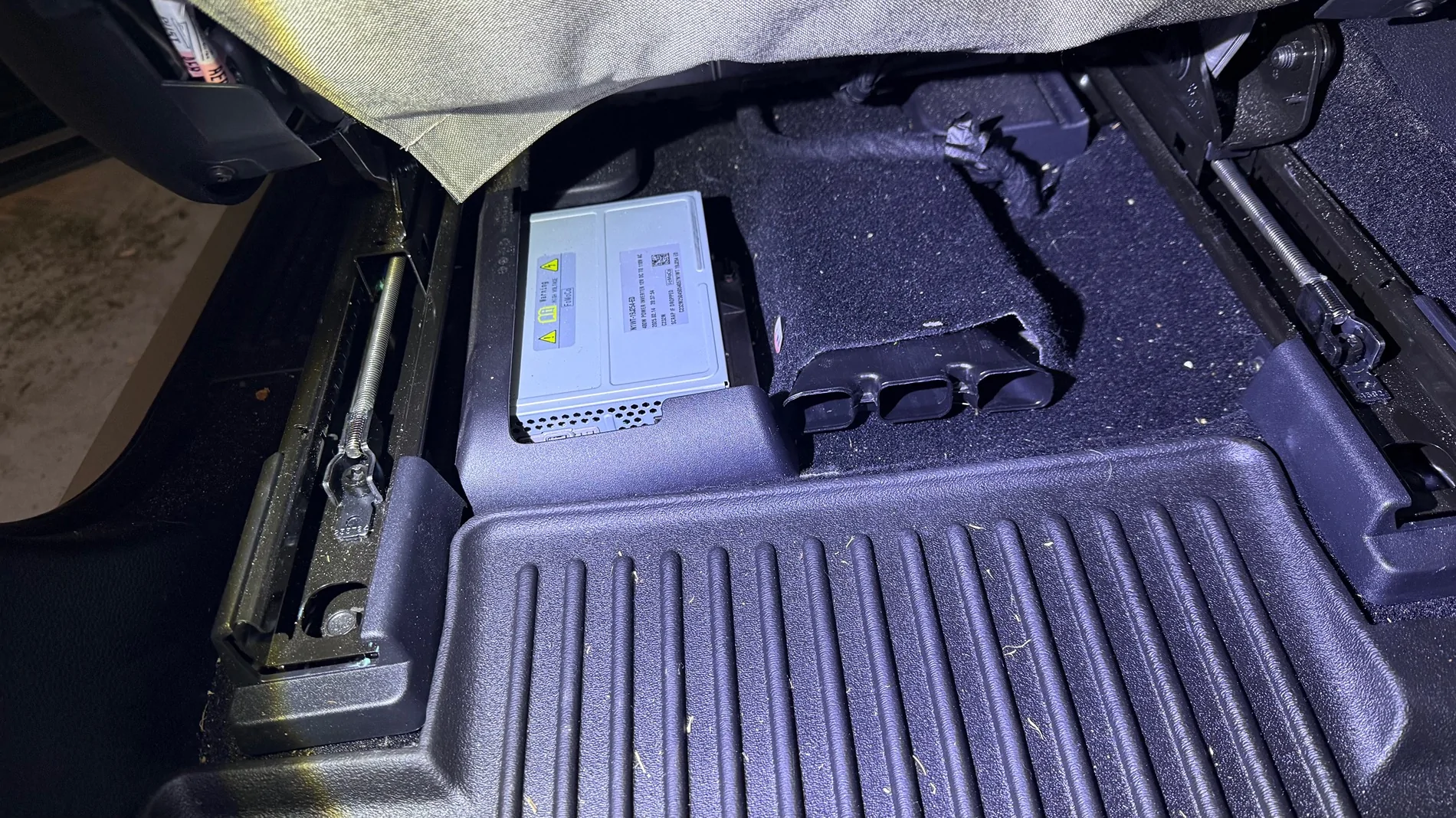

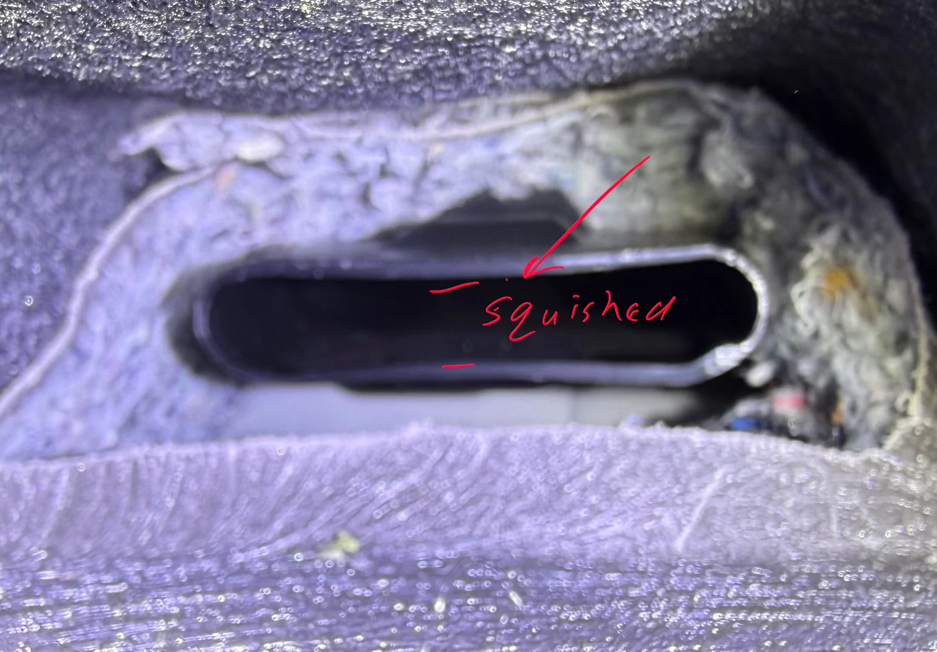

the factory part pulls out very easily and on closer examination it is the female part and the male mate part way under the seat is squished down. That likely restricts some flow.
after sitting in the back seat, I didn’t think extending the vent back was a good idea since it would interfere with passengers seats
in all honesty very little air comes out these vents, even on max fan and only lower vents on
surprisingly just taking the factory part out seemed better than leaving the factory part in

thats better then the bronco one from amazon/ebay. it does the same ting but no longer pushes out to where your feet are as a passenger

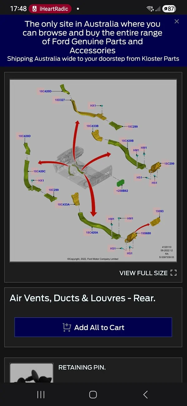

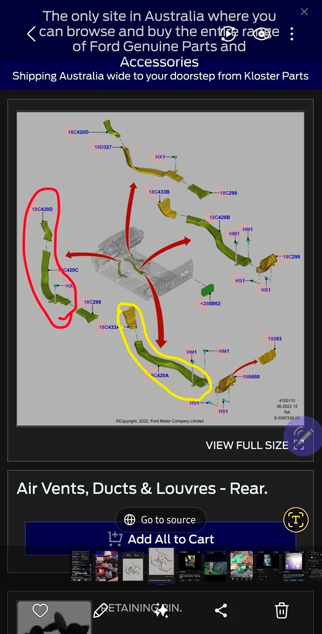

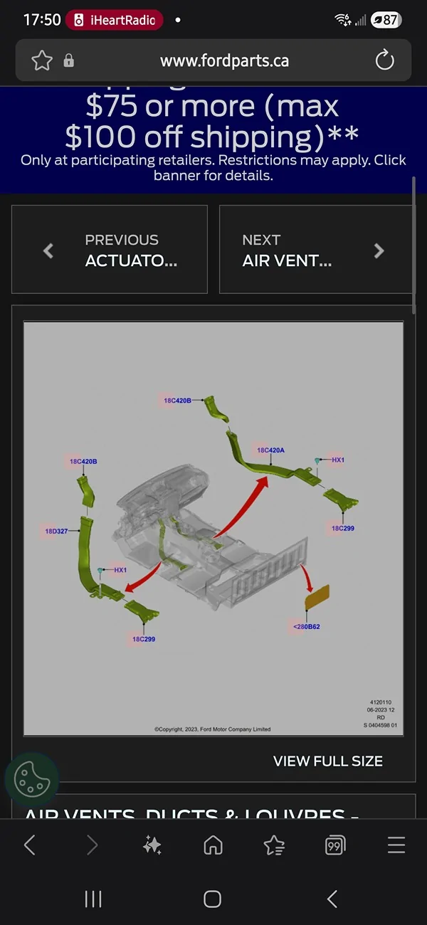

I said UK. it was actually Australian. and they dont look all that different in reality someone could 3d print an adapter to go from the foot vents under the radio, to the vent ducting you have to run under the center console, then run the aussie console vents. I had my console apart twice, the bracing and mounting points, and clearance where the ducting run are there for the console vents.

I never paid attention tho, and there could be blanks where the console ducting goes already.
I was installing diode dynamics ambient lighting footwell kit, amd under the front seats. and ran everything under the console. and when I yook my dash apart looking for the intragrated trailer brake controller plug as my truck happe ed to be prewired for nesrly everything else(spoiler didnt find it. lol)

you remove the ducting going down under the seats that have meaningless airflow, and instead divert them to the console ducting. I think the problem is in the obvious restriction in the bends, meanwhile the rear console ducting is larger and more straight
maybe, hard to tell from that image how big it really is. The existing ones are not very big.
and less than finger width underneath the seat where it seems to have been crushed down.
Either one doesn't look ideal since their are shared with the front bottom vents?
Have we heard from our Australian counterparts on how well this vent system works?

Are these confirmed to be supply vents, rather than return/re-circ vents?
‘the diagram shows them going to the same place as our underneath seat vents and the rest of the world description is vent
any rest of the world owners with the rear console vent want to chime in?
i am really interested if any significant air comes out of them.
