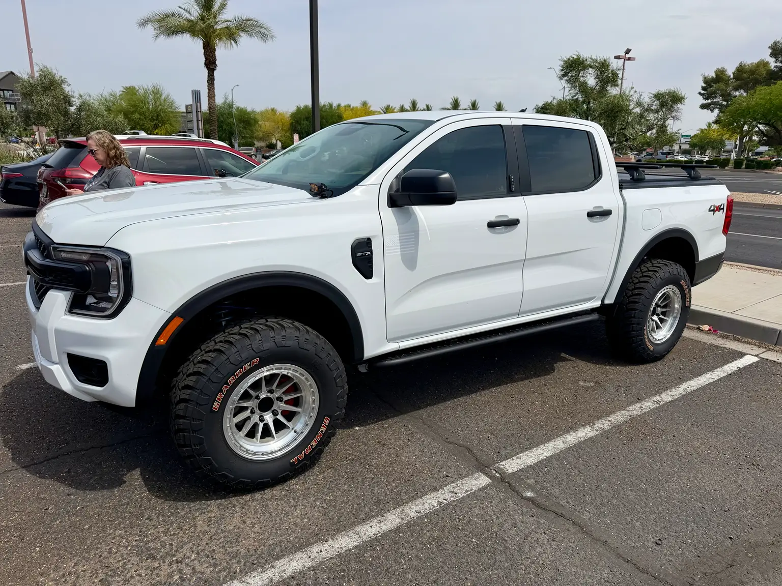

When I put my level and 35s on, I did the ride height recalibration using Forscan and updated my tire size with the Procal tuner. I don't believe you need to recalibrate your ride height on the XLT as they're just "dumb" monotube shocks.
It was extremely easy to change tire size with the Procal tuner and was just a matter of dialing in the revolutions per mile until the speedometer matched my GPS reading in Maps. I know this can also be done with Forscan, which is going to be a much cheaper option if you don't want the tune, but it's also going to be significantly more challenging for someone without experience. The Procal automatically updates all of the modules when you change the revs/mile, but with Forscan you have to update them all manually and risk the truck throwing codes if you mess it up.
I didn't do any ADAS recalibrations, and my adaptive cruise and lane centering seem to be working just as well as before the modifications. This may not be the case for everyone, so I would suggest you make your own educated choice on this matter.
Also, don't forget to adjust your headlight aim so you don't blind oncoming traffic. Good luck!

I did a 2 1/2" level lift, which was actually 2" after said and done. Adjusted headlights and got an alignment. No ADAS or any other calibration. I wouldn't worry about the tire size, it's lest that 1" difference in diameter. The OEM speed cal isn't perfect.

I went up 3.6% on tire height on my Maverick and had no issues outside of the small difference in mph and odometer. The windshield camera can easily be kicked into a "learn" mode via Forscan if need be. Then all you need to do is drive it down a marked lane.

It’s very easy to adjust the speedo with forscan.
it took a couple of tries to dial it in,but super easy.
Im on a 285 tire,and while a manufacturer claims a certain diameter,there are always small variables.
