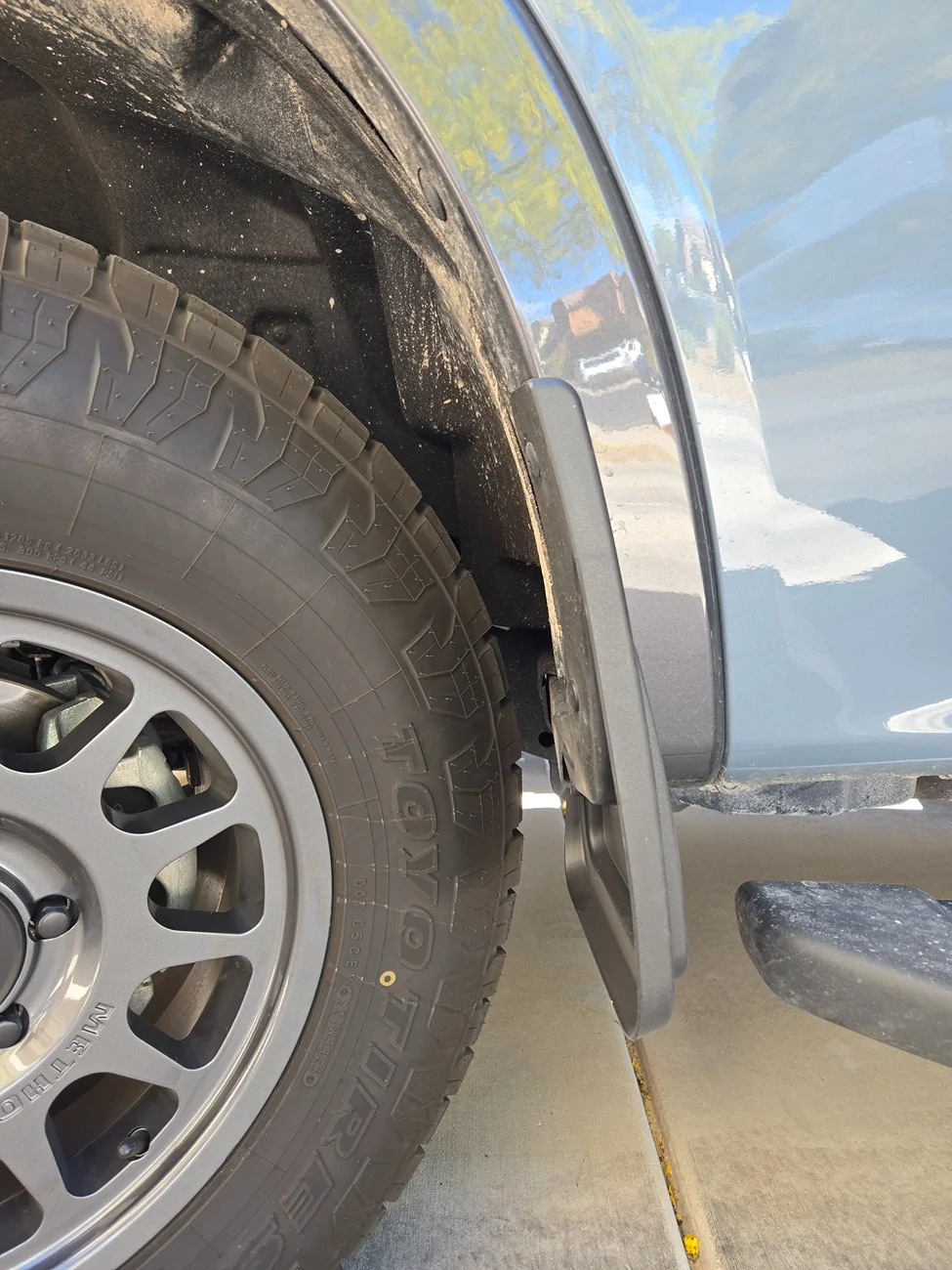

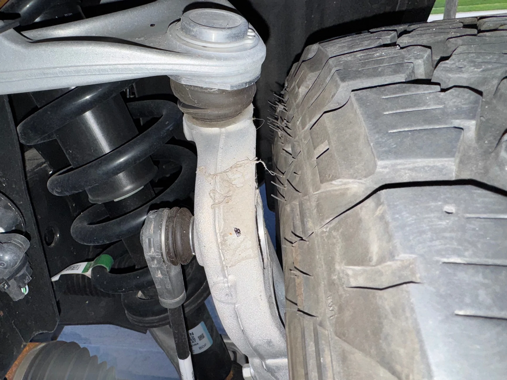

Do you have a picture of the space you have left between the wheel and front & rear crash bars at full crank?
I have the Eibach stage 2 ordered and aiming at lifting the front between 1" and 1.5". Same tires size as you, but Methods 305 with +25 offset.
The kit is back order and the ETA keeps getting pushed further. In the mean time, I will install a 1" puck spacer. Im pretty sure I will need to trim some felt liner.
It would be appreciated if you could give a reference picture! :)

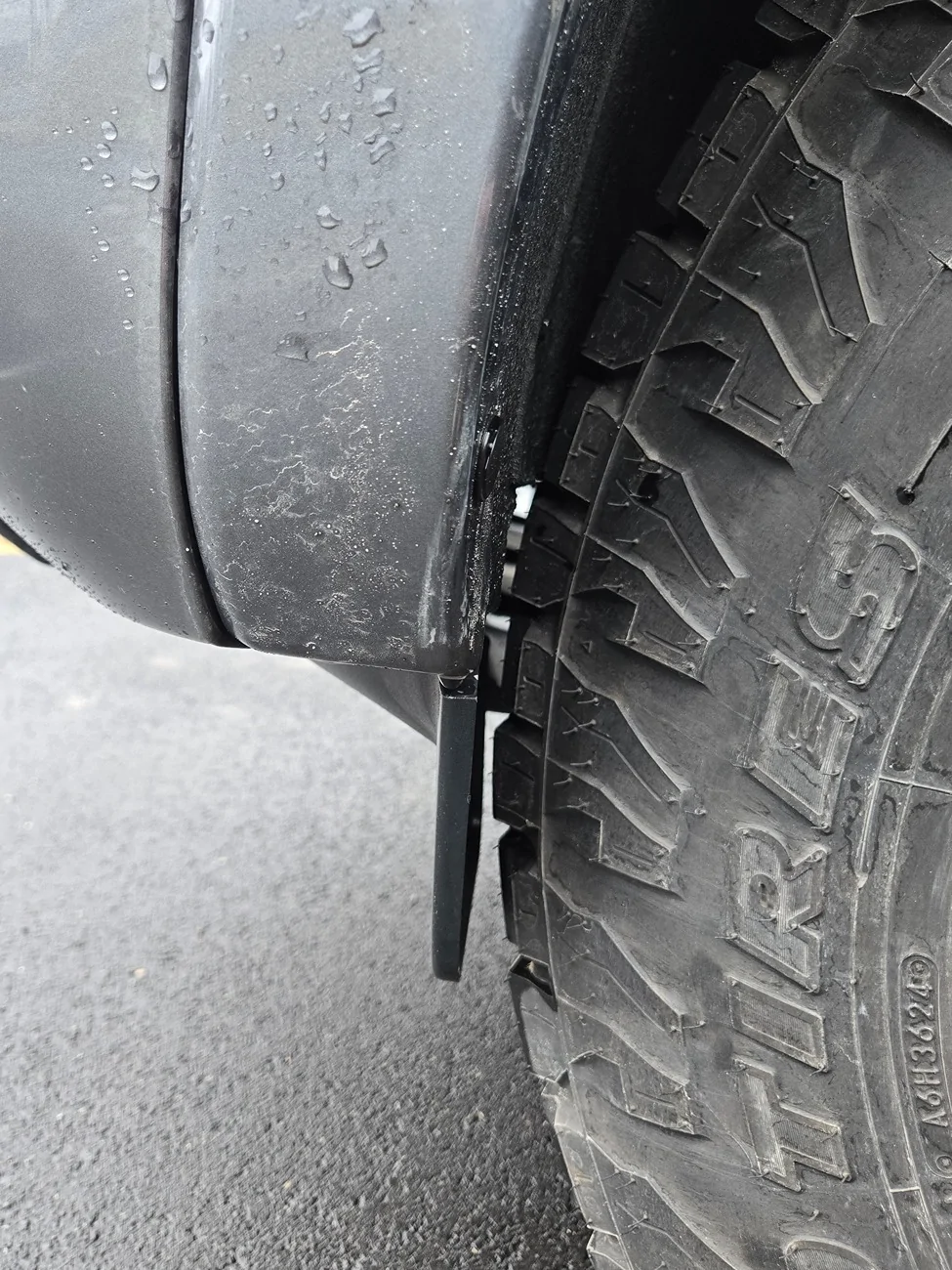

Here you go. Pretty close in front but so far no rubs at all.
Thanks! Plenty of room in the back, nothing to worry there but I see the potential rub in the front in reverse or when the suspension is compressed. Nothing some minor trimming can't fix.

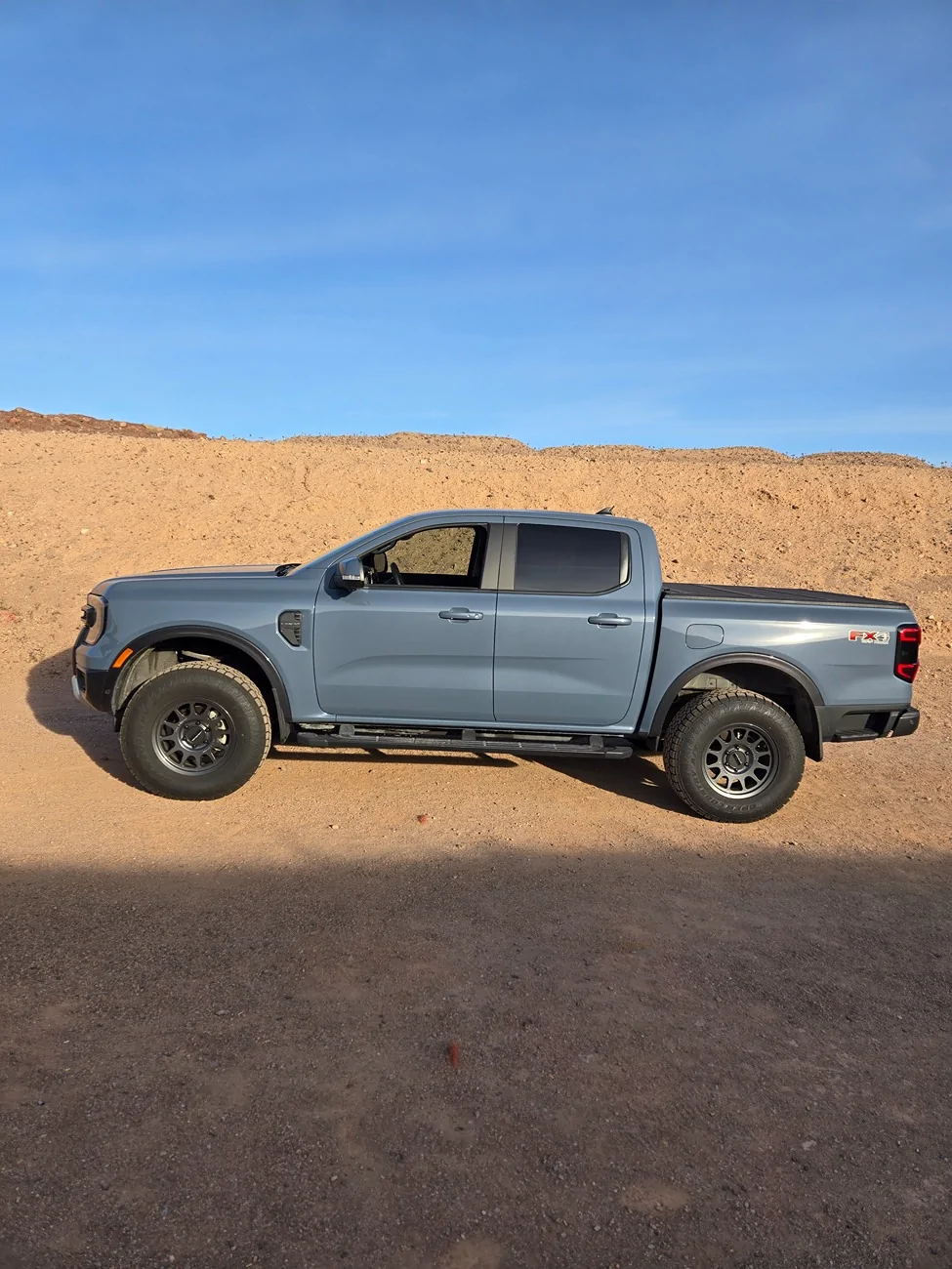

2024 XLT FX4, 2.7. Toyo Open Country R/T 275/70R17 on factory 17 x 7.5 FX4 wheels. Stock FX4 suspension, no mods. No rubbing or clearance issues. Very happy with the combination.
Sorry to quote a more than year old post,
But really? 275/70R17 is 33 (ish) do they really fit? Stock wheels, no lift?? No rubs, still??
I’m VERY interested in this combo, just about to pick up some bronco take-offs that are the same 17x7.5 +55offset (Black diamond, not SAS) and thinking about fitting the biggest rubber I can….
could be these, yeah??

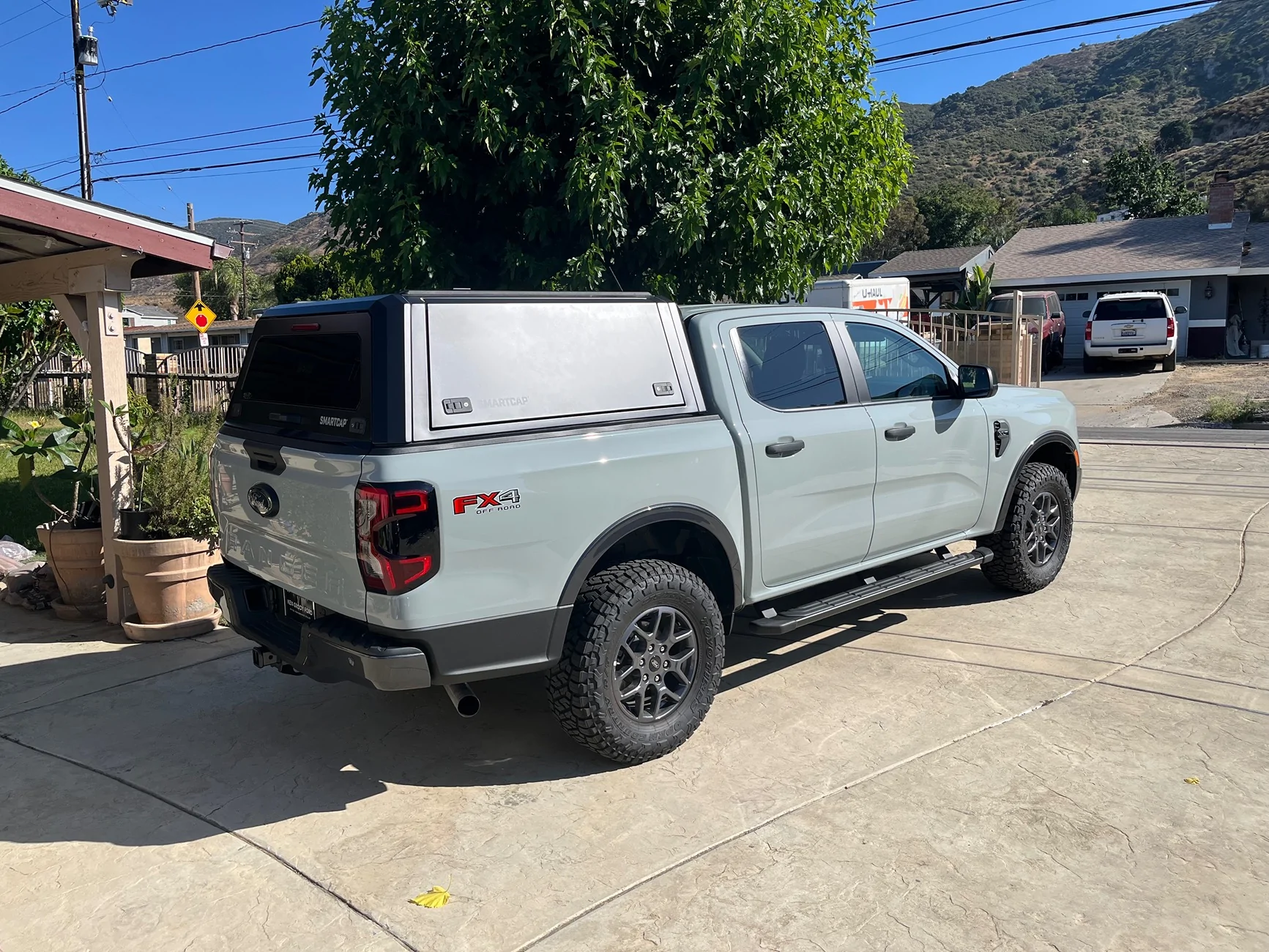

Stock 24 Lariat FX4. With 2022+ Bronco Black Diamond wheels (17x7.5 +55offset) and Stock (for them) General Grabber Atx 265/70R17
no rubs, TPMs learned on it’s own.
Maybe I’ll go up to the 275‘s mentioned above when these are shot…🤣

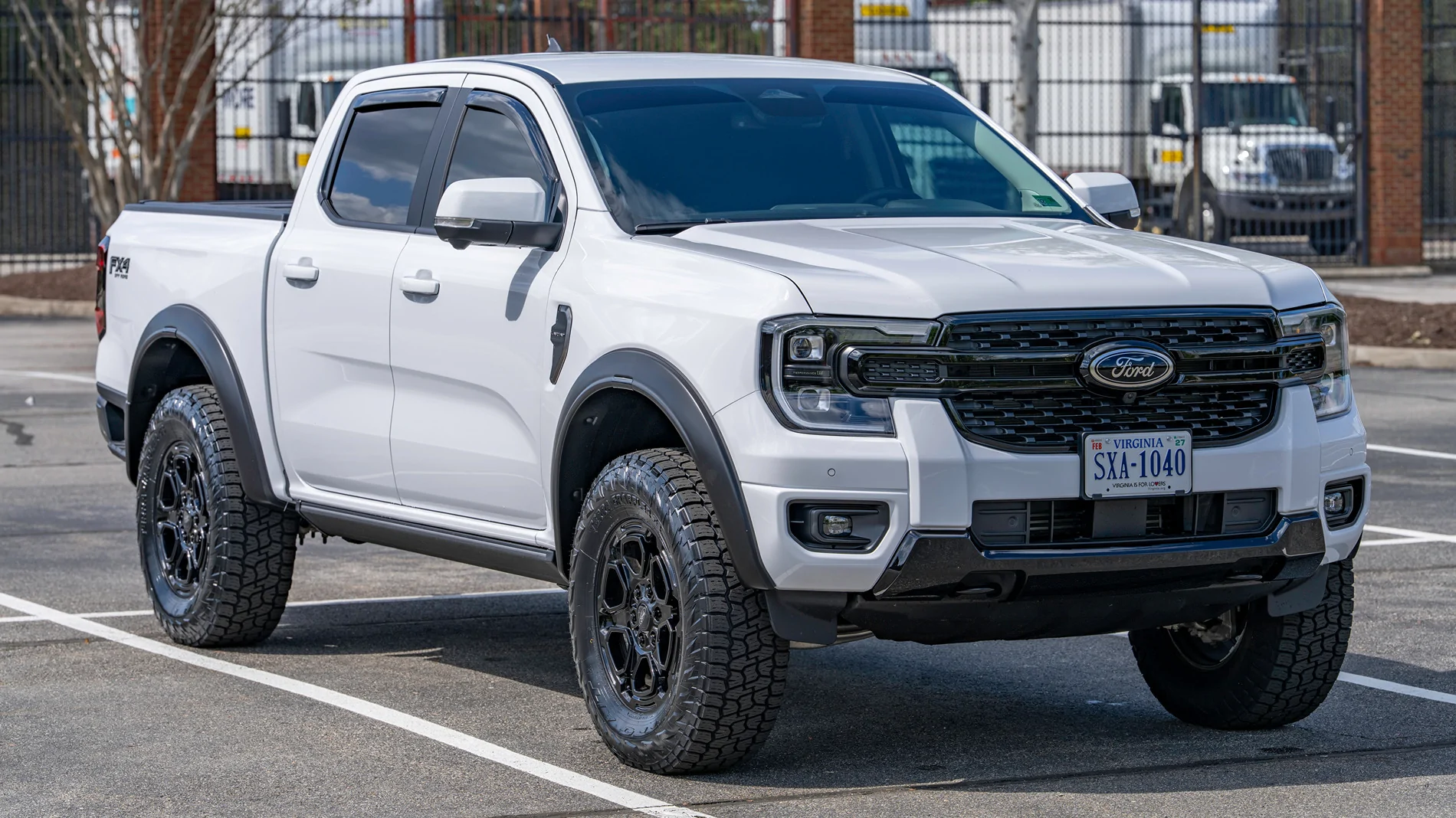

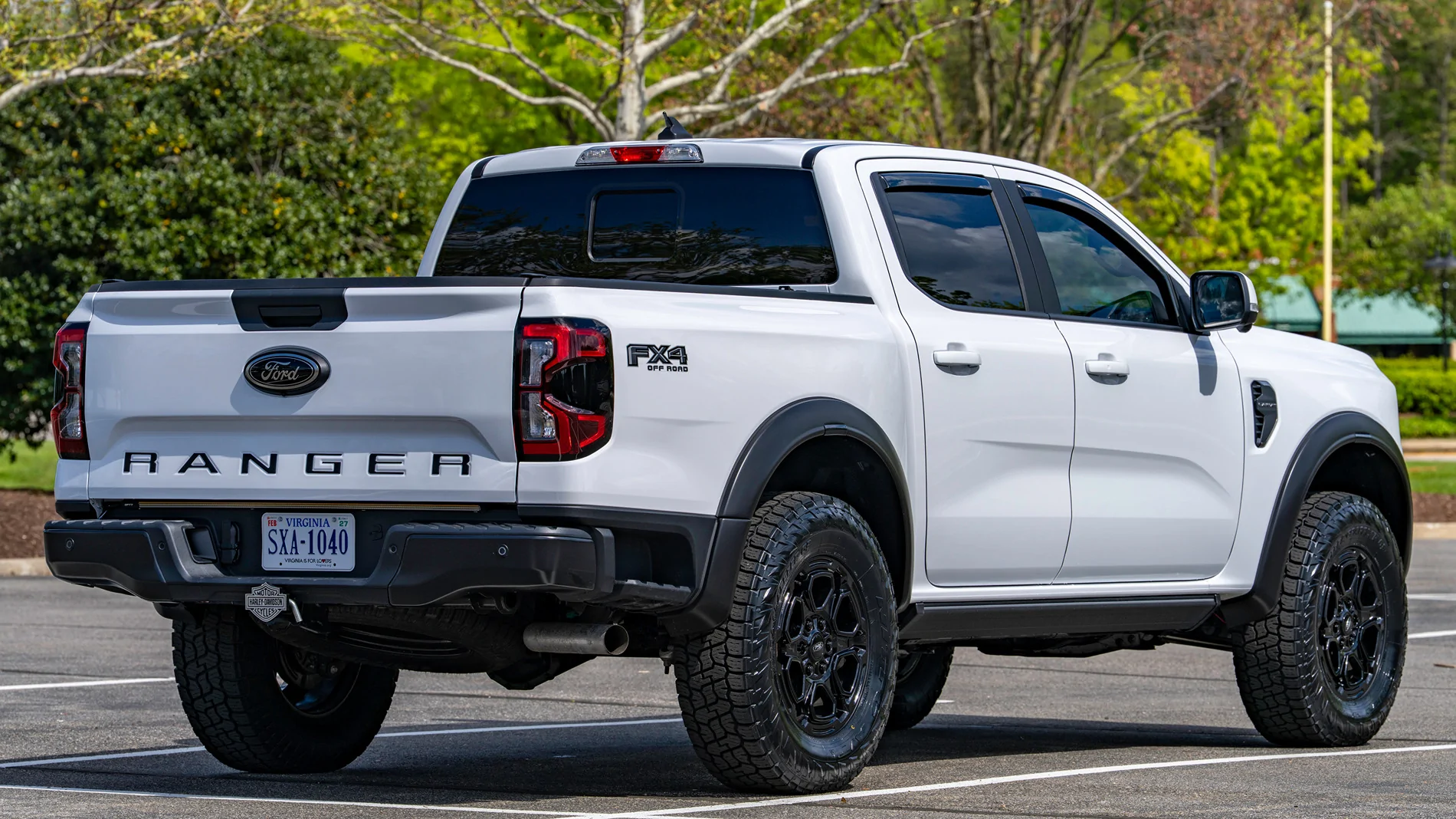

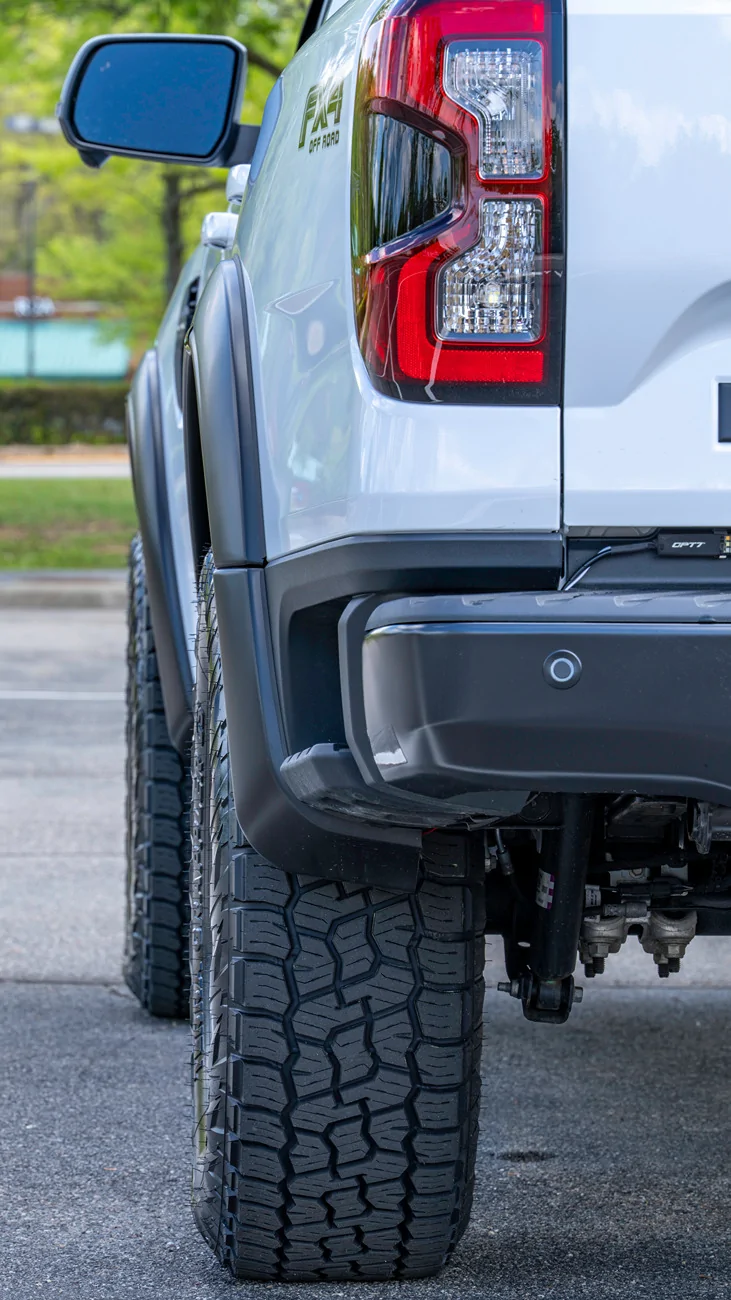

Put on some Nitto Terra Grapler G3 275/70R18 on the stock BAP wheels with 1.5 spacers and a 2" level. They are a lightweight, quiet tire. The spacers where perfect to go with the fender flares I put on. There's a slight rub at full lock. I need very minor trimming if I can't tie the liners back.
Very sharp looking setup .
‘With the BAP and your list of upgrades, it really starts looking a lot like a Raptor.
‘Which I do love that look.
NICE! I Love the Raptor! I was SO CLOSE to buying one but I thought I might need the extra towing capacity to pull an RV.
Very nice. Which fender flares are those?

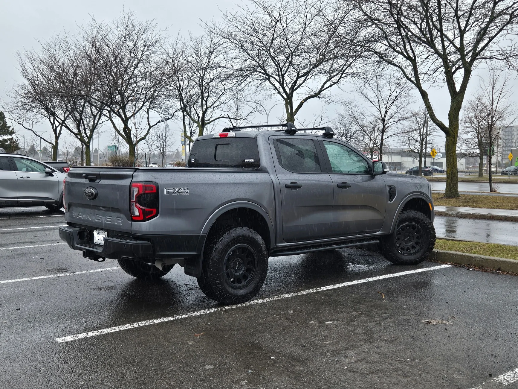

285/70/17 Toyos Open Country AT3
Method 305 double black 17x8.5 +25 offset
1" lift from Fordrangerlift
Wanted to keep some rake because I will tow a 3700lbs dry weight travel trailer.
My driveway goes downhill, but in that same spot I measured 2.5" of rake stock, and now it's still 2" rake after the lift. Curious that it says 1" lift but is apparently more like 0.5" lift.
I got rubbing at full lock in reverse and forward on the felt liner, even if i trimmed it a bit prior to the lift. Doesnt seem to hit the crash bar so I will just trim a bit more eventually. Nothing too concerning.
