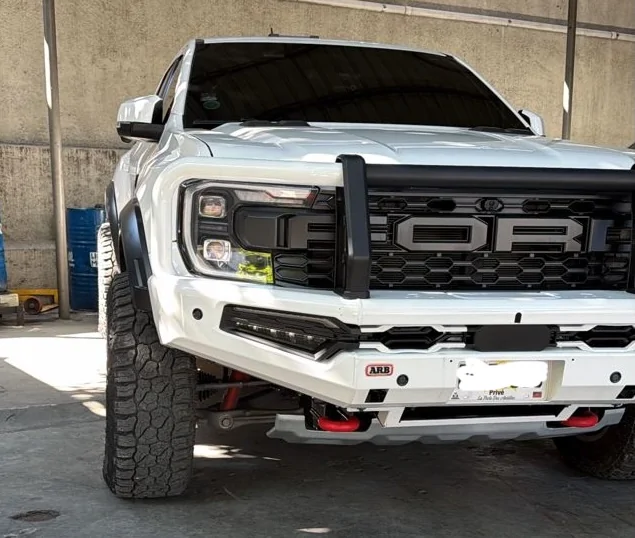

I couldn’t find anything that was hub centric that I really liked. I wanted an something similar to an oem replacement. So I had 6061 aluminum forged wheels made that are the hub centric to my liking
These wheels are custom made overseas.
I have a friend who worked with the designer and came back with renderings until it was something I liked.
93.1 center bore
20mm offset
17x9
23lb
Factory size tires 285/70/17
